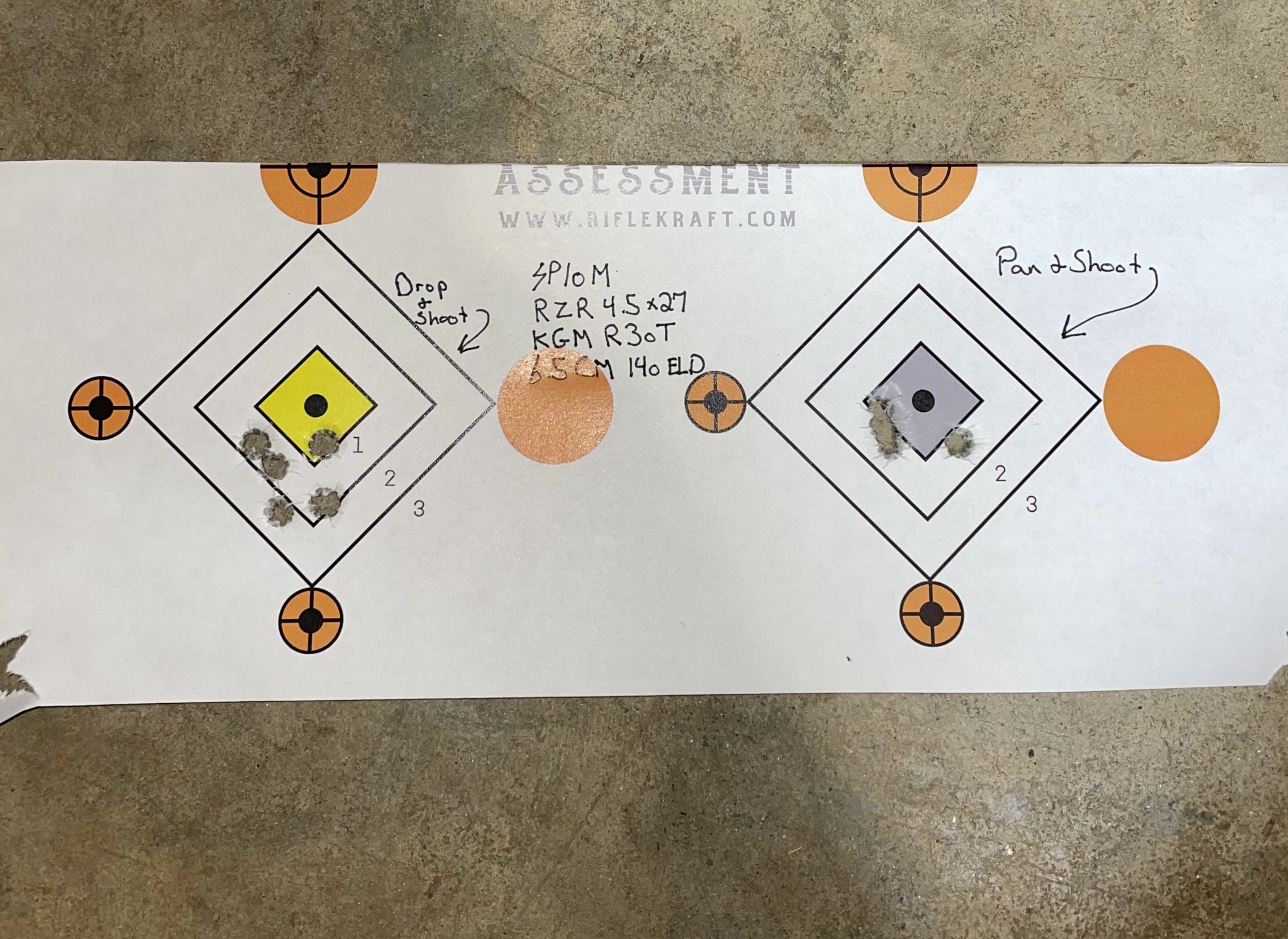

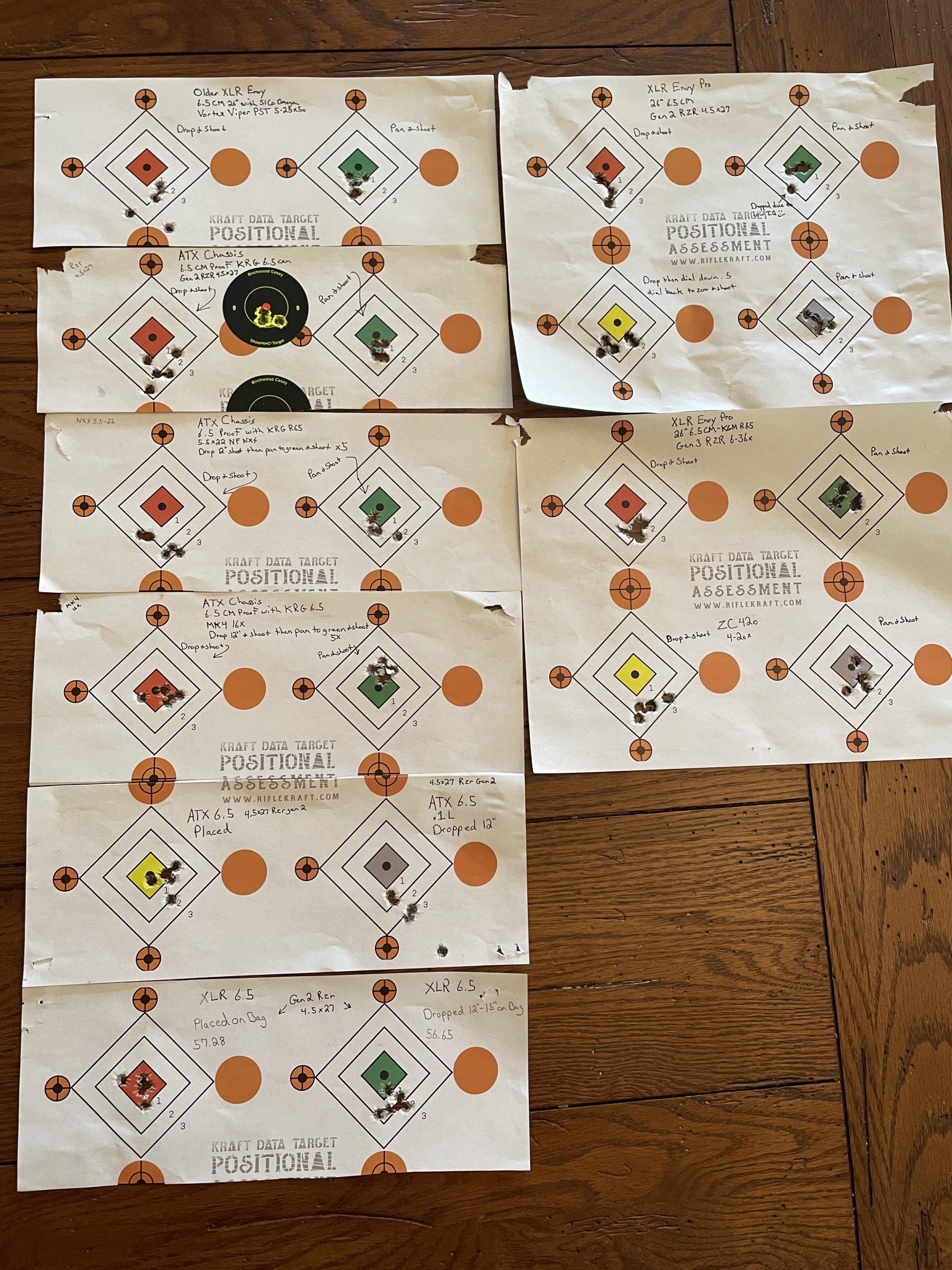

Seems I have a scope issue times seven scopes. It also seems like this is a legit issue. So, with that said I have a question for you dudes. Has anyone else seen an impact shift when dropping the rifle on a bag and taking a shot?
What started all this was trying to get my build and break times down. I’d shoot five shots from five different positions for time trying to keep them all in the #1 diamond on the Kraft Target. When I went from high kneeling to standing I dropped the rifle on the bag from about 12” in a hatchet type movement pushing to make up time. Hand on grip, forearm approximately 12” above the bag and let the rifle drop angling down to the bag. I noticed the shot went low when I called it center diamond. I shot again to confirm and it was center. I thought that was weird so I repeated the process and first shot was low, second shot was center. My mind went into overtime knowing there was an issue, but what was causing it? My first thought was chassis. Swapped around with three chassis to no resolve. Ok, it’s a barrel issue, again three barrels with no resolve. So I texted a dude that likes to test stuff. He said nope never tested that or heard of it but I’ll look into it. Only one thing left to do swap scopes and see what’s up. The results are below and they speak for themselves. What say you?
Here is the process I used to confirm the results checking different scopes.
- All shots were from standing position.
- Held grip, the rifle is 12” above bag, release forearm and rifle falls onto bag.
- Fire first shot.
- Pan over to next target and fire second shot.
- Pick up rifle and repeat for a total of 5 shots per target/10 rounds total.
Here is the list of scopes tested:
- Gen 2 Razor 4.5-27
- Zero Compromise 4-20
- Nightforce NXS 5.5-22
- Gen 3 Razor 6-36
- Leupold MK4 Fixed 16x
- Gen 2 Razor 3-18
- Viper PST 5-25
Chassis that were tried early on to eliminate that thought:
- AIATX
- XLR Envy Pro
- Early XLR Envy
Barrels Tested to remove that thought:
- 26” Proof 6mm
- 26” Bartlien
- 26” Proof 6.5mm
The last thing I tried was dropping the rifle onto the bag dialing the scope up and down to remove any lash then return to zero and fire. It fixed nothing.
Will work for ammo….
Update to add Seekins SP10 results 5-26-24
