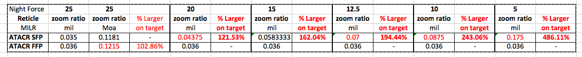

Are you saying SFP (with subtentions) Allows you to aim smaller?? Let's put this into perspective and show the math. Note that some FFP reticles with run even a smaller dot the the ATACR.
First the difference at max zoom is not worth the argument.. But look at what happens as one zoom out a bit maybe for shimmer or barrel mirage. (note that was just quick math, should be close enough for the illustration).
