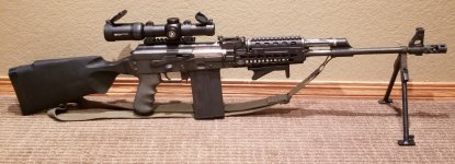

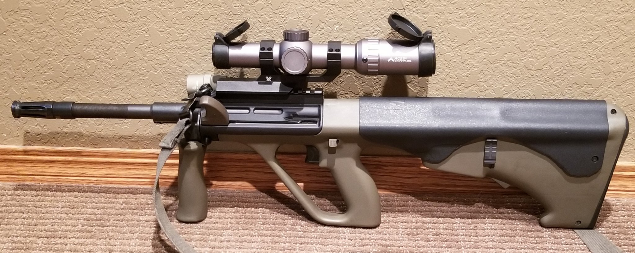

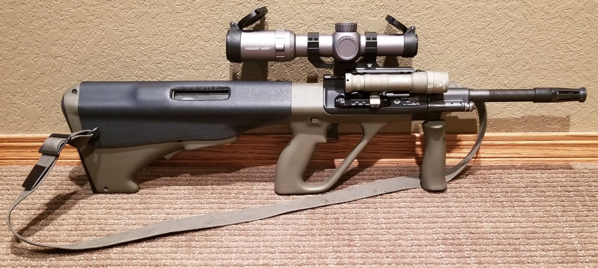

Edit: I added some pics of my PA 1-8 W/ & W/O illumination and on 1x and 8x so you have a good idea what you're getting real world, keeping in mind that theres only a couple hundred ACSS reticles at this point lol. I also included an old AK with a previous gen 1-8 strike eagle which is very close in both size and weight, but overall I'd say less refined than the PA 1-8.
