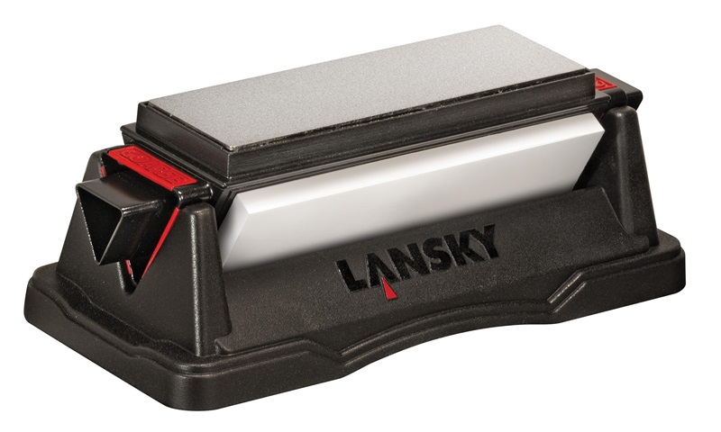

    i use a Lansky Crock Stick. its pretty easy to use, and u can choose the level of grind yourself. about 15 minutes on it and its pretty damn sharp. ive never really had shaving sharp, but thats probably because i stop too soon. idrc if it can shave me really......

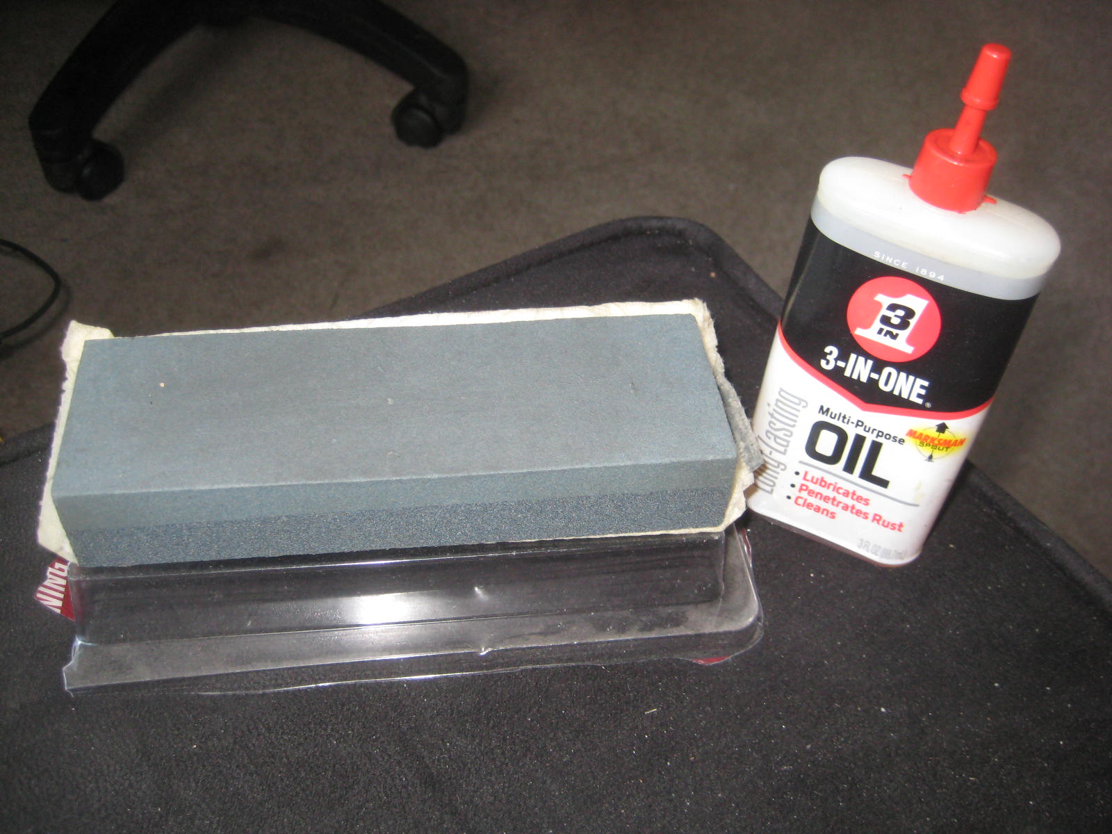

    One of these will basically sharpen anything on the planet. You just have to learn to hold your blades at the right angle.
    Practice on kitchen knives and cheap knives. Then do the good stuff. Keep it wet with water and add a drop of dish soap every once in a while to flush out the chips, so to speak.

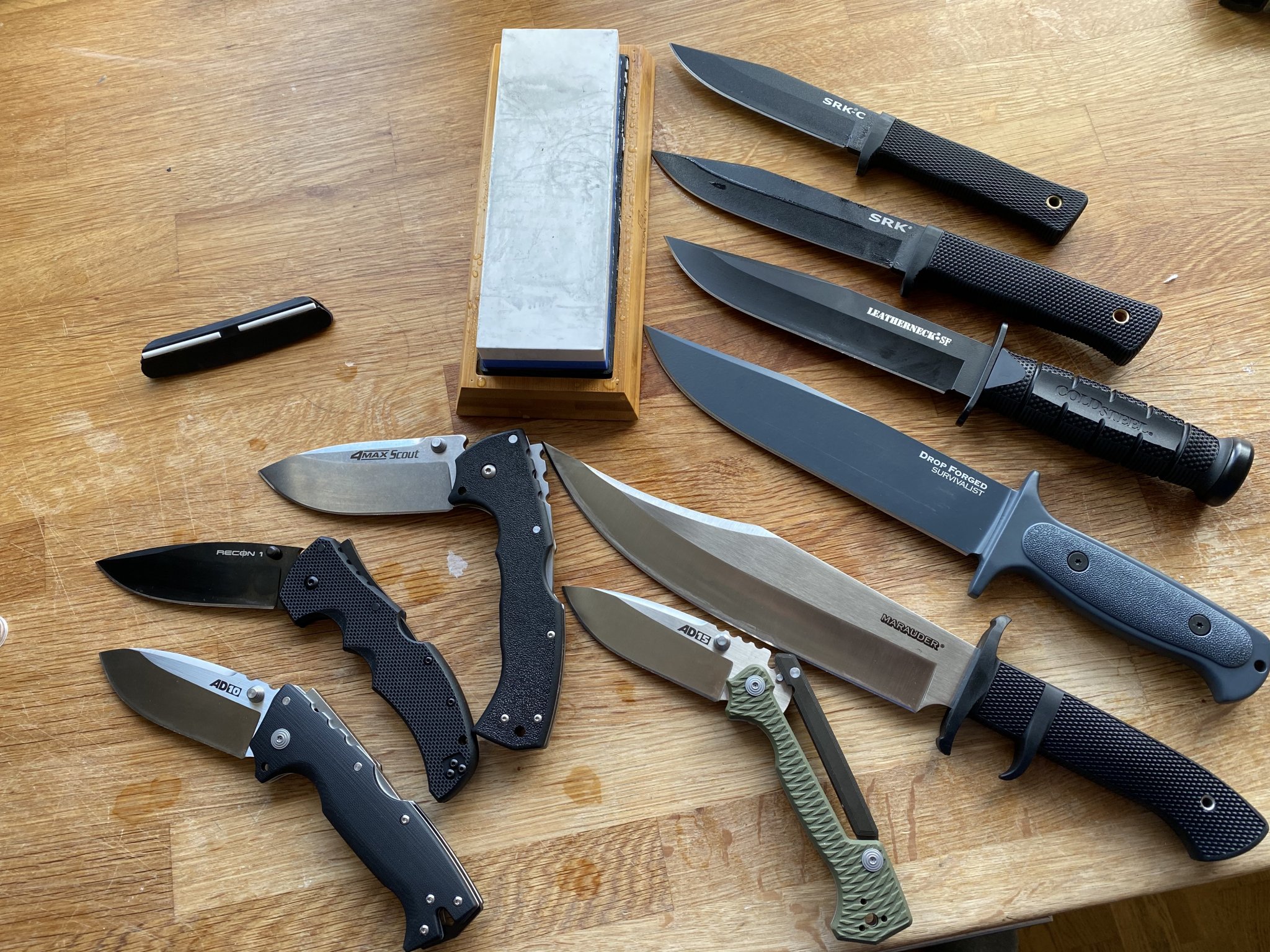

    Keep it simple and sharpen often.... Any of you guys remember when a wet rock was a standard item on the counter at the farm store, auto parts store or the hardware store ? Always a good time to put an edge on your pocket knife while waiting for your order to be filled....
    Now, everyone is "busy" and sharpening a knife is an event. Usually the event takes place after the knife has been dull for a long time...

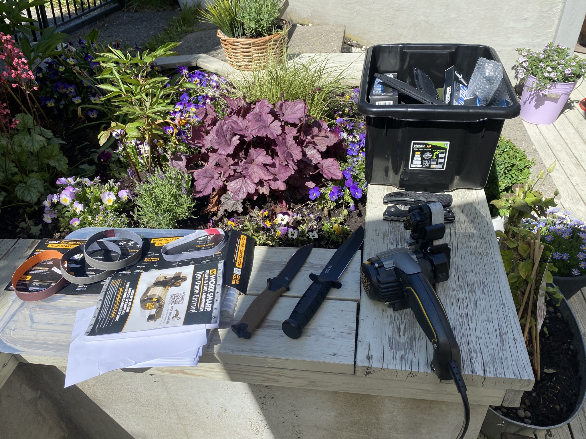

    Worksharp's Ken Onion is easy to use. Worksharp has systems from about $20 up. If you can attend one of their classes (like Atlanta Blade Show), you get a coupon for 50 % off your webb orders. It would pay to watch some of Worksharp's u-tube productions.
    Sharpening is all fun :)
    I have used the Worksharp KenOnion set with great results but also a relatively inexpensive Whetstone; both require practice and both give good sharp knives.
    This. With the Work Sharp you can easily and quickly put any blade angle on the hardest steels. Practice on a cheap knife and set much slower for soft steels, because you can also easily and quickly remove more metal than you intended. Takes just a few minutes to get the hang of it. $65 for standard version. Ken Onion version gets you a wider range of blade angle.

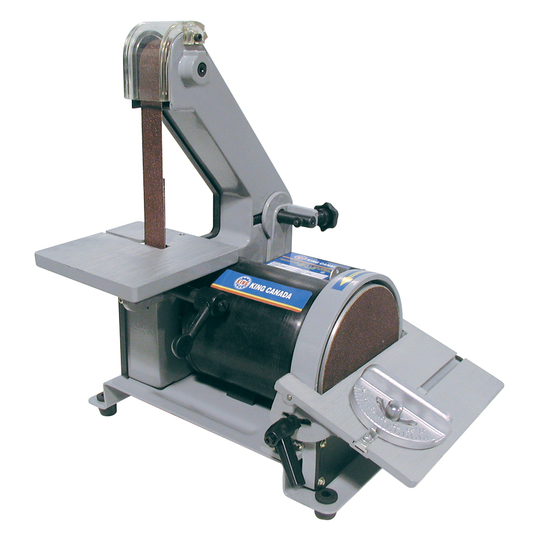

    The Ken Onion Edition of the little belt sand will work for most casual folks who want sharp knives....

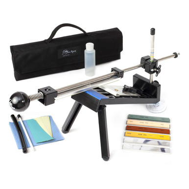

    I purchased the Edge Pro as I was not aware of the Wicked Edge at the time....

    as to the work sharp, the Ken Onion is the only work sharp to get for knives. If you picked up the base model, see if you can exchange it and buy the $130 or so Ken Onion edition.
    Did you get the Ken Onion Edition?
    The Ken Onion is a few pesos more but allows you to set a specific degree angle for knives...
    It is a simple and easy to use platform. Do you have a wide tipped sharpie?
    If not pick one up before it arrives.

    I have been using a 1" x 30" belt sander like this (1x30 Belt sander) for many years. My blades are always hair shaving sharp.
    Here's another https://www.homedepot.com/p/WEN-1-in-x-30-in-Belt-Sander-with-5-in-Sanding-Disc-6515T/307873039
    The trick is not the brand of sander you have as much as it is the belts. I have several belts now 120, 240, 320, 400, 600, 800, 1000 and leather with polishing rouge. I got all of them from Lee Valley Tools.
    I also have many good stones, but that requires alot of elbow grease especially when beginning with a badly sharpened or badly dull blade.
    I'll use the stones to touch up a slightly dull blade, but I'll still always finish with the leather belt on the belt sander for that mirror finish. I don't buy stones that are sold in sporting goods stores or knife shops. Instead I get them at industrial supply stores that specialize in abrasives where the quality is excellent but the prices are much much better. Hopefully there's one near you.
    I would advise you guys to buy a generic power tool such as this belt sander where you can get belts at the local hardware store, rather than some niche product with hard to find or limited selection of belts. It's very important to have the fine belts and leather for a razor edge.
    You learn a lot about blade steel when you have a belt grinder as you learn what steel throws a large burr or not. Often times a cheap knife well sharpened is an awesome knife. Case in point, I bought a Shimano fillet knife at the dollar store (actually I have several now). Out of the box it was crap, but excellent after I re-profiled the grind angles and polished the edge. When I was done, it was like a brand new Mora.
    I don't believe it is important to obsess about the exact grind angles or tools sold in an effort to help you maintain an angle. You'll get a feel for it anyway.
    If you think about it, it is very difficult to sharpen a blunt edge, but less work to touch up the edge if the angle is slightly too slight... So err on too sharp rather than too blunt. I hope this statement makes sense for you guys.

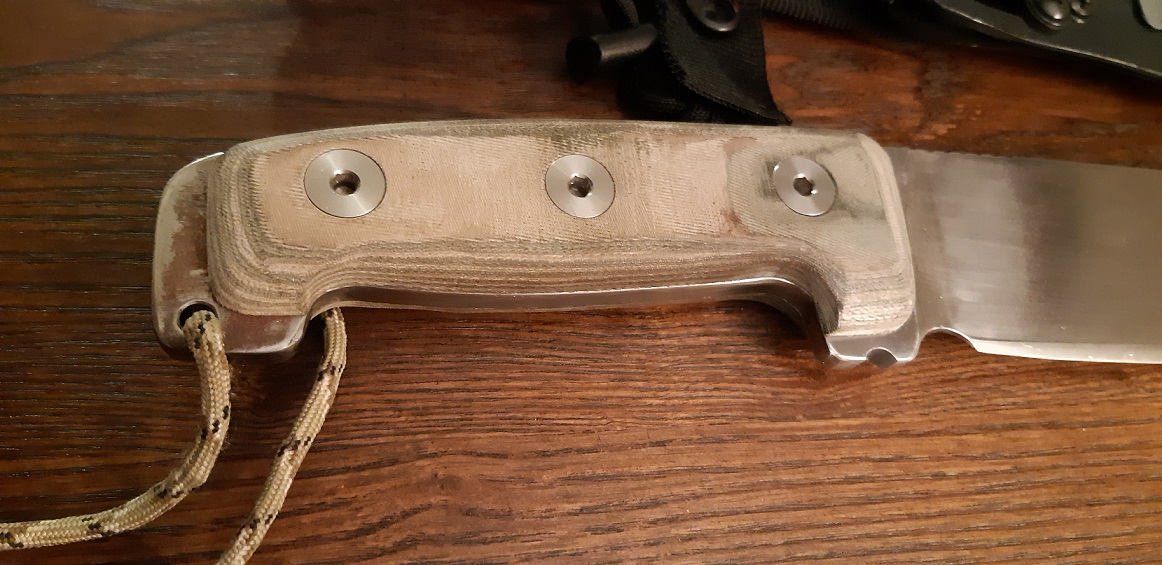

    Here's a couple pictures of a beast of a survival knife I made last year from 1/4" D2 steel. It's an awesome blade with a hybridized full flat grind / Scandi grind. I made the canvas Micarta too. Soon I'll need to take the handle scales off and polish it up again.
