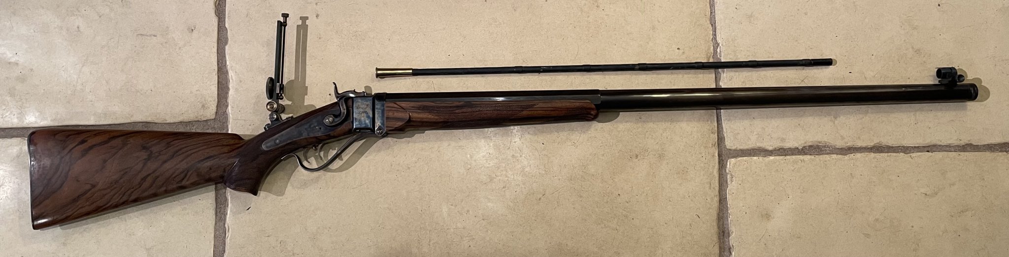

I have a 30 " Pedersoli 1874 sharps in 45/70 and I purchased a .22 rf liner from a place in Texas. The liner is 24" long and has a 45/70 case soldered to the breach end and drilled so the rf round will fit into it. I think it's a match chamber as it engraves the bullet. There are nodes evenly spaced along the liner and then the whole thing has what looks like some type of shrink wrap over it all. With a little grease on the liner, it slips into the barrel easily, and it works pretty well. I haven't worked with it with the high-cost ammo, but with SK rifle I got around 1.25-1.50" inch groups at 100 yards.
The interesting thing about the whole set up is that it's much quieter shooting, not silencer quiet, but noticeably quieter than my other rimfire rifles. It also verified that my vernier sights were installed correctly. I zeroed the rifle at 50 yards on a large target, and as I moved that target out to 100 yards, I "walked" the rounds up to find my 100-yard setting. The bullet strikes were a vertical line up from 50 to 100 yards. Shooting steel at 250 with the rifle is kind of jaw dropping.

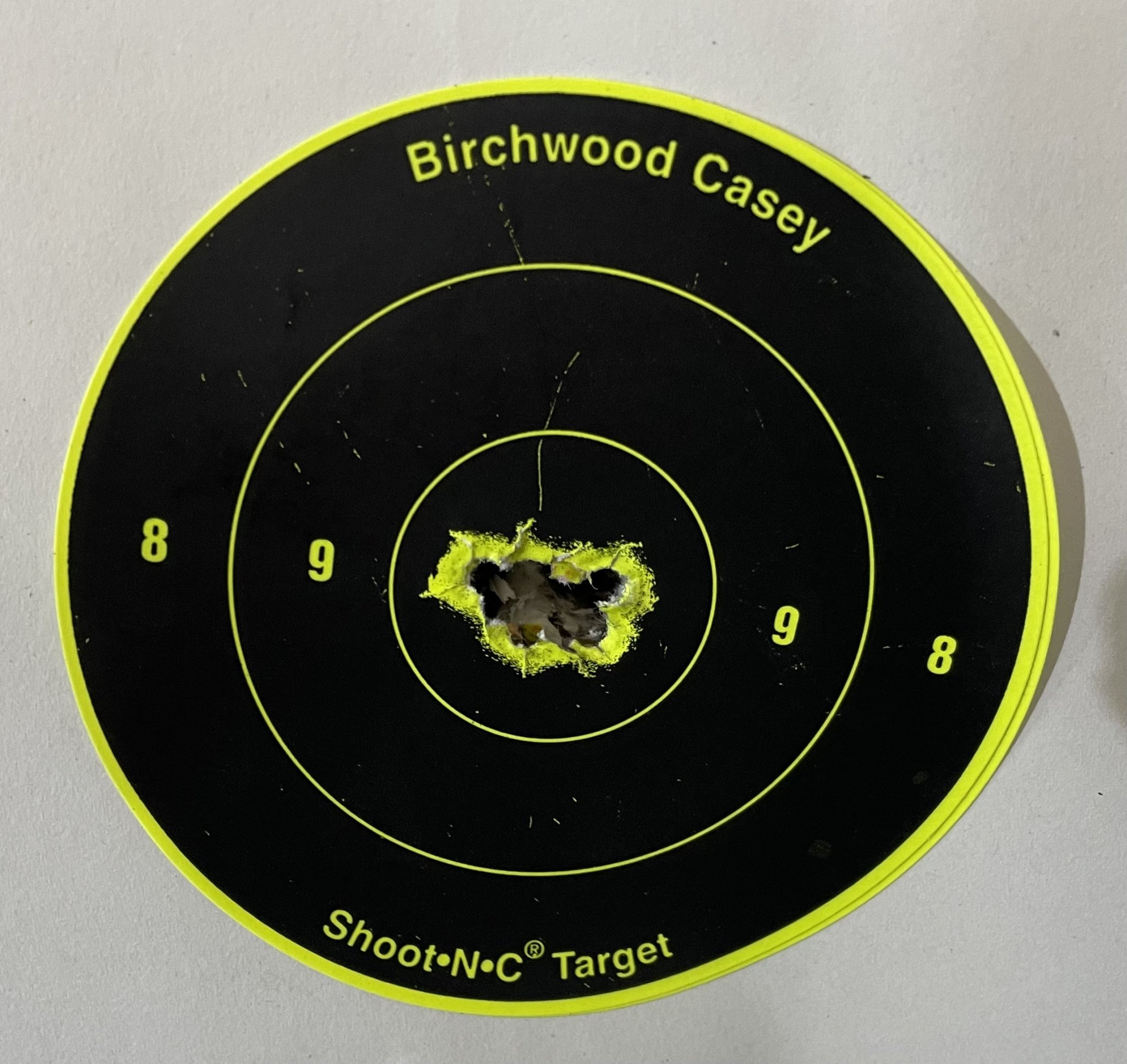

accurate to boot, this is 50m with original open tangent stights

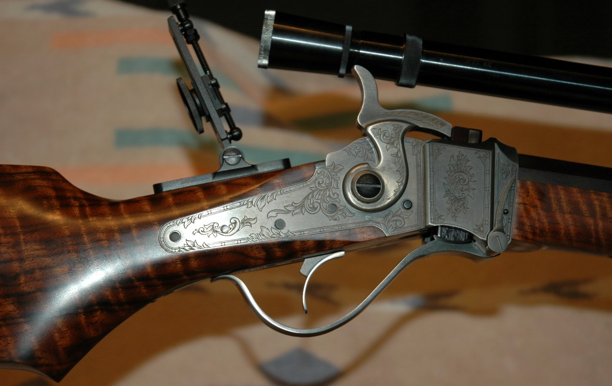

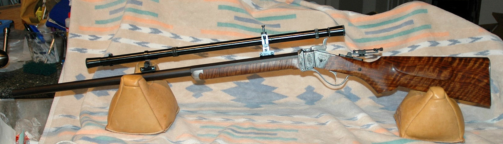

Beautiful rifle, is that a Shiloh or a C Sharps?
Looks like I'm going to be getting my Safe Queen Shiloh Sharps out to the range a bit more once the Crossno liner shows up from Buffalo Arms! Thanks for spending my money for me!! :)

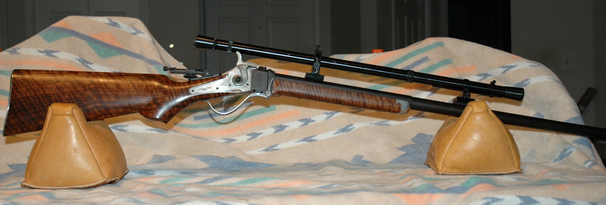

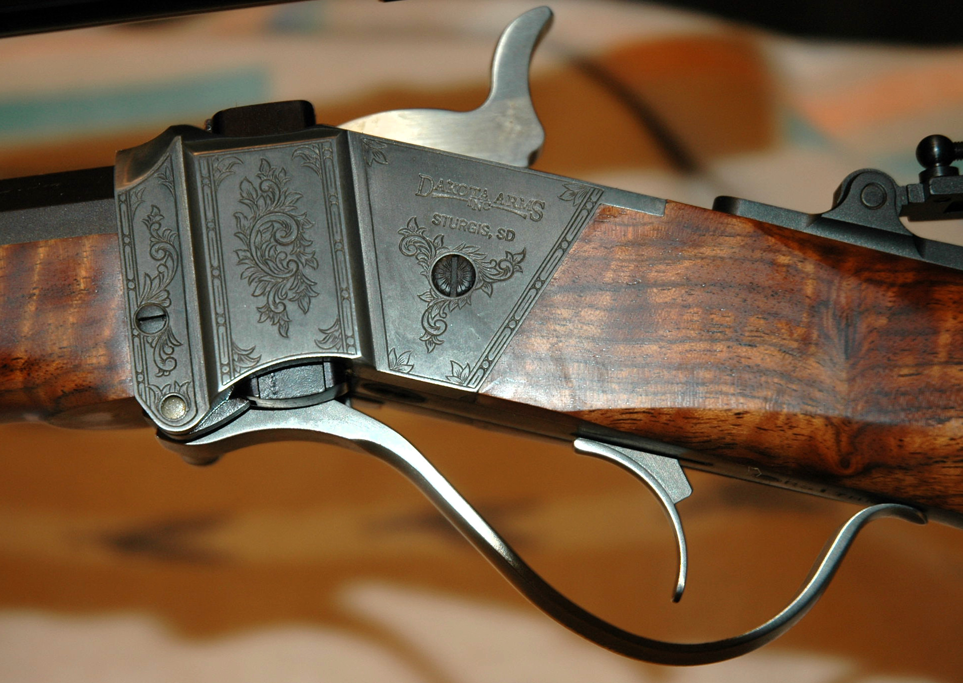

Though I never met Dave Crossno, I spoke on the phone with him several times after I bought a custom rifle from a good friend that he'd had Dave build on an original Winchester HiWall action in 1994. It was a beautiful single shot, with really pretty French walnut stock & forearm, custom repro of a Winchester double-set trigger trigger guard/lever, and a very accurate heavy octagon Douglas bbl chambered for 40-65. He'd also had the action & lever plated in electroless nickel, and I'd put Montana Vintage Arms LR rear tang & globe front sights on it. Dave had to make me another firing pin, after the one he'd supplied with the rifle broke. I sold it to another BPCRS shooter after I stopped shooting those matches...another one of those guns that I wish I'd kept.
