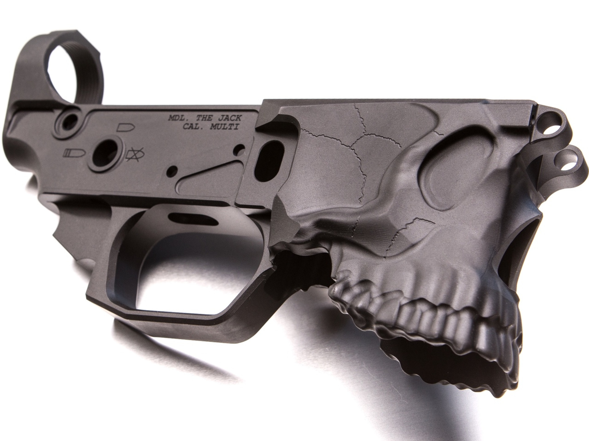

    They make "The Jack" and other novelty lowers as well as a conventional billet lower. Just because they can profile a neat lower doesn't mean the tolerances are held. Of the 17 Designs lowers all had good fit and finish, assembled correctly, and mated well with multiple (forged) uppers.
