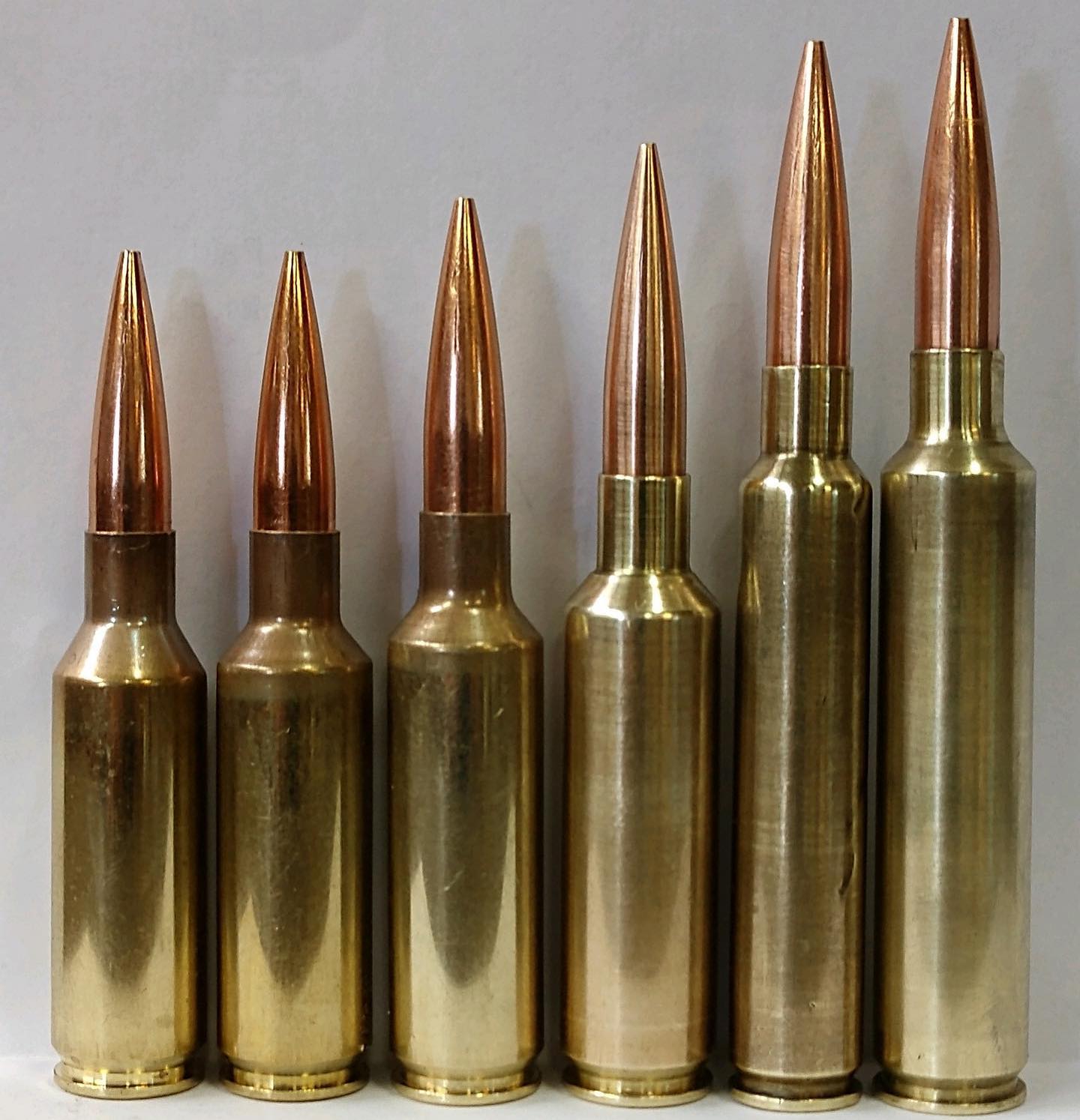

No parent case. Rich from Sherman Wildcats had ADG make brass for him. Its more like a 7prc improved. I couldn't find any brass or ammo for 7PRC so I went with this. On paper it outperforms 7prc with heavier bullets and more speed. I'll post real world results next week as I'm starting load development Sunday. My goal is to push a Berger 190LRHT at 3100fps while holding peak accuracy. From left to right - SST (sherman short tactical), SS (sherman short), Max, MEGA, SM (sheman magnum, which is a 300prc improved case).
