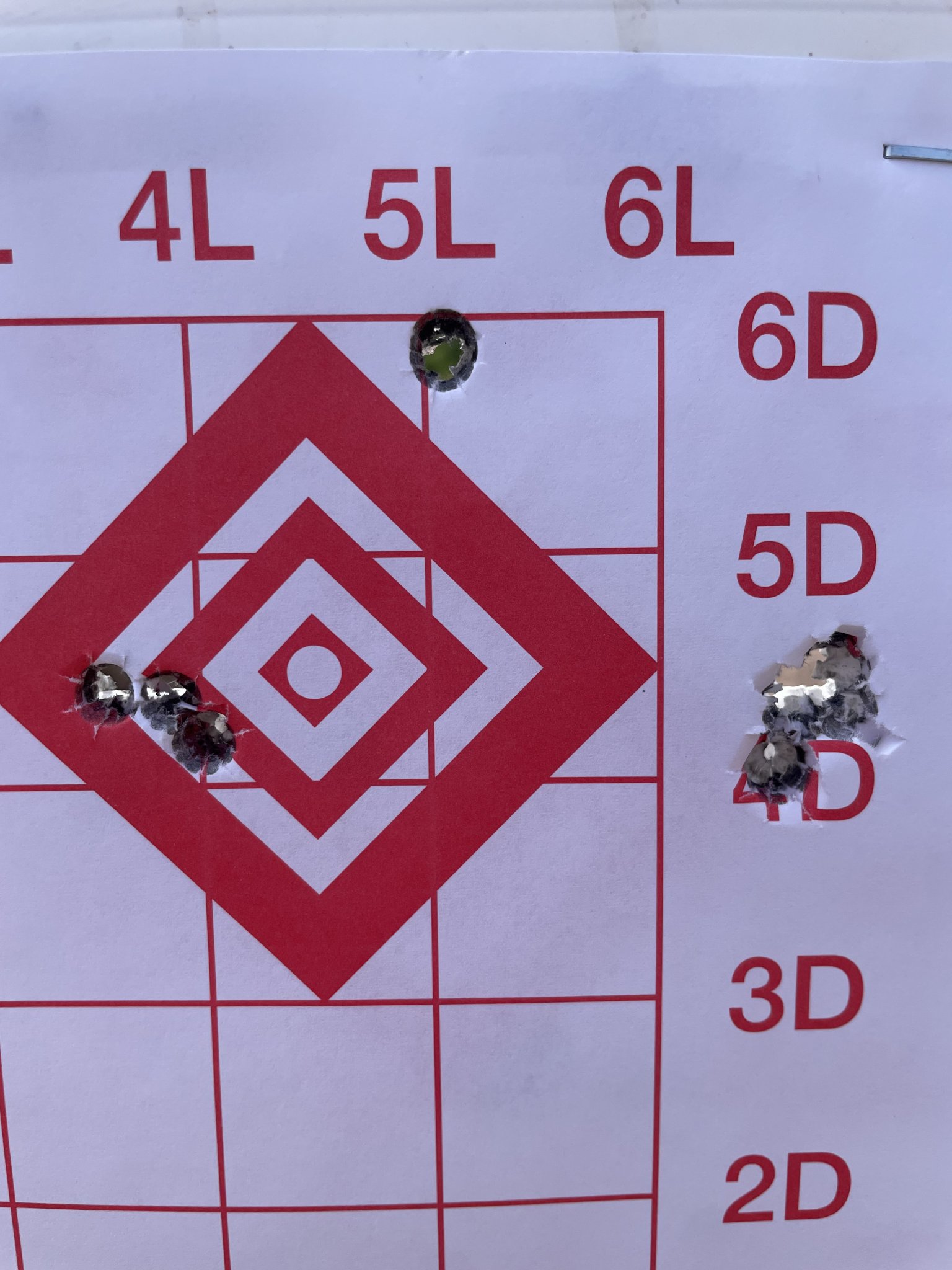

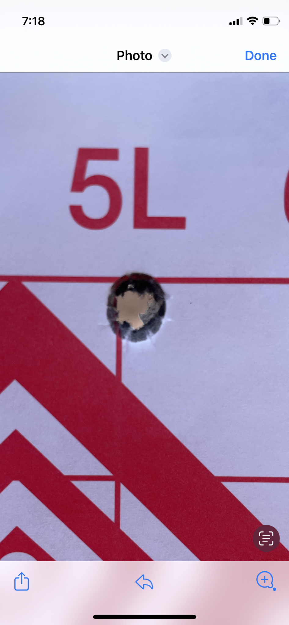

Glad to see this thread getting some views 😂😂😂. N570 with Berger 190LRHT @ 3,000 FPS. Seating adjustment test. Under 5L is a 3 shot group, I didn’t have the balls to shoot another round into that group. This load has made 2nd and 3rd round hits on a 1/2 ipsc at a mile. So far I’ve only managed to blow up my hand, lost an eye, and blew up an action. Blowing every primer and using a rubber mallet to open my bolt. Only getting 30 rounds per barrel.
