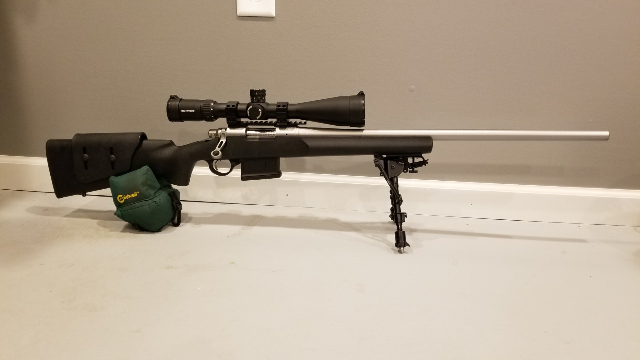

Hey guys, went out and shot 25 rounds today at 150y & im incredibly frustrated..... i shot 5 shot groups and had 3 on spot then 2 shots that went 1-2 inches directly left of the group almost every group, WTF am i doing wrong? Do i need to work on load development or me?
Im shooting a....
Rem 700 5R Milspec .308 off a
Harris bipod w/cleats and rear bag....
168gr SMK
Varget
Lapua brass (neck sized)
BR2 primers

This is what i was using.....

Nice stick

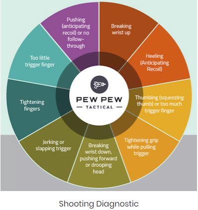

That's a cool chart for pistols and possibly offhand rifle shooting, but I'm not sure it would do much for rifles when prone or on bench (it would be backwards if anything). The fulcrum points are very different: pistol is around the grip, which means forces to the right move muzzle right and vice versa. So being to far right on trigger ("too little trigger finger") would move muzzle left. On a rifle, prone with a bipod, the forces are reversed at muzzle: pushing left on but stock would cause muzzle (and bullet) to move right.
I fight misses high left also and I've isolated it to three aspects of my prone technique (right handed shooter):
-Too much cheek pressure : moves comb down and right; muzzle up and left. Fix is less cheek weld pressure.
-spine/shoulder pointed right of target (not inline enough with recoil); miss left. Fix is better sqauring behind rifle and pulling left back (to square shoulders to spine)
- too little rear bag squeeze/ pressure or settling (recoil pushes butt down and muzzle up). This is a tough one to control with a sloped buttstock vs a flat rear stock slider.
On a side note, I do think it would be cool to develop a chart like above for common prone rifle POI shifts.
Hope that helps!

It is for pistols, but the principles still apply. Pretty rare that you are dropping shots with a rest or bipod, but left, high and left, almost always the trigger finger.
Agreed that trigger plays a part but pistol has two points of contact: hands and trigger finger. A rifle has 4+: trigger hand, trigger finger, shoulder, cheek and you could possibly include bipod pressure. All four/five have to work in concert exactly the same way for each shot in order to get shot on same POI/POA.
We are generally shooting 1.5-3lb triggers on 10-15lb rifles (1/5th to 1/10th the weight of rifle).
Compared to a 4-6lb trigger on a 1-2lb pistol (trigger is 3x heavier than pistol), the mechanics are not the same and the source of misses can come from other areas besides trigger finger.
There is a reason bench rest guys shoot free recoil and only manipulate a trigger without touching the rifle. They specifically need to remove the body and recoil management as a source of error.
I'm not dismissing the idea that trigger control is important; quite the opposite in fact. But you need the other points of contact exactly the same to ensure solid, consistent groups with same shape each time.
Agreed?
