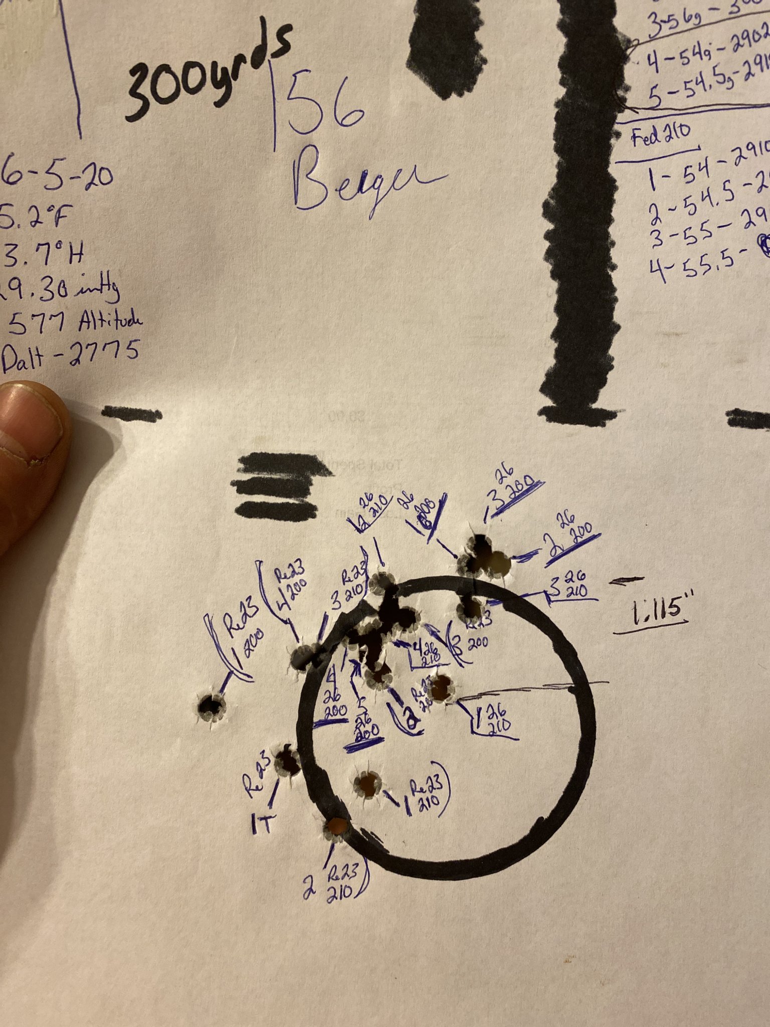

With my precision long range stuff I will shoot 300 or 600/650.....depending on the bullet and how good of quality they are. Hornady eldms I can find what I need at 300, Berger or lathe turned copper bullets 600/650.
I will find what powder charge I want start at and a generic seating depth......I typically start at .010” off with every bullet and wherever I start at with the powder charge I then go .5g increments up until I see pressure signs....1-2 bullets per charge. I will also load some of the lower charge weights to get on target where I want and get initial velocities. I hang a large piece of paper at either of the ranges, I have the point of aim low and watch the bullets migrate up on the target, horizontal don’t really matter at this time but vertical is what your looking for, I also put a camcorder down there pointing at the target to watch later where the bullets go and mark them accordingly to shot #. What I look for is velocity and the spread of the bullet holes, I choose to load where the velocity es is the closest in between shots and the bullets are close to each other. I then pick somewhere in between the .5g powder jump where I want my velocity and then start seating depth tests at 100 yrds, once I get what I like there I move back to 500+yards and shoot for groups with promising loads with consistent es/sd #’s.
I generally do this with differing primers and powder at the same time, cci or feds is generally always going to give you something with whatever powder you decide. If you don’t like what you see, try a different combo, you will know if the primers don’t work with your choice of powder, you won’t get what you want or like what you got so then I would move to a different powder and repeat the process all over again.
It’s like a hopped up Satterlee test. Ryan Furman at Long Range Only had posted this method that he came up with and I haven’t looked back, it’s easy on everything. He has a video on YouTube on what I described. I do something’s a little different but not too much. It is also possible to use this method and not need a chronograph.

I’m not trying to argue with anyone, bad mouth a proven process or discount anyone’s process but for new shooters/reloaders, even older shooters/reloaders the process that Ryan came up with works every time without a doubt.
I’ve tried the 100 stuff to start out with and it worked but why work hard at something that you can change to make it easier to decipher. 100 yard stuff CAN be a mess, you CAN come up with something but you test it out farther and it falls apart, why not do a little load development at the actual range you intend on shooting to, practice at those distances to get used to the environmentals and to get used to reading those environmental changes?
Give Ryan’s video a watch and keep an open mind of what he’s saying and telling people. I’m not saying anyone is wrong with their process, some don’t have access to land like I do but if I can improve on something and it works time and time again and is easy I don’t mind sharing for new guys to learn, choose what works for them in their situation.
I included a 300yrd target from my prc......there’s holes there that if I was at 100 yards there would be no way to tell what is what with .5g increments to boot, barely could at 300, so I moved to 650.
Some of you are WAY better at reading 100 yard targets than me, great, keep up the excellent work and keep doing what works for you!
