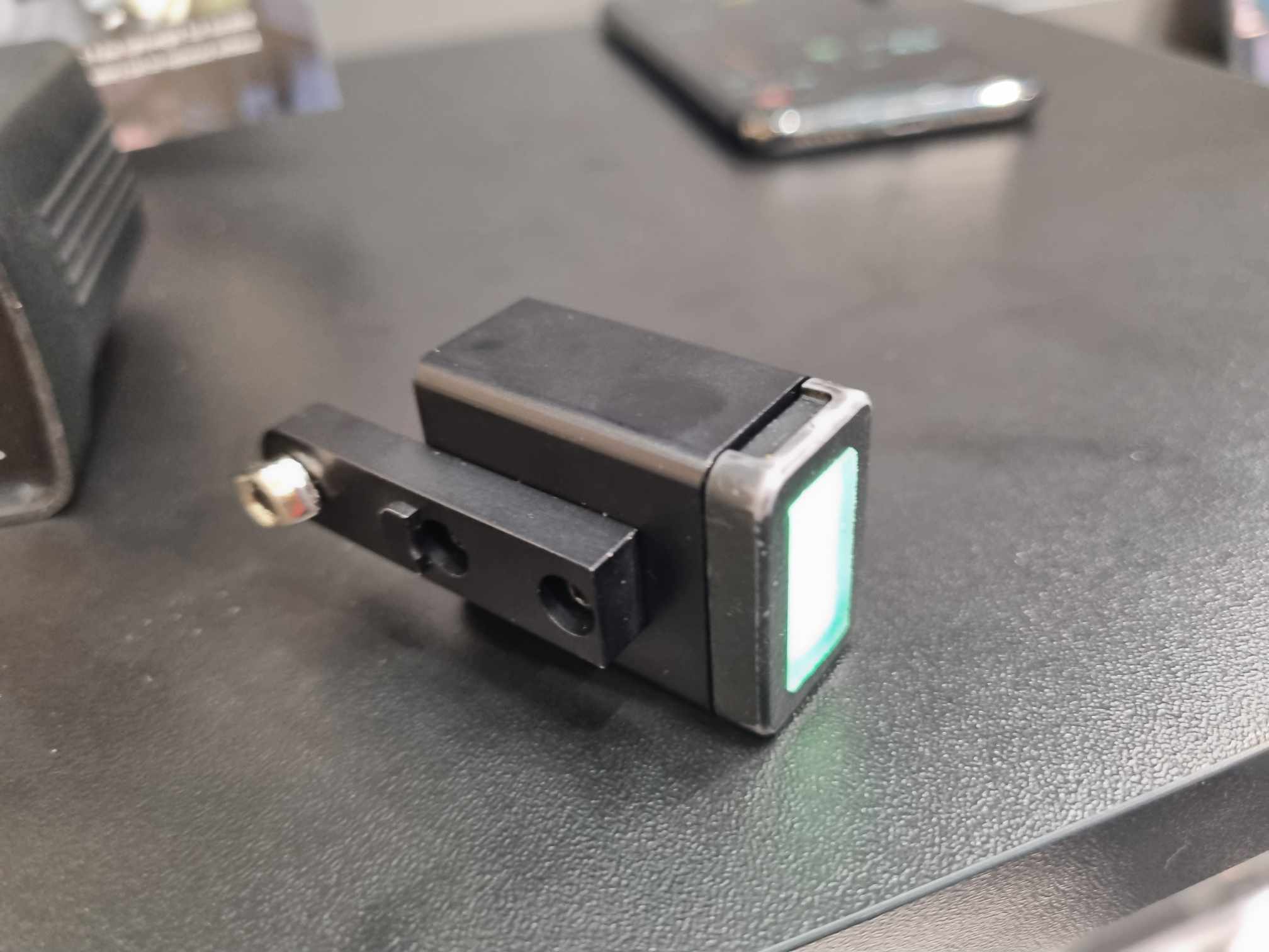

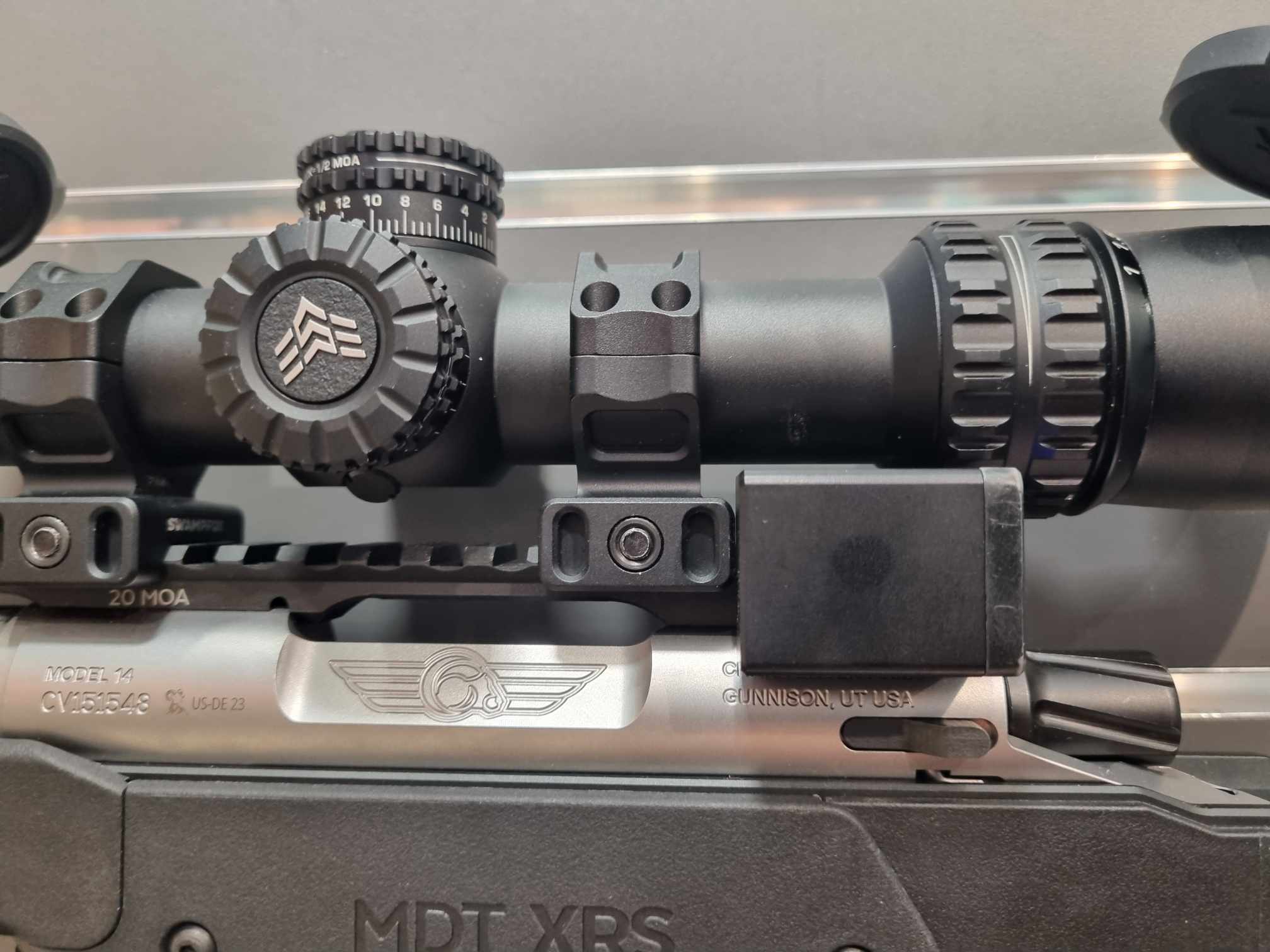

    SG Pulse electronic level presented at IWA seems that it will be eating the MDT/Send it level for breakfast and doing it for 150$.
    Given SG has great timers as well i suspect some time down the line we might see a unit linked to their existing timer with some audible countdown function.

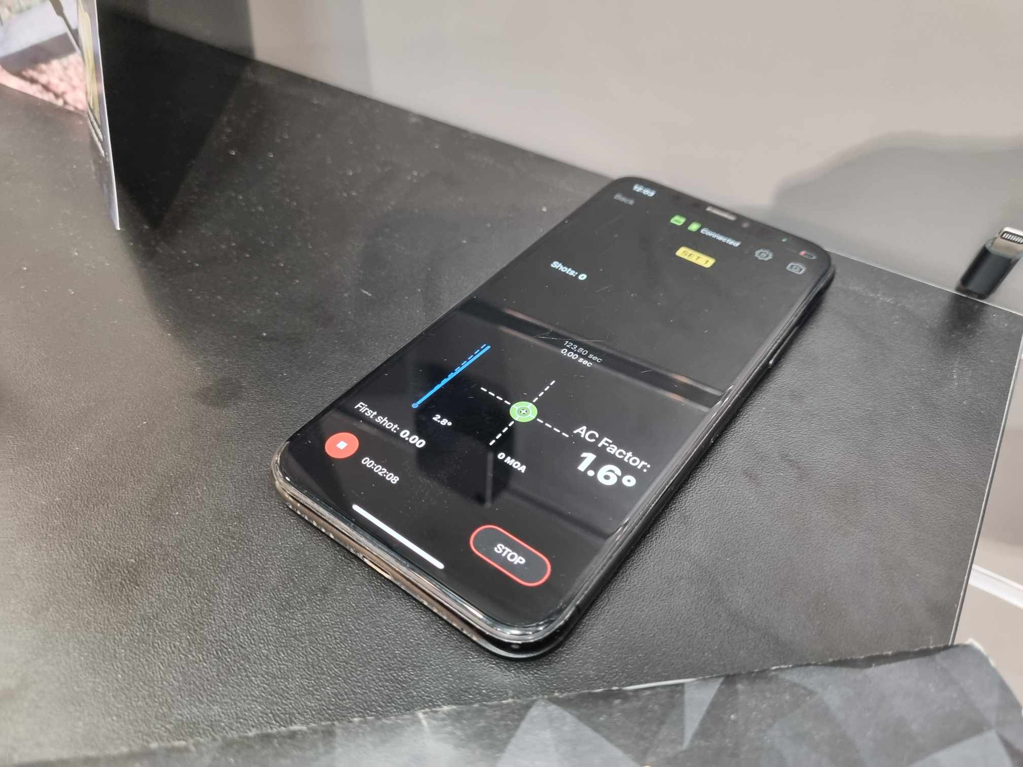

    I honestly don't really see the use of the ACI being that it only displays in the phone/app, same for "stability". The price difference between this and the Send It is the difference between US manufacturing and chicom manufacturing...
    The prone app features are not as much meant for real-time uses, more for analytics and remote programing and like said given they work with blue tooth i would be supprised it they are not hooked to their timers next.
    This device is magnitudes more complex than send it . These are manufactured in Poland EU ,not China
    If you'd order ''send it'' with chicoms with the same exact electronic components and OEM cost would be in the low 20$ range.

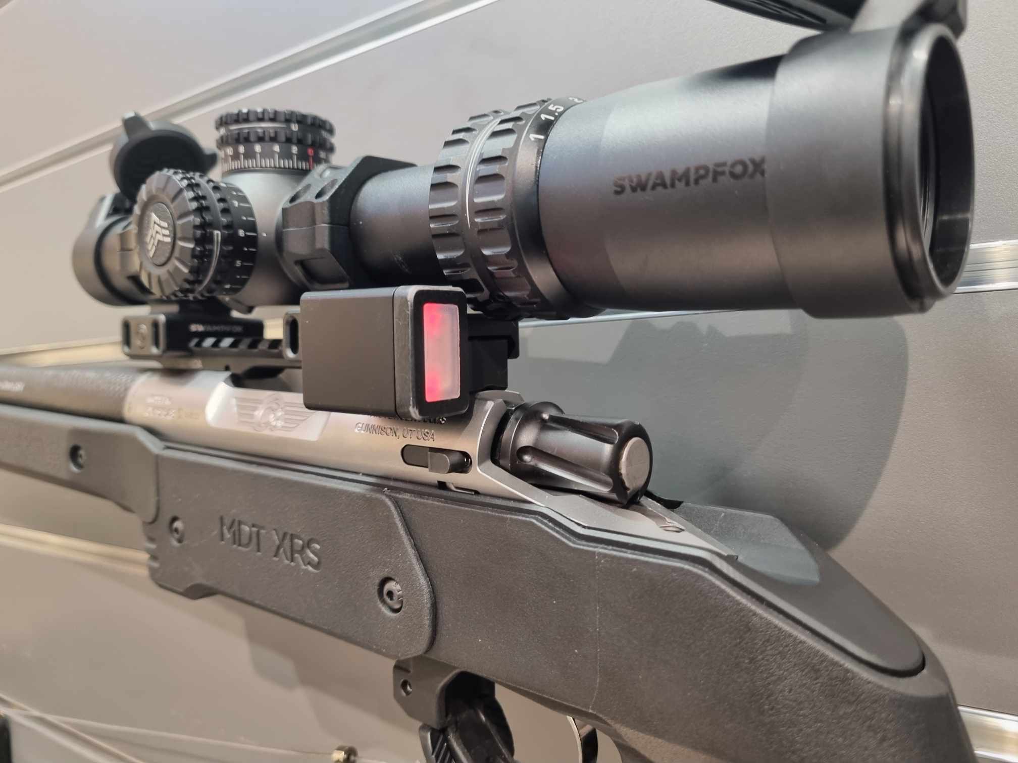

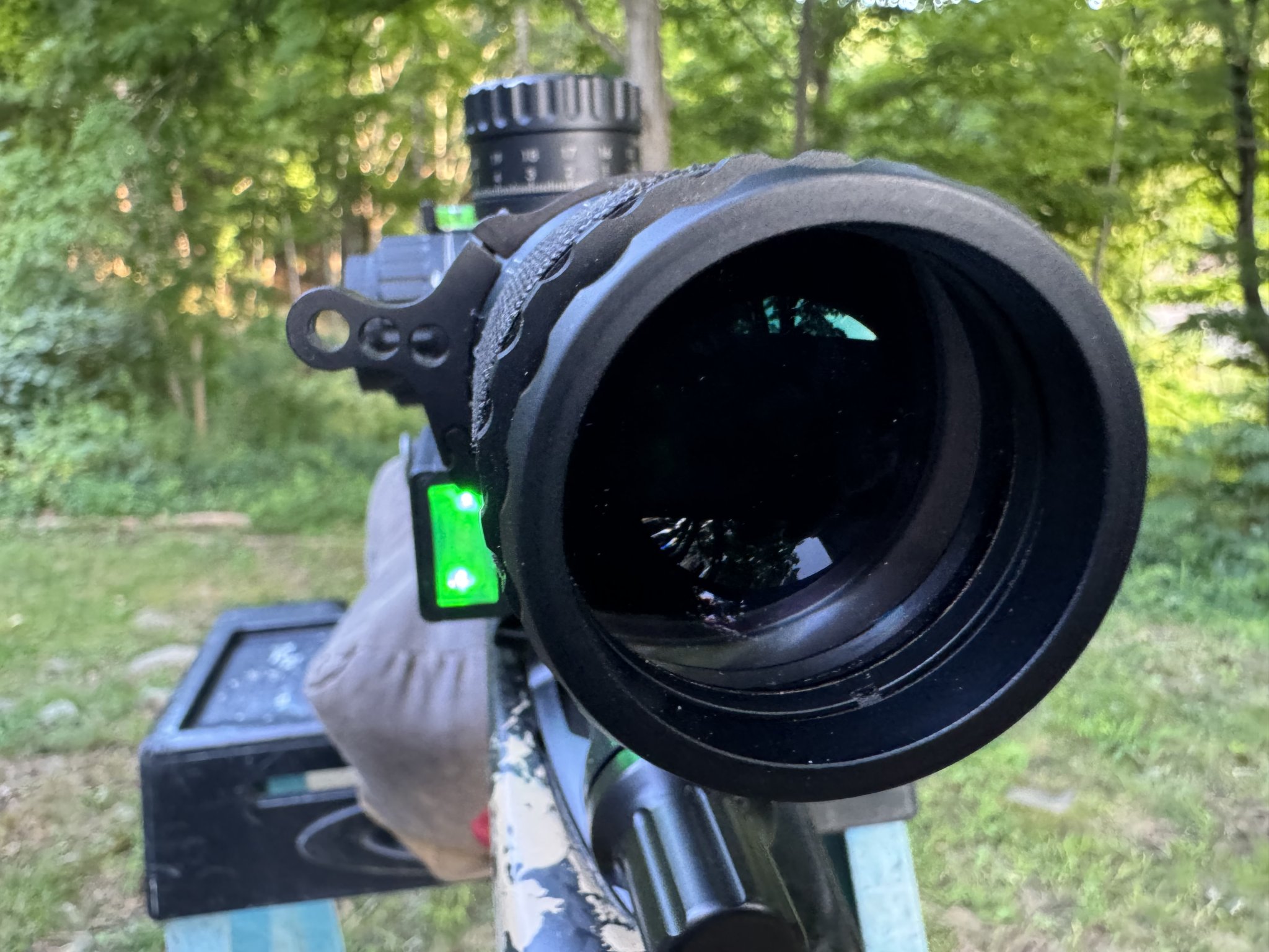

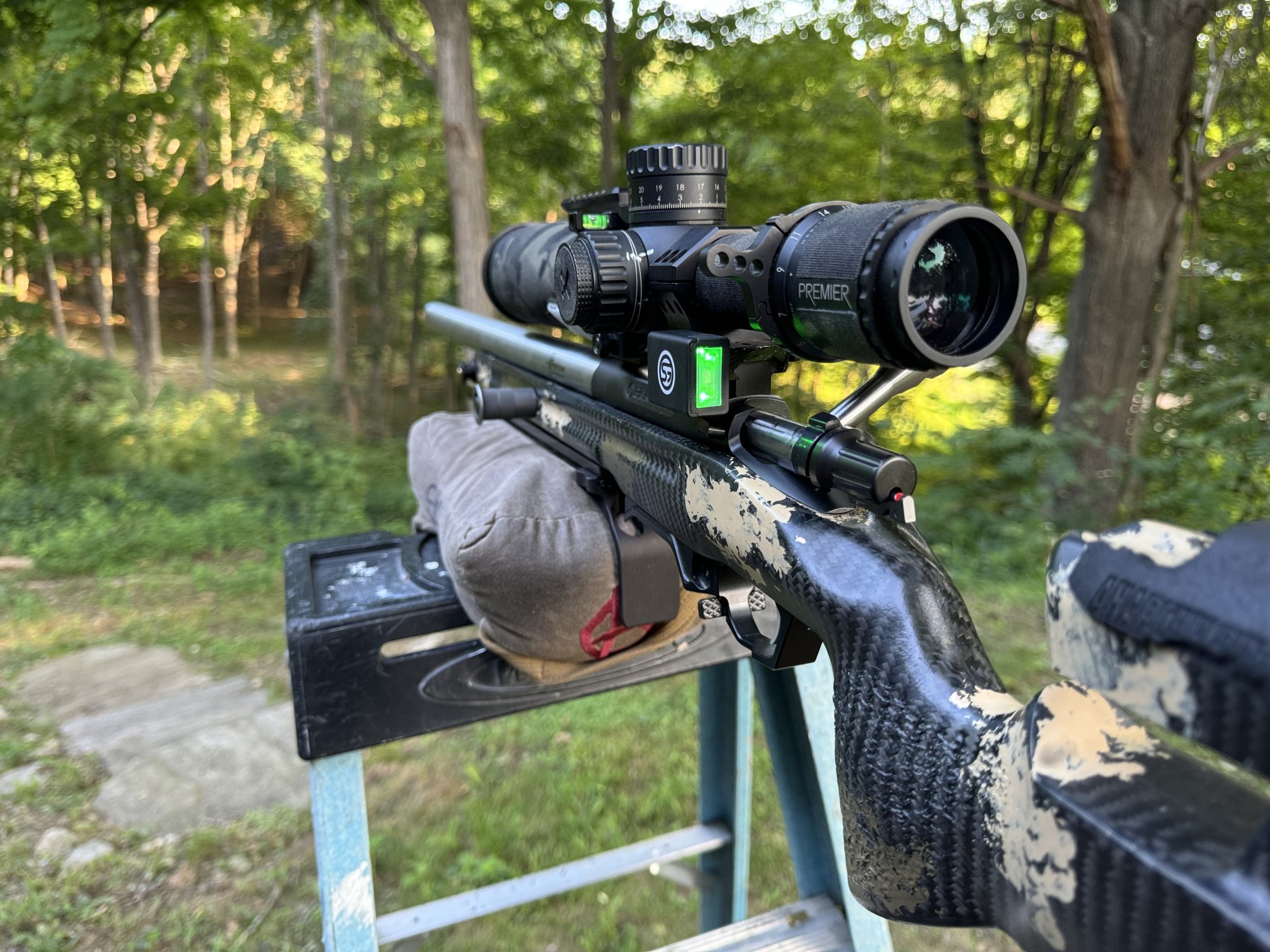

    I ordered 2 when i first saw the preorder, I received them today and started messing with them. I run a send it with a 90degree mount on my main gun, i have found so far that the send it is much simpler to just set up and go. The pulse seems to require you to use the app to get it setup, and the directions were vague.
    The size is smaller than anticipated, there are a ton of brightness settings which i found that level 3 is plenty bright for me. The mounts are very simple, i ended up cutting the picatinny mount so the bolt clears, which i had to do the same on the send it mount that i run in the same location.
    You can adjust the sensitivity of movement, so slight movements don’t make the level go crazy. You can also choose the degree of cant that you find acceptable for your green zone.
    The on and off is a long press and hold, once set up i really liked it. It is very obvious when behind the scope when you are canted or level. As far as i can tell, there is no indication for when you are getting closer or further from level like the 2 red and 2 blue lights on the send it.
    I am hoping sg comes out with some other mounts, or maybe some other companies can. Because, on one of my rifles i have no space on the rail behind the scope rings, and the pulse doesn't stick far enough off the mount to clear the erector housing. So i currently don't have an ideal solution to mount it on that rifle, other than the hawkins diving board.

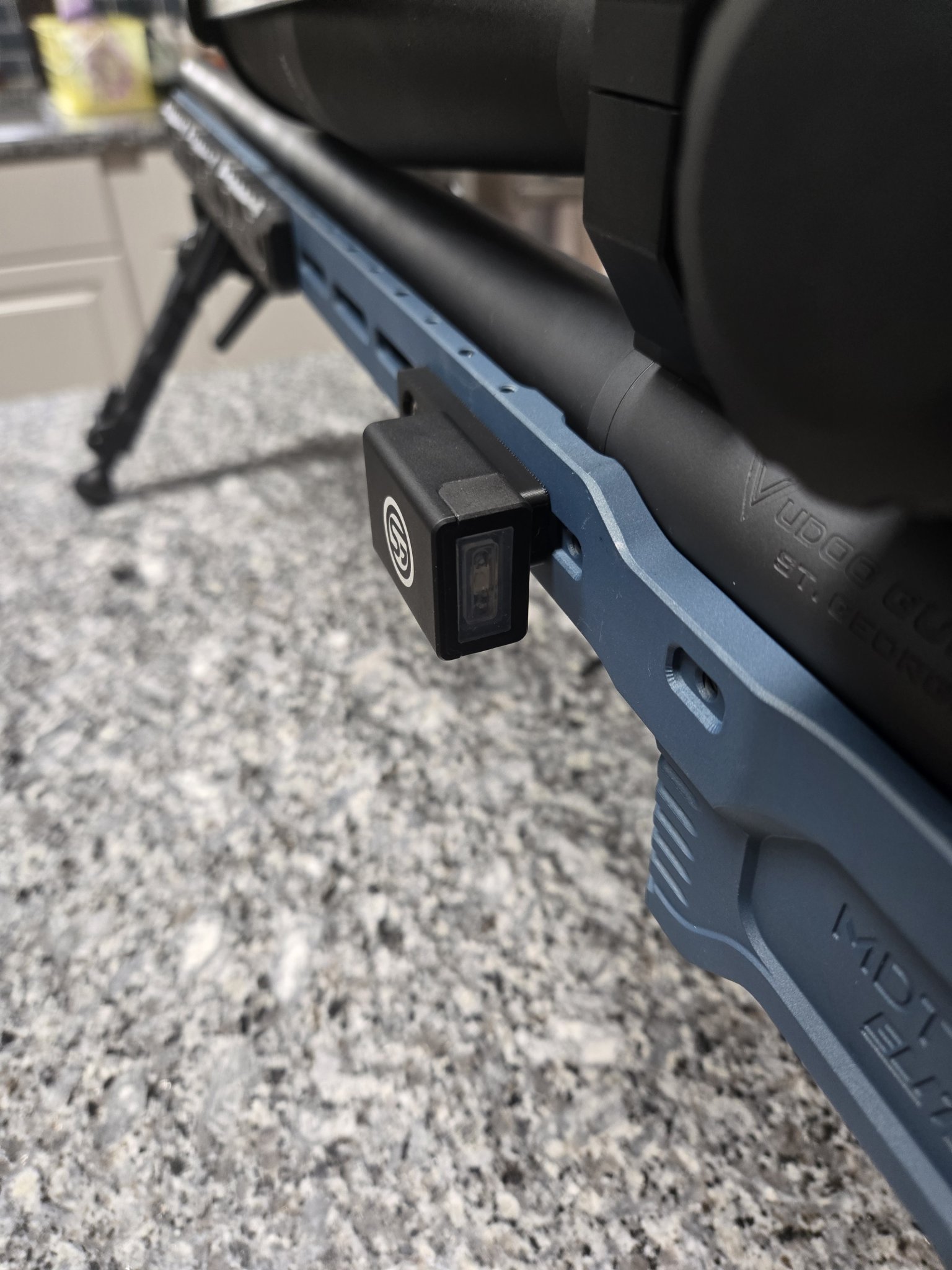

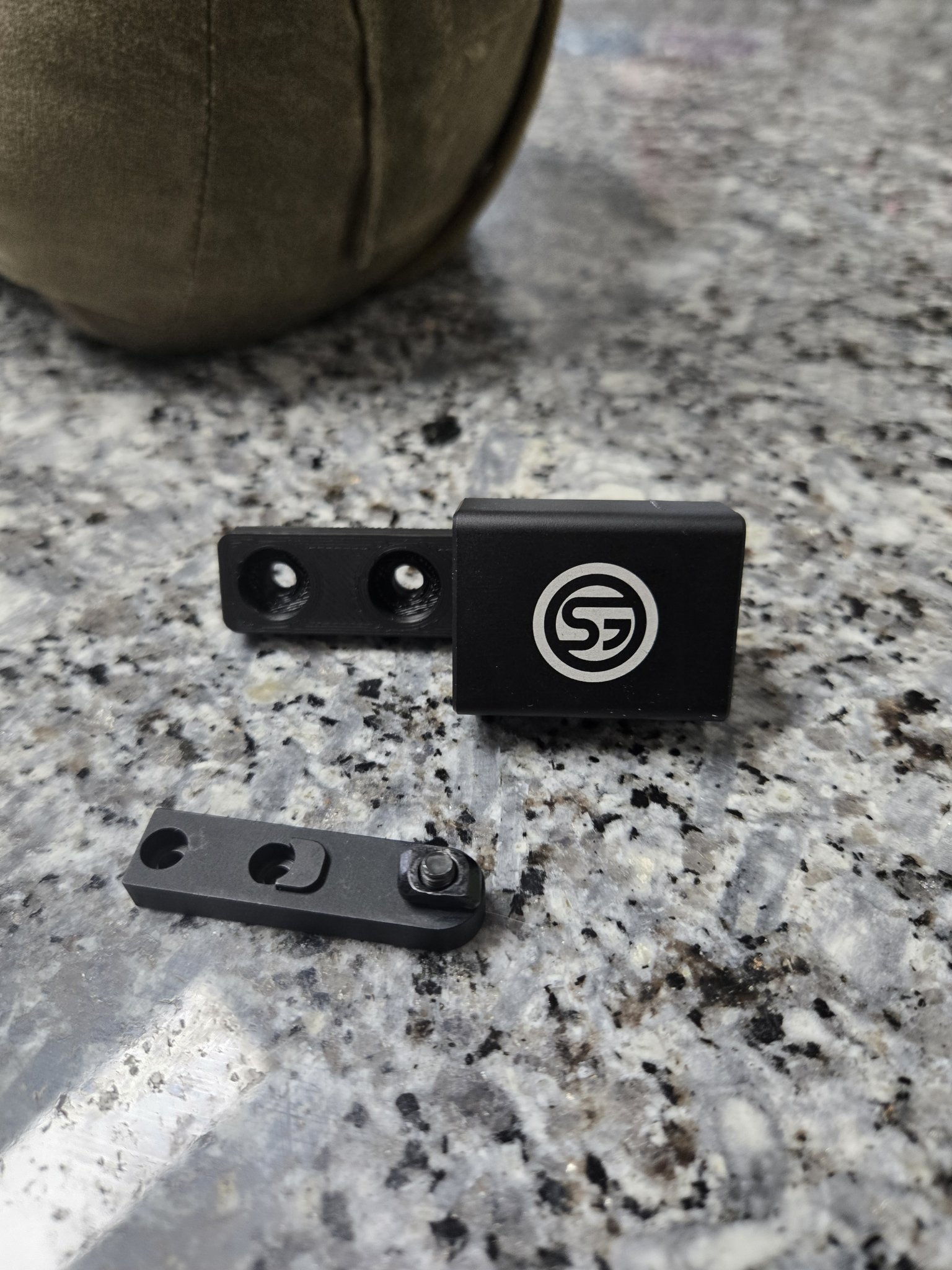

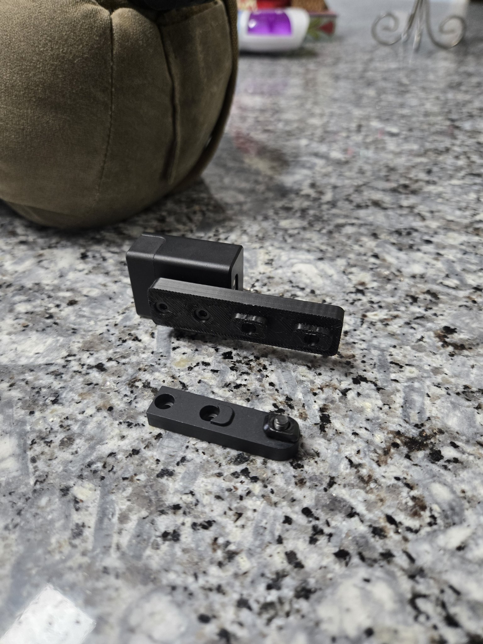

    I received my SG Pulse level today.
    First impressions: the instructions are a joke. They are severely lacking in detail. It seems like there's a couple modes that can be entered via different (long vs short) button presses, but no explanation of what those modes are or how to use them. The m lok mount is trash. The t nut is grossly out of spec and doesn't lock up well. The pic mount uses a thumb screw instead of a cap screw to secure it to a rail. And the charging cable is proprietary. Who doesn't use USB C in 2024?
    On the positive side the unit itself seems well built. It's compact and tucks nicely against the rifle. Setting sensitivity and calibrating the level are easy with the app. The led is plenty bright and can be adjusted for brightness. Time will tell how it holds up.

    We apologize for the issues with the mounts. We are aware of these concerns and are working on offering more robust mounting options in the future.

    I've had it for about 2 months now and have been able to use it in practice and a match. I have no experience with Send It, so I can't compare it to that.
    My only complaint during match use is that it turns itself off between stages and I forgot to turn it on before a stage because I assumed it was on. They claim battery life of 50 hours. It would be nice if the time out time could be adjusted.
    To @Turbwhistle's point about knowing how far off you are, some of that can be dealt with by changing the sensitivity range of the unit.
    Compared to a bubble level, an electronic level is faster to react and easier to know when you're level.
    As much as I bitched about the mounts and the instructions, now that I have it figured out I like it quite well.

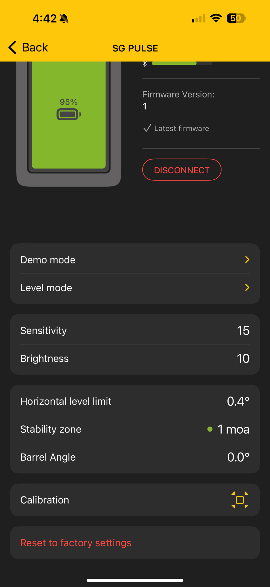

    Picked one of these up. During practice, it seemed like a great solution until the calibration drift became evident. Using it in a match last weekend was a disaster.
    The unit I have (firmware v5, after an update), will not keep its calibration after 1-3 power cycles. When mounted vertically oriented (picatinny mount attached to top rail) sometimes it's a single power cycle, sometimes is 2 or 3, but inevitably, I have to recalibrate it at a frequency that's just not acceptable. I outline my reproduction of the issue below.
    If I change the mount so it sits horizontally (on a picatinny rail on the side of my Spuhr mount visible below the parallax knob) it will completely forget/lose it's calibration every power cycle.
    Additionally, there's no control over the auto-off timeout (30min). The unit auto shutdown just before 2 stages in the match as I was trying not to power cycle the unit to avoid recalibration between stages.
    I'm debating exchanging the unit, or just going back to the Send-It.
    Reproduction
    To verify the drift Id do the following:
    1. Level the rifle using the in-set level in my Spuhr mount
    2. Calibrate using the app while the rifle is undisturbed
    3. Confirm the calibration was set by canting the rifle left/right and returning to level as indicated by the Spuhr in-set level
    4. Power the device off
    5. Power on
    6. Cant the rifle left/right and return rifle to level using the Spuhr in-set level
    7. Repeat steps 4-6 until the SG Pulse did not indicate green when the rifle was level as indicated by the Spuhr in-set level
    8. Check the App > Device > calibration
    9. The calibration would be off by >1°
    EDIT (10/18/24) - Adding some additional insights
    • There is no way to power the device off via the App
    • Manual power off forces the unit from "Level Mode" to "Stability Mode" (or vice versa). The unit then powers up in the opposite mode of previous use case.
    • I tried resetting the unit to factory settings via the App and the calibration drift/loss still reproduced
    • When changing the "Horizontal Level Limit" you must immediately recalibrate after, otherwise it distorts the saved calibration
