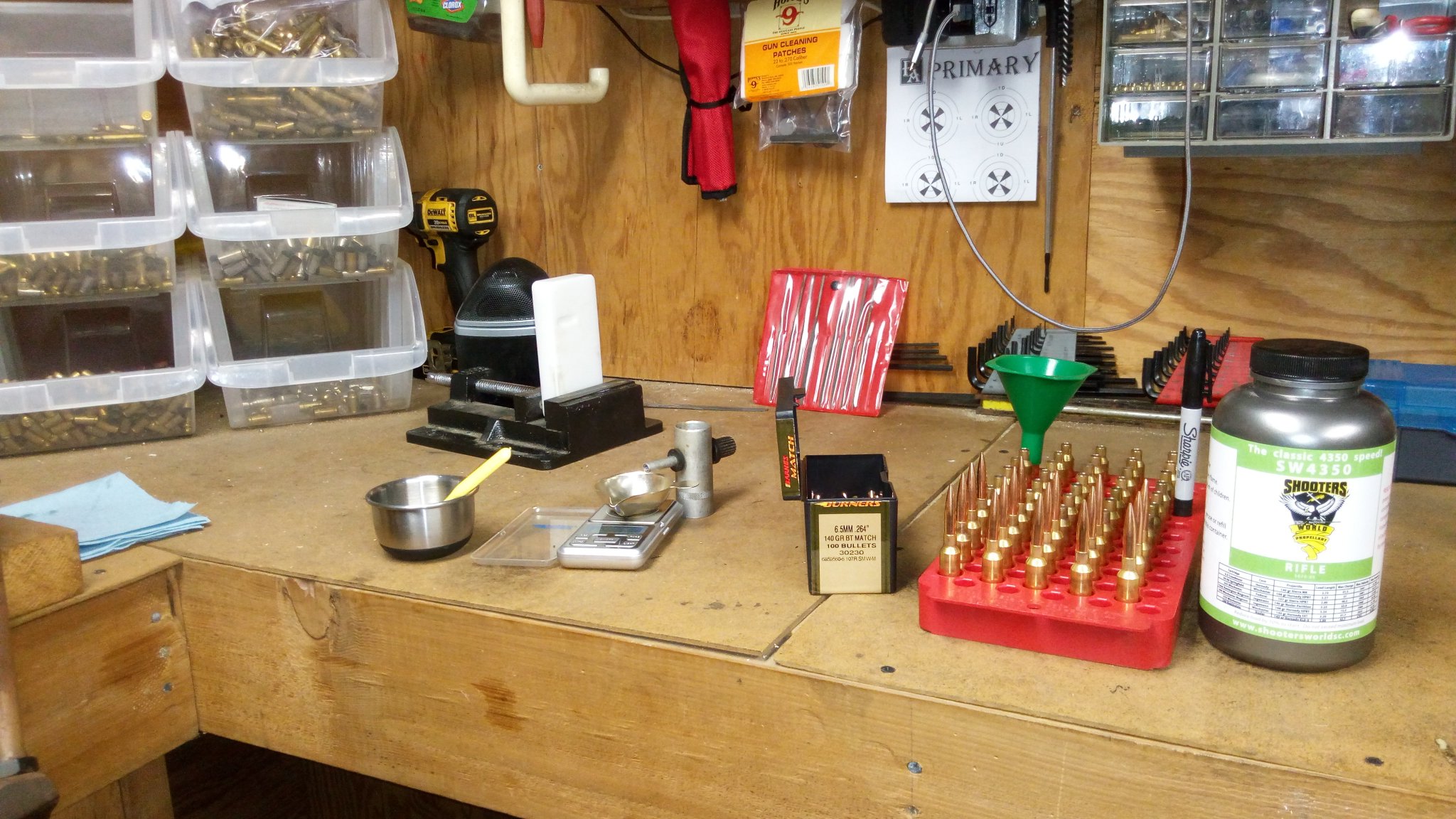

Hey fellas, I'm new here but hope I'll have a little to offer to the community as time goes on.. I'm very much a student of the game like most of you.. a master of nothing except bating ;)
Anyways this is a fairly newer offering to the best of my knowledge and very affordable.
SW4350, I'm just starting to work up a 6.5 CM load with it using Barnes 140 MBs, Hornady brass and CCI LRPs
It will be shot out of a brand new bergara b14 hmr.. I have no answers about the powder yet but hope to be able to provide some feedback and a short term review
I welcome anyone else who has used it to add imput here if they like, hijack away :)
Was about 20bucks a pound shipped if anyone wanted to know..

3 of us each got a pound and tried to duplicate our loads that we are already using successfully with H4350. Everyone of us saw the same thing almost 200fps drop with the same charge weight. 260, 6XC and 6.5 creed It's not even close and adding more powder to get back up to our speeds way offset the cheaper cost.
