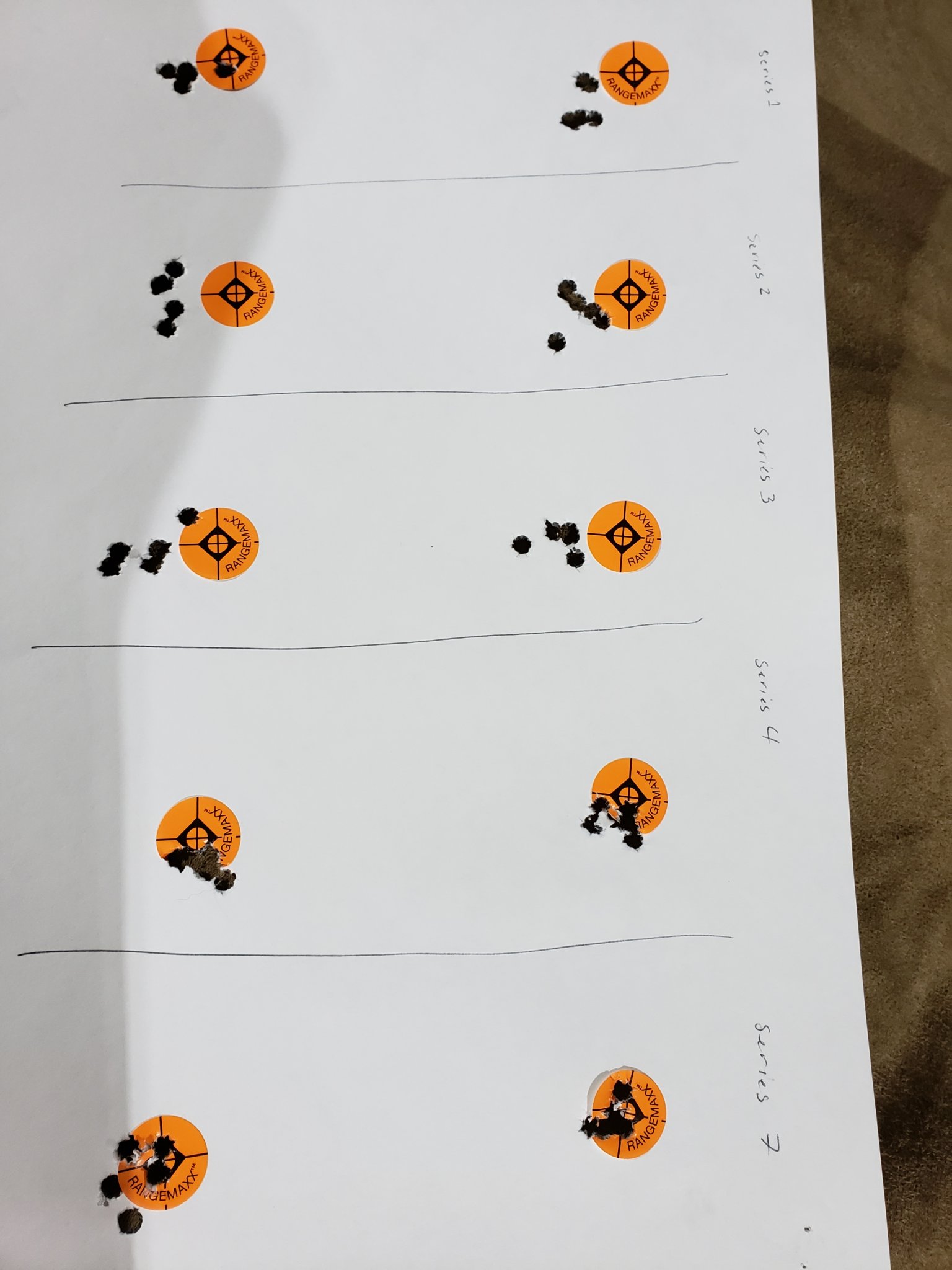

Shot SW4350 2 days ago and did a direct comparison on charge weights to H4350. I run 40.6gr of H4350 for my match gun behind a 140ELDM, with CCI BR2 primers in Peterson brass. Build is a TL3, 26" RCB from PVA. Labradar, sitting at 6k' above sea level, and in 50-degree weather @ 100yds.
Usual results are:
Stats - Average
2780.91​
Stats - Highest
2784.37​
Stats - Lowest
2776.14​
Stats - Ext. Spread
8.23​
Stats - Std. Dev
3.02​
Here are the results of the SW4350 (10shot strings, loaded exactly the same as I do my match loads):

The only reason why I did this test is because of the dry up of H4350. I'm looking at alternatives. No pressure signs are seen on any of these loads in my gun, and bullets were seated +/- .0005 off the lands. Accuracy with SW4350 wasn't "great" ie, all loads around an MOA which I consider pretty bad. My H4350 load shoots in 3's usually at 100yds with the 40.6-41gr of H4350. Now, Staball has caught my attention, and I like it because it flows through my dillon. I did not load these 2 series on the dillon, but I am going to pursue it further.
On the other hand, SW Match in my 24" 1x7 223wylde AR is a match made in heaven. I also have SW Precision and my 6br so far is not a fan.
Just want to note that the above data that posted was the first try at sw4350....I had the same problems with H4350 with this gun shooting patterns until seating depth was worked out. So just take it with a grain of salt....I will work up the charges in 3 shot strings, with .3 gr increments until I hit pressure with sw4350, but I'm digging staball...

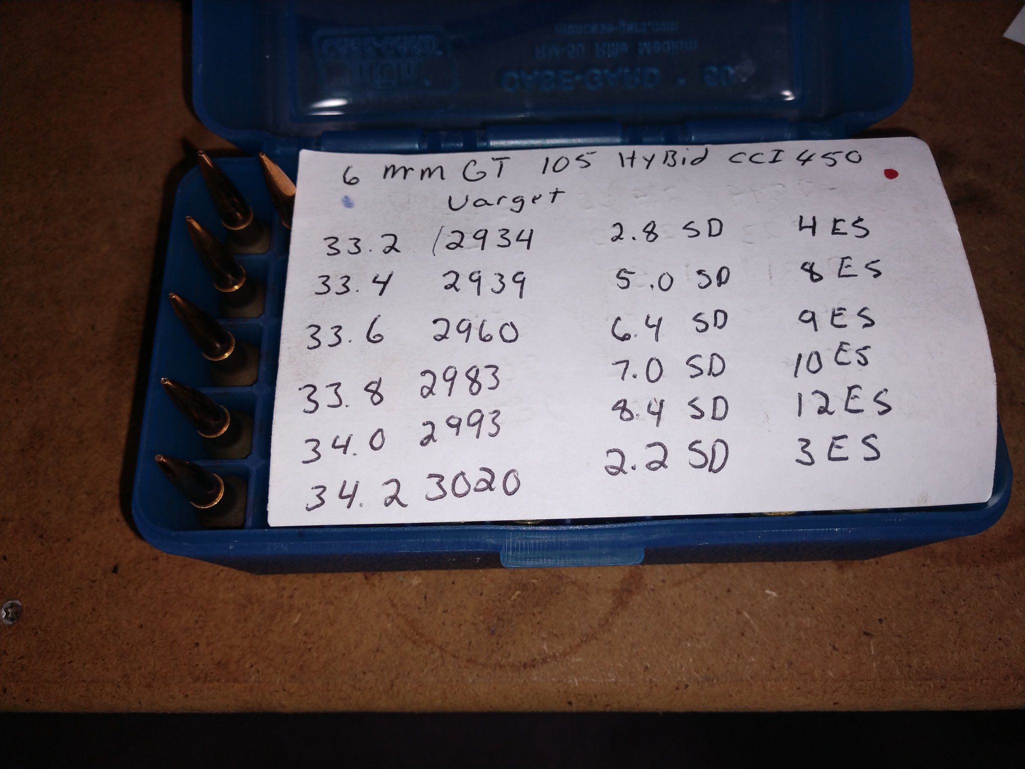

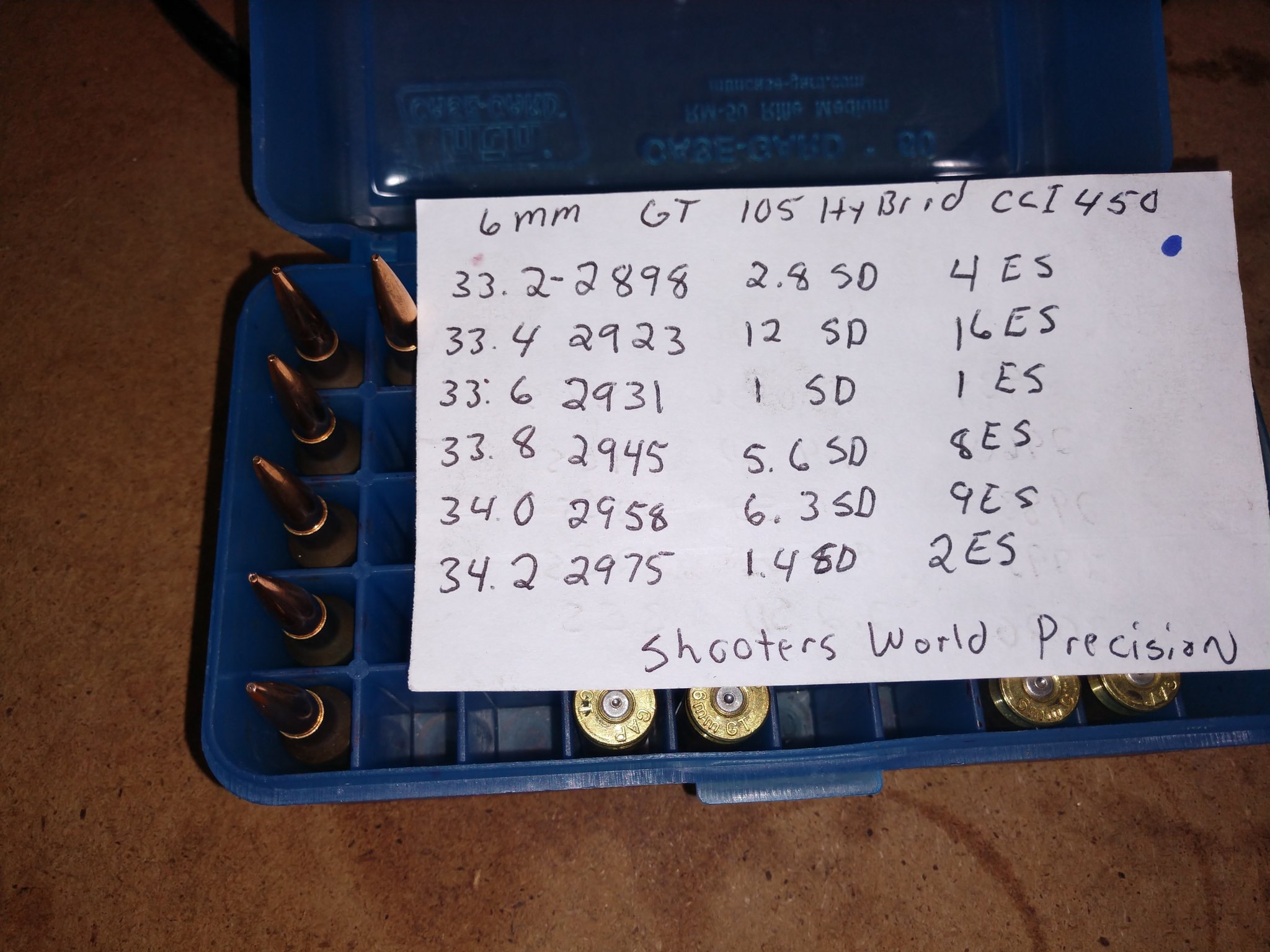

Precision was 30-40 fps slower than Varget of the same charge in GT. It did produce some great SD/ES with nice groups. I think it's a good option of you can't get Varget.

Made it up to the range with the 6.5cm with the SW4350. Loaded in groups of 2. No pressure signs up to 43.6gr at 6k above sea level. I needed something to do while the barrel cooled on my tac6. Only did 2 shot strings, i know...I'm lazy....140eldm was the bullet.
Shot​
ID​
Match Load​
1​
2786​
43gr​
2​
2659​
3​
2649​
42.7gr​
4​
2634​
5​
2645​
43.3gr​
6​
2668​
7​
2671​
43.6gr​
8​
2713​
9​
2677​
