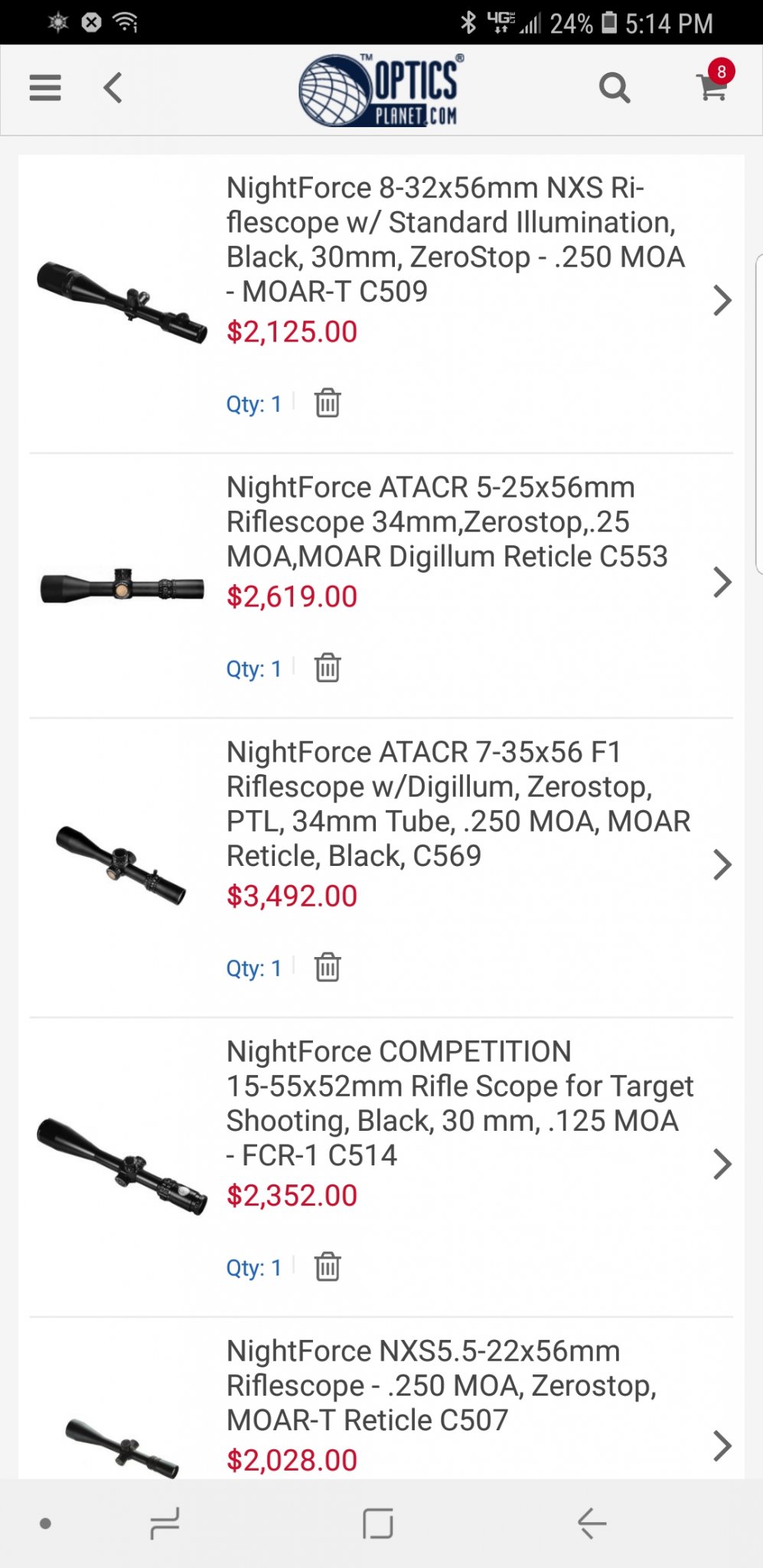

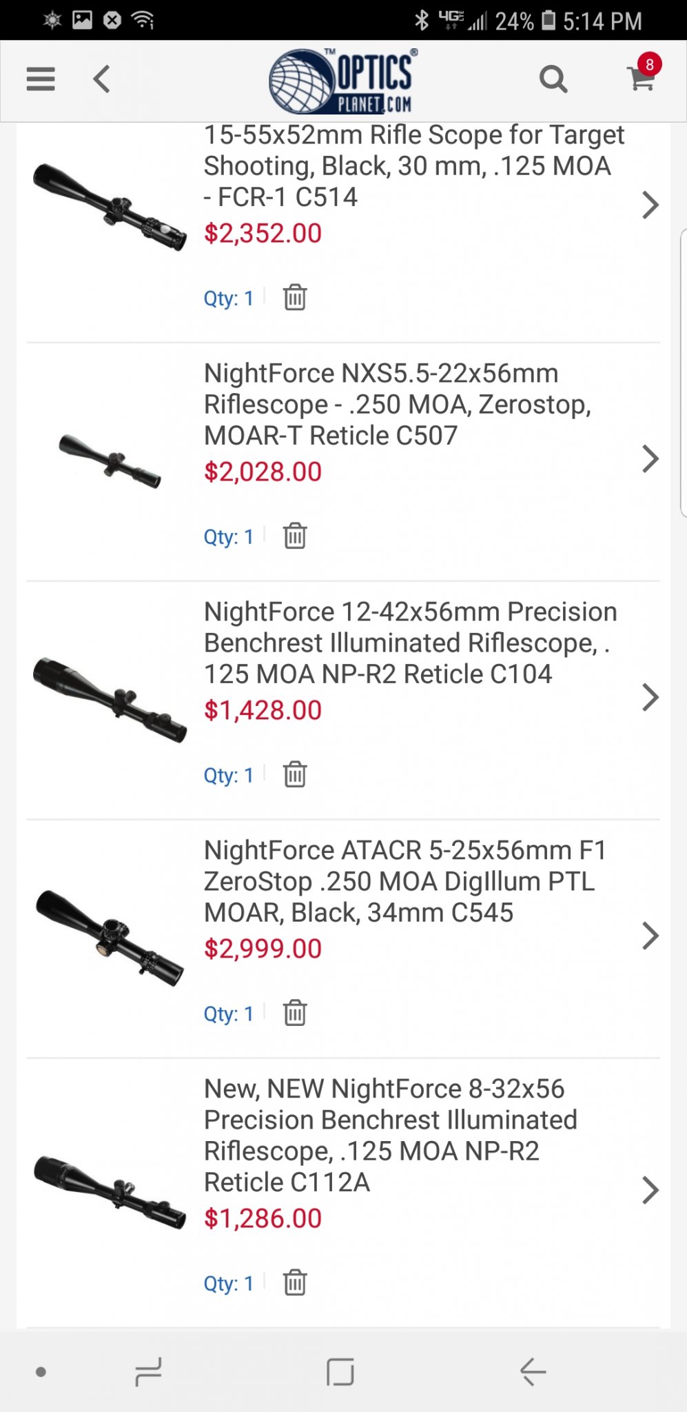

Hi everyone,
Sorry this is so long. Ive tried researching for myself for the right scope and because of all the articles I read Ive gotten more....overwhelmed than I should be... if thats even the right word.
I just recently splurged and grabbed a Desert Tech SRS for a steal. It comes with 4 barrels:
.243 win
.308
6.5 x 47 Lapua
.338 Lapua (This will most likely be what I shoot for the mile, though a shot with a .308 would be epic)
Ive never shot a mile before, 960 is my record and that was with a friend's setup and a few days out at the range to get used to it and work up to the longshot. Ive been looking at Nightforce scopes since, well I dont think I need to go into all the reasons. Weight isnt an issue (since I know most high powered NF scopes are rather cumbersome) since Ill be shooting prone/bench. From what I gathered, ATACR has better glass, better reticle, etc than the NXS line. Is it worth what seems to be an extra $1000? Im not going hunting with this setup, its strictly shooting in daylight at targets. Im fairly certain Im buying from optics planet because they have the best deals overall. The problem is, all the scopes range from $1300 for a 8-32 power to a fully loaded 7-35 for $3500. Then there's the twenty different reticle options. Its overwhelming, at least I narrowed it down to Nightforce....They all have the same objective at 56mm.
I suppose the question(s) is, can I get by with a lower power like the 5-25 so I can use it to comfortably shoot below 500 yards and still use it to hit the mile?
2. Is the ATACR worth the money even though I dont need extra illumination because I wont be hunting with it?
3. Which reticle should I get? Its alot for what seems to be very similar patterns. I dont mind a busy reticle, I just need to know its worth the excess.
Other questions that may or may not belong here...
4. Should I buy a desert tech scope mount or Nightforce? And should I go ahead and buy the 40 MOA model?
5. The bipod coming with the rifle is a cheap $15 model from someone Ive never heard, xaegis. Should I get rid of it and buy something like a Harris?
6. Cheapest spotter scope for the mile worth the money? There are some 50% off Barskas sub $200 with like 90x magnification though the reviews are substandard.
I also want to mention, Ill buy used if you or someone you know is selling their equipment.
Thanks guys!
DS

The only thing you need to shoot a mile is elevation really. Don’t worry too much about magnification. 5-25 is more than enough, especially if it’s sunny
Yes. I've shot 2000 yards with 14X (actually more like 12.5X, had to zoom back to expose hold over). I was still able to confidently aim a specific portion of a man-sized silhouette. 18X would be adequate, 25X would be more than plenty.
The ATACR F1 is awful nice, but you can get the job done with less budget if you want to. Figure the elevation you'll need for a mile (for example, I needed 80 MOA for a mile with 6.5CM at 4350", 100 MOA for 2000 yards), then pick a scope that has that. Scopes with 100 MOA internal elevation and not more than $3395 for the Nightforce ATACR F1 5-25X56 include:
Leupold Mark 5HD 3.6-18X44 ($2000) or Mark 5HD 5-25X56 ($2094 non-illum),
Vortex Razor HD Gen 1 5-20X50 ($1699 ) or Razor HD Gen II 4.5-27X56 ($2499),
March 3-24X42 ($2239) or 3-24X52 ($3299),
Burris XTR2 3-15X50 ($952 )
Bushnell XRS 4.5-30X50 ($1900) or XRS II 4.5-30X50 ($2097) or DMR II 3.5-21X50 ($1459) or ERS 3.5-21X50 ($1585 )
Kahles K525i 5-25X56 ($3299) or K318i 3-18X50 ($3199)
EoTech Vudu 3.5-18X50 ($1497)
Steiner T5Xi 3-15X50 ($2500) or P4Xi 4-16X56 ($1299) or M5Xi 3-15X50 ($3300)
Athlon Cronus BTR 4.5-29X56 ($1700) or Midas TAC 4-16X44 ($590)
Sightron SV 4.5-24X56 (not sure if released yet)
IOR Valdada 3-25X50 ($3040) or 4-28X50 ($2995) or 5.8-40X56 ($3390)
Sightmark Latitude PRS 6.5-25X56 ($700)
Hi-Lux Phenom 5X-30X56 ($637)
Trijicon AccuPower 4.5-30X56 FFP (MSRP $2675)
Minox ZP5 3-15X50 ($3200) or ZP5 5-25X56 ($2306)
Any SWFA scope (up to $1300)
(See the link in my signature for the full list of all FFP scopes with elevation, reticle and street price data)
Reticle is a big decision, and a very personal one. Take the time to compare and think about how you'll use it.
For a scope with 100+ MOA internal elevation, you're pretty safe with a 40 MOA mount. You're only leaving 10 MOA for mounting error and 100 yard zero, but chances are it'll work and give you the maximum available up, which you'll want for shooting past a mile.
Frankly, you may be better served with quality bags, like Dog Gone Good, unless you really want to do "practical" mile shooting.
Because of mirage, on not cold days, you might not be able to see hits with any spotting scope. Put a phone downrange and FaceTime with it? Our WiFi-based target cam couldn't stay connected at a mile. I don't have a good solution for spotting at a mile.
I have the ATACR 5-25 and man oh man is the glass nice. I have several NXS and NXS compacts as well and the glass is pretty good with those too but the ATACR is clearly a step up. I think a mile is doable with 25x if your eyesight is good. That said, I will eventually buy a 7-35 when I find one for somewhere under $3K.
As far as reticles go, the first step is to decide if you want to think in milrads or MOA. Personally, I'm annoyed by a busy reticle and I like the MIL-R.
