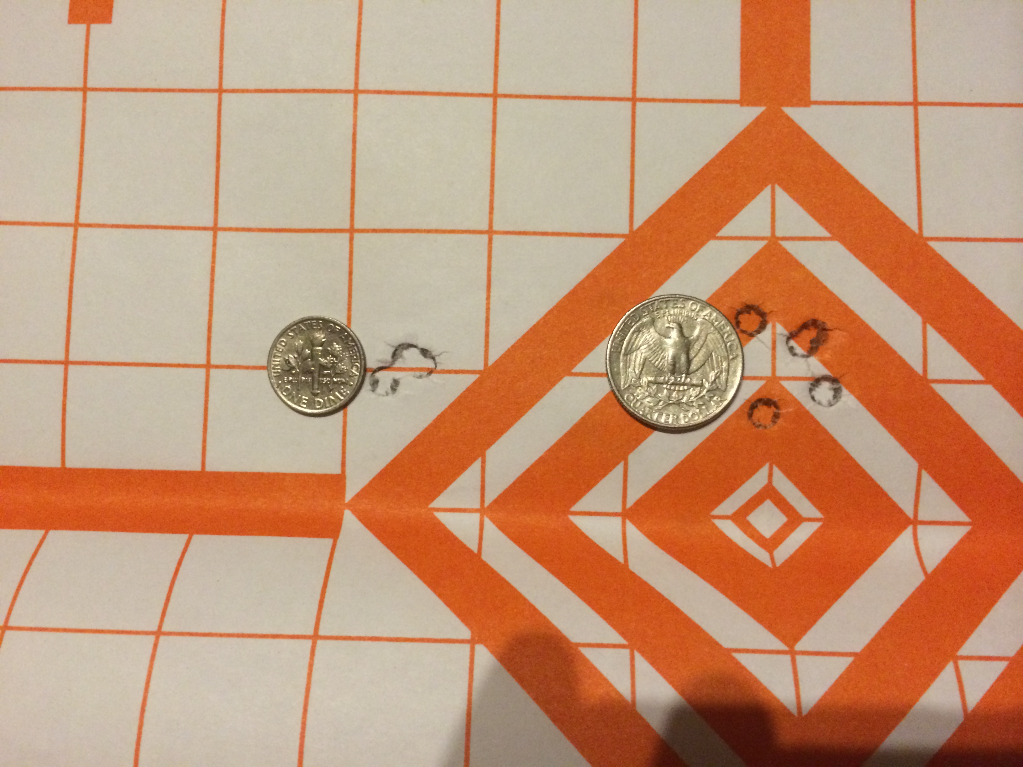

Update- it helps when you find a load that the rifle likes... :D
Still not fantastic shooting, but at this point I think I can blame myself (and the wind, a little bit) rather than the rifle. The above 100 yard groups were shot with Fiocchi 50gr V-max (and a pretty warm barrel); it just doesn't like my soft point hand loads or Hornady Superformance 53gr. I just need more trigger time (and perhaps a trigger upgrade) so I can get more consistent.
Prior to shooting these groups with the Fiocchi, I ran probably 30 or so rounds of my hand loads and 20 rounds of Superformance through it, so "seasoning" may have helped as well.
I should also note that after running 75-ish rounds through the gun, the bore came clean in about 10 patches with no brushing.
