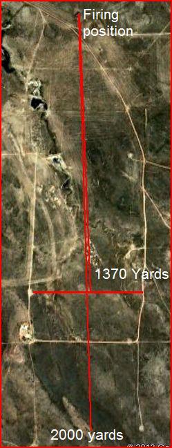

Ok so here is the deal, I am wanting to setup a target at 2000 plus yards on my own personal range that is accessible by truck all year round. My current 2000 yard range is is down a two track dirt road with no gravel or anything so when it gets wet out or the spring snow is melting, I can't get in there with a pickup without tearing the road up. I can make it on my four wheeler but I really don't like doing that when I know I may have other options for a 2000+ yard range. I have the perfect area picked out but there is a power line that runs perpendicular to the line of sight to the target. The power line is 1370 yards from the firing position. By my math I think I should be able to shoot to 2000 yards plus and not have to worry about the bullet even coming all that close to the 3 phase power lines. Here is how I crunched the numbers. Let me know if you think this math is solid.
Firing position- 4830' ASL
Power Lines 4827' ASL with the bottom wires being 18ft above the ground for an elevation of 4843' ASL
Target-4877' ASL
Load data:
.338 LM
285 Hornady @ 2830 FPS
25.0 station pressure
58 degree temp
Max Ordinate of a 2000 Yard shot with that load would be 574.7 inches [MENTION=7008]117[/MENTION]0 yards
574.7/12=47.89' above the bore
Height of the bullet @ 1370 yards= 546.7" or 45.75' above the bore
45.75' (height of bullet @1370 yards) - 18' ( height of the power lines)= 27.75' above the lowest power line.
So by my math I should be well above the lowest power line and actually probably 20' above the highest power line so the power lines shouldn't be an issue if I use this range for 2000+ yard shooting. I understand that if I move the target in closer (and I dont know what range that would be without running some numbers), could result in coming really close to the power lines due to the change in trajectory. Any critique or help with my math is welcome and appreciated. Thanks
Target-4877' ASL
Max Ordinate of a 2000 Yard shot with that load would be 574.7 inches @ 1170 yards
