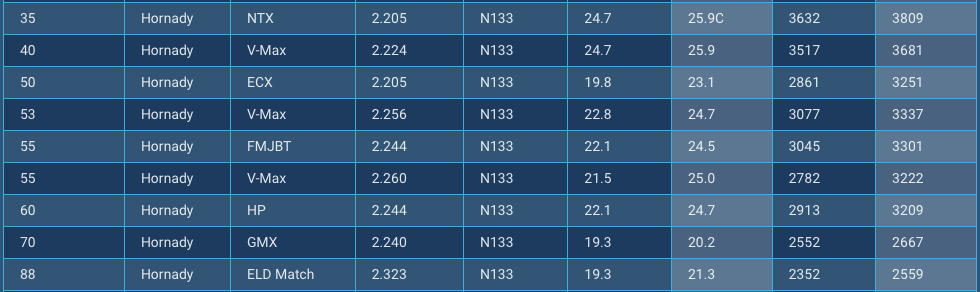

Not a lot of info for .223 Rem using N133 but was able to find this.....

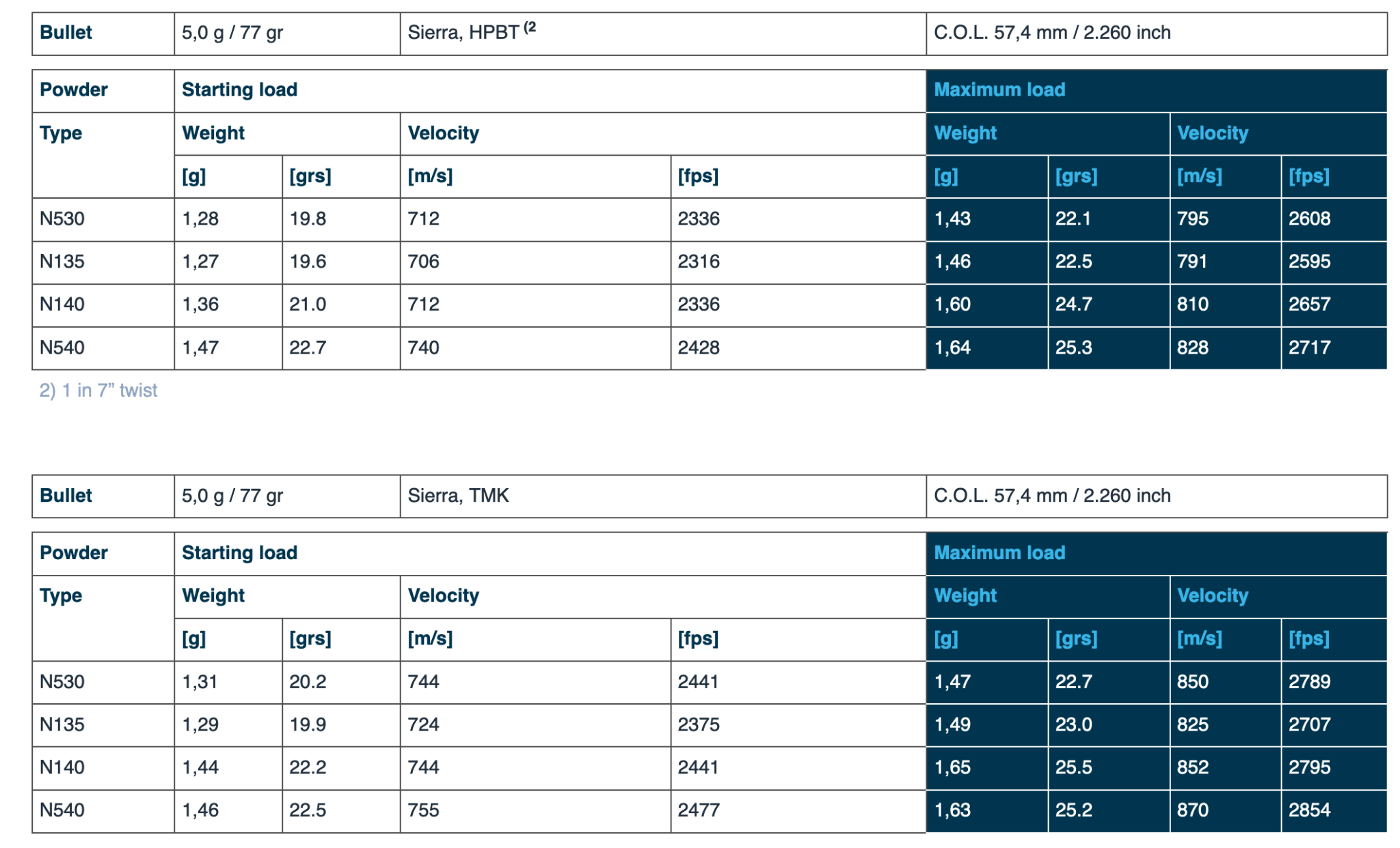

AFAIK, the 4895 or 8208 or ARComp etc. powders (commonly used for .223 heavies) are just slightly faster than 140/Varget.
VV equivalent for 1 step faster than VV140 probably VV 135 not VV 133, se ...
Try this handloading powder also with .223 Remington loads with a bullet weight of 3,9-4,5 grams (60-69 grains) and you will be surprised of the accuracy and velocity performance of the combination.
source>https://www.vihtavuori.com/powder/n135-rifle-powder/
I have already looked extensively through VV website and had also found data on a sierra site for 69 Gr. SMK's with N133.
Most of the load data on those sites are for chambers with very short freebore. Hoping to get some feedback from anyone who has personally used N133 in a bolt gun 223 with a wylde chamber or longer.
