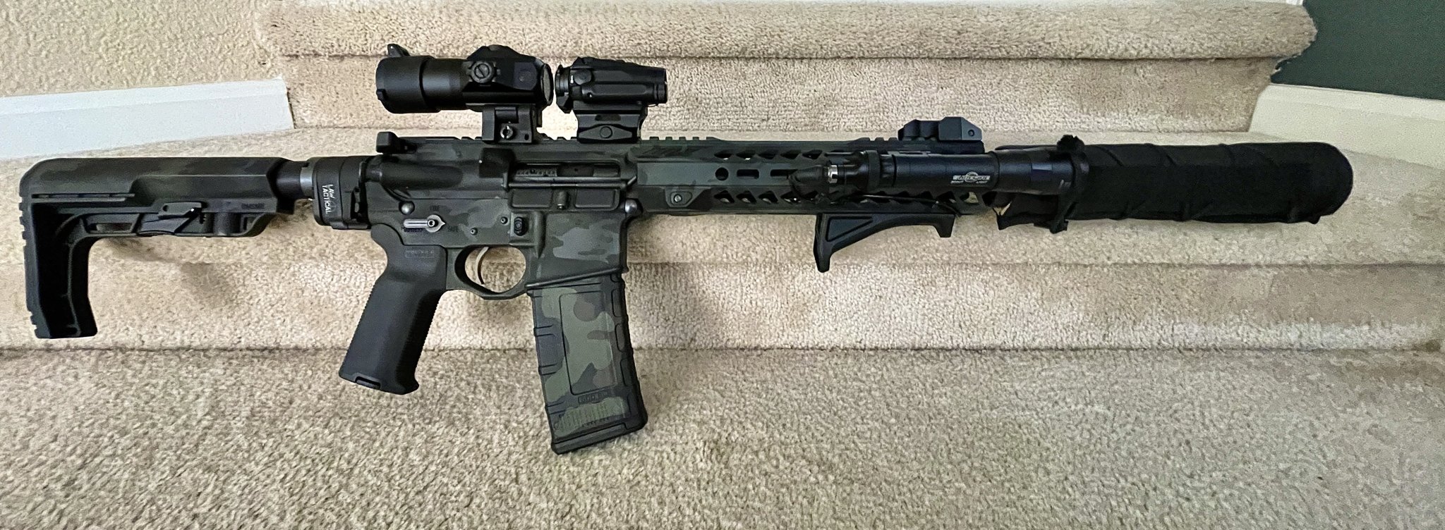

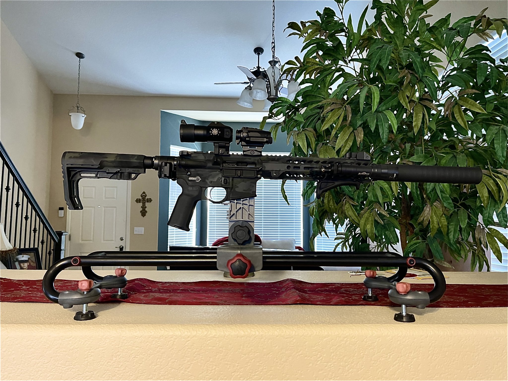

    I have a 300BLK SBR, 10.5" barrel with an OCL Hydrogen L 7.62 suppressor.
    147/150gr Supers work best in mine, though the 110gr A-Max does hammer!! 200/220gr Subs are where my SBR works best...Very quiet, very little recoil! Optic has been changed out for an EOTech EXPS2-0 Green...but you get the idea.
    I really like the punch of the 300BLK, but my best advice is to really identify your use-case, then go from there.

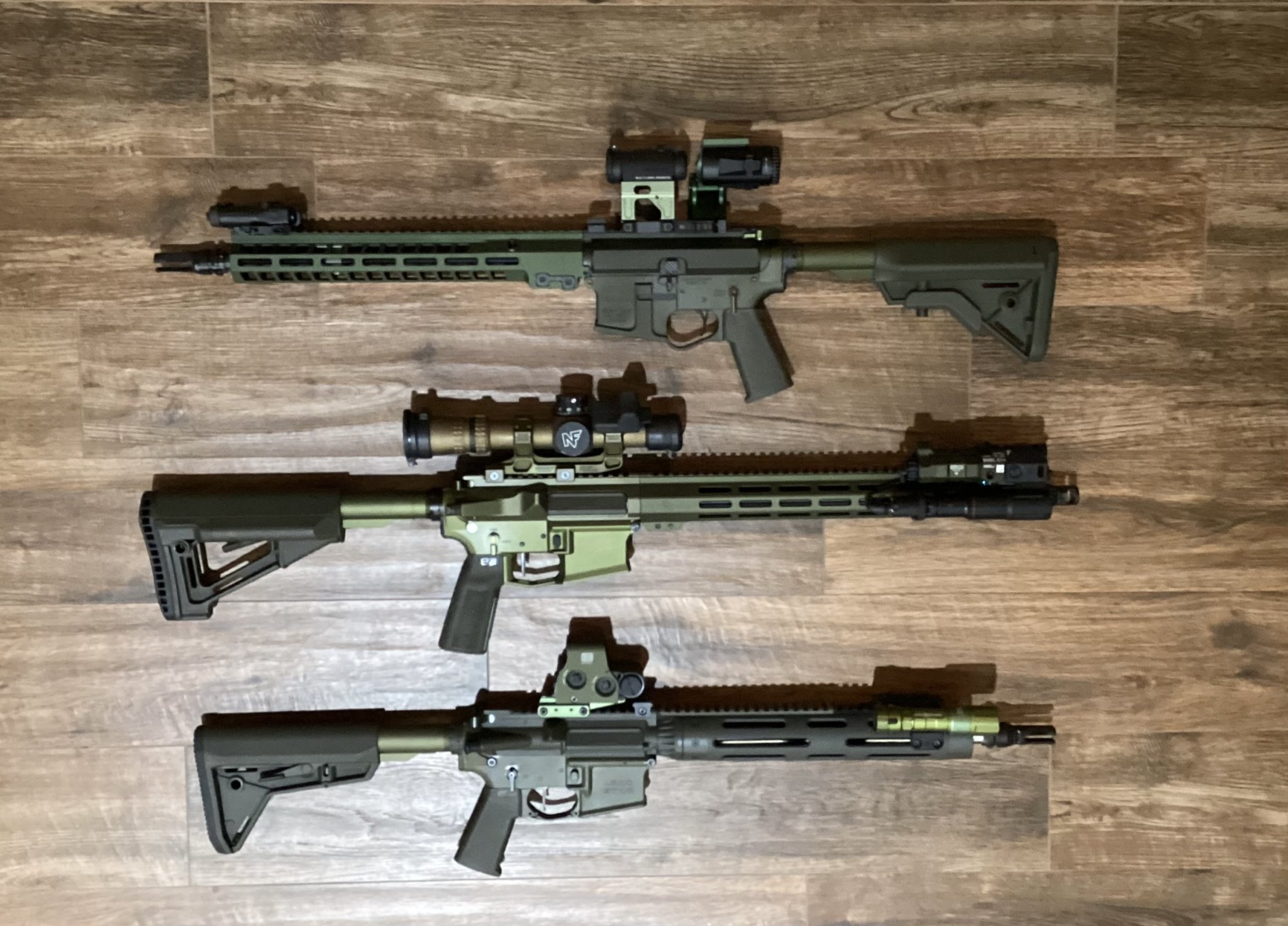

    Edit: a few of our 300 BLK rifles/uppers:
    16” that we loan out a lot…good all around plinker and hunting rifle:
    My personal favorite for hunting though is this 10” barrel, and has the old Leupy Mk5 scope with the 300BLK reticle:
    My son and daughter each have a 10.5” 300BLK upper for their SBR’d ARs:
    …finally got the red dot shroud Cerakoted pink too, LoL:
    My go-to HD and truck gun when travelling; 9” barrel:
    And an 8” done as a pistol; got tired of having to notify the bureaucracy if I wanted to cross state lines with one of our SBR’d lowers.
    …that upper gets shot enough that it has an actual red dot and magnifier now:
