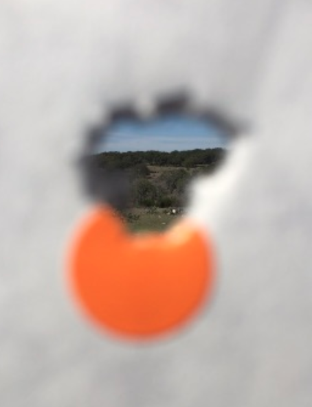

I LOVE my 16” 223:love:
7 twist pushing 75 elds, bangs steel at 1k and its just a pleasure to shoot. Its all about getting the good bc bullet twisted fast enough to carry its momentum way out there and keep stable. My old 9 twist barrel with 69s wasnt worth a damn past 600. This new one is.
Doesnt swing the target all that well but it puts a mark in the paint just like all the rest of them.

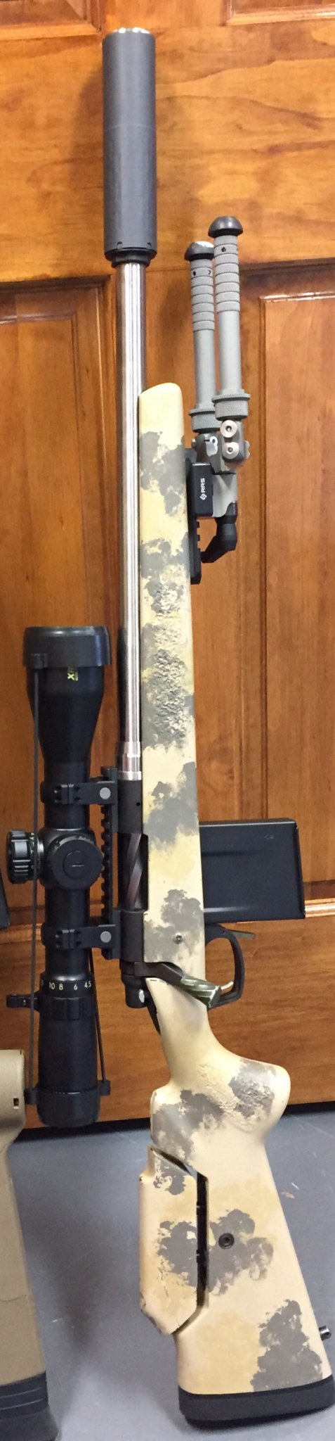

What kind of velocity are you getting out of the 16"? I have a 24" that I am going to cut down, was thinking 20", might go shorter. I is only shot suppressed. I have another barrel for it in 1-7 that I will finish longer for a match/ trainer.

I am currently at 3025 with 24.9gr H4895, NAMMO brass, 450s, and the 75 ELD. I might have to go 18". Once the new barrel is chambered, the shorter one will be for coyotes and a youth deer rifle. Have a 4 yr old grandson that has told me he wants to shoot a deer when he is 6.
