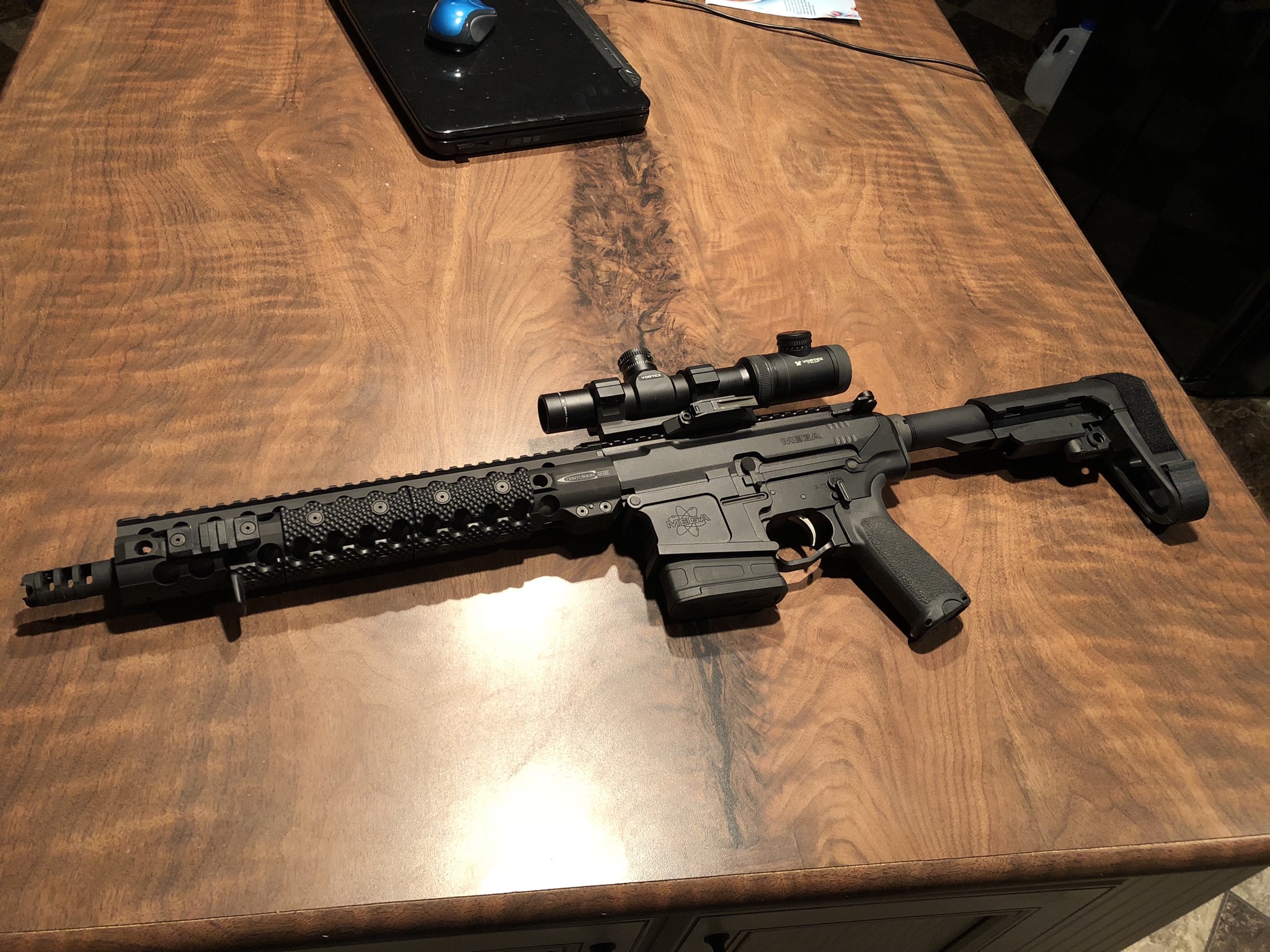

    For those of you with experience with SBR 308, I'm wondering what buffer and springs I should start with with a 12.5" Craddock Precision barrel? I'm going to run a brace on it and file for SBR stamp. I assume it will need to be heavy but which weight specifically? I have a XH Slash buffer that works in an extended carbine length tube but I'm assuming the arm brace tubes are standard carbine length? Oh and I have a nickel boron Aero carrier and JP enhanced 308 bolt, if that helps...

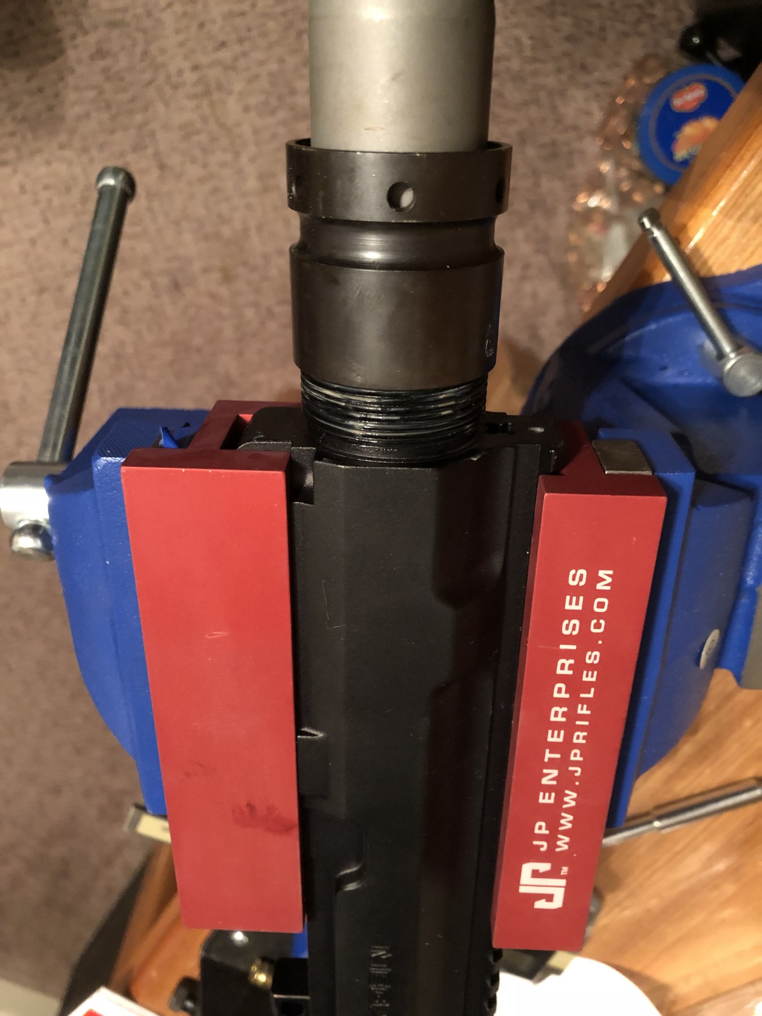

    To the best of my ability I measured .0870. I attempted to install the barrel tonight but obviously the barrel nut is too small to fit completely over the barrel extension. I sent an email to Centurion to see what the remedy will be. Bummer!
    It slips over the barrel and stops at the barrel extension. Apparently, this is a known issue to Centurion. I sent an email explaining my issue and Corrie has sent a package with a Gen 2 barrel nut and wrench.

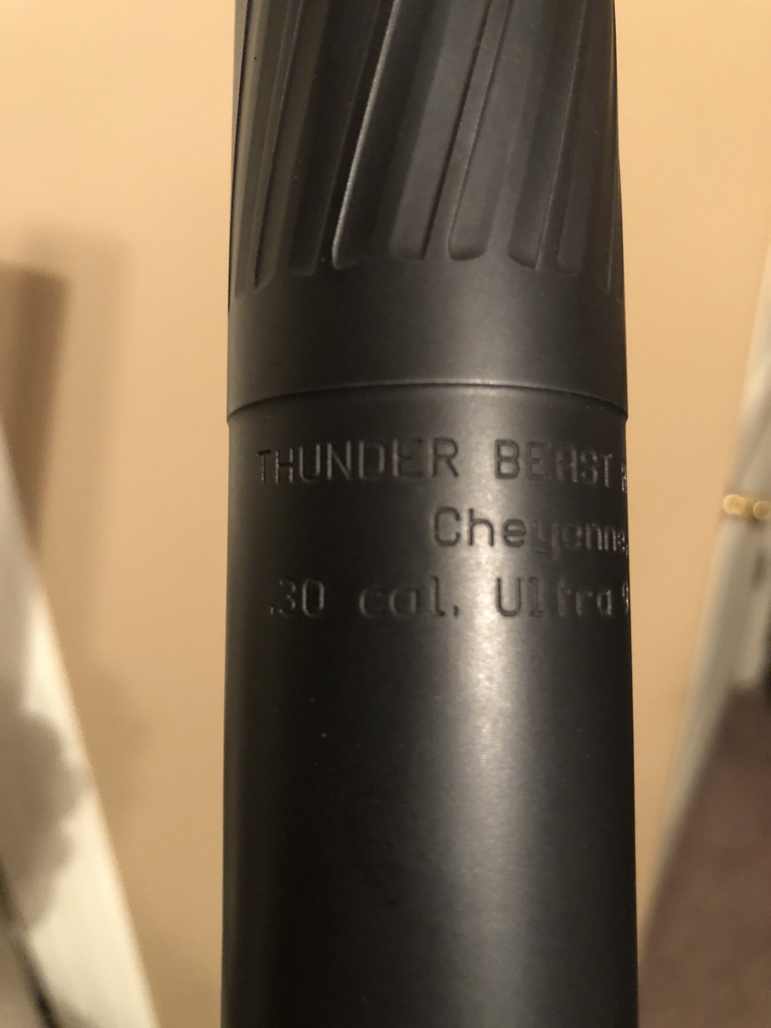

    I saw KAK has flash cans. If I can tame the gas, I may use my TBA Ultra 9 on it. I’m sure most of the time I’ll just shoot it with a brake and let it be obnoxious! LOL
    I put in an email to Zak about using the U9 on a 308 SBR. He said no shorter than 14.5, so that leaves me with having to use my saker.

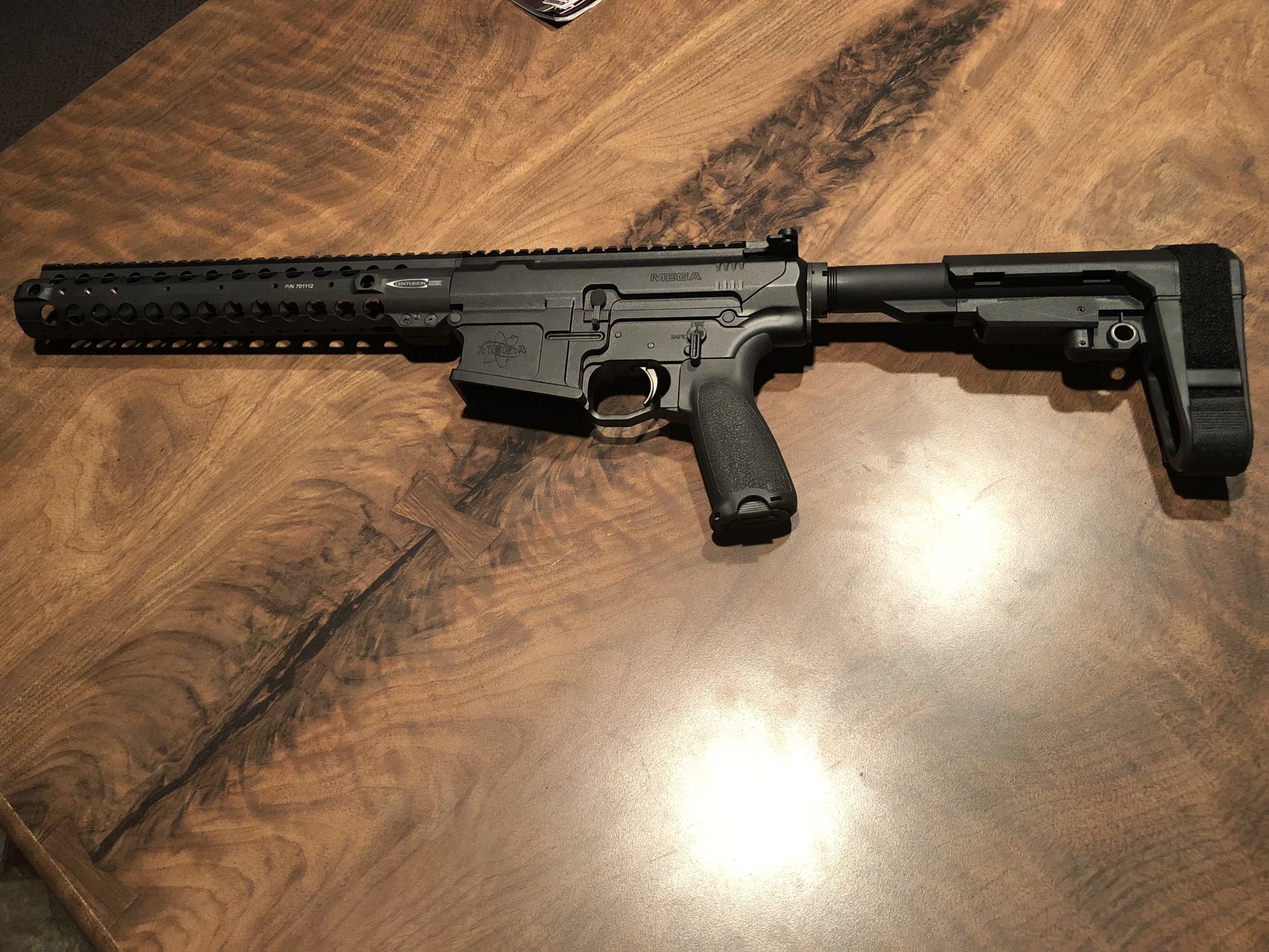

    I'm doing the pistol build as well while I wait for the form one. All the parts should be here in about a week.
    Aero m5e1 upper/lower
    Toolcraft bolt
    BA 12.5 carbine
    SLR AGB
    SBA3
    Saker762

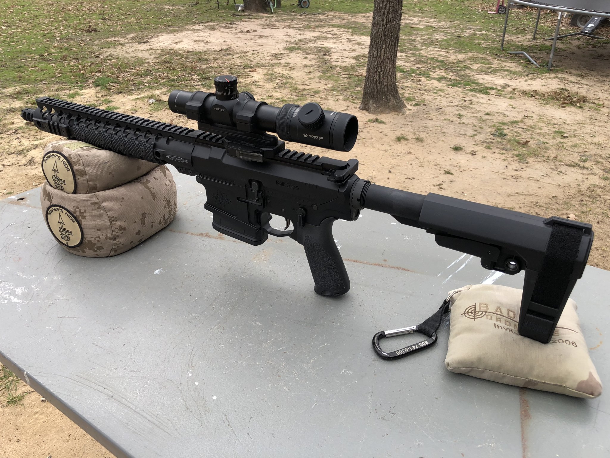

    I lied...It has a mid length gas system and functions with a standard gas block, Aero NIB bolt carrier group, and Heavy JP Silent Captured Spring. I built it up this afternoon and test fired it with South African ball. Going to load up some 155 AMAXs with 8208 XBR tomorrow and see how that goes.
    Reactions: bfoosh006
    I changed the buffer tube to an extended carbine and am now using an XH Carbine and rifle spring from Slash.
    It’s still a little overgassed so I will be adding an adjustable gas block. I just wanted to see if I could tune it with burn rate...First I tried 8208 XBR and 155 AMAX, Hornady match brass and CCI 200 primer with somewhat acceptable results but switched to AR Comp and worked up to find the max charge. I started at 42 and worked up to 45 in .5 grain increments. I’m onto something here as all of the test rounds went into about 1.25 inches. 45 grains showed pressure so I’m going to back down and do a ladder this weekend. It’s also compressed with a 155 at 2.80. The cases are very clean and in surprisingly good condition after firing.
