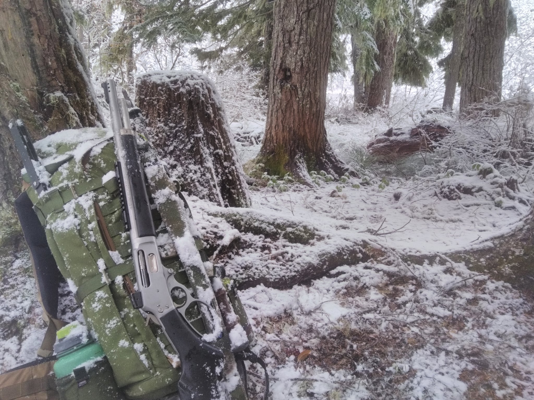

Winner. Pics from hunting Roosevelt elk a few months ago carrying my 400 and below elk rifle... If it's for under 400 does it even need glass?
Can't find pics of the other elk rifles, the 30-30,25-06 and 308 for the big bodied Rosie's.
