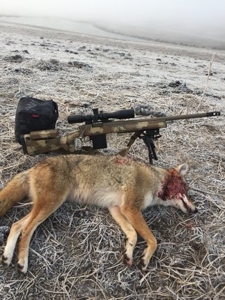

My 6x45AI is more than adequate, day or night.. Heck, all I use is a flashlight & have no problem with <200yd shots. Most are 1/2 that...
If my AO were muffler friendly, I'd prolly knocked a couple more inches off. But as it sits now @ 22", I'll take the extra fps...
Good hunting!

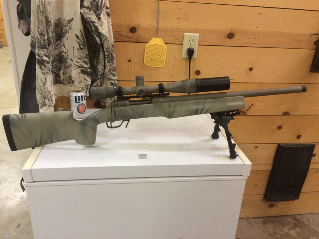

I had this 22 creedmoor built this winter. I wanted to go down to 16" but my smith talked me out of it. He said the shortest he would go is 20" for that size case. He had a 22x47 that started out life at 24" and he chopped it down to 22, then 21, then 16. He said chopping it down to 16 ruined it and couldn't get it to shoot anymore.
It's a 20" 7.7 twist bartlein runnin the Berger 80.5 fullbores at 3400 over 43.0 H4350 into tiny little bugholes.

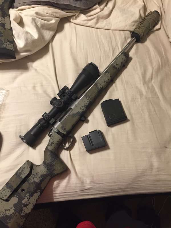

This will be my short barreled coyote rifle for the next few years. It is an 18" barrel chambered in .223 AI. I haven't got a load for it yet but I hope to shoot 80 ELD's at over 2900 FPS. The suppressor is a Form 1 build I did that is larger in diameter than normal but only adds 5.5 inches to the gun as it slides over the barrel almost 2.5 inches. Suppressor weighs 13 ounces and whole gun with suppressor mounted weighs less than 11 lbs. Also, the action looks a bit strange because it is a left bolt/right port Bighorn TL3. I bet they don't make many in that configuration. It is a very handy length/weight. I think it will do well on coyotes. [IMG2=JSON]{"data-align":"none","data-size":"full","src":"http:\/\/i1149.photobucket.com\/albums\/o592\/austinbuschman\/IMG_20170504_211056017.jpg"}[/IMG2]
