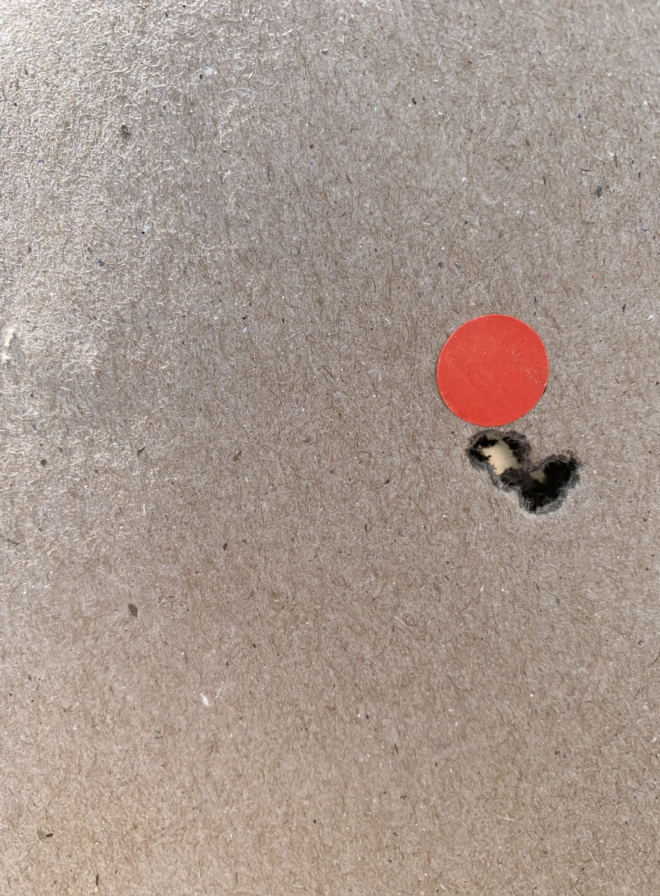

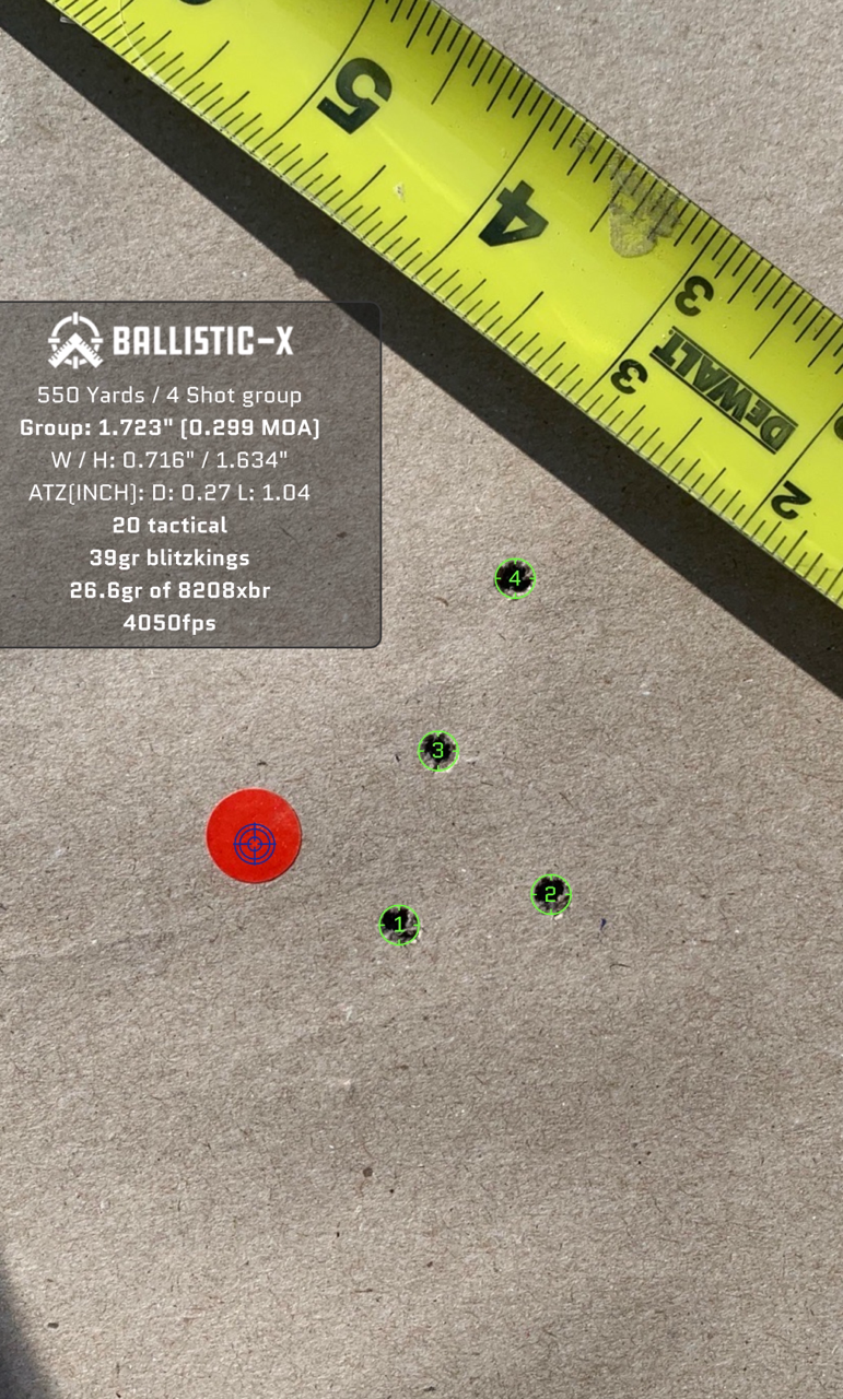

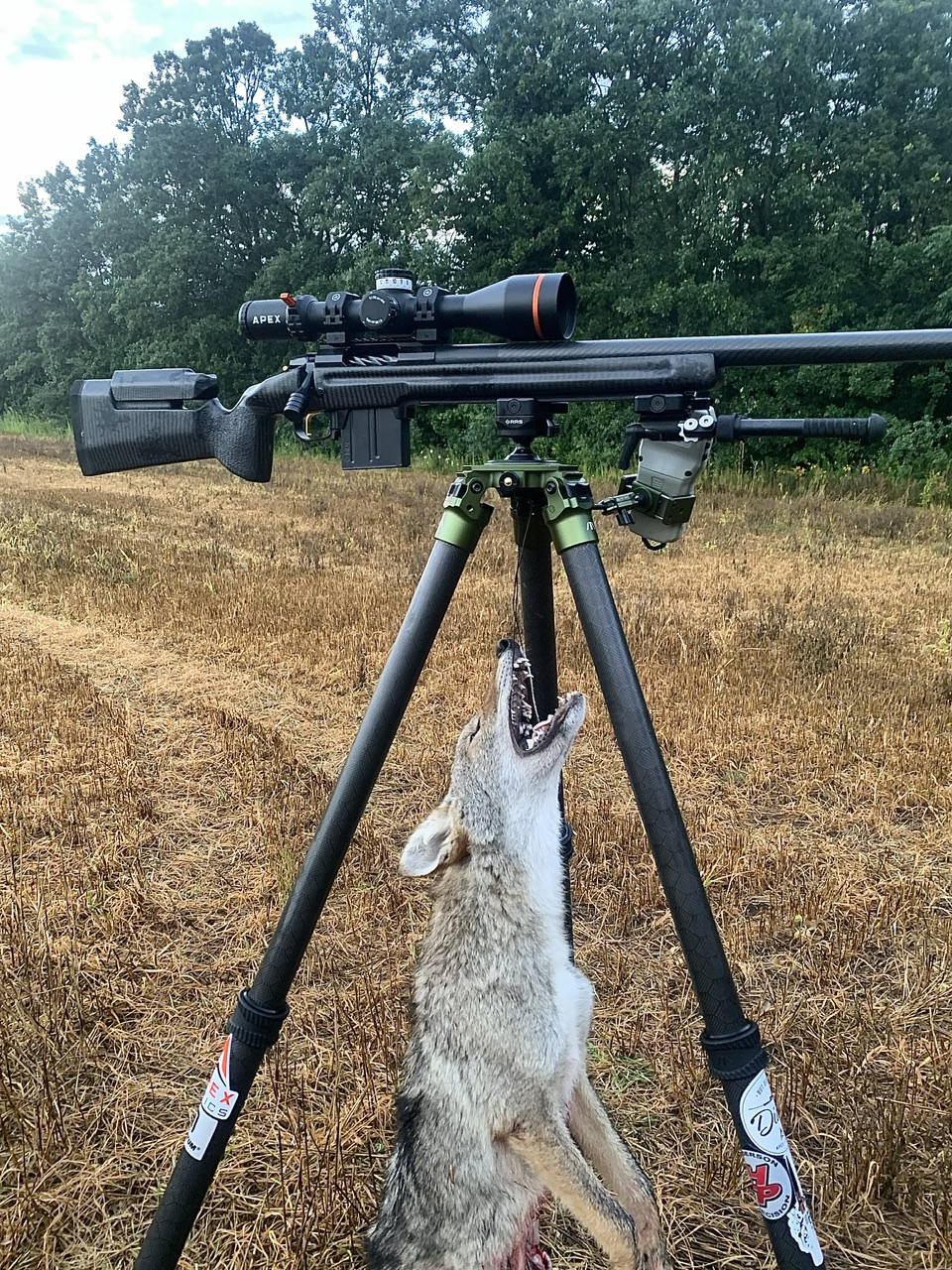

For 300 and in a 20 cal would be my choice for sure. Im running a 20 tac with 39gr blitzkings at 4000fps and 35gr bergers at 4050fps. Super fast, super flat and hammers yotes. Inside that 450 yard range it’s lights out. A 204 would be the same. Here’s some 20 tac groups
View attachment 8598052View attachment 8598051View attachment 8598050View attachment 8598049

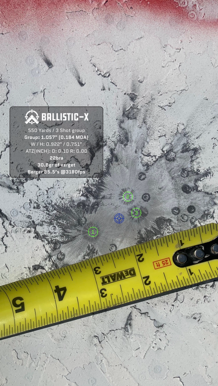

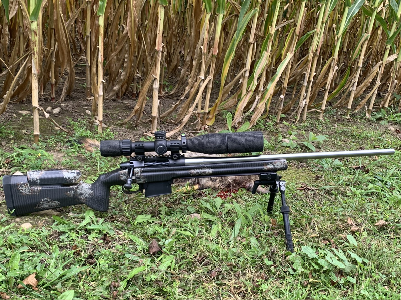

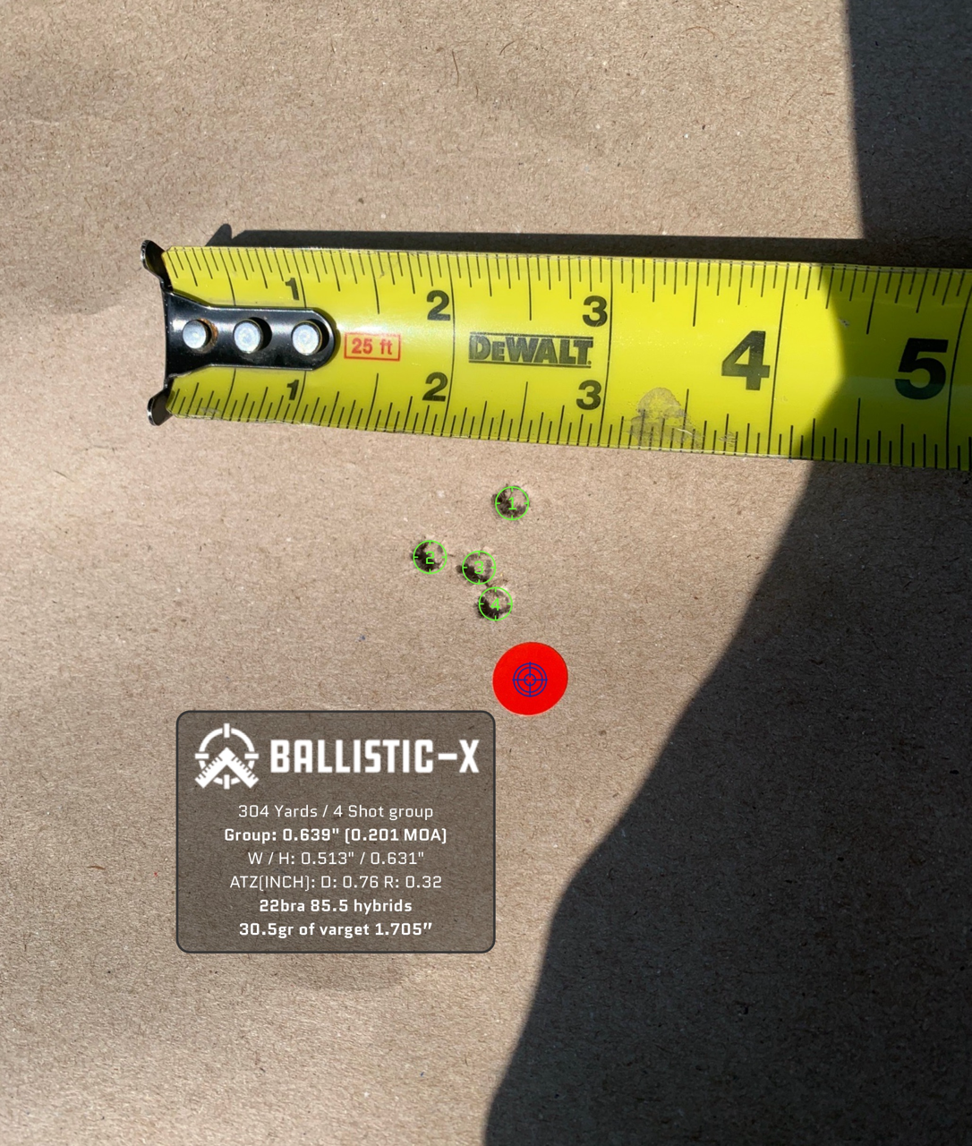

I also love my 22bra. I’m running 85.5’s at 3100-3130fps but have pushed the 75gr eld’m’s to 3400 and could imagine the 60gr bullets would be 3500+
View attachment 8598053View attachment 8598054View attachment 8598055
