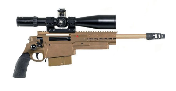

    Is this kinda what you're going for?

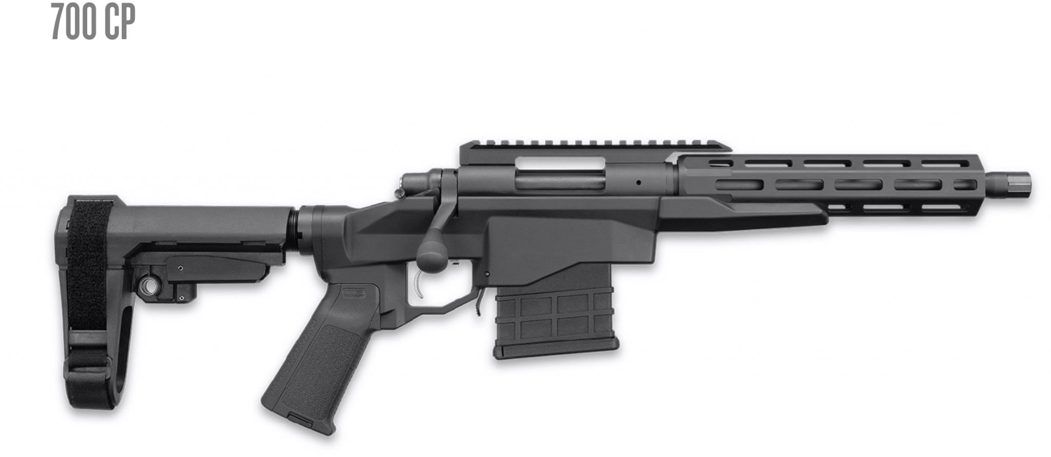

    I think these are built with howa minis. Probably not for OP, but interesting option if you’re looking for a light, short 6.5 Grendel or .300BLK pistol bolt gun.
    been coon fingering their website for a few days. I’m particularly interested in their stock since I’m looking for a child-sized LOP for my thermal’s short eye relief. They have one for 700SA too.
