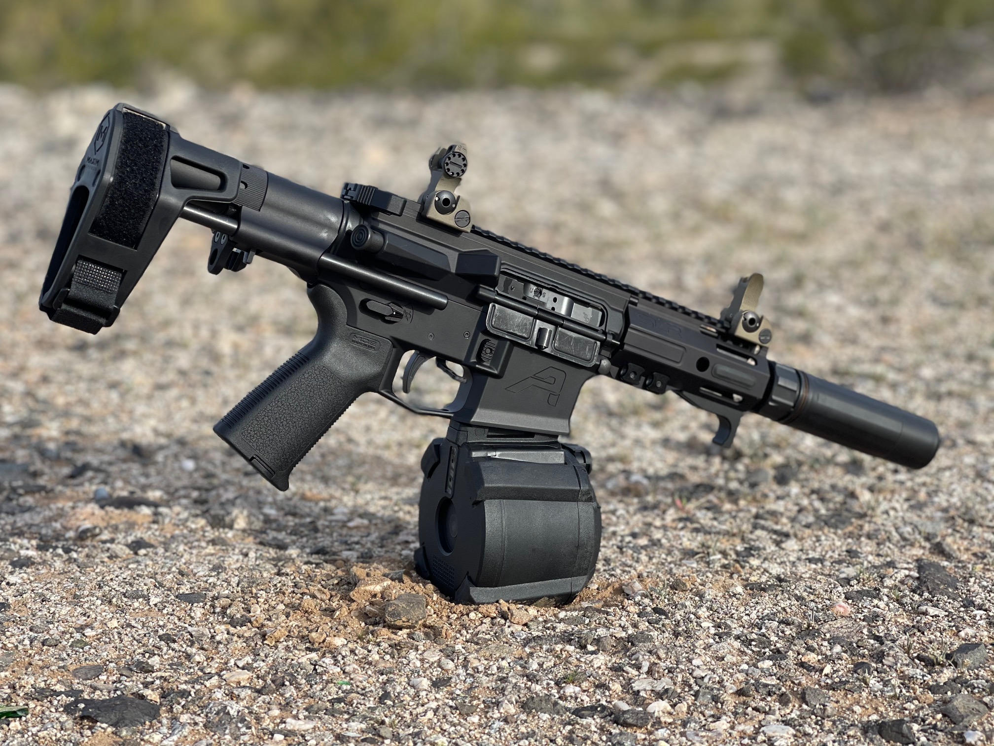

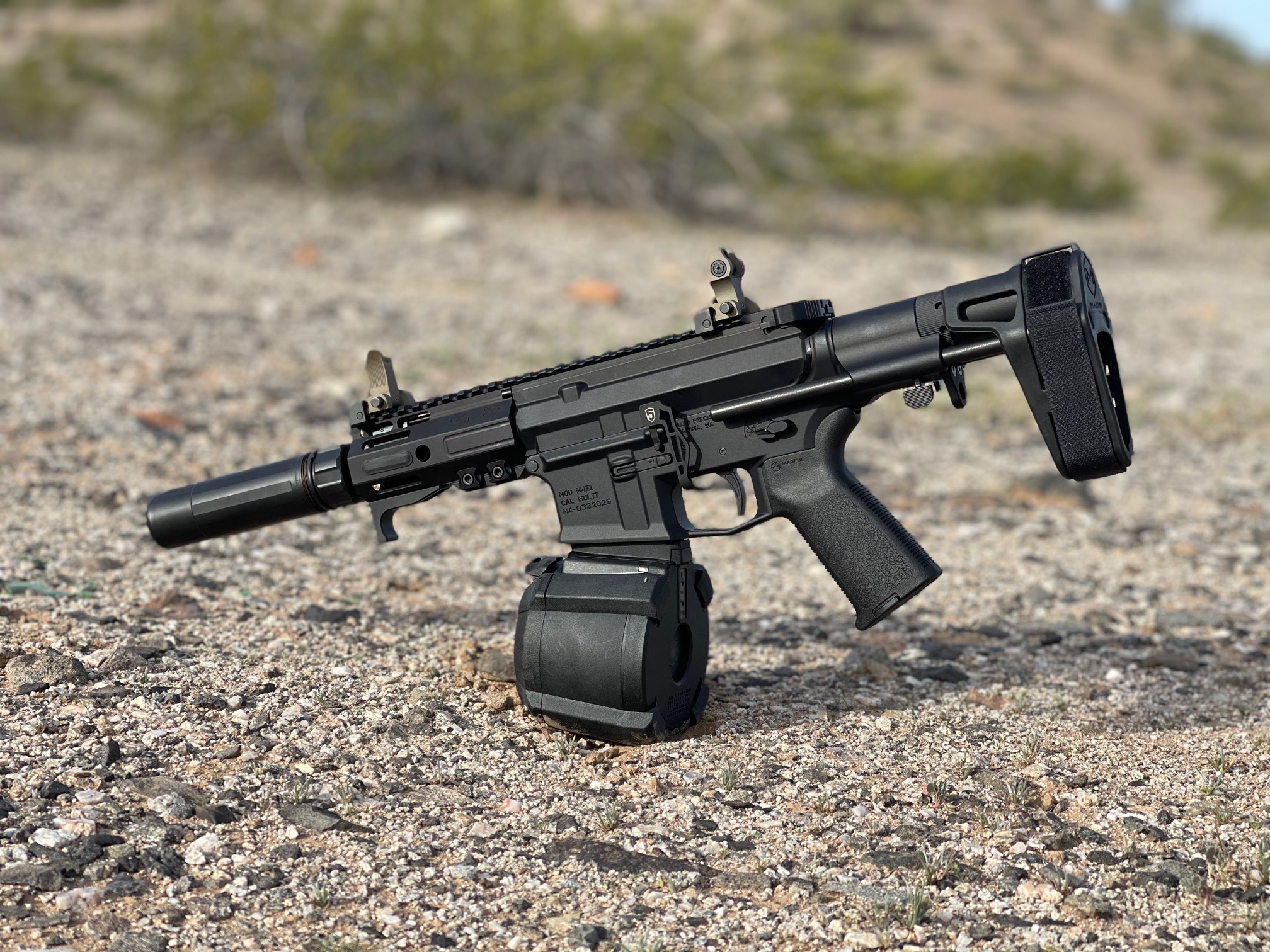

that is sweet5" with SLR barrel & handguard.
Ballistically stupid, incredibly fun flamethrower.
