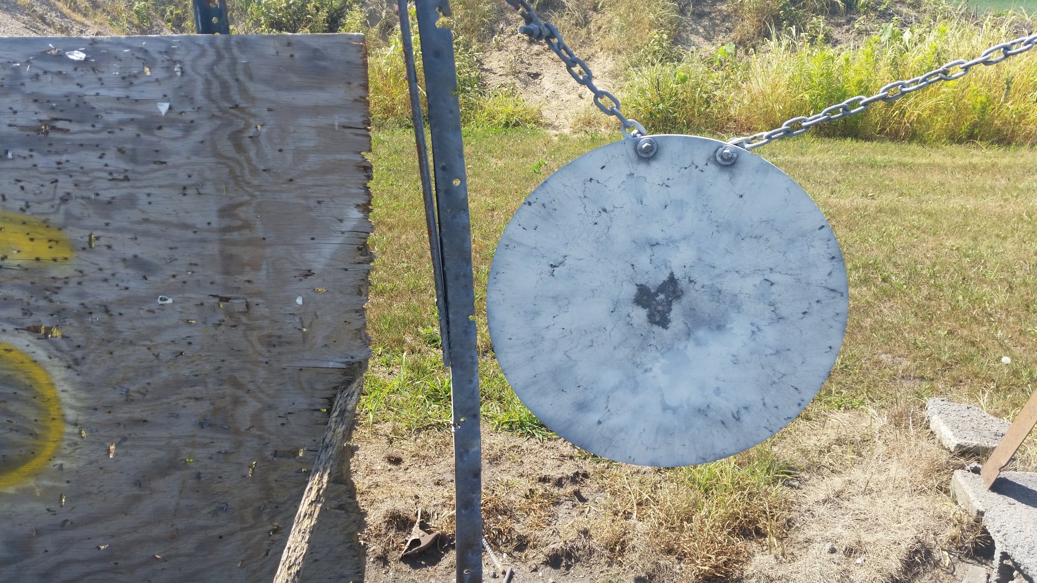

As has been stated, if you want factory ammo support get the creedmoor. If you want stupid easy load development where almost any load used will be good, get the 47L. Below is a Green Mountain barrel 1:8 in 6.5x47 at 600, 2.25" oal 5 shot, 140 hybrids.
