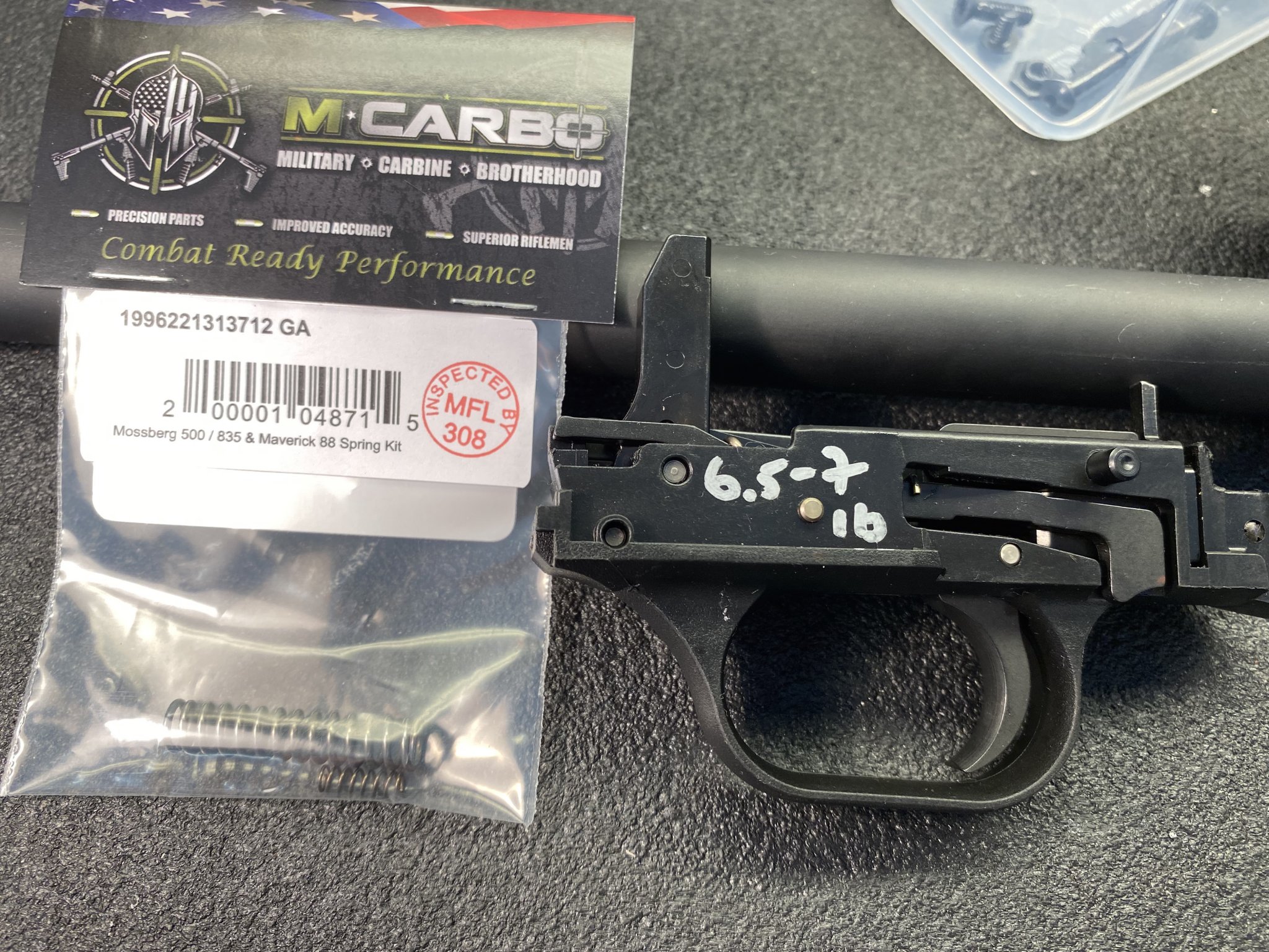

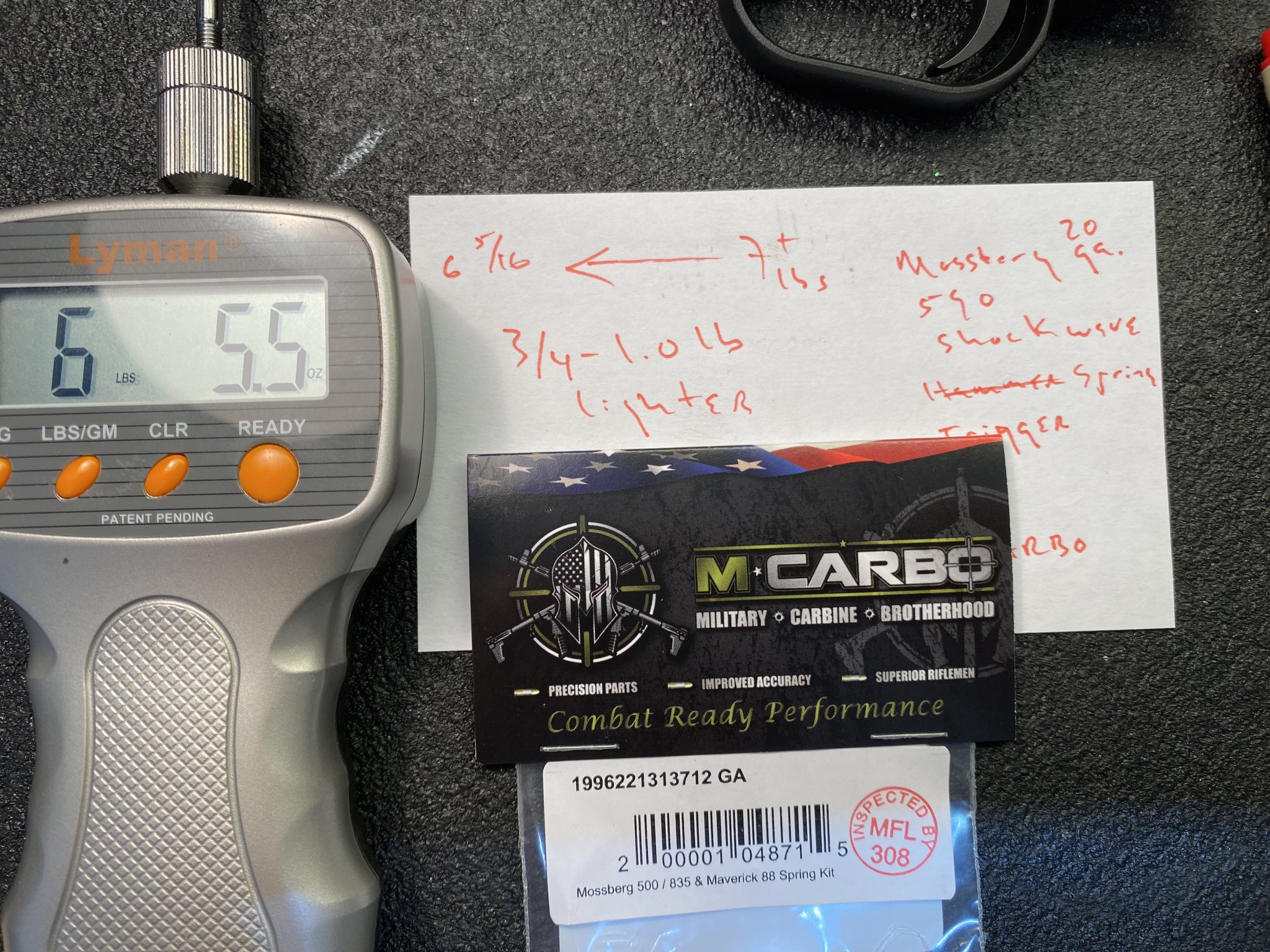

@strikeeagle1 What is your opinion on the M-Carbo trigger spring kit?

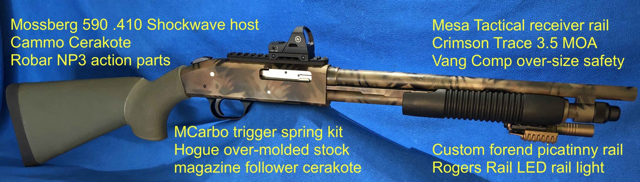

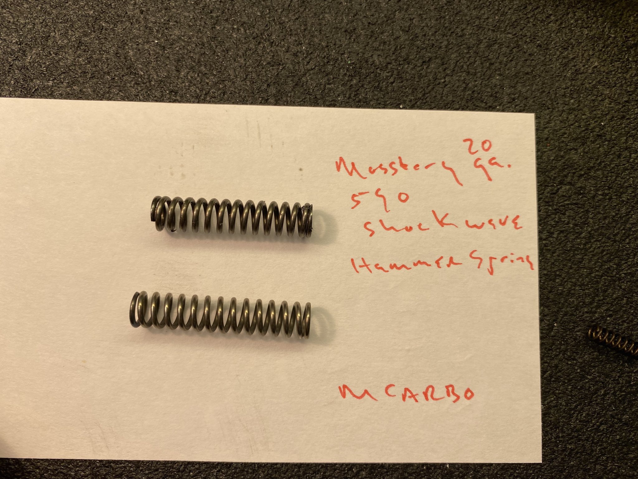

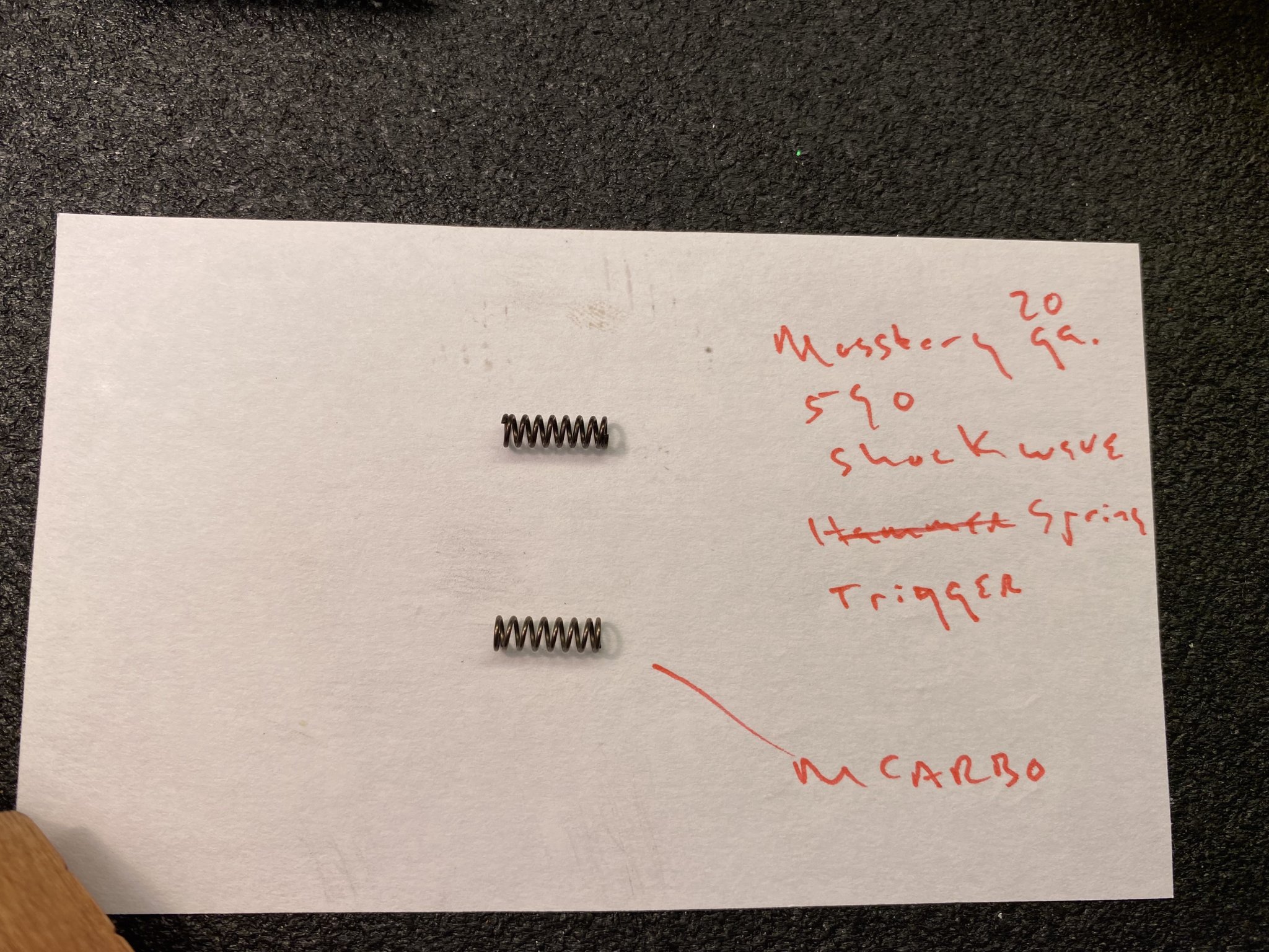

The M-carbo is a good consideration. Drops the trigger pull 3.4-1 lb.....of course with shotguns a low trigger pull is not usually desirable, and since the operator has cheek weld and forearm support you can slap the trigger and get away with it regarding accuracy. I also used it in this Mossberg 590 Shockwave .410 (my critter gitter). For home defense I wouldn't want to be shot in the face with it.

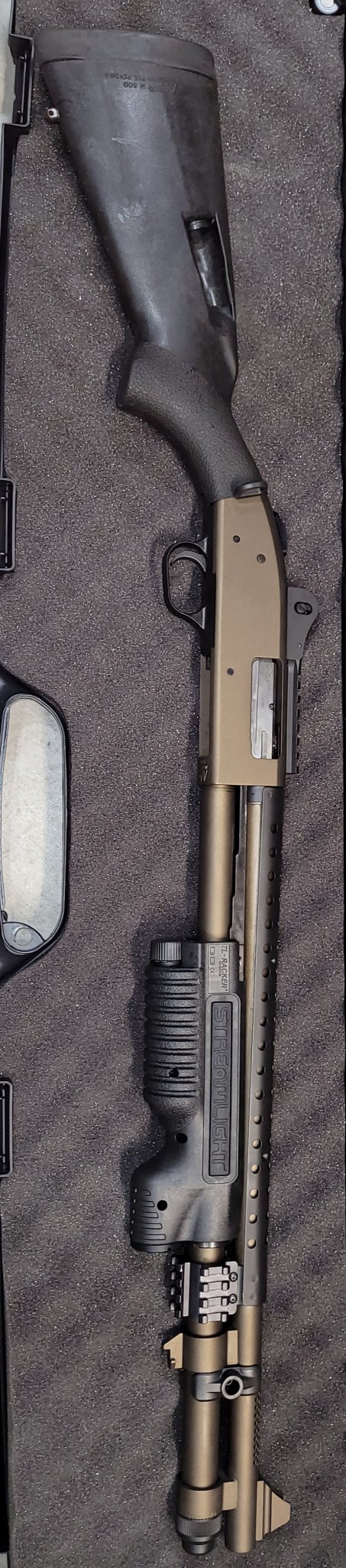

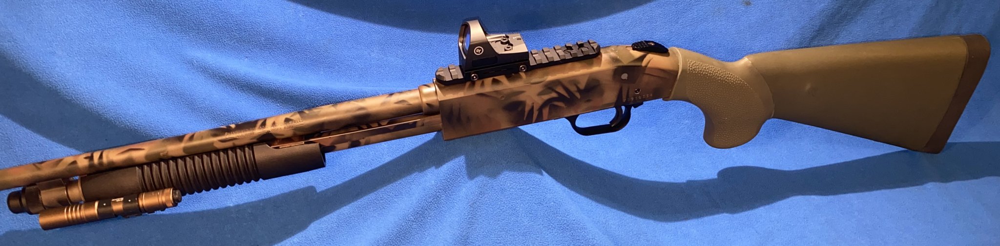

My 590 is 30 years old but not used a lot. The springs are probably just fine but I figure I'd replace them any way. I am not looking for a significant reduction in trigger pull. I'd be happy with around 5-6 lbs. I've also got an Wolff xp magazine on the way.
I'm getting pretty anxious to get it back from Vang Comp to get all the other stuff done (TL Racker, GG&G sling swivels, springs, and patterning).
My class is in August so I should have plenty of time.

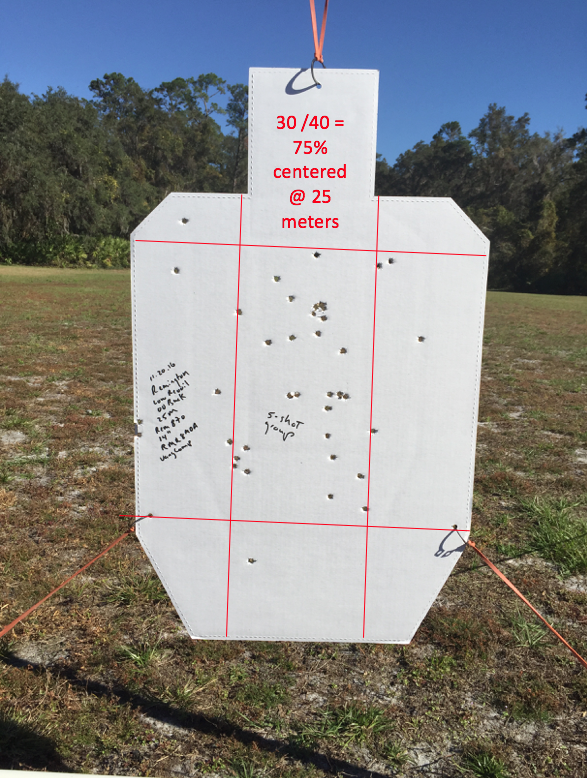

Vang Comp profiles the muzzle for a 32 MOA pattern; 8" @ 25 yards. All the pellets on the target but a few on the edge; a lot of .30 caliber
pellet accountability down range.

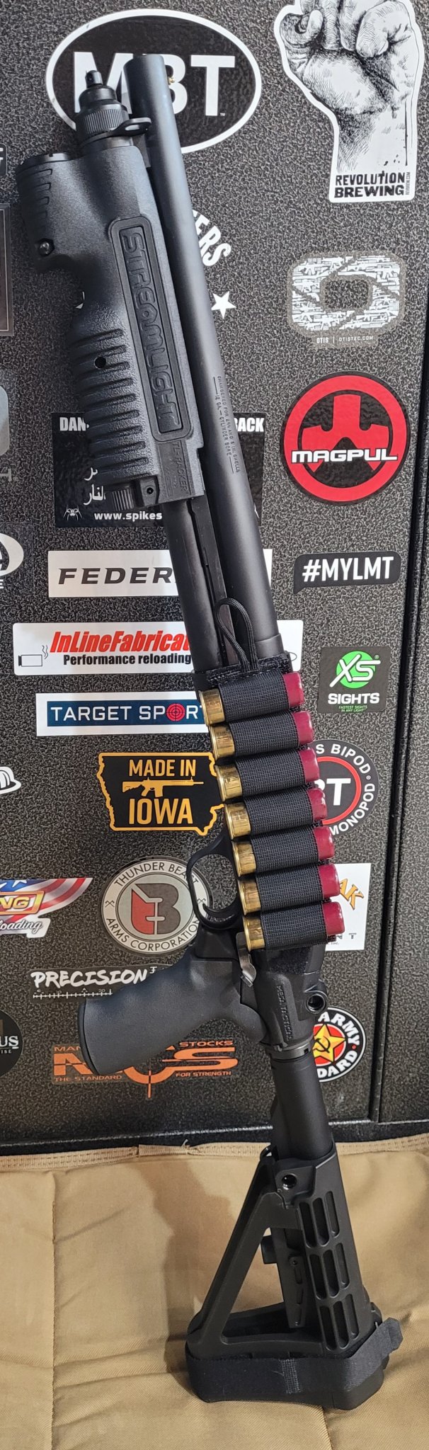

Form 1 SBS that bitch and put on a proper stock. It just feels good in the hands.
Would love too, unfortunately my F'd up state (IL) doesn't allow such things. No SBS, SBR, Suppressor, etc. But we are trying to fix that.
The Mossberg safety on top and the slide release do not lend themselves to a pistol grip set up like the Rem Tac14, but I'm sticking with the Shockwave anyway.

So I built a thing...
Mossberg 590 Shockwave 12ga
Mesa Tactical adapter.
SBA4 Brace
Streamlight TL Racker forend
Vang Comp SS flower and oversize safety
M Carbo trigger spring kit.
Pic rail with Vortex Viper Red dot (Not pictured)
Shoten Armory extended slide release.
Esstac shot cards

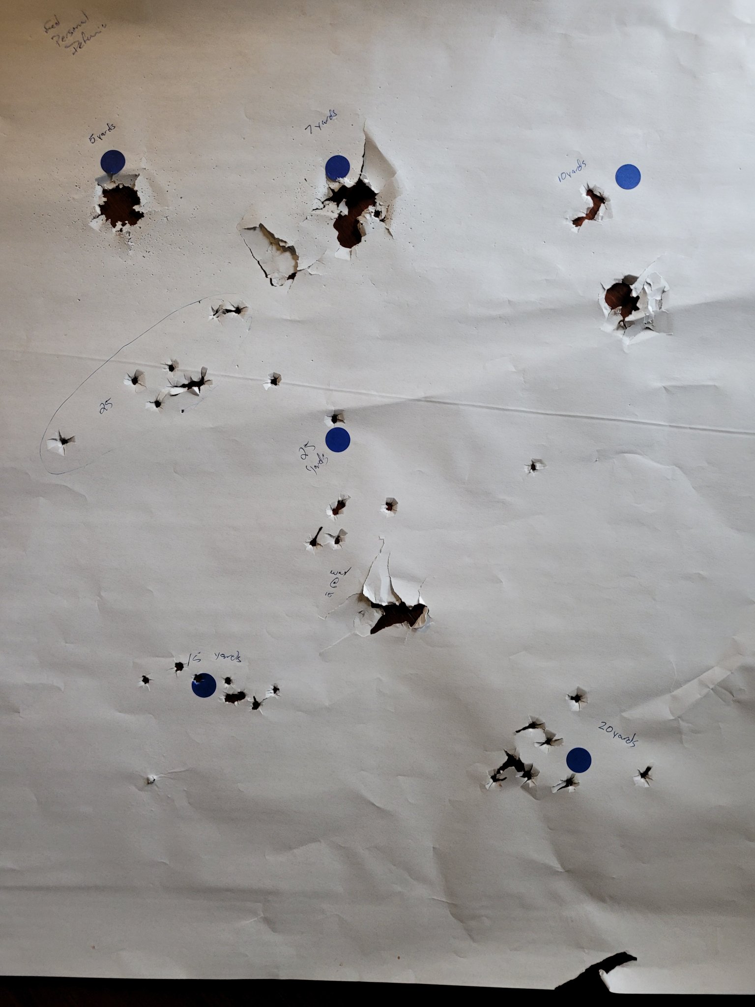

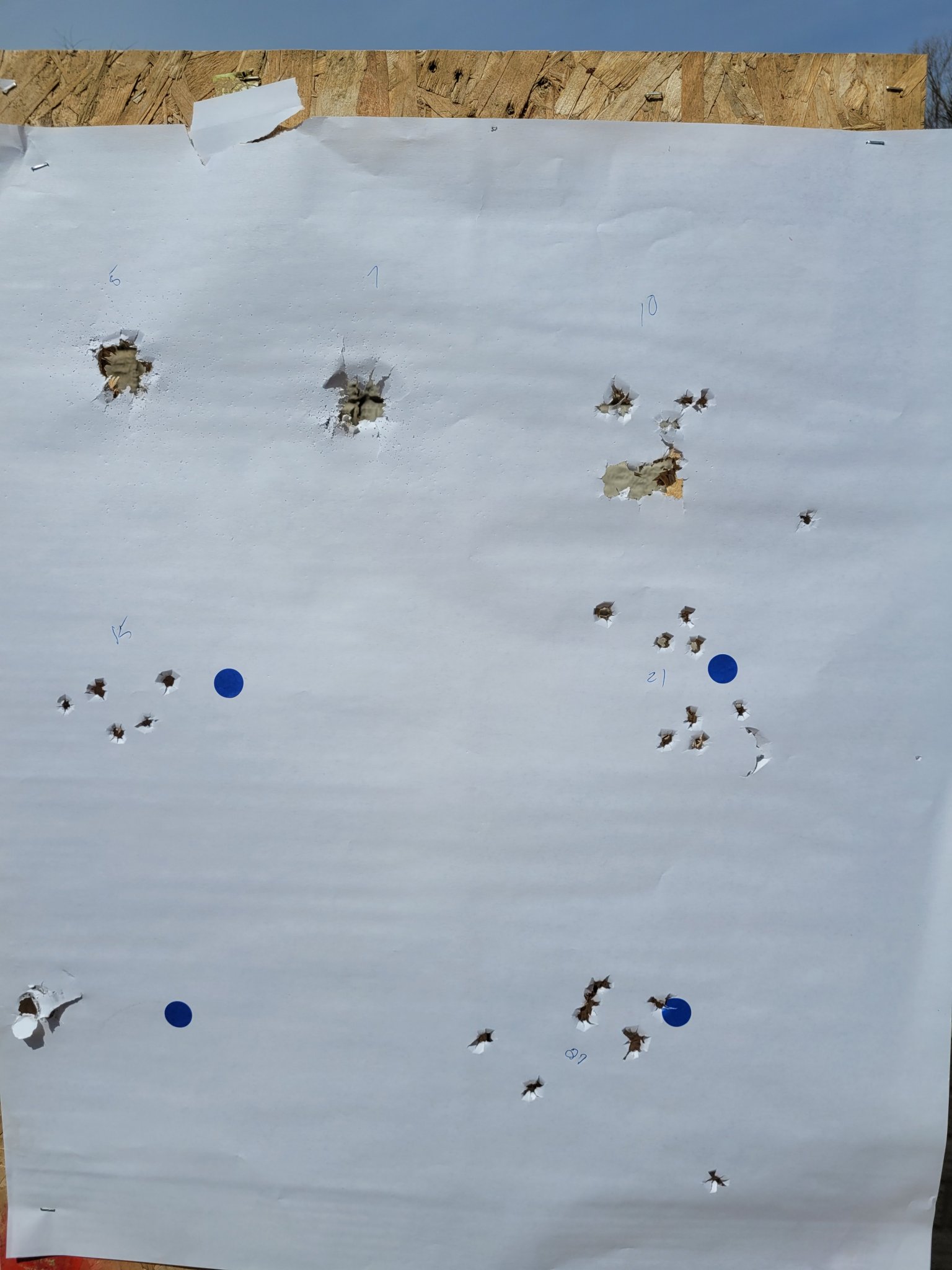

Also since the buffer tube was empty space I added a 23 oz SS piece of bar stock (6.25in x1in) for both balance and recoil reduction.
Very pleasant to shoot with reduced recoil loadings.
Today I shot Federal Personal Defense copper plated 00buck and Federal Tactical 00buck out to 25/27 yards as shown below. I am super stoked and amazed at the patterns both of these loads turned in. Im really not seeing single pellets until 10 yards. The blue dot aiming points are about 3/4 inch. I shot 2 at 25 on the first target below, one centered and one left just to see how it would repeat. Federal Truball slugs shot exceptional as well.
I am beyond happy with how this little project turned out.
With performance like this I'm hesitant to send the barrel to Vang Comp.
Six and a half months later I got her back.
One extra thing I had them do was to cut the Speedfeed stock to accept a Magpul Para loop.
They did as I asked and did a good job of it. Unfortunately, I don't like it at all. Either side I put it on gets in the way. I'll be going back to conventional swivels.
