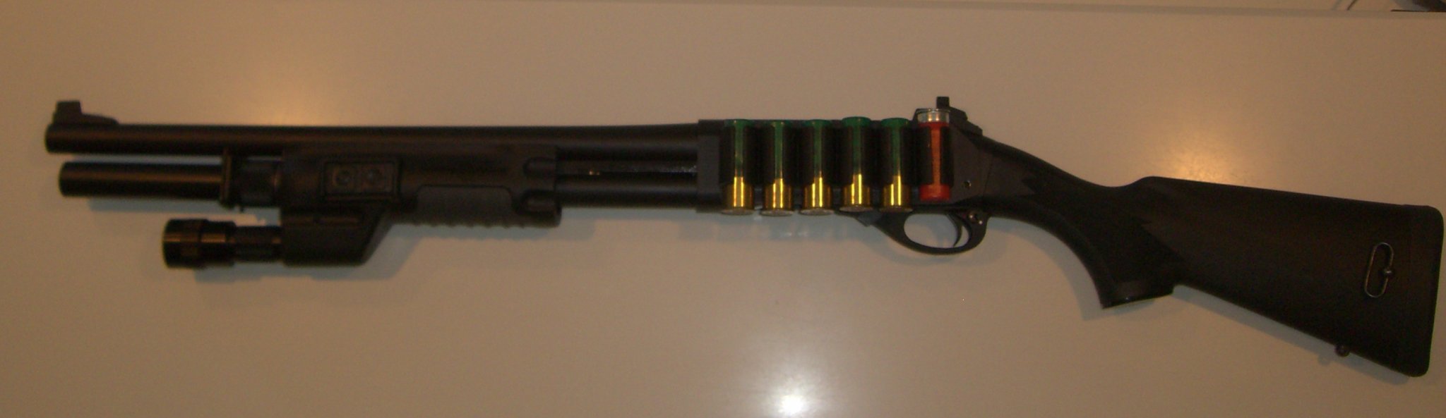

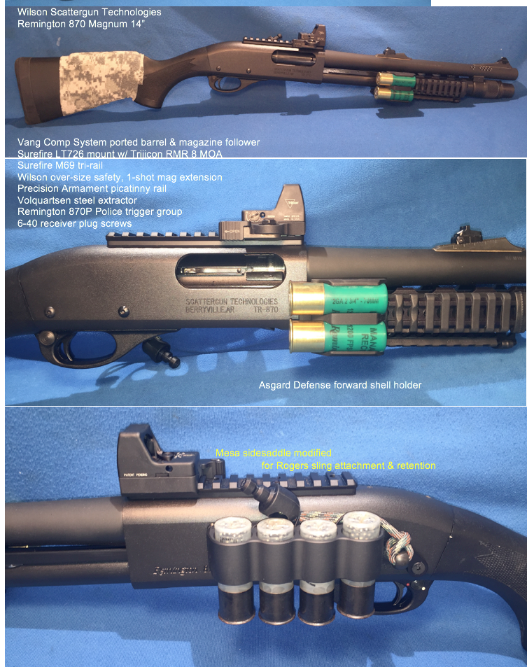

I think Wilson Combat has slid out of the shotgun business this past year. I was viewing their website recently, virtually no shotgun parts and no custom shotguns as they used to offer.

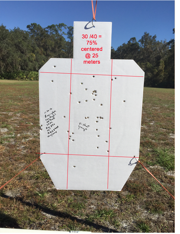

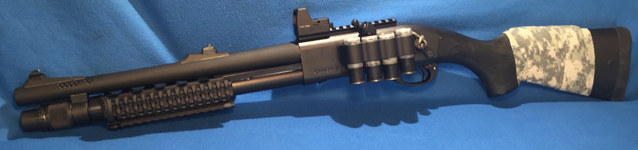

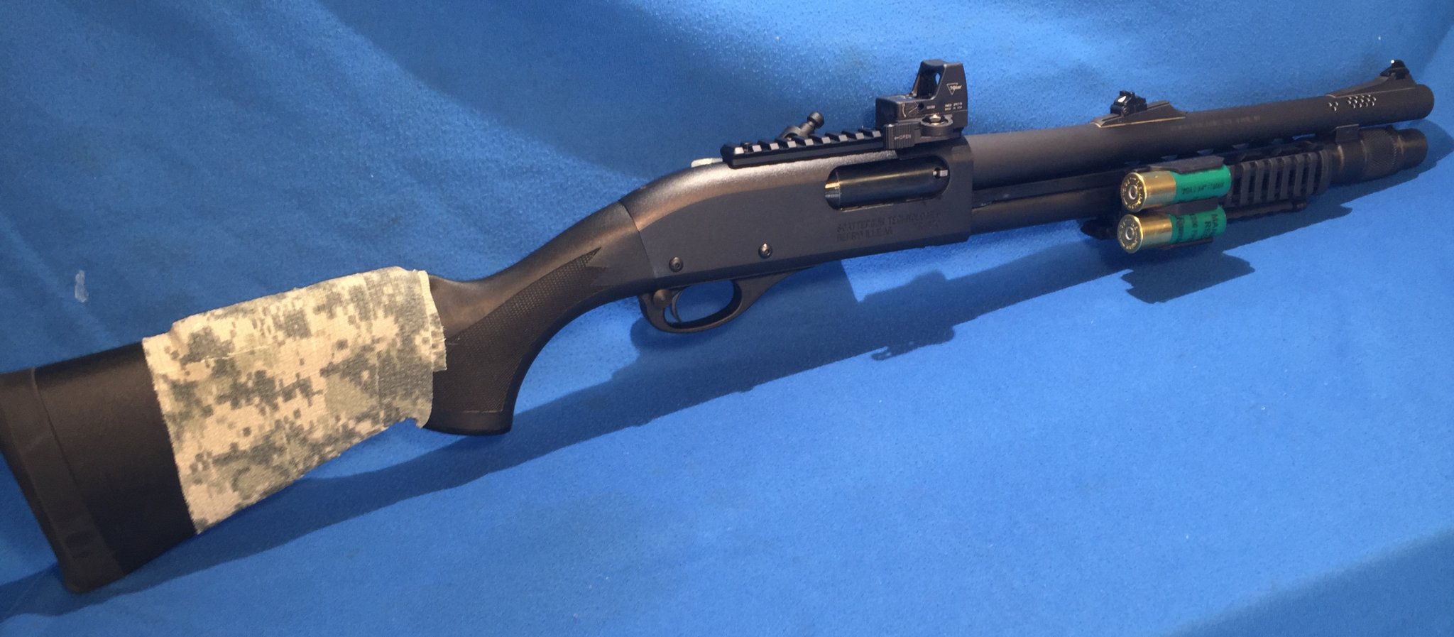

This Remington 870 started as a Wilson Combat Scatterguns Technology setup, 18" barrel with a sea anchor of SureFire light power way out front; with a full magazine Arnold Schwartzenager couldn't drive it the target fast enough. I installed a 14" barrel with Vang Comp treatment and some other mods and it's a pretty handy accurate shotgun. I converted a Mossberg 590 shockwave .410 into a critter gun and it's really nice.

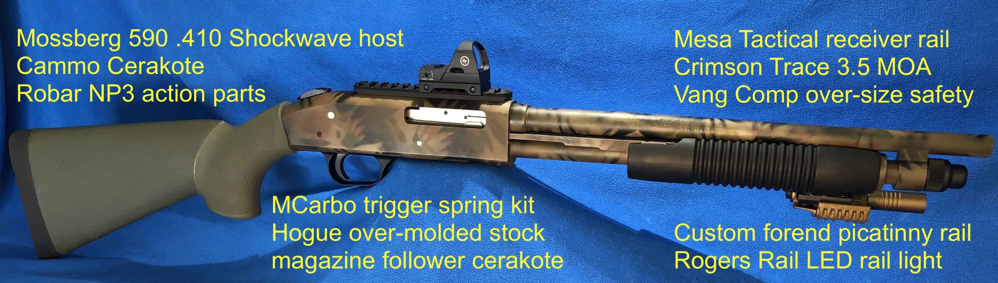

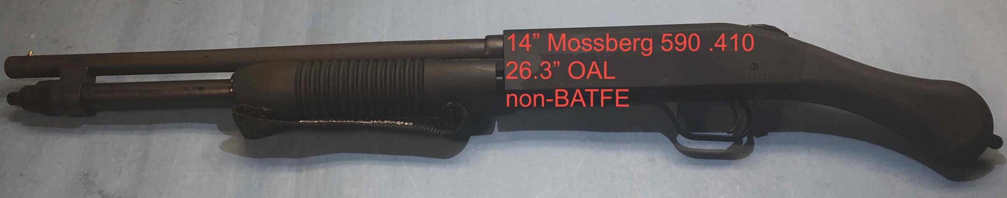

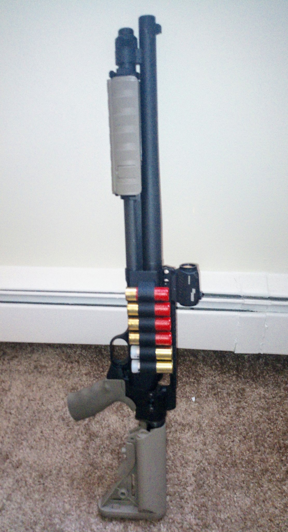

Currently converting a Mossberg 20 gauge shockwave into a similar pattern 14" project; just today Vang Comp shipping the barrel that has been ported and forcing cone extended with guarded tactical front sight, NP3 coated all action parts, rear ghost sight with integral picatinny rail to mount a red dot yadah yadah.....will post up some completed project photos in a few weeks.

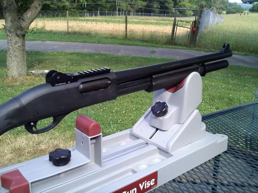

Glad to contribute. Let me clarify.........if u want it refinished, Cerakote is tough and affordable, I didn't mean to do that yourself.
The reason I suggested the saddle rail is you can do it yourself, no holes to drill and tap. It is a one piece unit that slides over the whole receiver and is held in place by two screws that replace the trigger pins. It has a pic rail on the top for mounting a dot. I have one on a 20ga set up for deer hunting.
If you were to get a Remington slug barrel (shorty) it has front and rear sights. They are smooth and would work great for buckshot. With the saddle set up, you can look through it and still see the sights. Nice if you dot goes to shit.
Buy a shockwave.
Put it on a form 1.
Get tax stamp.
Put a magpul stock and forend on it.
Get a GG&G rail.
Mount red dot of choice.
Mount light of choice on forend.
Best pump shotgun you'll ever own.
Correction...
  • Mossberg 500 shockwave
  • Form 1 SBS
  • Mesa high tube adaptor
  • Mesa side saddle
  • B5 sopmod
  • Quad rail forearm
Best pump you'll ever own 😉
