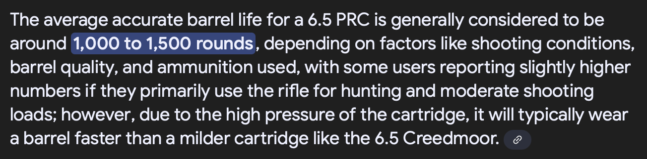

Facts are a bitch sometimes... If you're handloading hot, you can expect that to be closer to the 1,000, than the 1,500 mark...
If you like buying barrels every 1,000 rounds just to only gain 150 FPS over a 6.5CM, go for it. 😂
I feel the same way about the 6.5 PRC. That's why I had a 6.5/7 PRC built. It runs 147's at 3100 fps. If I get 800 rounds out of it I'll be happy. I have a extra barrel on stand by when the first one is burned out. Barrels are consumables.
