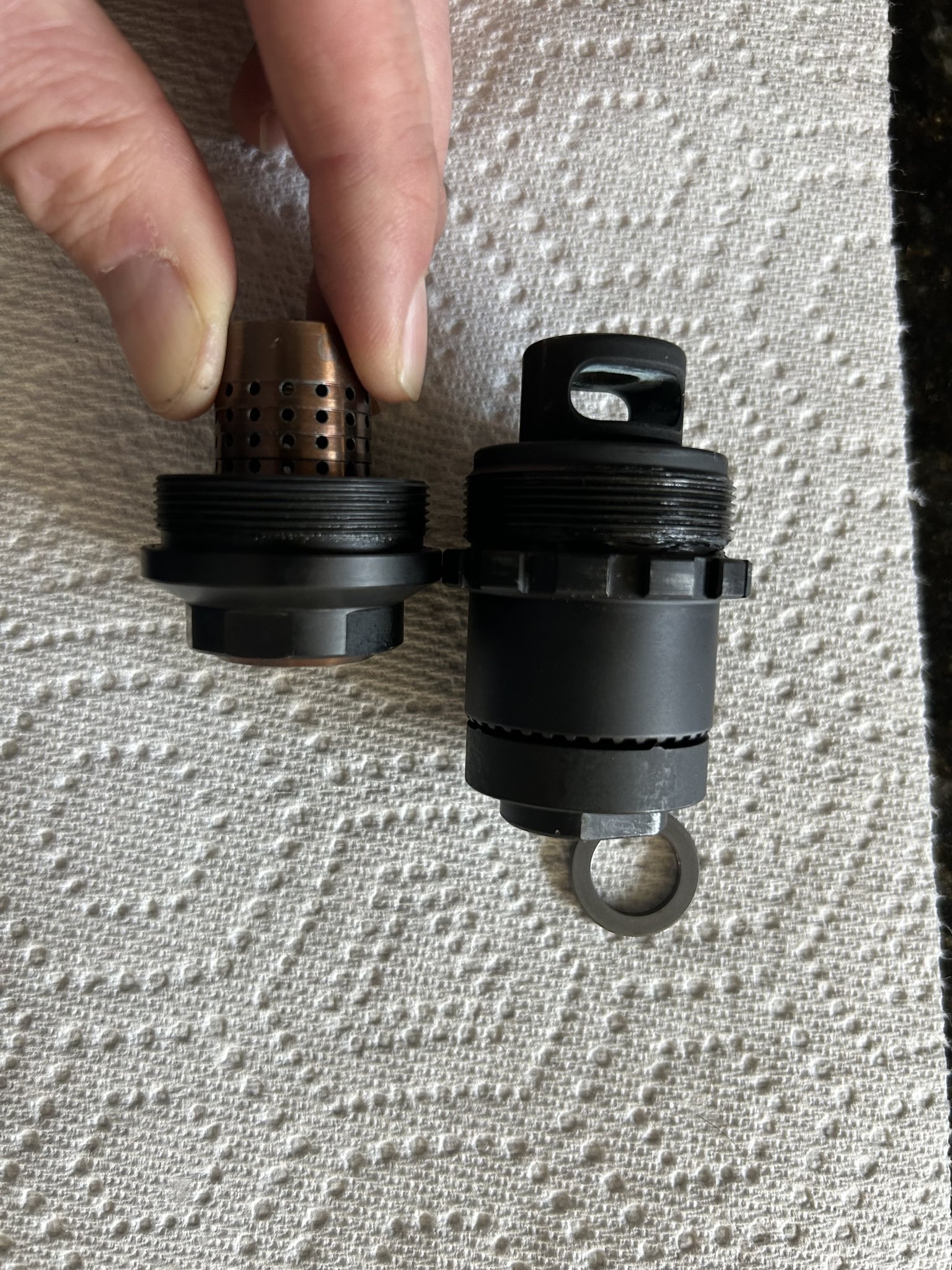

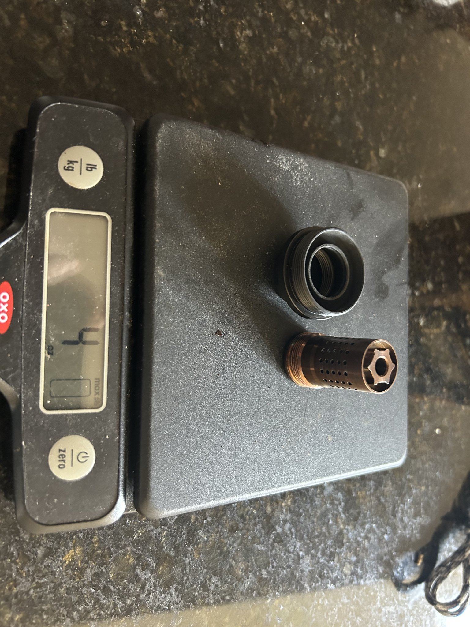

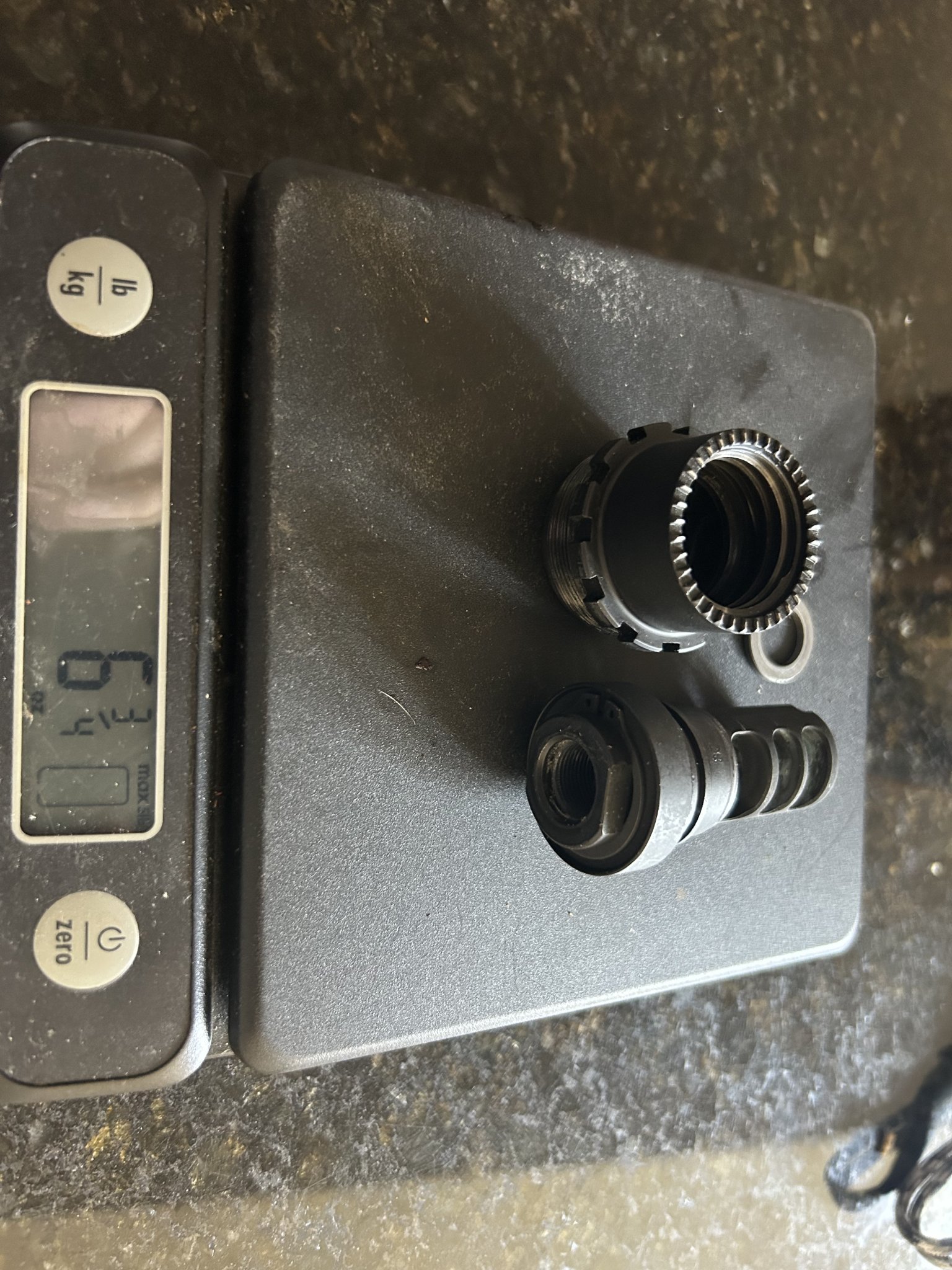

    There’s about a 3 oz diff in weight and about an inch difference in length between the YHM phantom and the Rearden/cherry bomb systems. I made the switch for most of my guns, but I have 2 that still wear the phantom brakes. The only real down side to the Rearden/Q stuff is the cost of entry. $1500 on mounts and adapters is a pretty big pull to swallow.
    BTW, how do you adjust the phantom collars for lock up? That would eliminate my biggest complaint with their system. Thanks.
    You turn the can pretty hard and when the teeth get point to point you can use a flat head or tip of knife ect and stick it in the joint there and move the collar just enough that it will go to the next tooth, making it lock up really tight for the ones you need it to. So you are adjusting that collar on the brake more so than the mount

    That's good info. 3oz isn't a ton but it's not nothing hanging off there either. Not sure it's enough on its own to warrant a change either
    Ok, cool. This is what I do, and I have a set of flat-jaw pliers that make it pretty easy. And, I found that a light coat of motor oil on the taper of the mount can get you that last little bit of turn necessary to lock up on the next tooth. But, I have one combination that- no matter the effort- will back off just a bit but the collar just won’t click over to the next tooth. This, and having a pile of unused cherry bomb brakes (another story), lead me to Rearden…

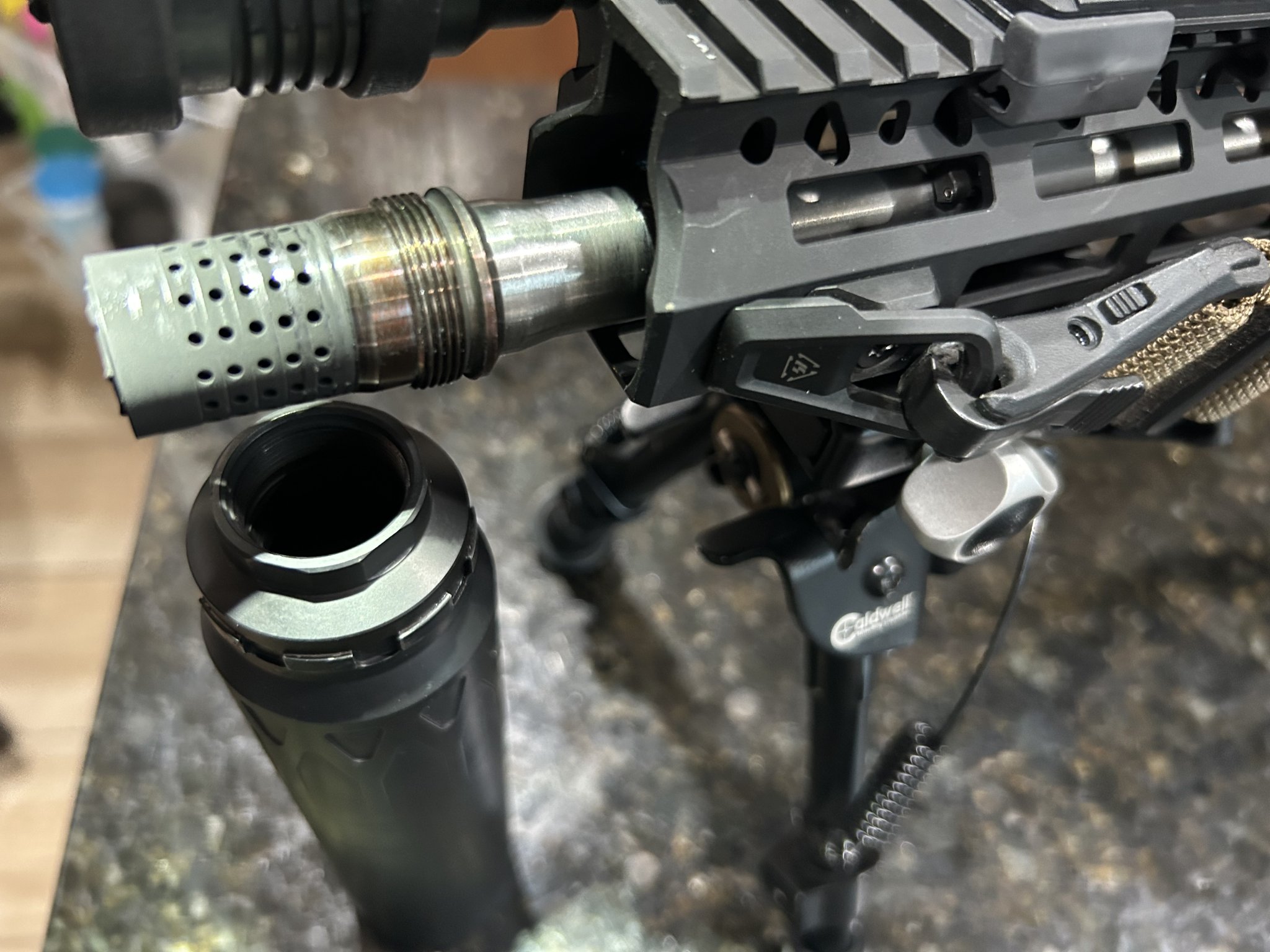

    One word of caution in regards to the Cherry bombs: they don't have any external wrench flats, so if they get stuck in the suppressor you are hooped.
    All the Rearden stuff has external wrench flats.
    Hmmm. I didn't realize that. Yeah that's gonna be a deal breaker there. Gonna have to have a flat on it or socket end or something.

    Unless you are using a Q can, the lack of wrench flats is a non issue. In the event that you stick a mount in the adapter, spin the adapter off the can. The cherry bomb has a point for a socket built into the front.
    But, if you ARE using a Q can, yeah the lack of wrench flats on the brake is a pita if it gets stuck in the can.
    Here’s another data point. I had a rifle at the range today; Q cherry bomb brake and Rearden Atlas mount. I had hand tightened the can onto the brake before shooting. Towards the end of the session, the suppressor was toasty, not glowing or smoking but definitely too hot to touch. Anyway, I wanted to remove it, but it wasn’t budging. Two hands on can (with a Silencer shop silencer removal tool pot holder thingy), stock between legs, red face, the whole works. It was on there. I said “fuck it, I don’t need to know the poi shift” and shot some more before heading home. Once home, and with the can cool, I gave it a go at removing the can again. It came off easily. And, in the pic below you can see how well the taper does at keeping fouling out of the threads. I have read that if you shoot enough, the carbon that builds up in front of the taper will carbon lock the supressor, but I haven’t experienced that.
    I'm sure it would as would any interface without cleaning at some point. It does look like it did a great job of keeping the crud off the threads of the brake
