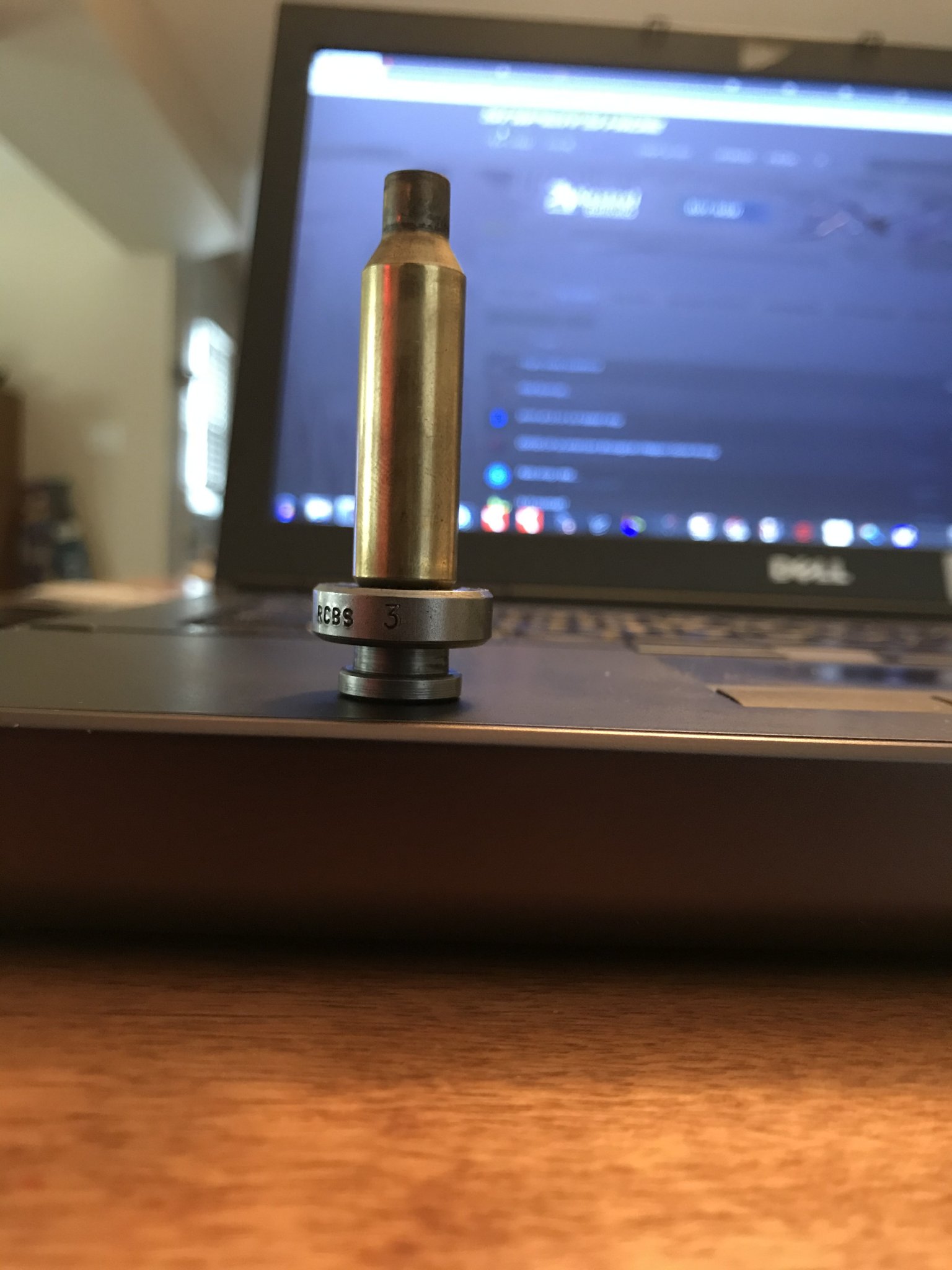

Anyone else have problems holding shoulder bump to a tight tolerance?
My headspace dim varies by .003 with an occasional outlier of .006 or so. I am guessing that much of it is caused by springback?
Youre gonna have to give way more info than that, actual details, for any sort of real answer. Im inclined to place blame on your measurement techniques or shit brass at this point.
Not spring back. Press rigidity perhaps, press technique(hold at the bottom of the stroke).
Redding comp shell holders are great, try them.

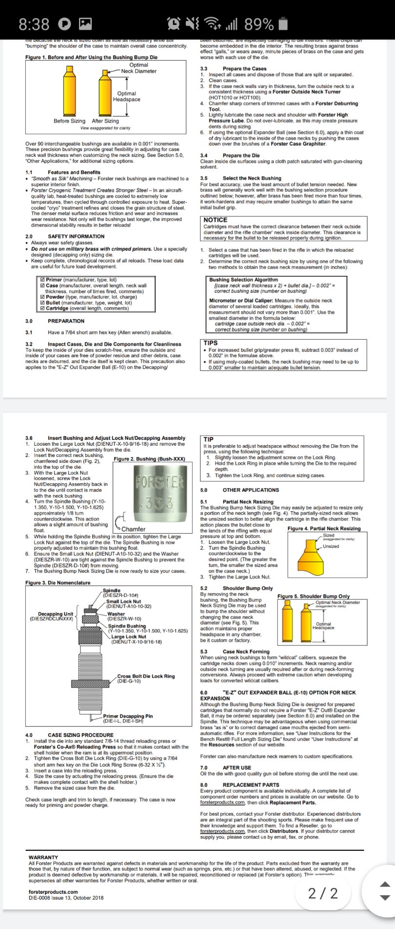

My Hornady full length die didn't size enough of the case to use brass shot in one chamber, on a different chamber. I had to switch to a Redding full length die to get the whole body sized. Different situation, completely, I know.
Reactions: Curt193
With a .002 bump, are you sizing all the way down the side of the case past the extractor groove?
Not that a couple though is likely to make that difference I guess.
You cant size that far and still get the case back out. The shell holder has to grip there.
I can get there, and my Redding die does.
And that’s what I don’t understand: how it does that without body support.
Unless it’s just touching tangentially along the sides and not actually pressing at all? But that’s a super fine line to ride and I don’t see how it could actually work properly in all but a few coincidental situations.
