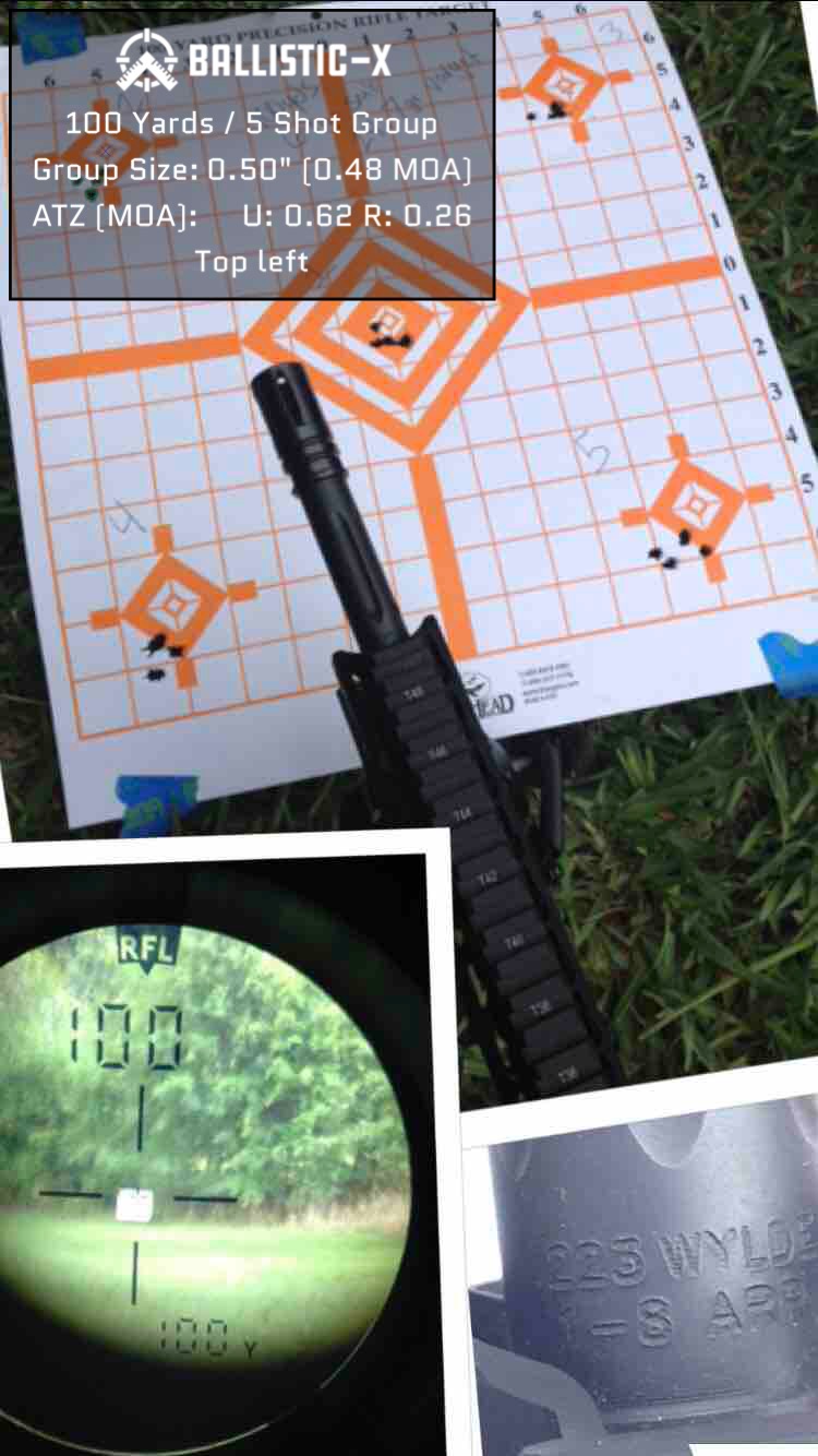

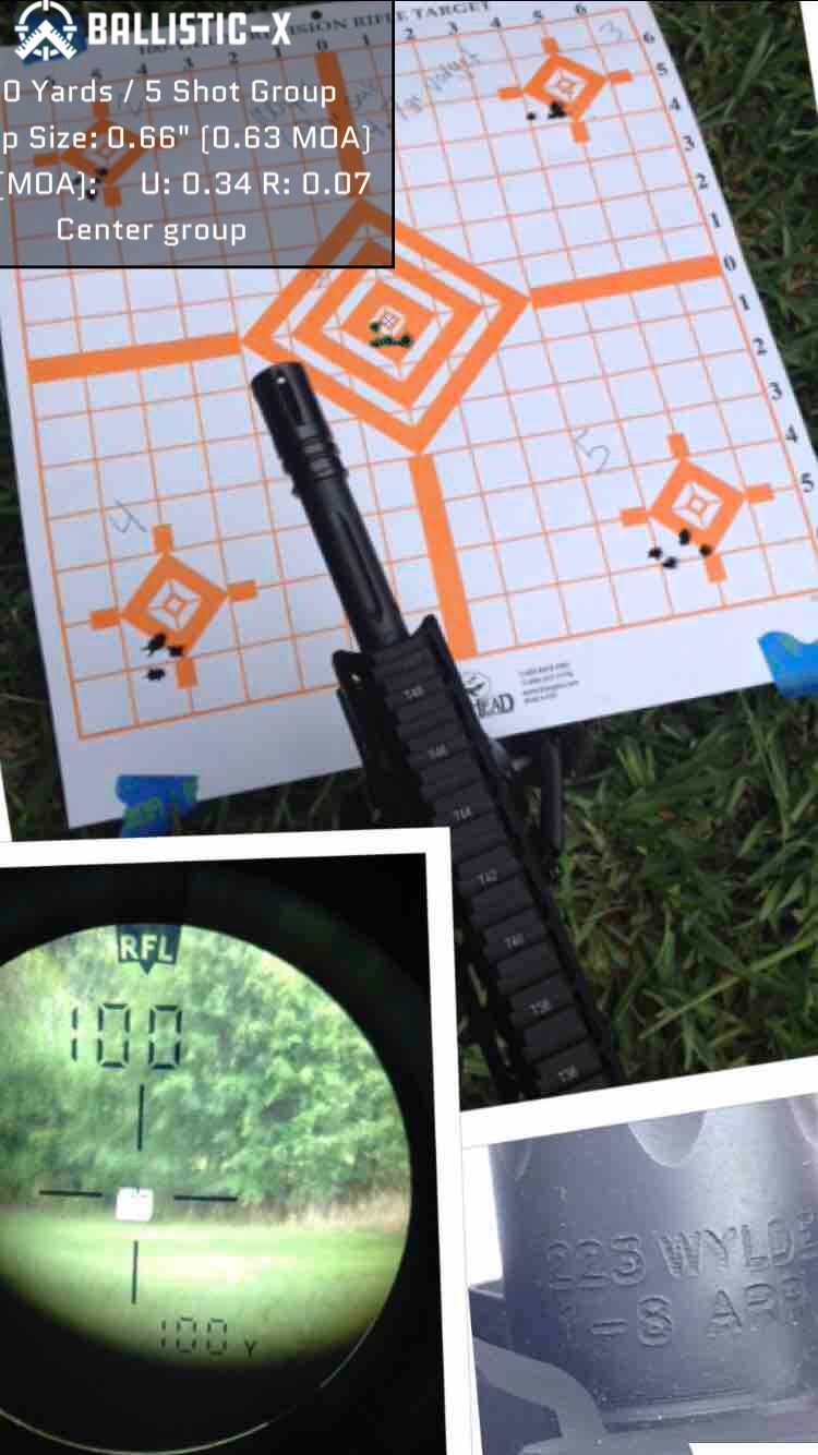

Range Report Show me your AR15 5 x 5 tests

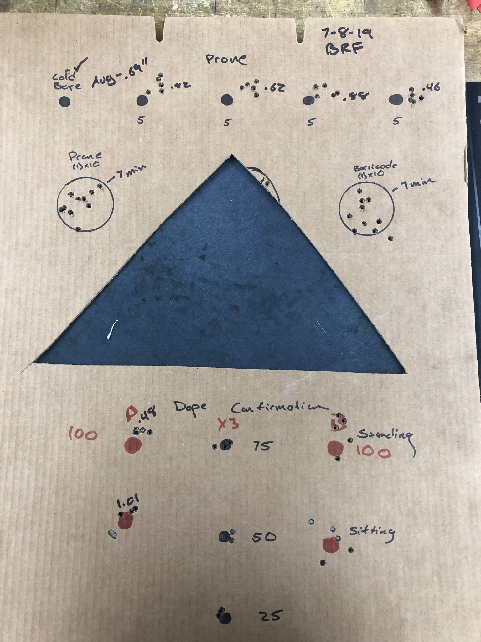

Top left is CB, then 4 (5x) groups accompanied by 2 more (5x) groups at bottom left
6 (5x) Avg - .69”
2 MOA circles were times barricade drills
Bottom middle is just close range dope confirmations
L

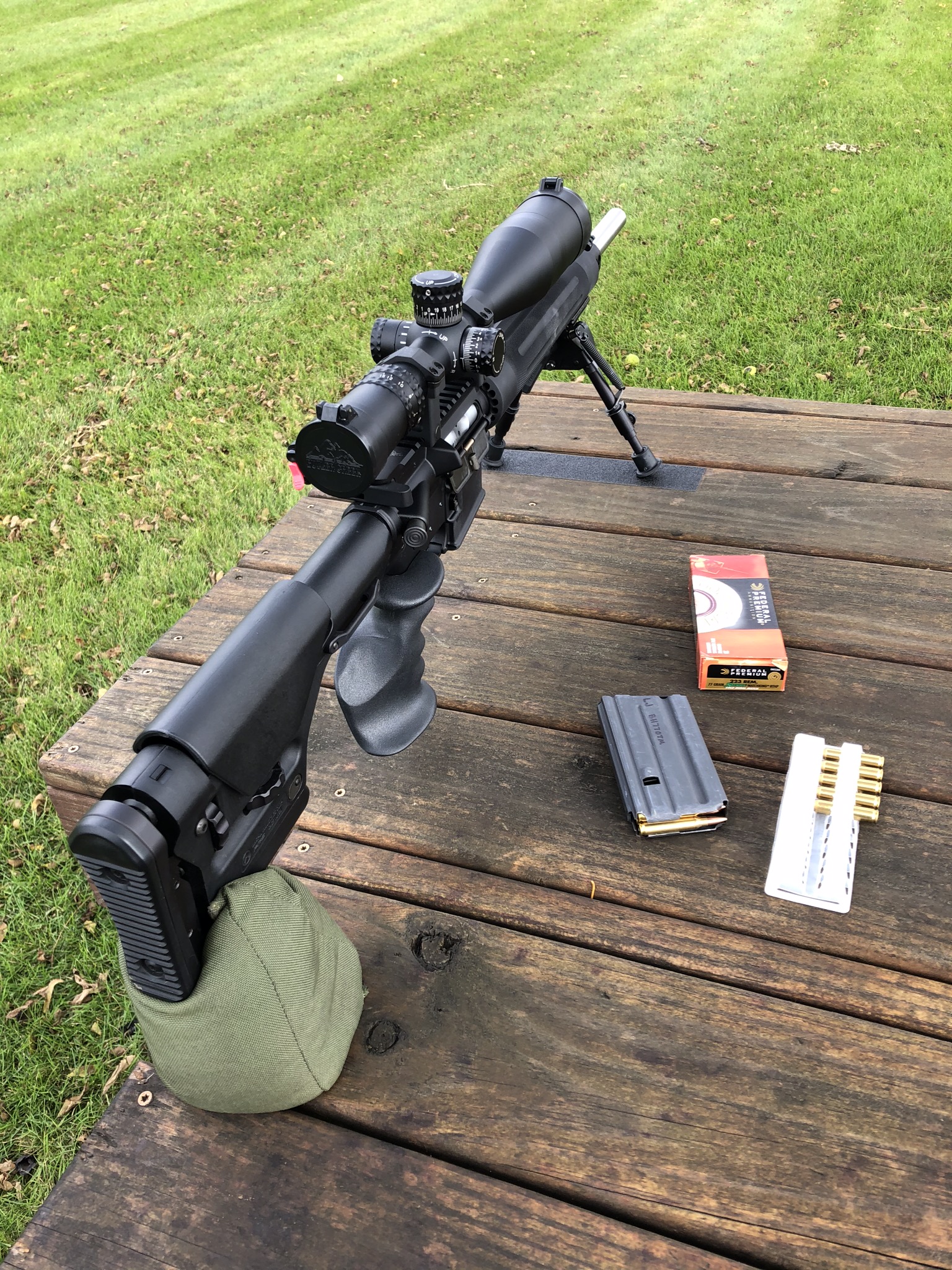

Home build:
18” AR15Performance 223 wylde barrel
BCM upper and handguard
LMT defender lower
Colt BCG
Geissele SSA-E trigger
Bi-pod and rear bag
Had a fixed 20x SS scope I use for load development
Elevation was adjusted 1/2 moa down after the first group to make sure I kept a clean poa. These groups were shot back to back. I didn’t give the barrel a cool down between groups. Some people may not agree with this method but I like to see how the groups shift and open as the barrel heats up during longer strings.

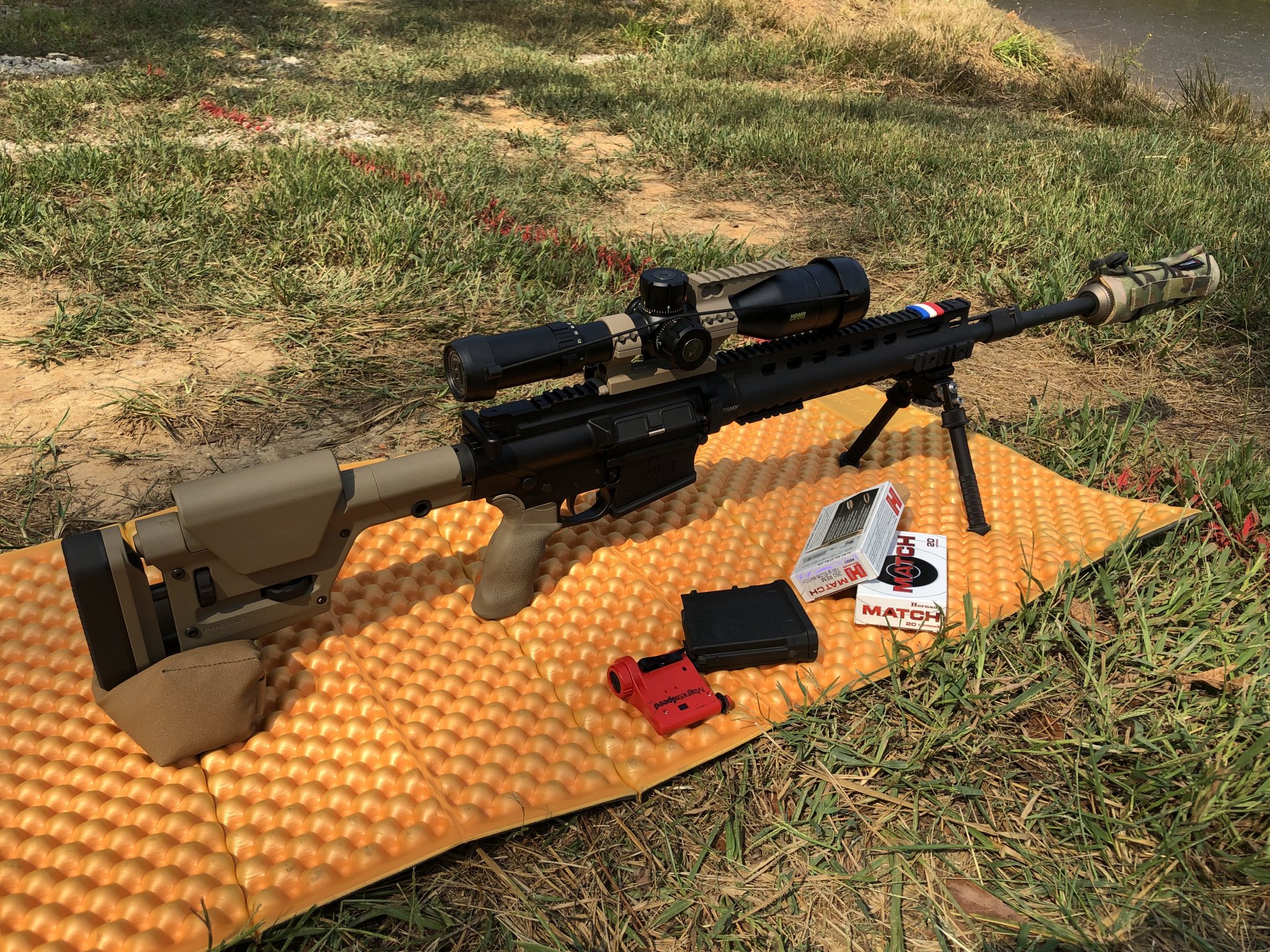

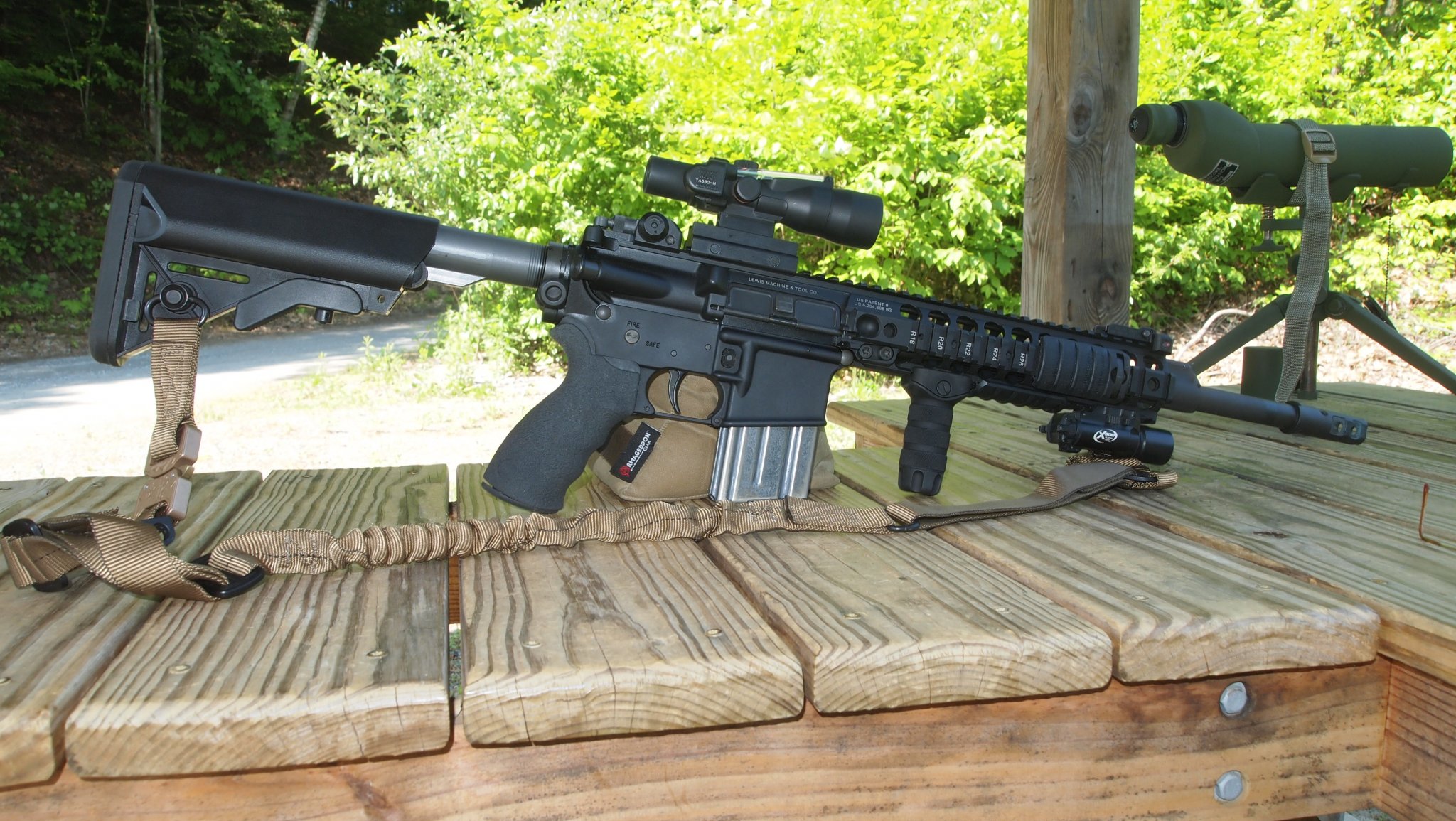

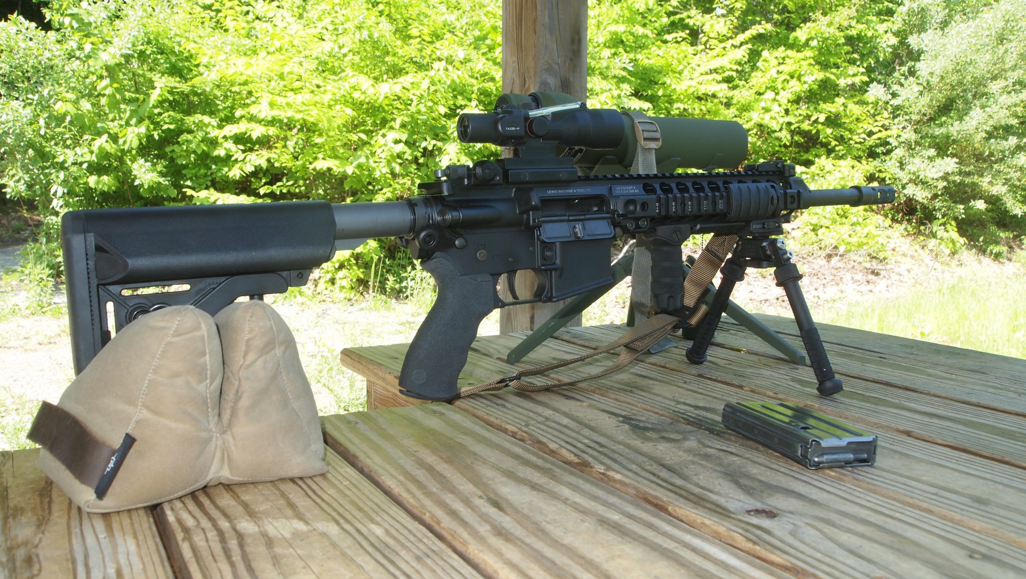

Rifle is an LMT CQB. Its pre shoot configuration....
Barrel is standard CQB chrome lined 1/7. Optic is an ACOG TA-33. Looking at the pic Im thinking I need other than the standard ACOG mount, seems kind of high. Trigger is the LMT two stage that was originally in my MWS.
After shooting I moved the light to the right side rail and the stubby grip went further forward. Im trying to move on to shooting this style rifle with the support hand up toward the end of the rail. Barrel has about 3,000 rounds, desire is to one day have the extension put on a better quality barrel.
As set up for shooting the 5x5....

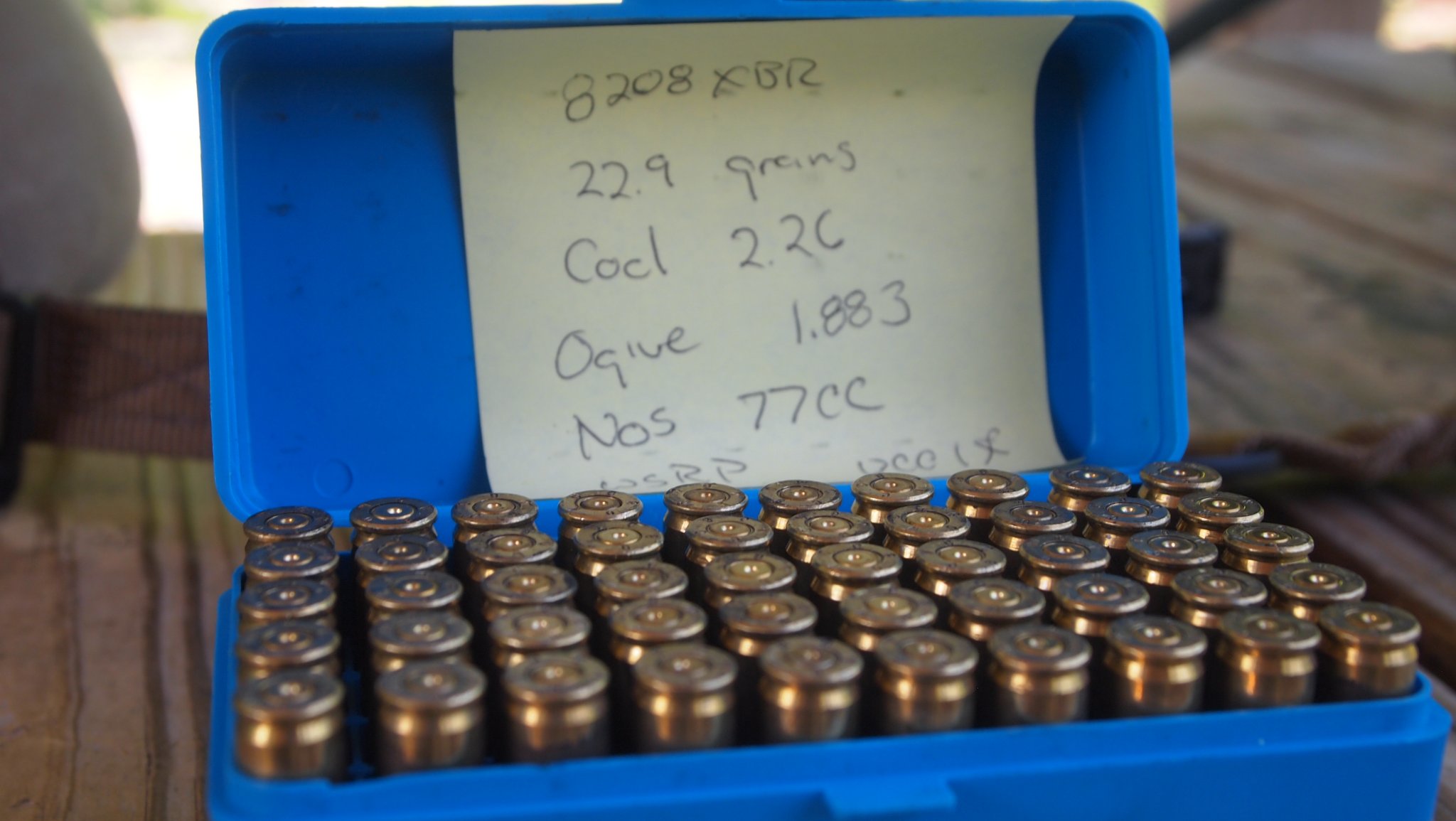

Ammo spec....

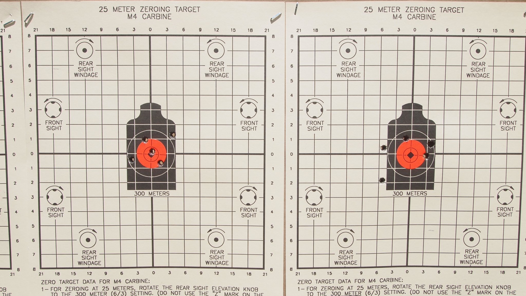

Targets 1-2.
Made a windage adjustment right after these two groups.

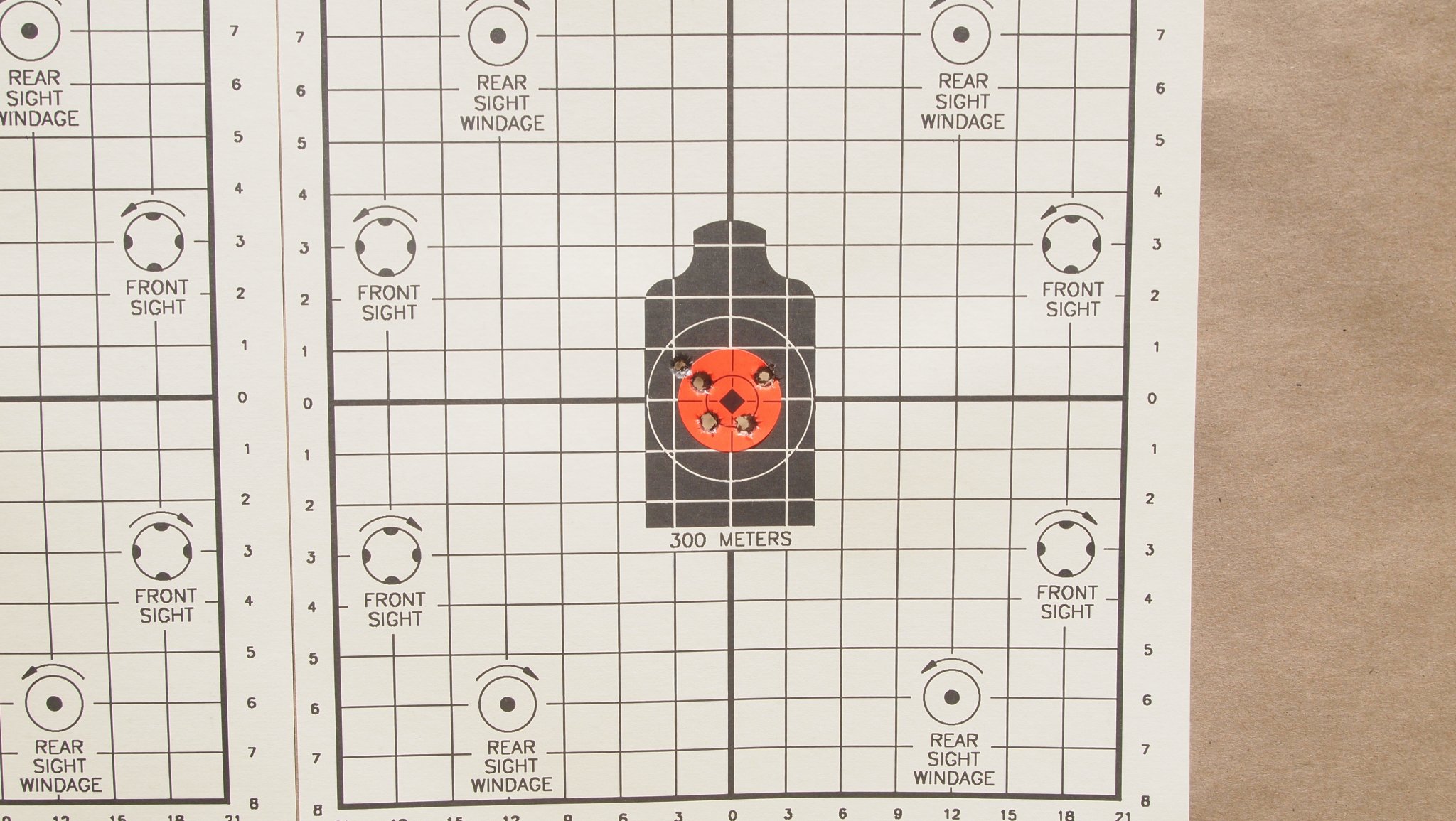

Targets 3 and 4...
Target 5
Paster is one inch for reference.
Targets 3 and 5 would be my ideal if I could do it consistently. I wouldnt ask anymore than that from what I consider a "defensive" rifle.
The ACOG center dot pretty much covered the entire black silhouette at 100 yards but holding center of paper worked well enough.

I see I’m not the only one who put a nylon synch strap on his M49 and tripod lol.
...I’m also running an LMT but mine is the SLK8 w/ the CL 16” 1:7.

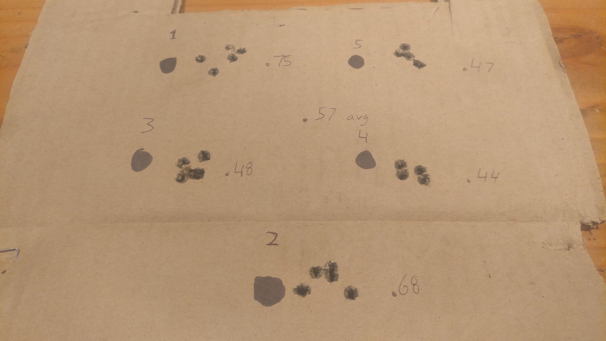

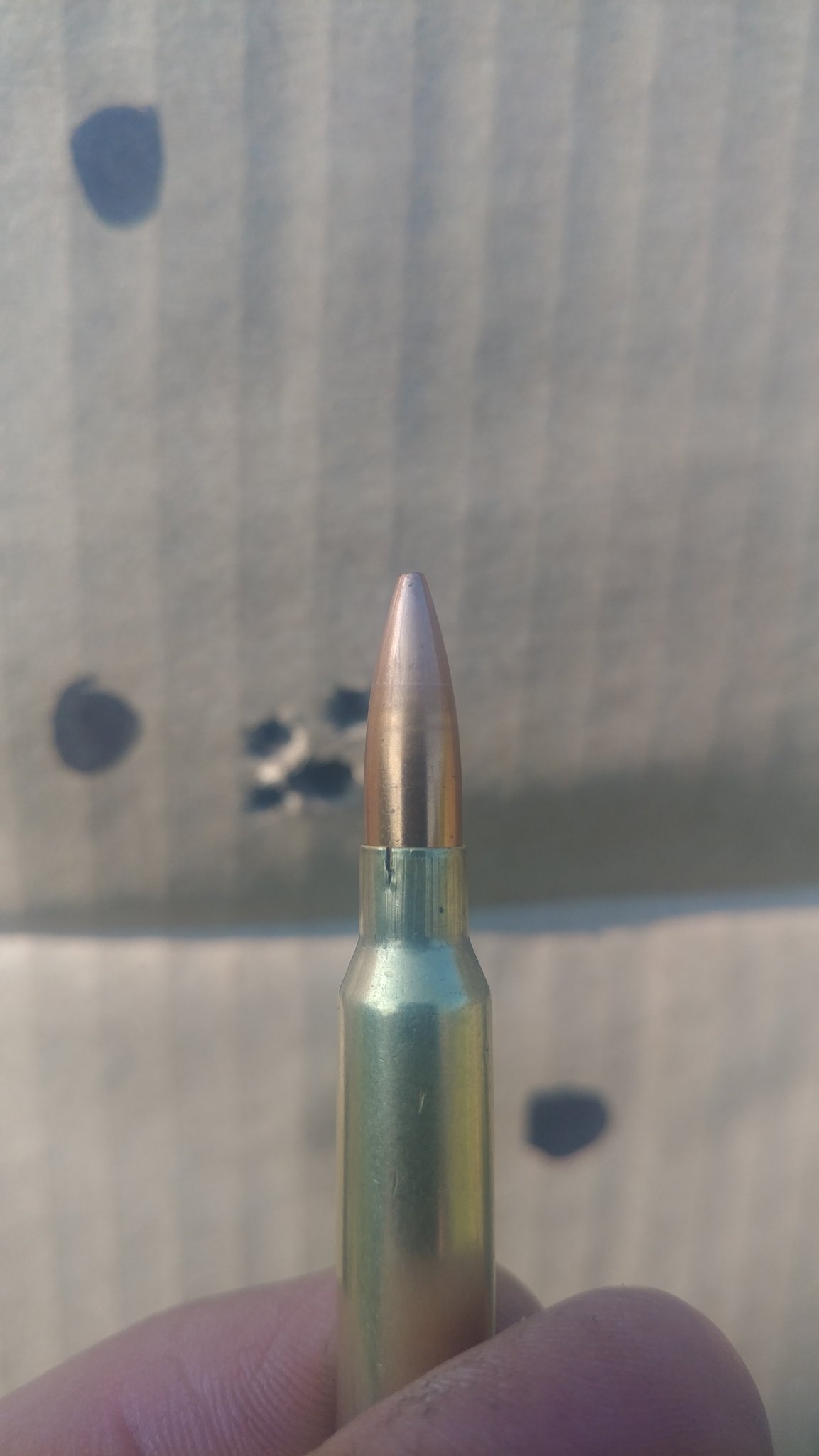

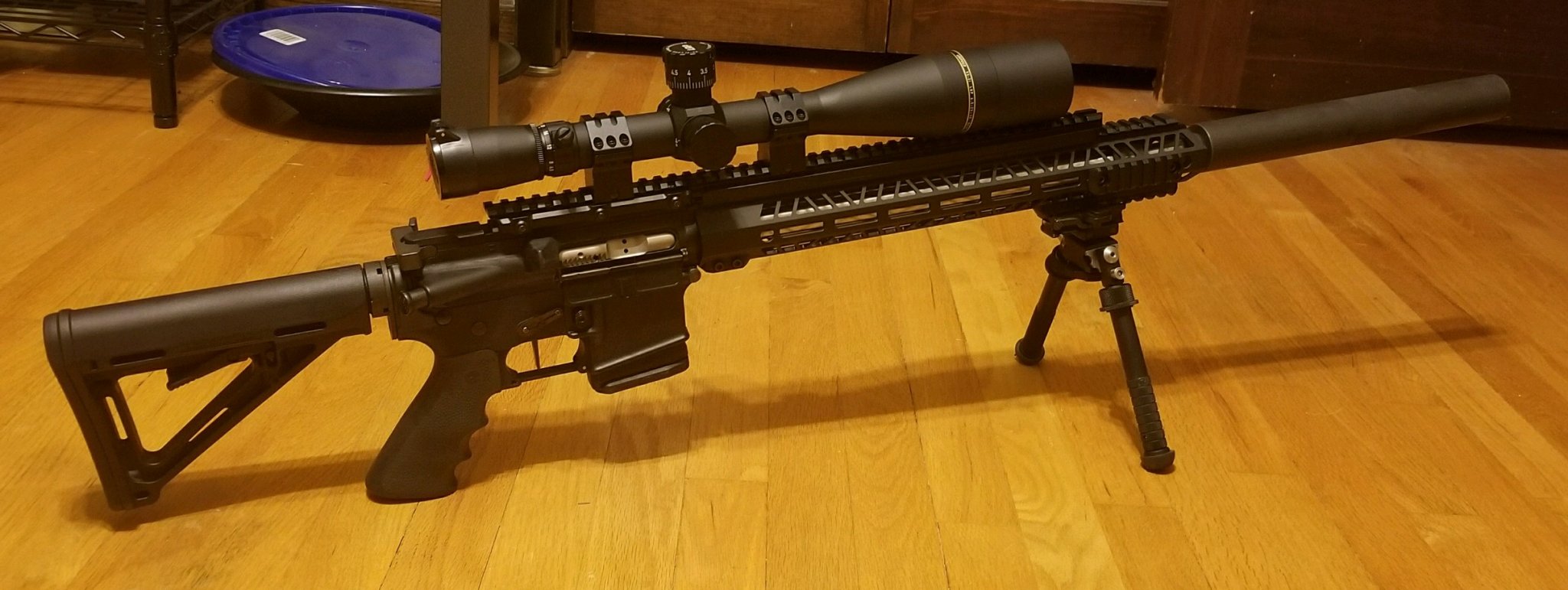

Decided I'd try this 5x5 thing just to see what all the fuss is about. Threw some 8208 in some cases and stuck a 77 SMK on top (never tried them before), thats it for load development. Walked out back and got prone with a rolled up shirt for a rear bag and did some shooting.
I'll get the excuses out of the way before pics:
1. I hate group shooting.
2. Light mirage
3. Light wind
4. I hate group shooting
5. This guy was in the top left group:
Turns out with two meh groups I still averaged .57 MOA, I can live with that.
What barrel are you running @TonyTheTiger?
The old trusty BHW 22" 8 twist.
I was shooting 75 ELD's as my primary load but the throat must've moved past their jump tolerance range so now I'm finishing the barrels life out with whatever jump tolerant bullets I find on sale. So far 77 SMK and TMK, 77 Custom Comp, 70 and 77 RDF, 69 TMK and 68 HPBT's all shoot comfortably under MOA with no actual load development. I'll give 73 ELD's and 75 HPBT's a try one of these days too.

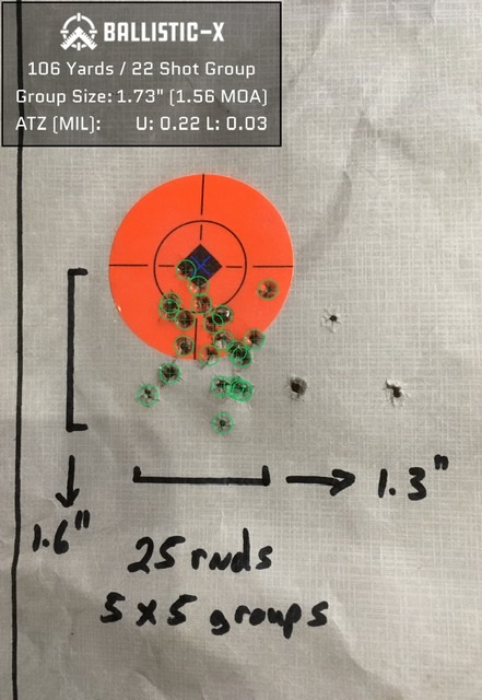

A brand new, box stock CZ Scorpion Evo 3 S1 Carbine - 9mm.
I was sighting the thing in yesterday on it’s first outing.
Nowhere have I ever read that this was ever going to be accurate, or a tack driver.
Shooting factory 115gr S&B, cheap, brass ammo. ($159 per 1000)
2moa dot on a Sig Romeo 5.
Chasing it to zero at 100yds in 2-shot groups, on a bench - basically using the 30-round mag a a monopod.
I think it has potential!
I cannot wait to get back out with it and see how it acts with different ammo, and also a decent trigger.
It will never be a long range weapon.
Suppressed it should be a bunch of fun though.
I just didn’t expect this kind of performance right out of the gate.

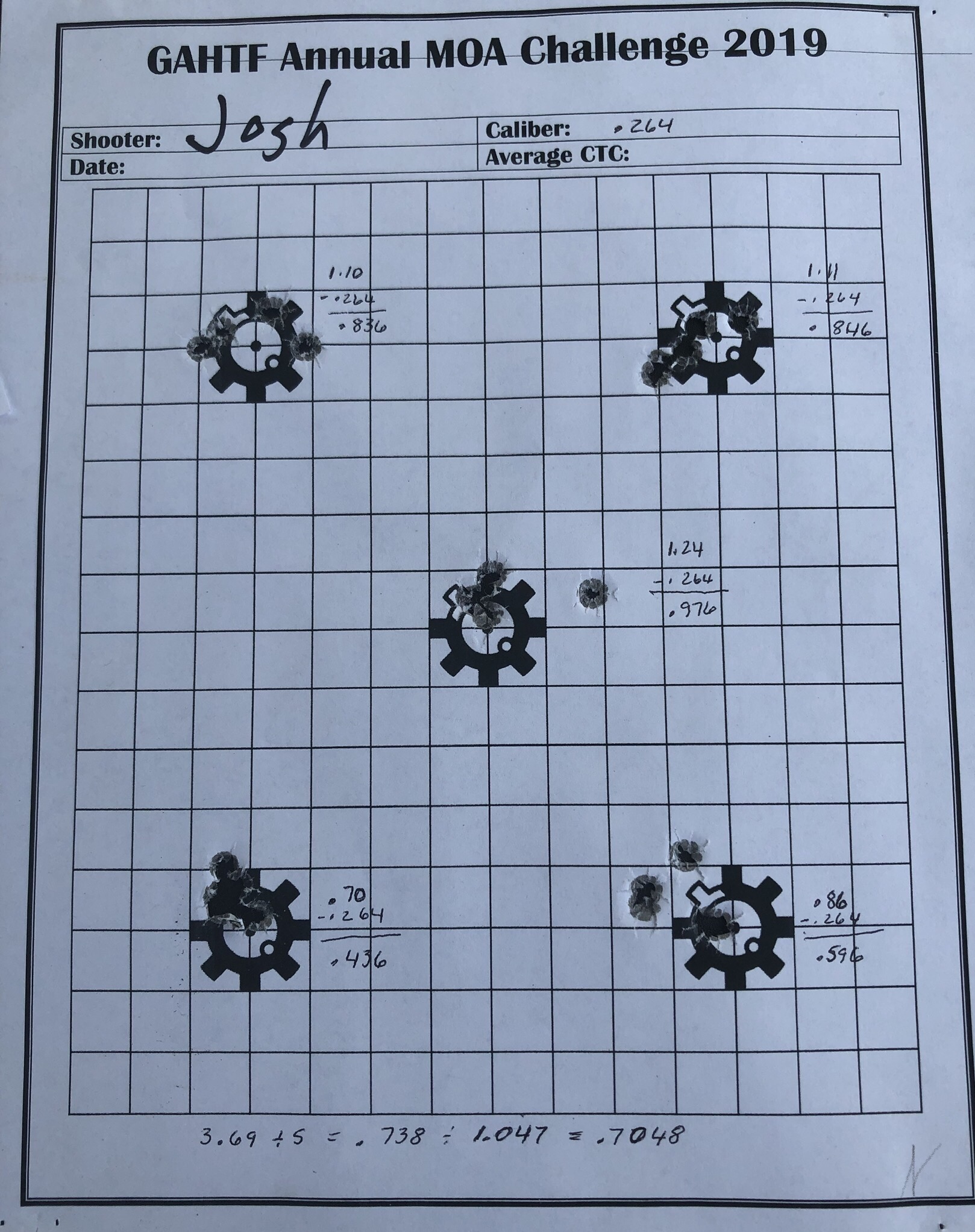

Didn’t pick the best day for this, but, I shoot when I have the time irregardless of the weather. Wife “let” me use her 20” RRA as I don’t have a small frame AR set up for precision.
Weather was 46 degrees, BP of 29.66, and wind 5 to 7 o’clock at 22 gusts to 34 mph.
We typically run Black Hills 77 OTM’s for distance, but for 100 I just grabbed a couple of boxes of FGMM 77’s. It will typically run 0.75 MOA give or take with that ammo, and I may shoot this again using the Black Hills offering.
I was getting a fair amount of wind buffeting me as it was quite strong, but, it is what it is.

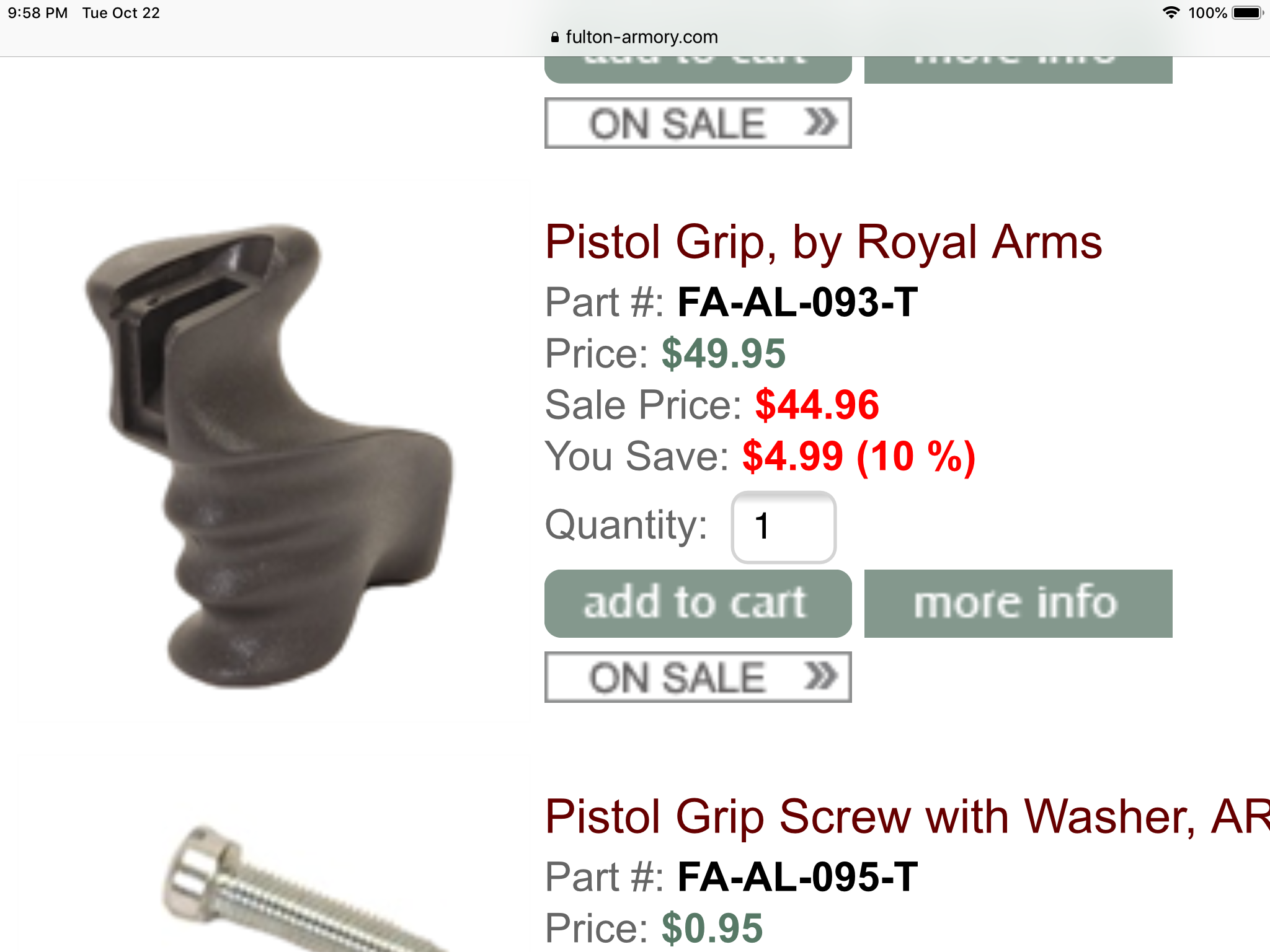

What grip is that? Has a thumb shelf or just an odd angle?
Had to do some digging around to answer your question. The following pic is a screenshot from Fulton Armory’s website where I believe I purchased it. She likes it, I don’t care for it so much. I run a fairly standard grip on my GAP10. I assembled her RRA approximately 10 years ago.

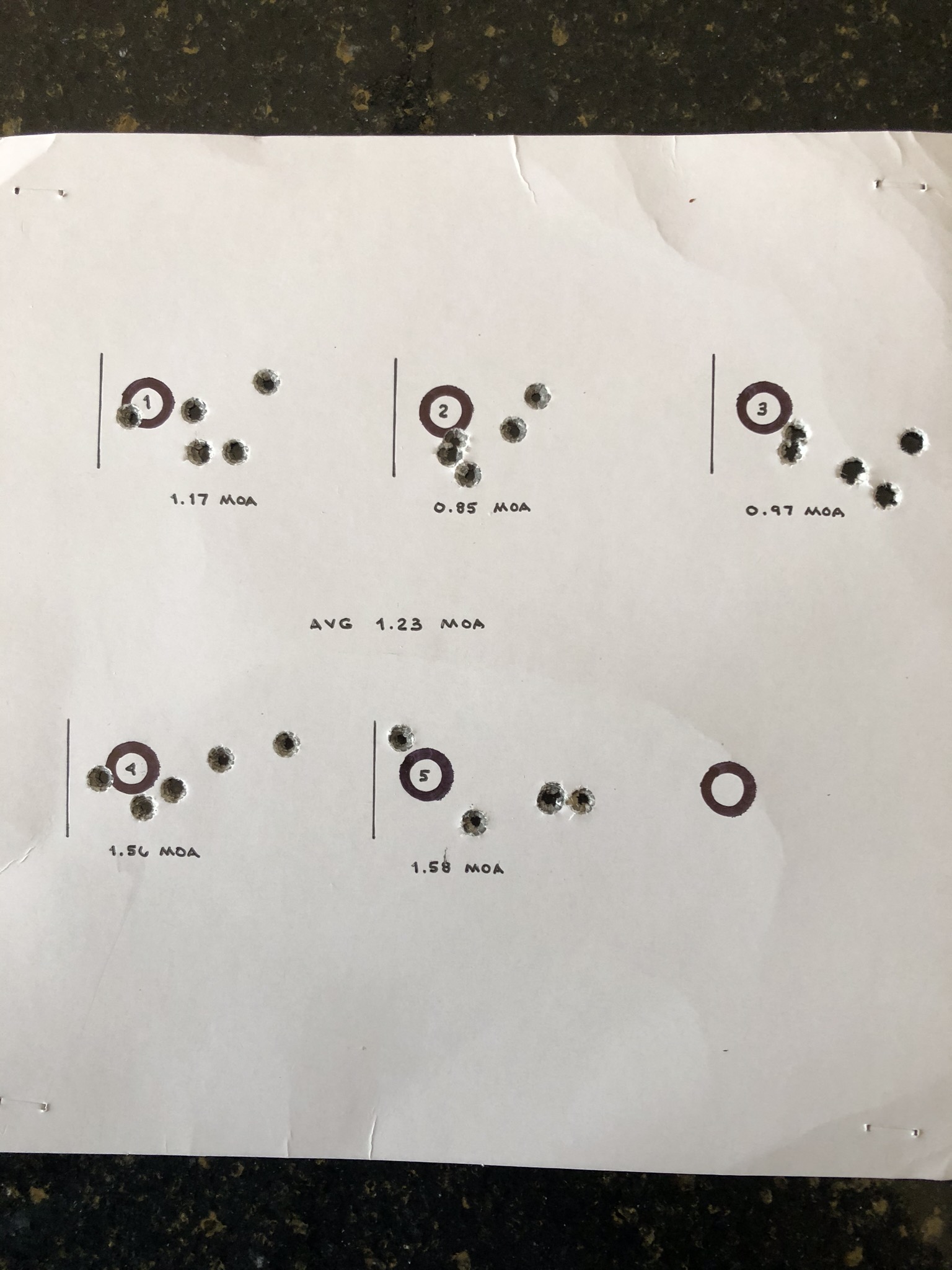

After shooting a 1000 yard steel match yesterday and a "F" class match today, I figured it was time to put the bolt gun away and pull out the AR to try this out. Turns out either I was fatigued, had an extremely bad outing, or I just suck. No excuses as I'm posting the worst 5 X 5 groups in this thread. I am going to go out again later this week to try again.
