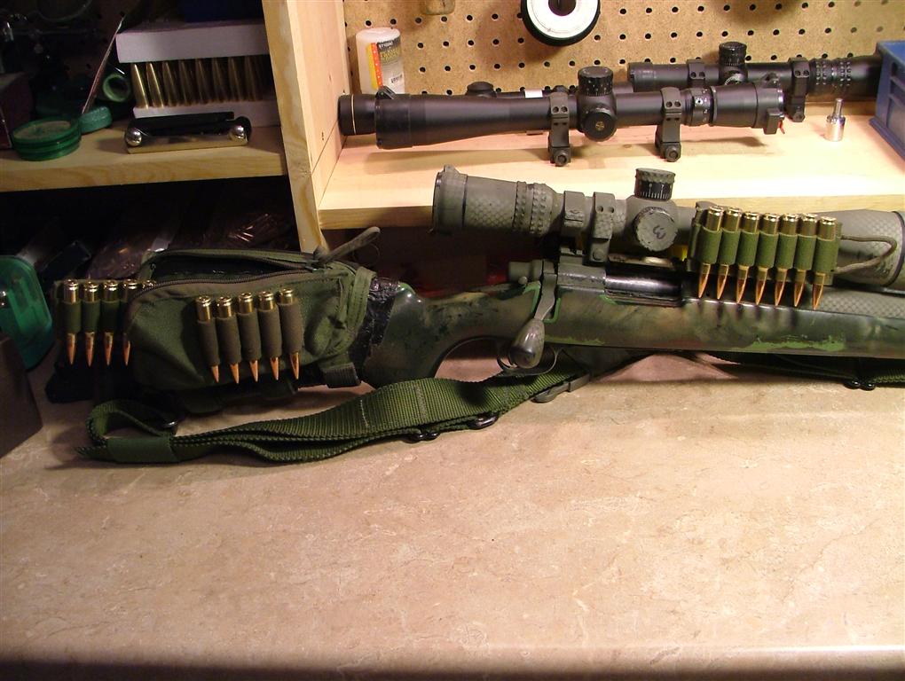

I use Frost King Self Seal Pipe Insulation over the comb. It comes in 1/2", 3/4" or 1" thicknesses in 6' lengths. Like this:
Lowes Home improvement
I cut a 6" section and wrap over the comb, and cover it with a $10. Uncle Mikes Elastic Ammo holder, like this:
I used 1/2" Pipe insulation under the Uncle Mikes on my McMillan HTG comb to get the proper height.
Re: Show me your DIY cheek piece/pads/rests
Best way is the method described above: closed-cell sissy pad or pipe insulation over the top of the comb, wrapped in duct or "100mph" tape, with an Eagle pack on top of that.
I actually cut open/re-sewed the Eagle and put a pad in there so that the taped portion on the gun still allows me to see straight down the bore (and clean it).
It feels like an adjustable A5 comb, but is waaaaay more comfortable. Oh, and it's bomber, too.

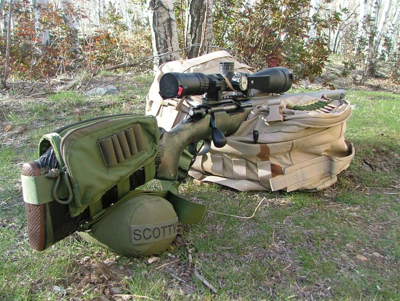

Mouse pads work well too. I picked up an imitation Eagle stock pack at my local sporting goods store for $12.00 back when they were sold out of the Eagle's everywhere.

i use the uncle mike's ammo holder with a mouse pad and a piece of doweling. The doweling is to allow a taller hight without making the sides wider which pushes my face off centre.
Down side the ammo holder when used with a bean bag or rear bag will start crawling up the stock (H&S stock) during recoil.
