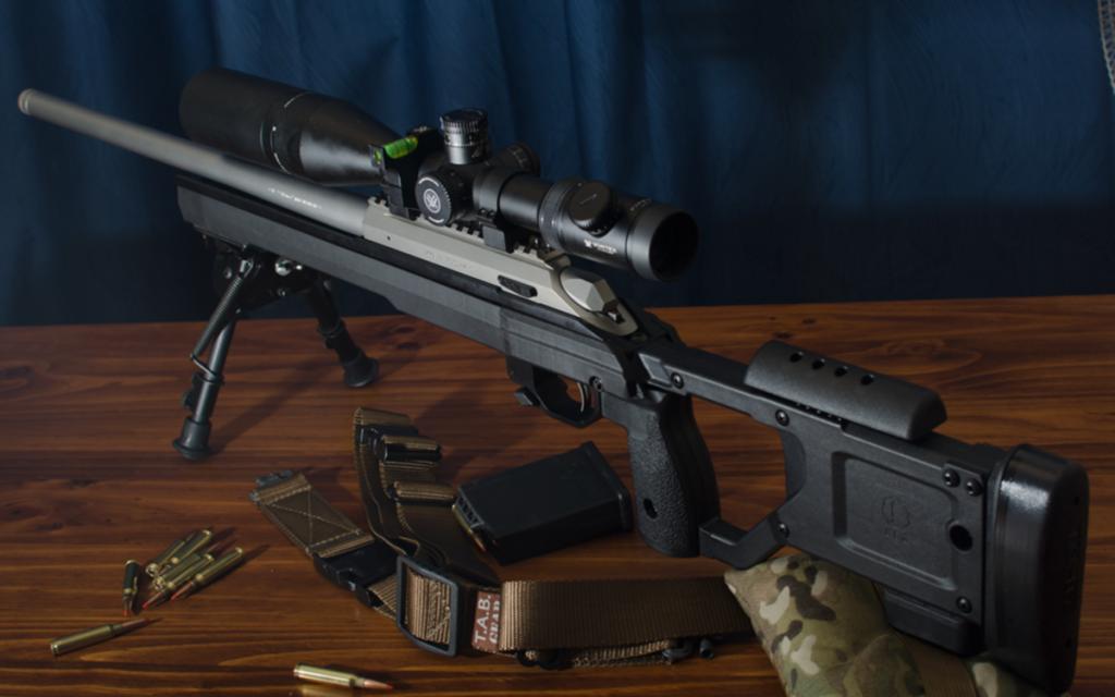

I have both a stock 223 1in 8 twist and a 308 shown below, both are honest sub .5moa rifles

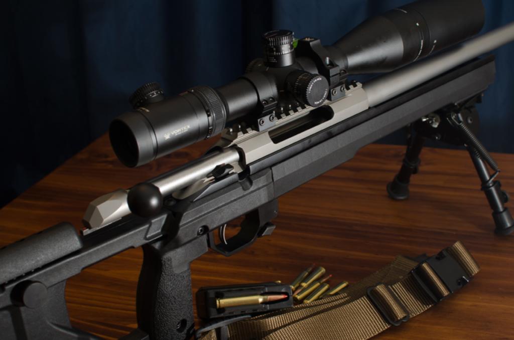

My tikka 308, soon to be outfitted with either the vortex 4.5-27 or Steiner 5-25 txi, time will tell
Like this one?
Just started to load my own ammo for it and got some loads for Sierra 180grain Gameking and 168grain Matchking for it.
Oh, and it got a Accu-shot monopod today. I can hardly wait for more time at the range.
The swept ball handle is really comfortable to use, the ball fits right in the palm of your hand when you chamber a round. The Pineapple handle is deburred and polished so it's not too rough, the Cerakoted version is less rough again because it's been blasted and coated. Some people are after a 'look' some people are after a particular functionality or ergonomics.

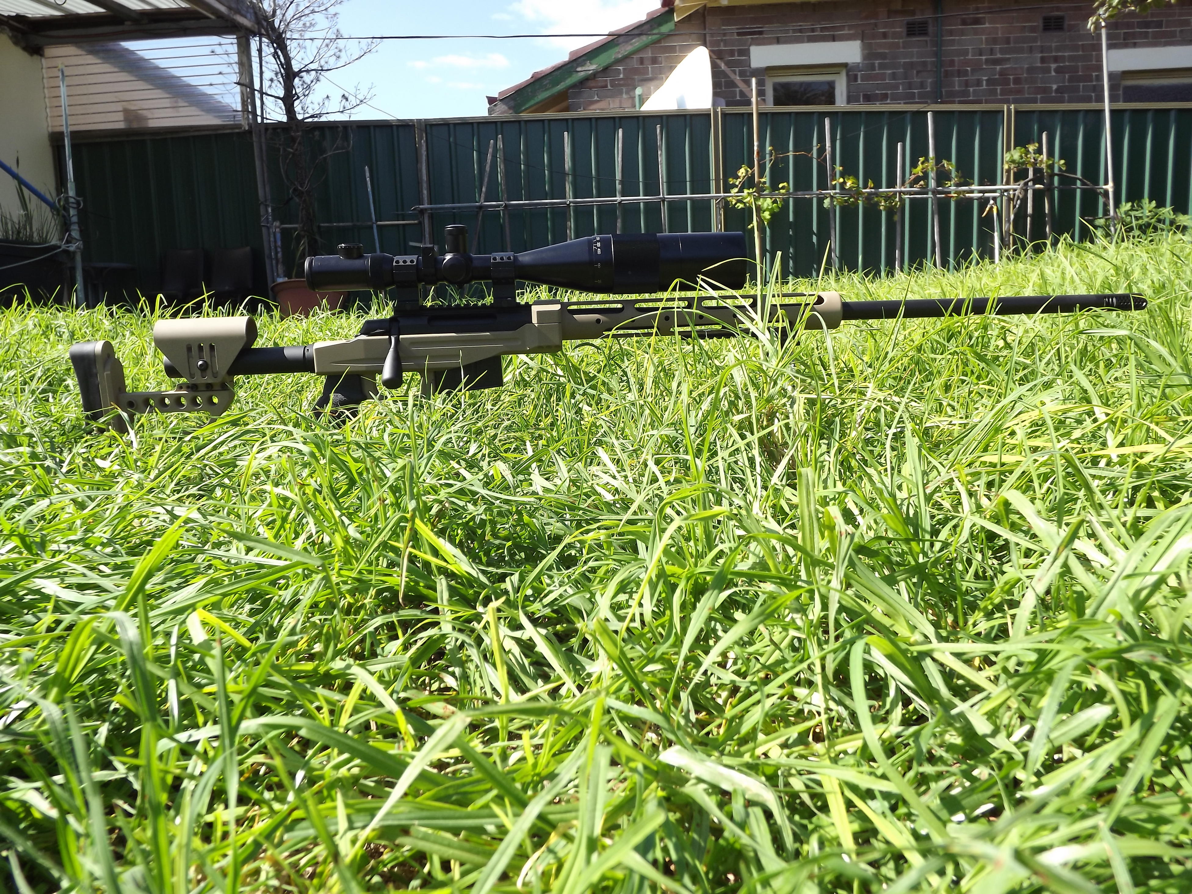

About time I contribute something here I guess.
Here is my Tikka T3 Super Varmint in .223 with a 1:8 twist 20'' barrel.
I just got the KRG X-ray for it in the mail, it also has the bolt handle already discussed in this thread from cannoncrossfire along with the bolt shroud he does.

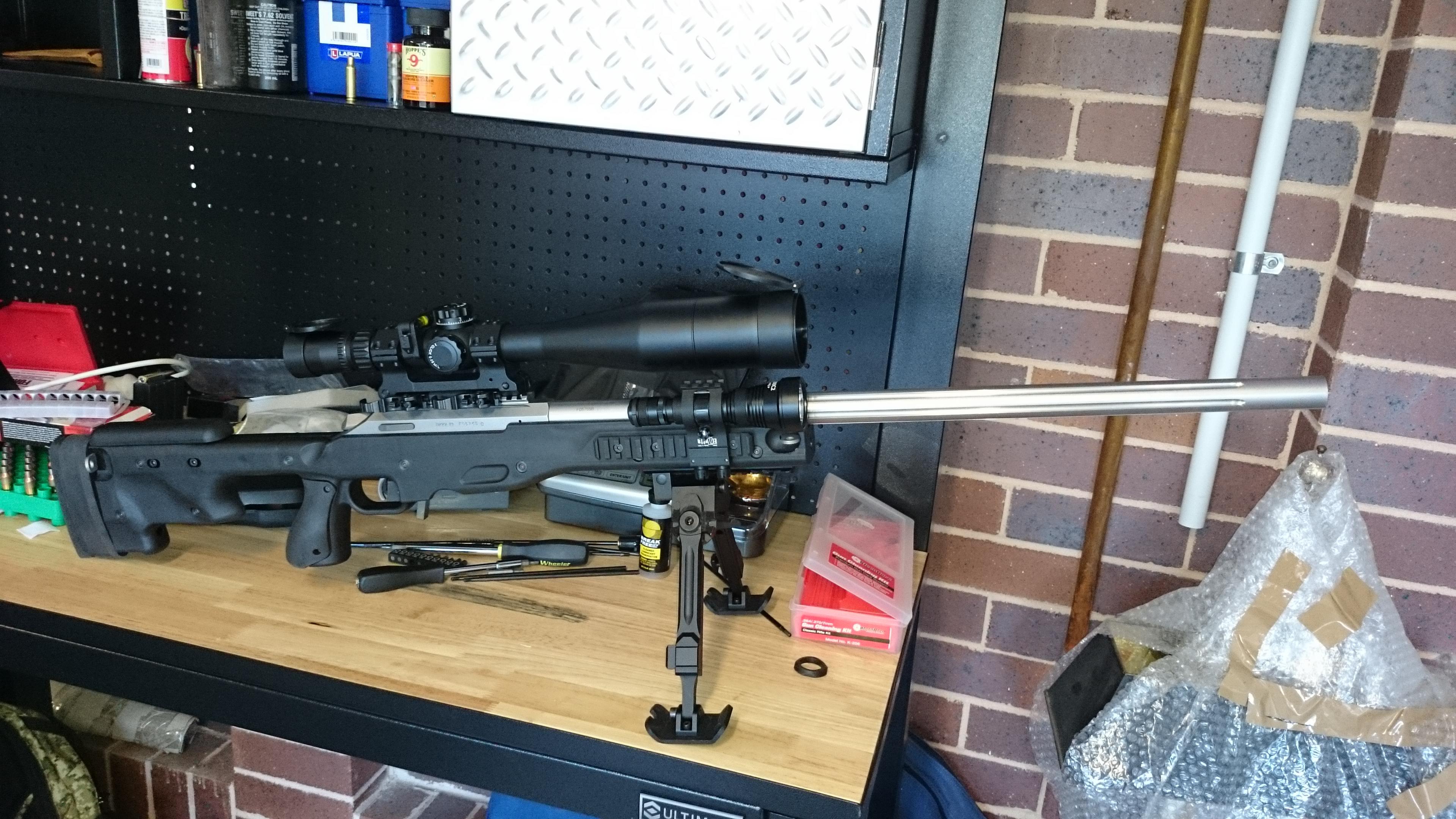

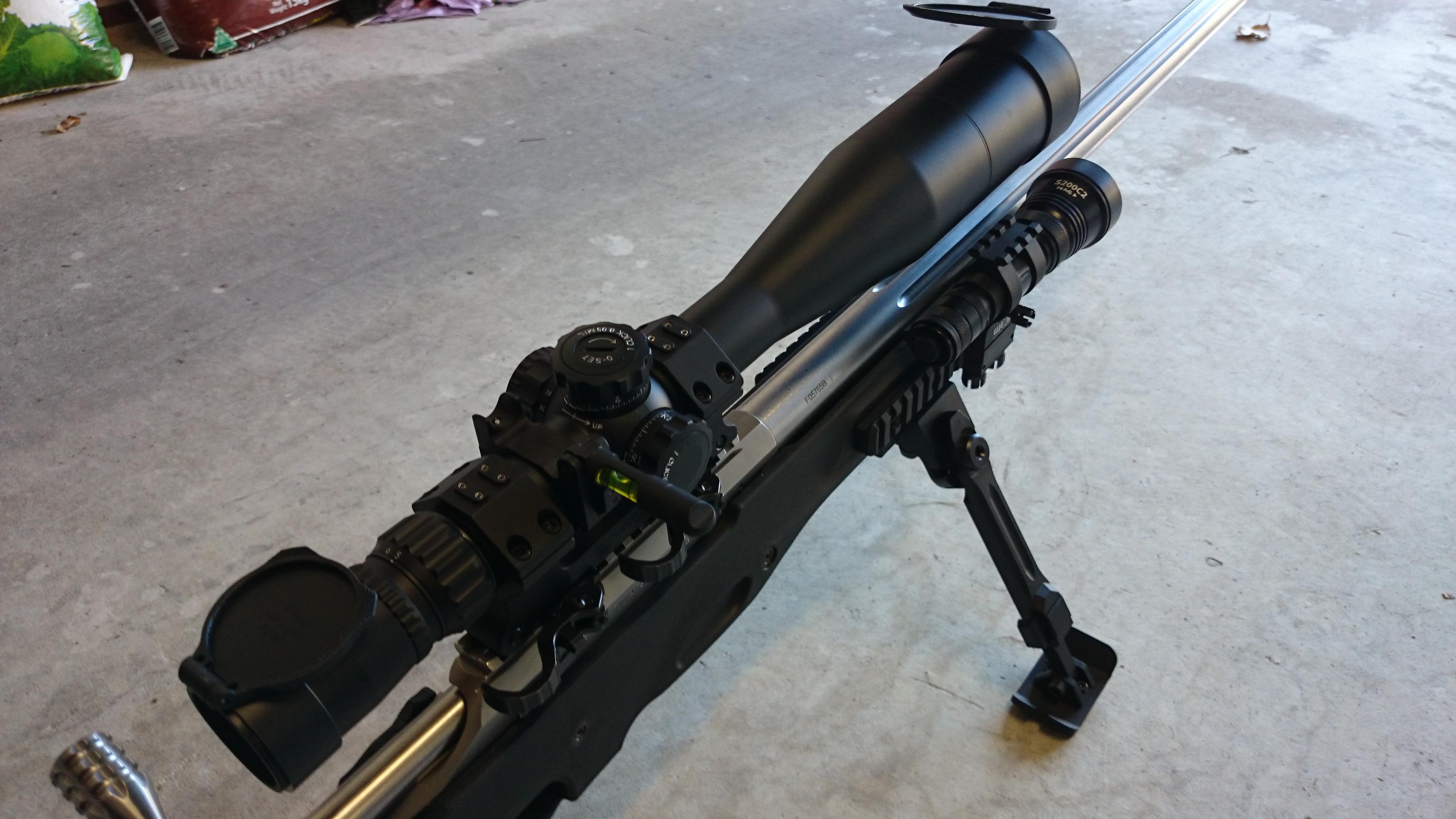

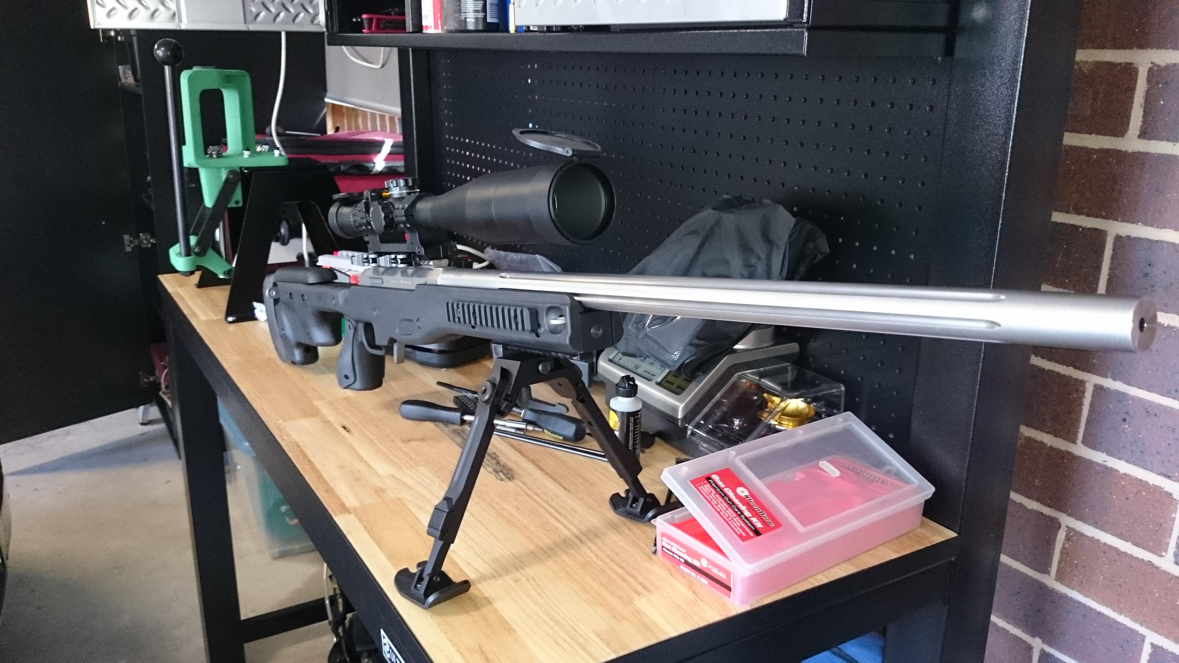

Here is the latest iteration of my Tikka. It started off as a stainless left hand varmint model, 7mm-08. I originally bought it for hunting but a property I was promised regular access to fell through. So with that in mind I set about changing the rifle to something more tactical and I intend to use it in F-class later this year and the odd tactical match when they pop up in Canberra.
So the build now consists of:
Roedale Precision RCSII chassis
Roedale Precision 20MOA scope rail
Roedale Precision Bipod
Viperskins with oversized pistol grip and side and under picatinny rails up front
Sterk titanium bolt shroud
Sterk pineapple titanium bolt handle
Yo Dave $10 spring to lighten the trigger (best guestimate is that it's now at about 700-800grams)
Maddco 26" match grade fluted barrel, re-barrelled to 6.5x47 lapua, 1 in 8 twist
March 5-40x56 FFP scope, illuminated
March flip-up scope caps
Era-Tac 1-piece adjustable inclination mount with Flatline Ops bubble level
I could get this shooting sub 1 moa groups at 100 metres with factory 7mm-08 hunting ammo so I'm very keen to see what it can do now that I can reload and get some match grade target projectiles down range. I plan on trying Berger 130gr VLD, Berger 140gr hybrid target and 136gr Lapua Scenar L rounds. I figure at least one of these should prove worthwhile.

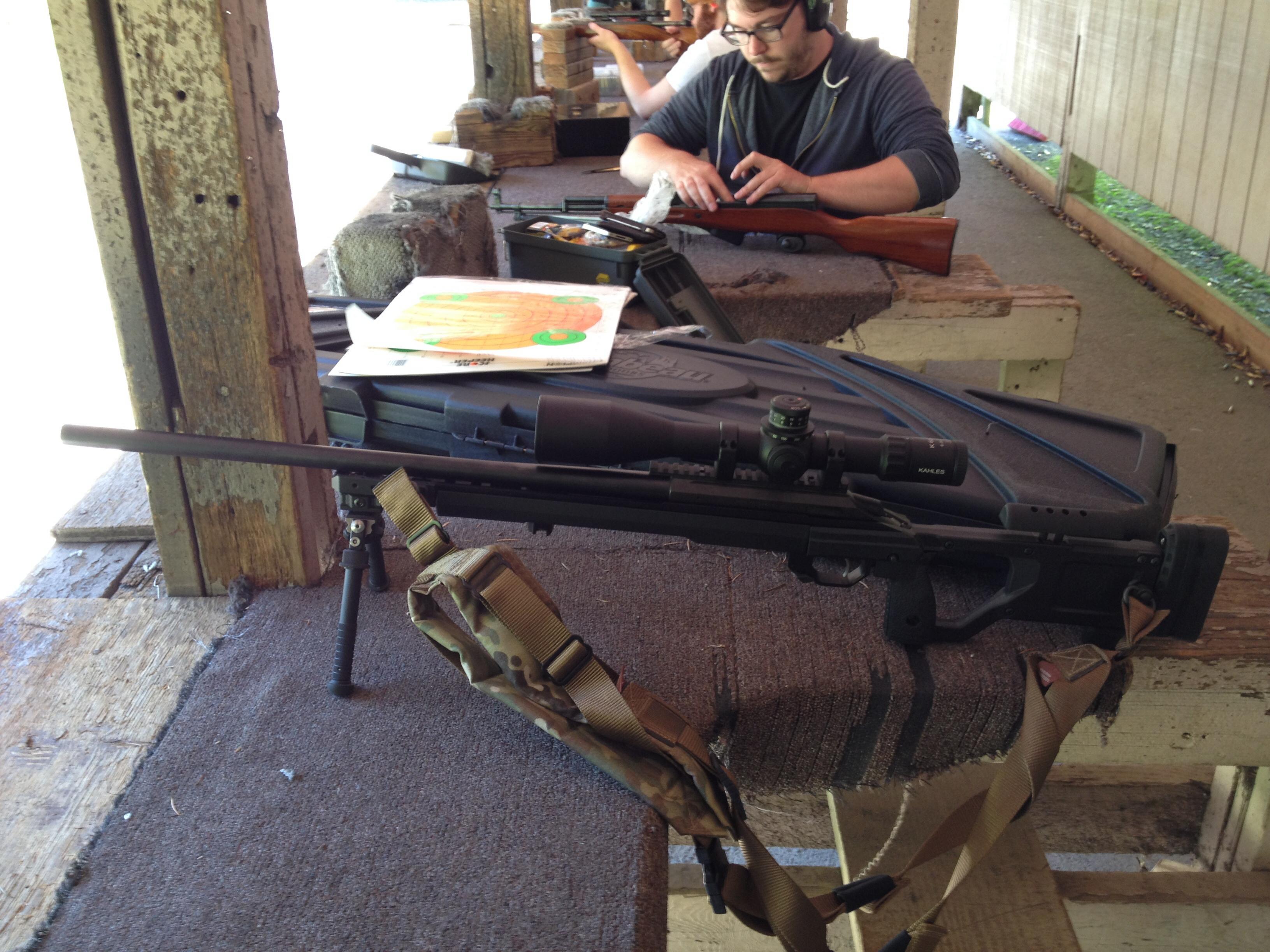

Looking good, how do like the stock?
Sendt fra min GT-I9300 med Tapatalk
Love the Kahles so far. I am coming from a Millet before this, so its night and day. I've looked through other scopes at competitions, and its definitely up there in terms of optics.
I'm shooting Southwest ammunition 139 scenars through it now. I'm not setup to reload, but I'm saving my brass and I'll get there eventually.
