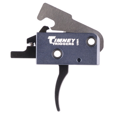

Pretty much giessele, kac, or mbt for serious use, everything else is a gamer trigger. Jard and timney are notorious for using lighter hammer springs to lighten the pull, equals fail on hard primers. Id avoid the drop in cassette type ar triggers, they gunk up bad and have no way to self clean like the 3 triggers I mentioned first.
