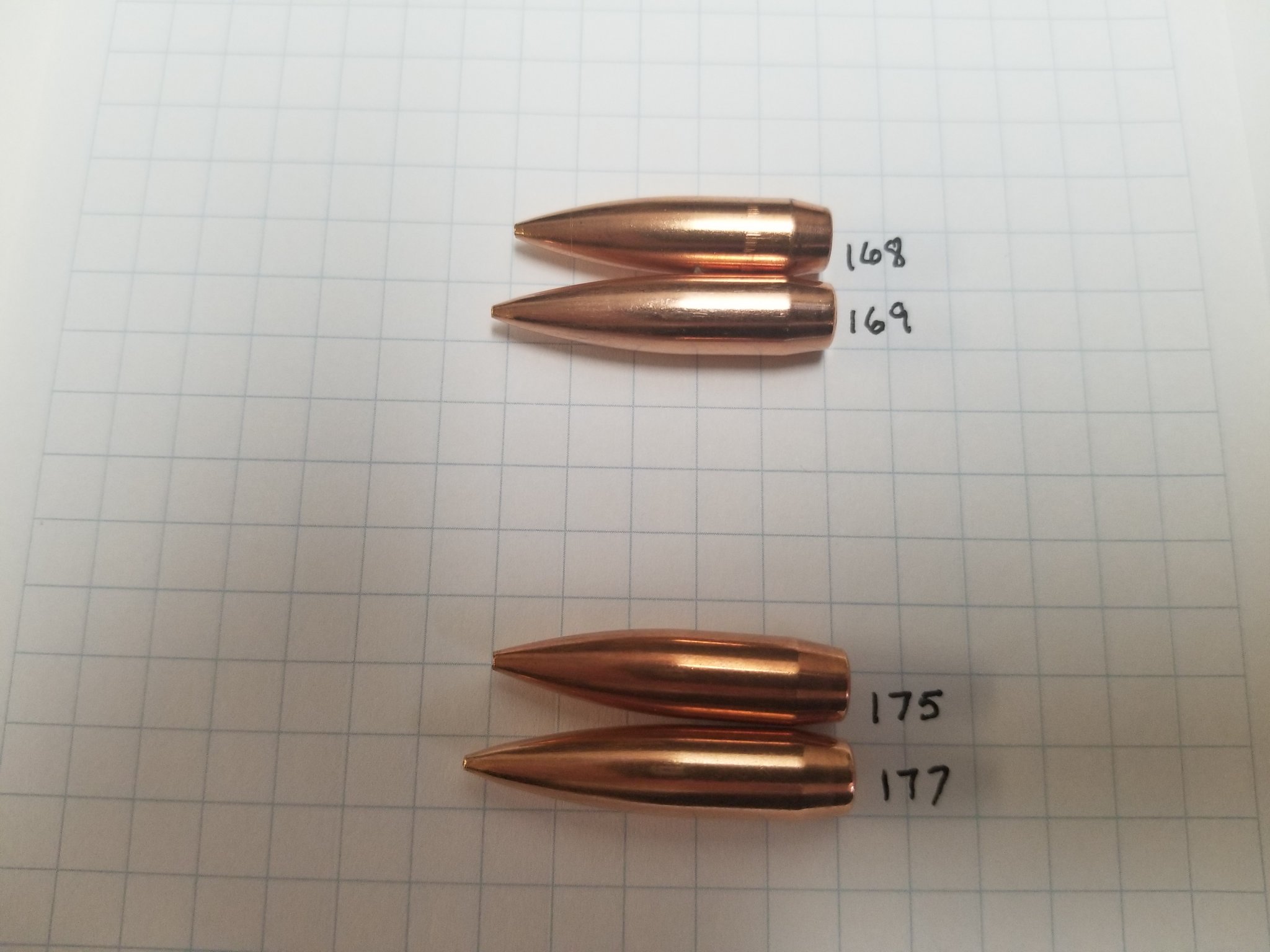

Got 2 boxes yesterday. I comparison-measured 10 against 10 of the 175SMK, 169SMK and 168SMK:
177SMK:
Base To Ogive
Tip To Boattail
OAL
Bearing Length
Weight
Avg
0.6879​
1.1697​
1.3343​
0.5233​
177.1​
Sd
0.0003​
0.0022​
0.0025​
0.0009​
0.0943​
175SMK:
Avg
0.6600​
1.0782​
1.2403​
0.4979​
174.8​
Sd
0.0009​
0.0018​
0.0021​
0.0014​
0.1160​
169SMK:
Avg
0.6575​
1.1454​
1.3079​
0.495​
169.0​
Sd
0.0007​
0.0018​
0.0014​
0.0011​
0.0516​
168SMK:
Avg
0.6117​
1.0542​
1.1894​
0.4765​
167.9​
Sd
0.0011​
0.0017​
0.0019​
0.0008​
0.0816​
Here is a visual comparison:
Top to bottom, 177-175-169-168:

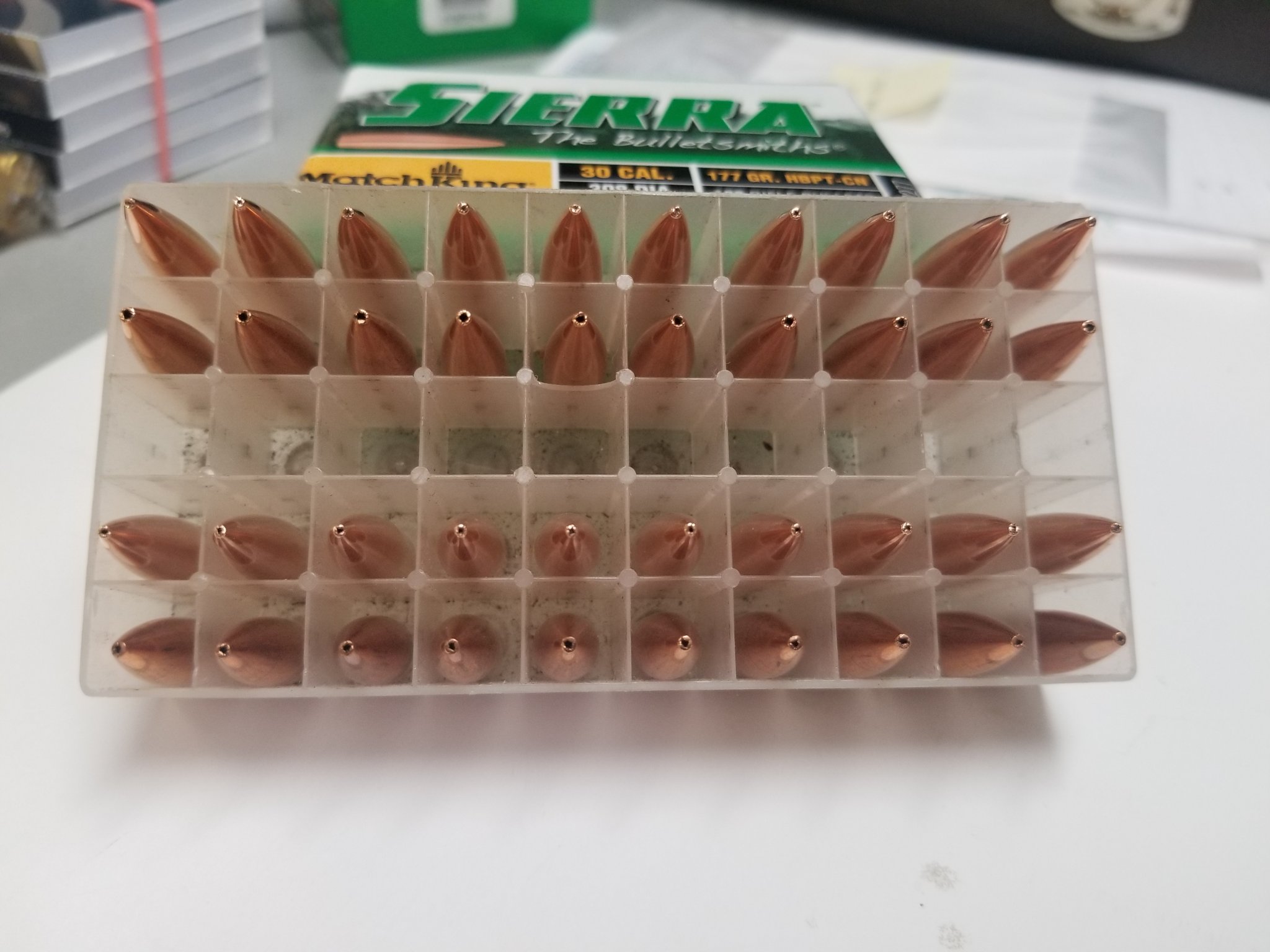

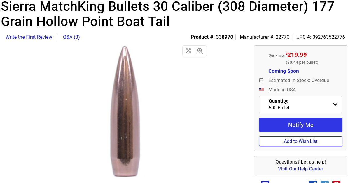

Reviving an old thread. Looks like the 177 SMK are about to be in stock @ Midway.
They currently have the 169's in stock (ordered 500).
Did anyone ever put any of the 177's down range??
Still isn't jack squat on Sierra's website.

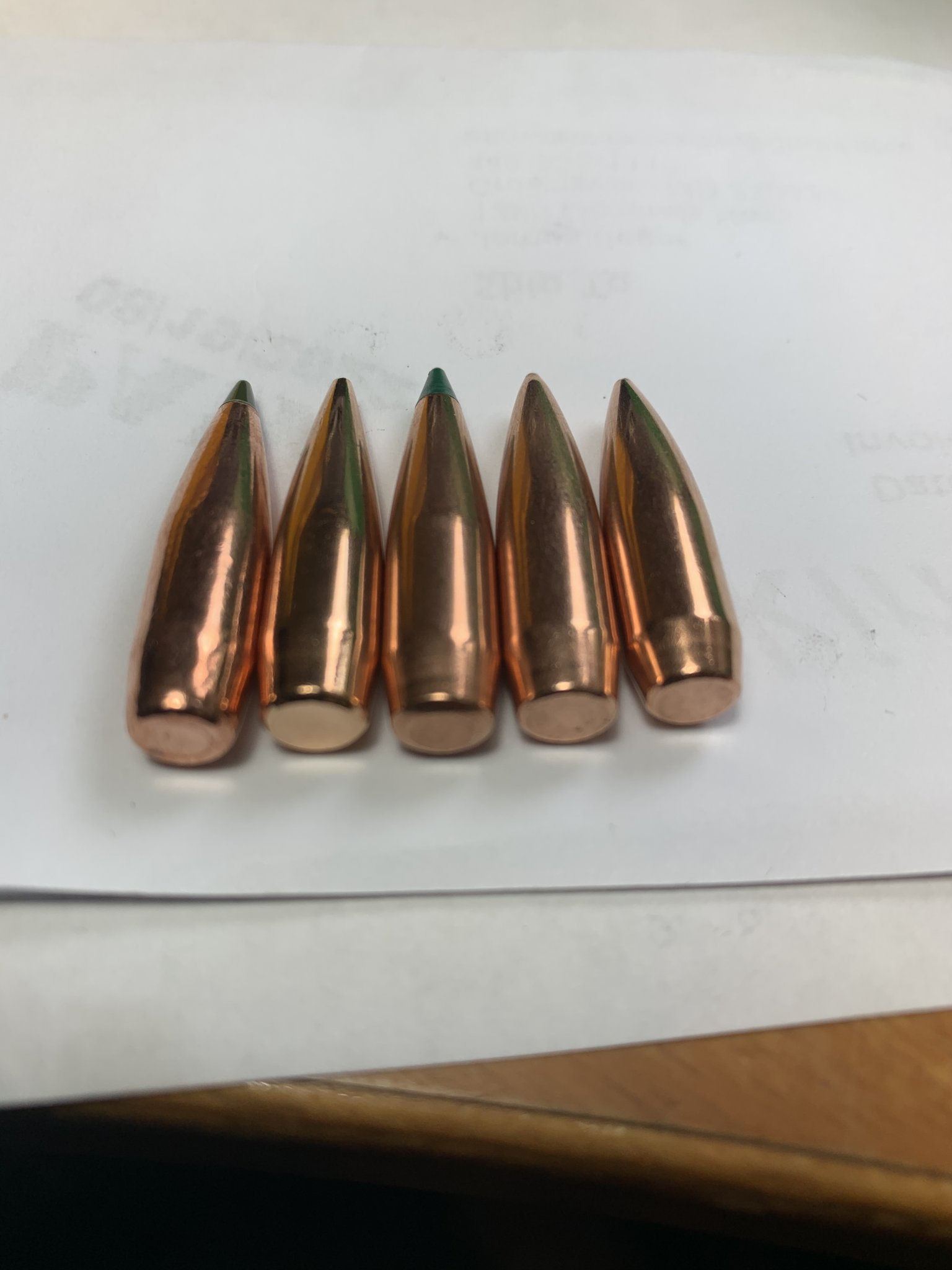

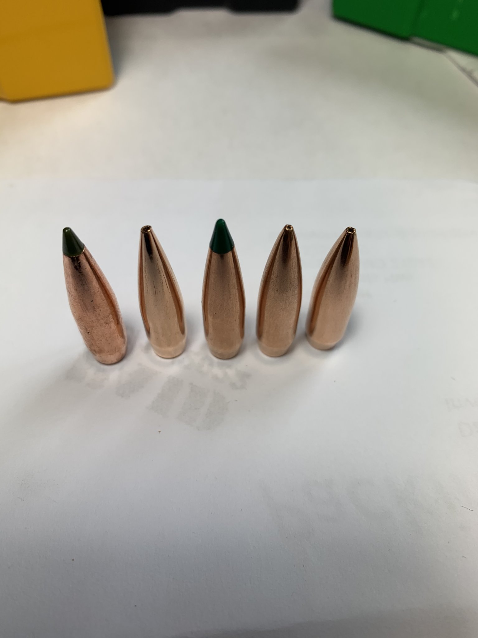

The new 169smk compared to the 168tmk base to ogive is within .001 @ .643-.645 that is where the similarities end. The TMk is about .070 longer oal & the boatail is different. For ref. berger hyb 168 base to ogive is .586
Edit: confirmed the new 169smk does have the tip reduction treatment. Assumng the 177’s will also.
I’m hopeing the new 169’s will be jump tollerant while not requiring the extreme jumps of the TMK in AR10 mag limits.
The TMK’s did not shoot well for me in my DPMS at thise loong jumps.

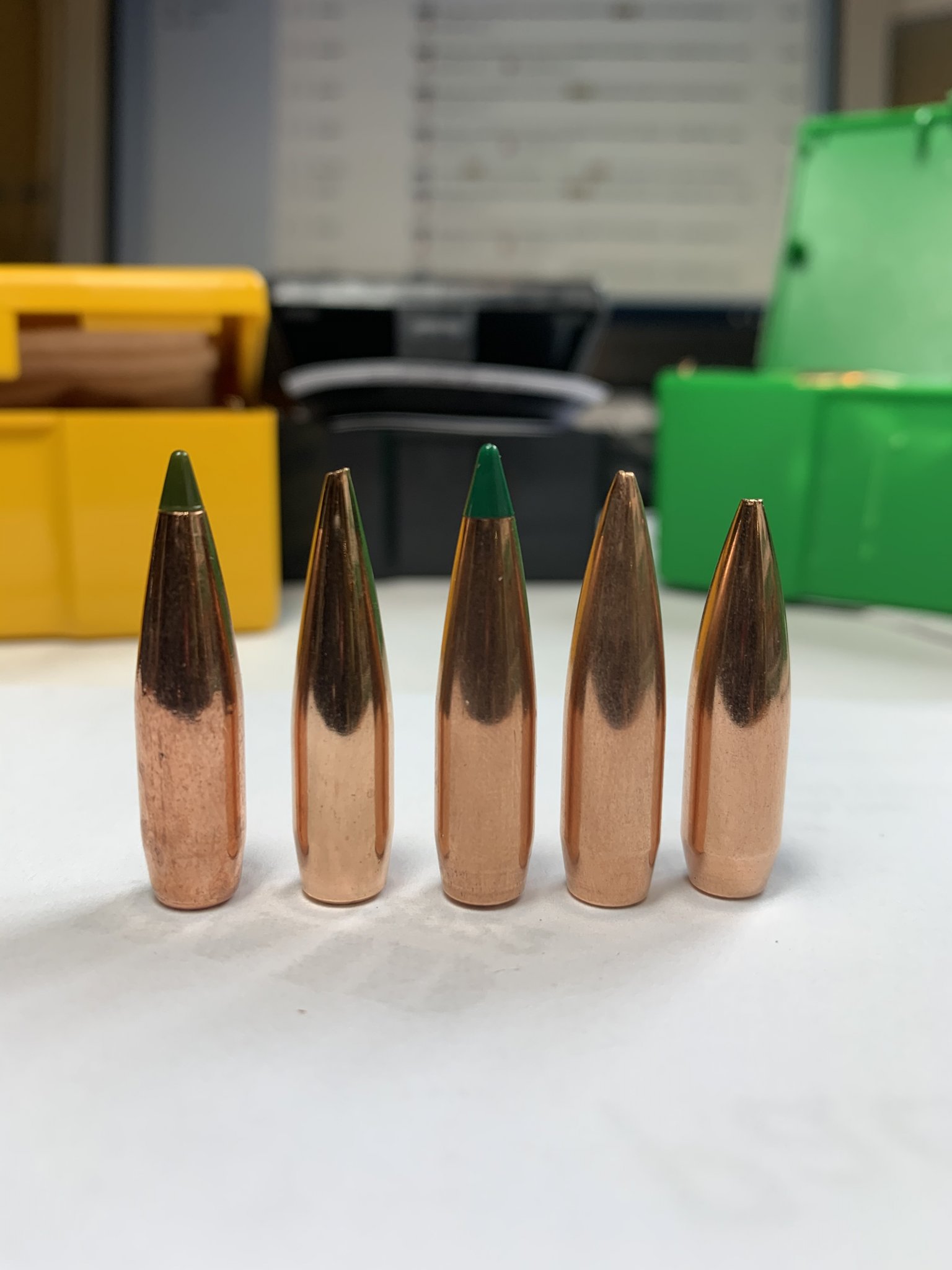

Here is a visual reference.
Left to right. Speer Impact 172, Berger 168 OTM, Sierra 168TMK, New 169smk, & std 168smk.
View attachment 7953408View attachment 7953409View attachment 7953410
Take a look at my post #22 above for a visual of the 177 and 169 in comparison to the 175/168s. Yes, both the 169 and 177 have meplats that are spun or swaged nearly closed.
