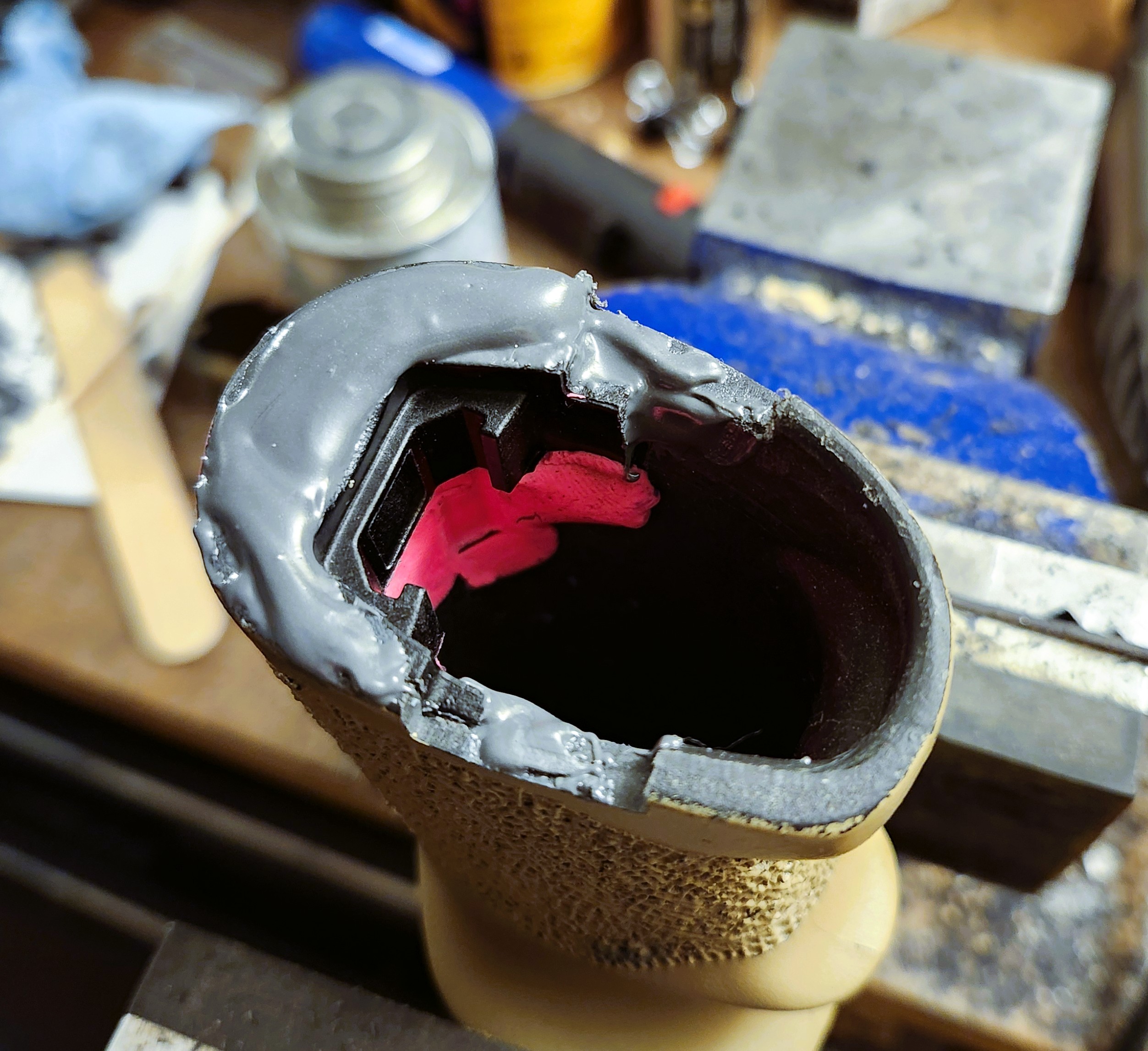

    The Sierra Precision Grip is probably my favorite grip for a precision AR but one of the drawbacks is that the inside of the grip is hollow and it's weirdly shaped so there were really no options for storage. I decided to do something about that so I brainstormed some ideas and what I came up with was to cannibalize a grip that did have storage and figure out a way to graft that on to the SPR grip.

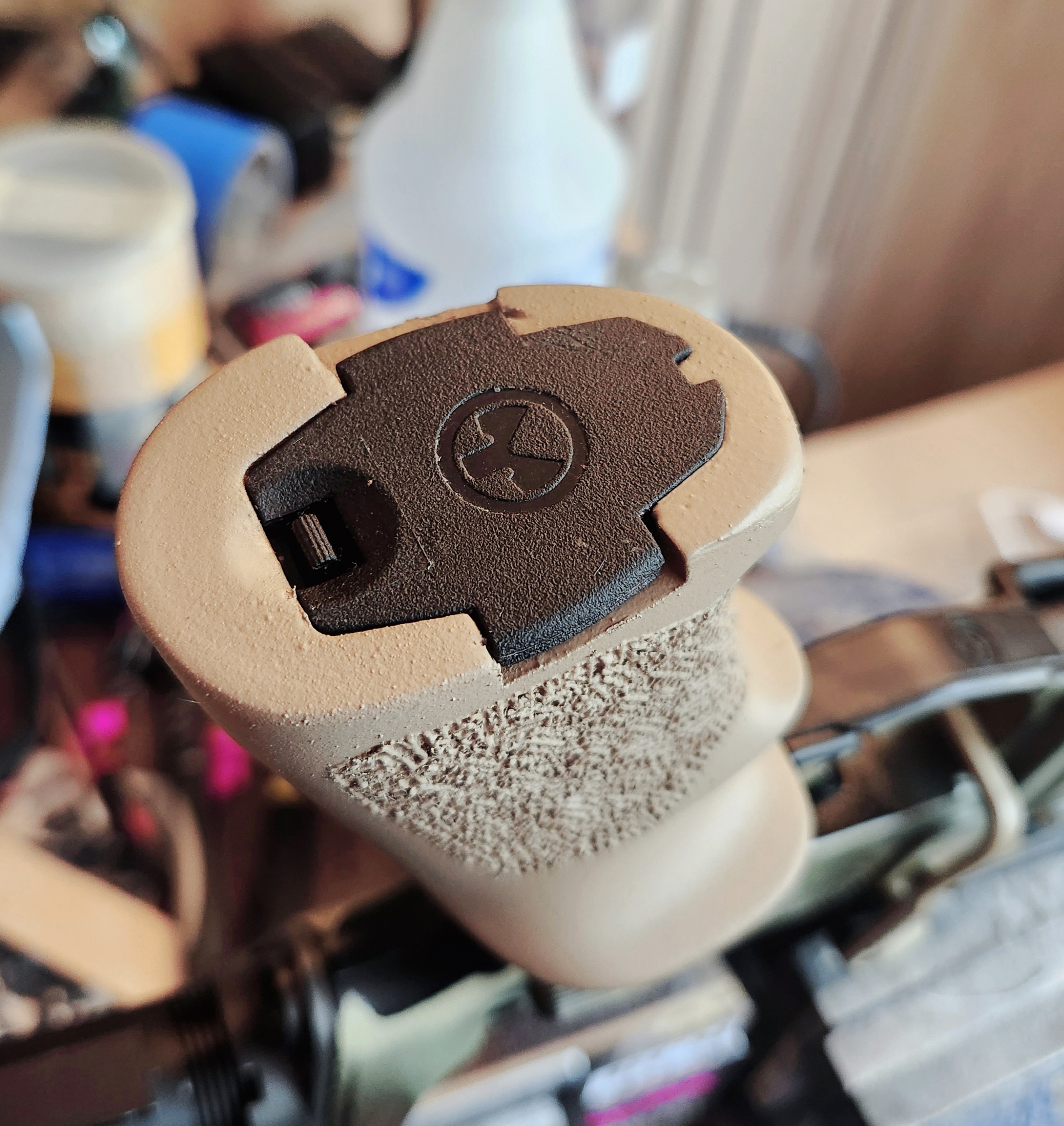

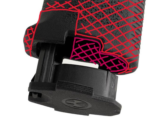

    I had a Magpul K2 XL that I ended up not really liking much so it became the sacrifice for this project so I started hacking and basically left myself with this relatively small portion, basically the latch recess and "strut guide".
    The remainder piece was still too wide to fit so I had to whittle it down and hog out some of the interior of the SPR grip using everyone's favorite tool, a Dremel.

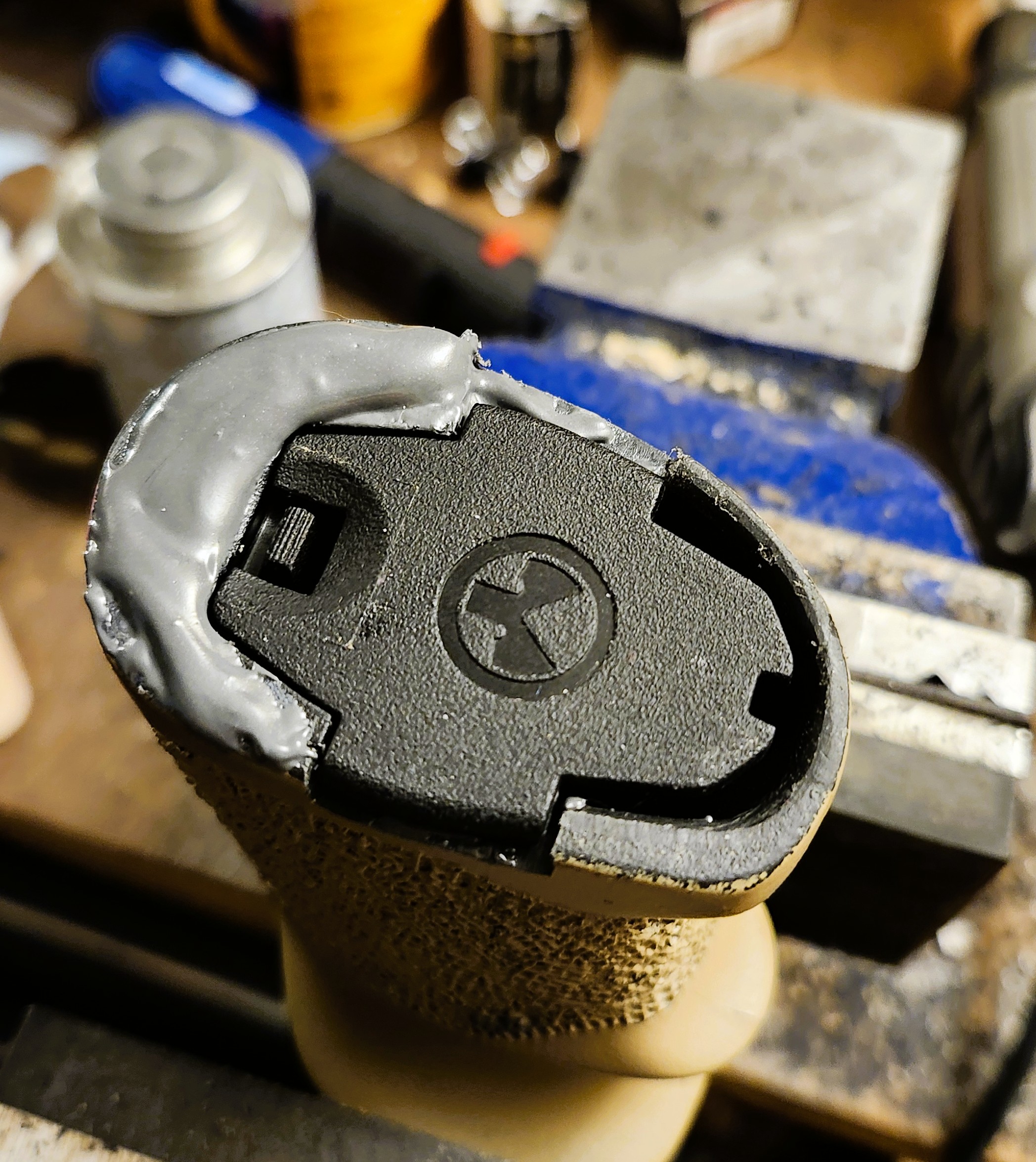

    Once I got it to the point the door was flush with the bottom I held it in place with a couple dots of super glue so I could prep it for epoxy.

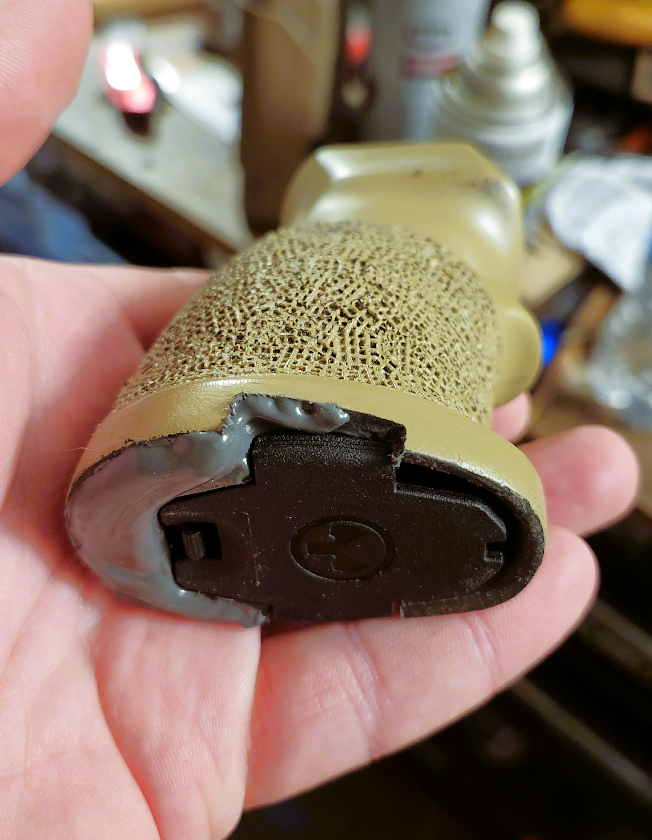

    I'll need to clean up the excess tomorrow so it's flush with the bottom and maybe splash it with some paint for touch up.
    Once I sand on it later tonight and ease the edges it'll blend in pretty good I think. The K2 XL that I bought came with the lube bottle grip core but I removed that and a made a foam insert to go in its place to hold some optic tools and stuff without rattling around. It looks like there's a big gap in the front but it's not that bad because of the interior contours of the grip. If I get to feeling a certain way about it I may seal it up with some JBW.
