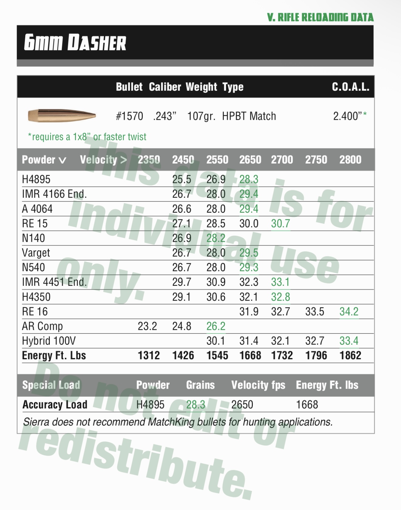

Is anyone finding that the load data from sierra is very conservative? I’m looking at the 6.5 prc data and their max charges only go up to 2800fps for the 150hpbt match bullet. It seems everyone posting velocities on their loads for similar weight bullets go faster than 2800fps.
Reactions: Hickswr
Yeah. I’m looking at their 300 WSM data with R26. This is probably one of the first places I’ve seen R26 in a manual for this round. I’m messing with it right now in a 20” barreled gun with bullets weighing 200 and 210 from Nosler and I’m already at 2 + grains over their listed max with no pressure signs. Seems pretty conservative on their part. Heck my starting loads are close to their max listed loads.
Extremely conservative data? I don’t know anyone shooting Dasher slower than 2800, and most shoot at 2850
Just because people shoot them at said speed doesn't mean they aren't overpressure. Other things that nake a diffrence include chamber sizes, I don't see what barrel length their velocity is from, or if they shot them from a production rifle or universal receiver. I beleive they generally try to do load data testing in a minimum chamber also.

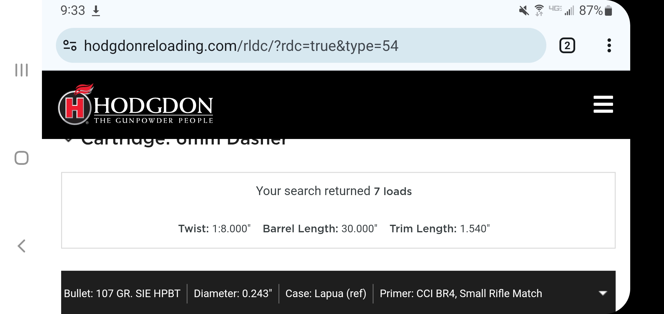

They state that they used a 24” barrel.
The maximum chamber pressure for the 6mm Dasher cartridge is generally considered to be 65,000 psi (pounds per square inch). However, some sources mention 64,000 psi as the SAAMI maximum.
GR.: 107 gr
Bullet Type: HPBT (Sierra)Diameter: 0.243"
Powder: Varget (Hodgdon)
Primer: CCI BR4
Case: Lapua
Trim Length: 1.540"
C.O.L.: 2.360"
Starting Powder: 29.2 gr
Starting Velocity: 2,726
Starting Pressure: 42,900
Max Powder: 31.8 gr
Max Velocity: 2,916
Max Pressure: 51,900 CUP
Source: Hodgdon

Hodgdon data is for a 30" barrel.😉
