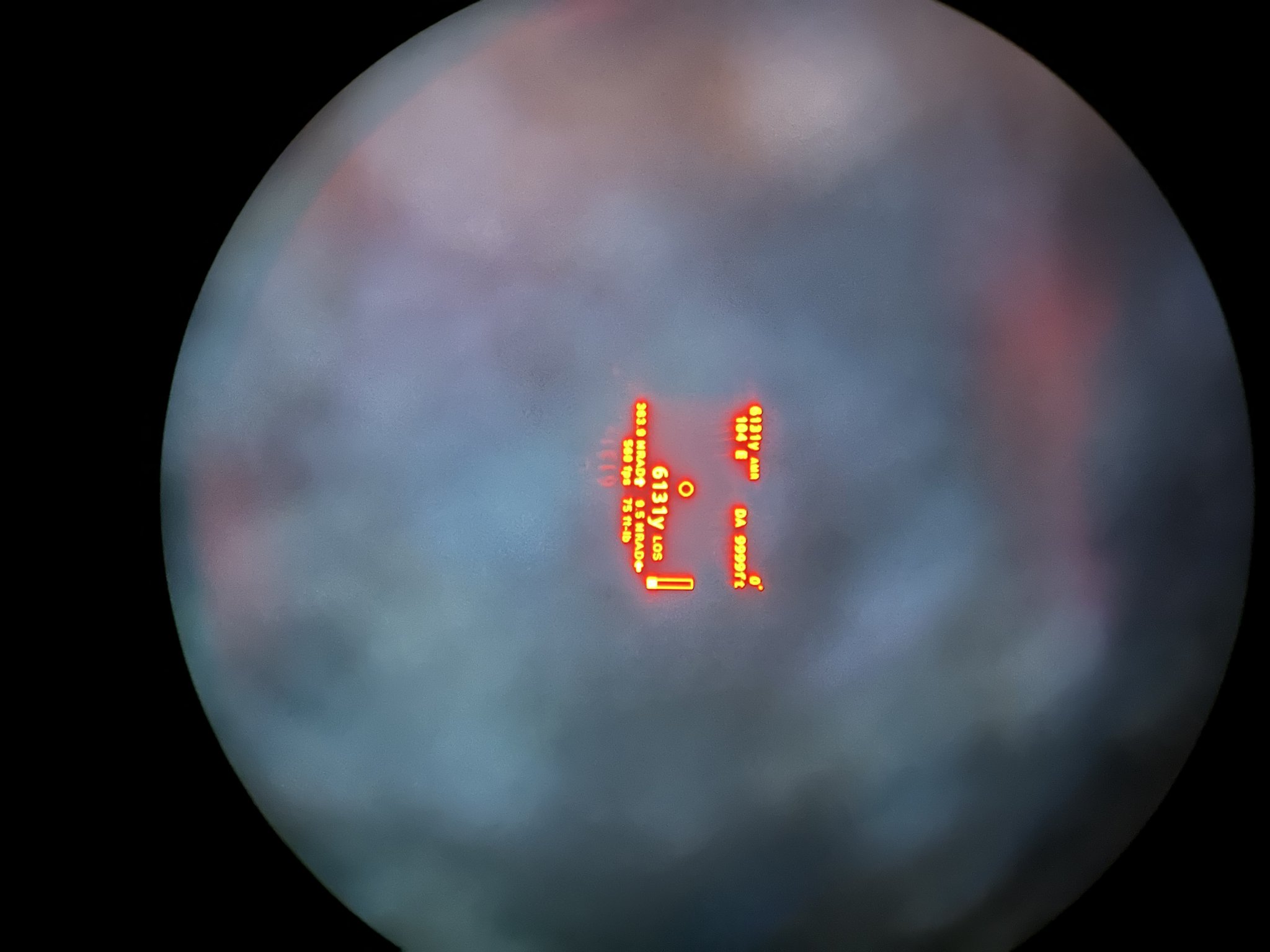

Did some more playing with the kilos tonight side by side with my Nikon 10x42HG’s and my father in laws old pair of Zeiss 10x40s from Germany. It was a clear afternoon and night. I started glassing about 30 minutes before sunset and glassed 20 minutes after sunset. I didn’t use a tripod just laid the binos over my tool box for support.
Ignoring the tint, the resolution easily beat the old zeiss, and was neck and neck with the HG’s. The tint wasn’t causing any issues with being able to see. We have a cattle ranch about 800 yards away and goes out to around 2k. Cows were obviously easy to pick out with all 3 binos. Didn’t find any deer out and about tonight.
The ranging capabilities are amazing! There is a mountain on the far side of the cattle ranch covered in pine trees. I ranged the top of it at 6131 yards. I did some more playing to see if the 10ks could differentiate wood fence posts by scanning back and forth across them. I had no problems at low 500s. I could not get the range finder to pick up the fence post from the background at around 800 yards.

Did you try some of the other ranging modes?
I was ranging in the low to mid 2ks with the near/best mode which is what I have been running most of the time. I switched to the extended mode for the long ranges.
I have tried the far setting as well and I really like how the near/far modes work. Your able to scan around and when you stop it will Display whatever the farthest or nearest range was during your scan. I have yet to have a situation I could use the far mode, haven’t used it in the fog/rain/snow or in the woods. I do have trees around my house with small opening that have given my Leica fits. I will try and play with that setting later today and see how it does side by side with the Leica.
The near mode is excellent for ranging skylined steel or being able to pick up the target instead of the berm or hill behind it.
Are you saying the Near mode stops working well @800+ yds for steel in front of berms? Or was that just the fencepost test?
That is the the distance I had available for a fence post last night. There was a fence run low to mid 500’s and the next run was 800 something. Kilos could pick up the fence post at 500’s but not the 800’s.
I have used the near setting in the mid 1ks if I remember correctly to hit the cows without issues. I don’t remember exact yardage last night that I was hitting trees with near mode before I swapped to the extended mode but it was in the 2ks

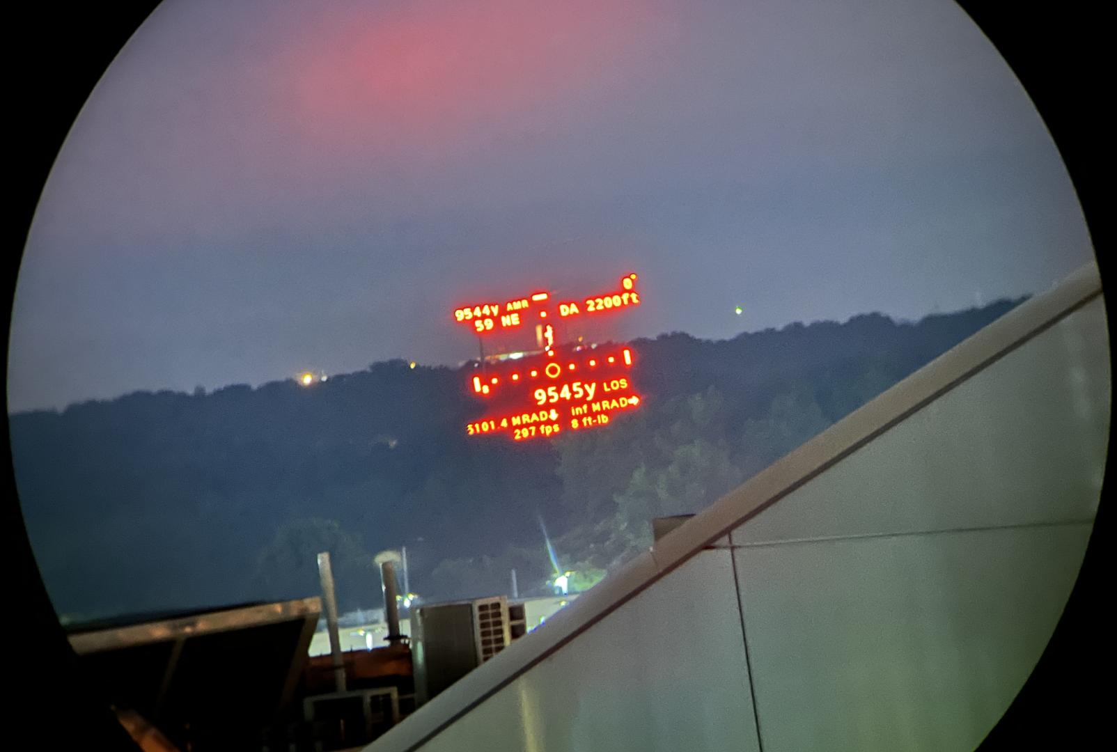

I've been playing a good deal with the Sig Kilo 10k-ABS HD rangefinder and I thought now might be a decent time to throw in a little teaser as I am most of the way done with the testing. This has been pretty interesting living in central Ohio as it is basically flat and tree covered for a hundred miles or so in any direction. This Sig can range so far you have to get pretty creative to test it around here. The manual, and advertising material, lists the 10k as having the ability to range: reflective targets at 10,000yds, Trees at 4,000yds, and deer at 3,000 yds. They are getting this with a 905nm class 1M laser essentially though the combination of an unusually flat beam pattern of 1.5 x .06 mrad and a special, longer duration, XR ranging mode. Although there is really no way for me to test a claim of 3k yds on a deer, I have been examining the other claims as well as the interesting effects of the unusual beam shape. I came quite close to the 10k number tonight ranging the iconic Budweiser factory tower from a parking garage across town. Yea, across town is what your dealing with trying to test these things max range. For my amusement, I left a .22lr ballistic profile active while doing this. It's funny, for most of the 6k+ ranges I did, the binos just returned zeros for the ballistic solution. .22lr, of course, simply cannot go that far at any solution. However, for whatever reason when I got to this crazy distance of 9545 yds the binos returned a solution of 5101.4 mils drop and inf mils wind. For those keeping track, 5101 mils is almost the whole way around a circle (6,283 mils) so, you would actually be pointing a bit down, not up. Incidentally, ranging the same thing again yielded 3744.0 mils for the same distance so clearly we are just getting programming static at this point. I was both amused at this return and at the fact the Kilo 10k's actually ranged this far though. I have also been able to test the tree line range claim, rather thoroughly in that case. On an overcast day, the Sig 10k's will do a tree line out to 3,700yds but not further. At night, they exceeded 5k yds on what appeared to be tree lines so far as I could tell.
Budweiser factory tower @ 9,545 yds through the Sig Kilo10k-ABS Laser Rangefinding Binoculars
