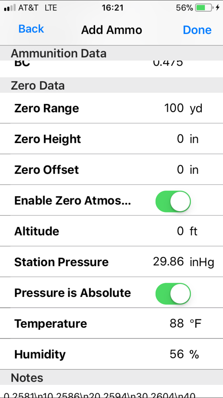

As far as I can tell, the Applied Ballistics standalone app has the same issue. (I've got the Applied Ballistics app too.)
As for environmentals effecting a 100 yard zero, they absolutely do. Sight in a rifle at sea level. Take that same rifle to 10,000 feet. It will shoot high, even at 100 yards.
Thisis AB Mobile on iPhone. As you can see, zero conditions are recorded.

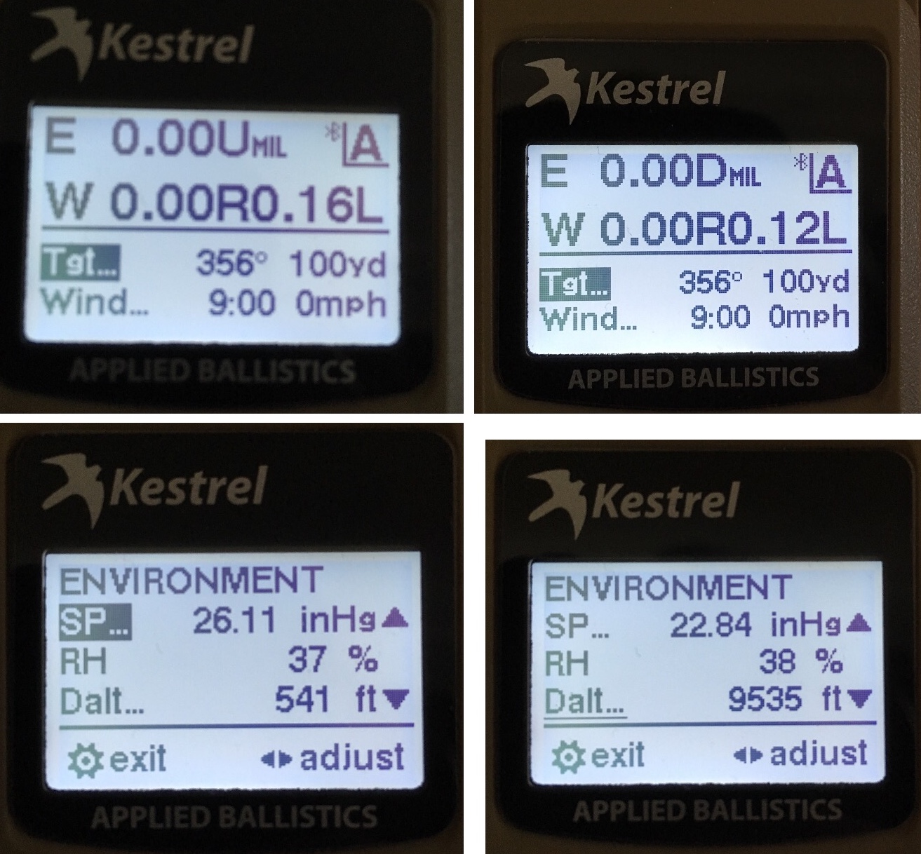

I checked myself on the Kestrel . No inputs and texts with AB confirms “Not needed” . Below is same gun 100 yards. Left is 541 DA and right is 9535 DA. No change at 100 yards.
Max. I ran your two examples through Strelok. A rifle that is sighted in a 100 yards at 26.11 inHg and the same rifle sighted in at 100 yards at 22.84 inHg. It's true that the differences between them are not great. With a high BC 230 grain 308 bullet, the difference between sight in conditions only made a difference of 1 inch at 800 yards. I'm not a good enough shot to consistently measure a 1 inch variation at 800 yards.

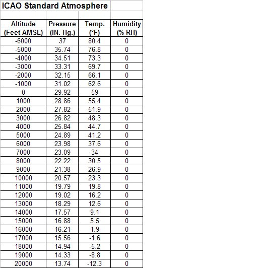

I actually changed both temp and station pressure to manipulate Density Altitude.the 541 DA was 0 deg F. And I think the 9535 DA was 73 deg f.
The right way to manipulate DA actually would be to use ICAO standards.
0 ft DA would be 29.92 inHG , 59 Deg F , 0% RH
10,000 ft DA would be 20.57, 23.3 Deg F, 0% RH
Or If strelok has a DA input you could just use that. Kestrel does not.

I must say I’m a bit confused here. If there is 1inch change at 800 yards , wouldn’t that be a theoretical 1/8 “ at 100 yards? I hear what you are saying about being precise but knowing how geeky precise Litz and Co. are it’s hard to think they would call that a “wash”.
So if AB says and shows no change at 100 yards, one has to assume its changing further down the line. Aren’t the environmentals making this change at 800 yards already?
So I’d propose running the same test as above but using DA or ICAO standard to manipulate DA for sea level and then 10,000 ft. Then check zero verses 800 yards at each.
My take is you’ll see no change in zero but dope will change accordingly at 800 yards.

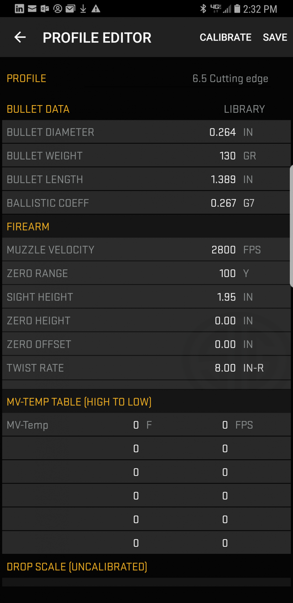

I am assuming that the 2400 has a MV correction table to take temperature into account?
Coldbore lets you store your zero environment and if you enter MV as a function of temperature, you can turn on field conditions which take temperature effects into account. It also will take RH and station pressure differences into account. Though it doesn't distinguish how much each of these variables enter into the overall solution.
The Kilo 2400 has the Temp Table Feature.
The mobile app has a single MV/FPS value input. The mobile app also has the ability to set zero atmosphere. In fact the engine in the Kestrel, Kilo, Foretrex... All support that function. It is in the engine. However if you zero at 100 yards, you don't need that function. I have zeroed a rifle at 200ft altitude, taken it to 10,000ft and the zero was fine. You are more likely to have something happen due to the way your luggage is treated during travel, than to have a shift. There are other factors that can cause a zero shift too, much more influential at 100 yards. Such as your shooting position, what you are shooting off of, and more.
