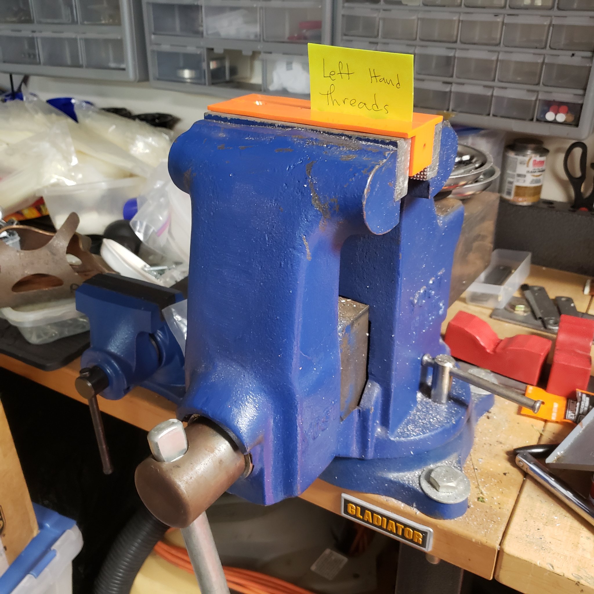

Remember it has a LEFT hand thread. To REMOVE the brake turn to the RIGHT!
Yeah, I'm scared to death I'll forget the thread direction. I need to put a post it note on my vise I think.

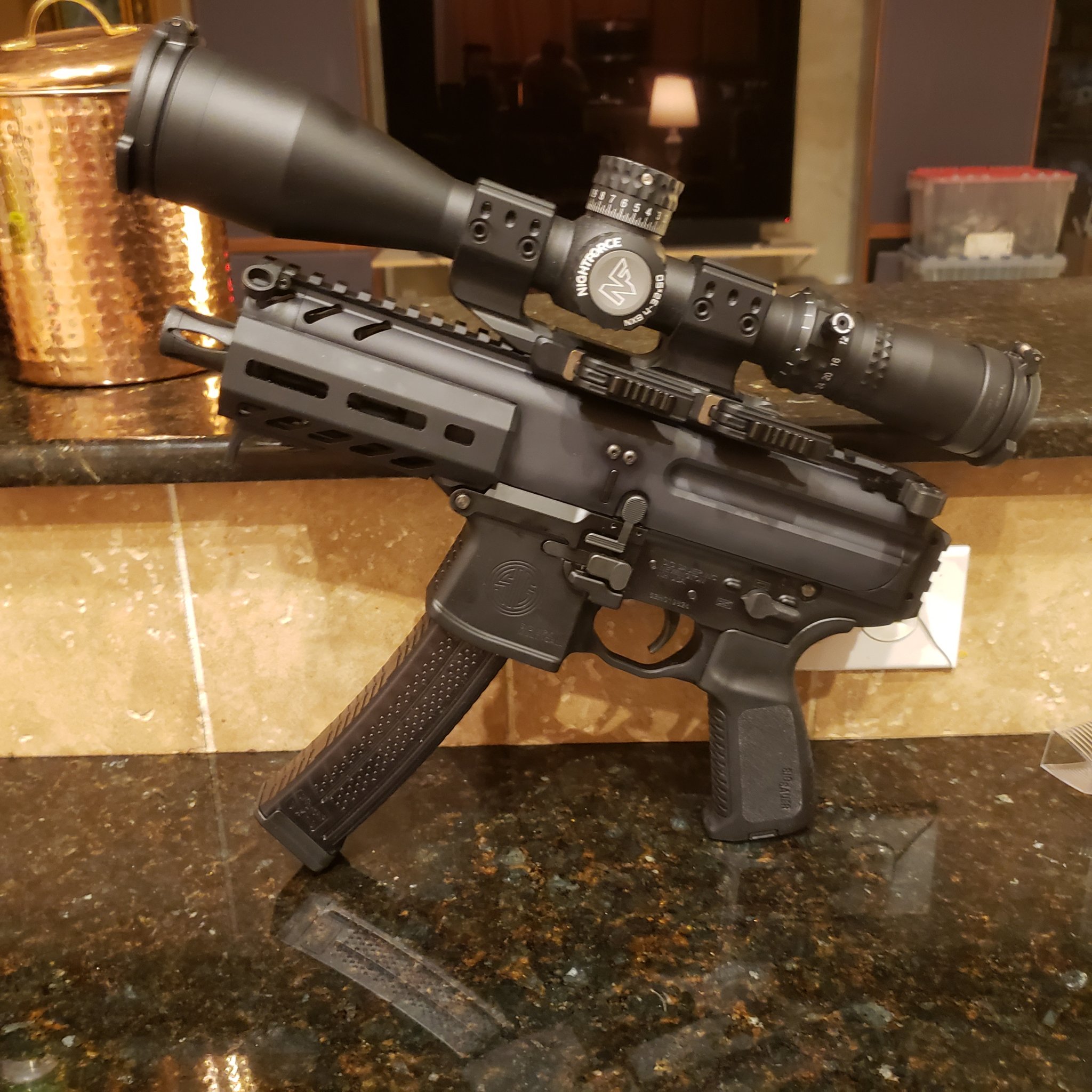

A few pix of the project.
I call this the Secret Squirrel addition.
View attachment 8207794View attachment 8207795
Are you removing the flash hider from the short pistol barrel or the 16 inch carbine barrel?
If so, I don't recall the flash hider on either one of my 4.5" and 8" barrels being difficult to remove at all. The Carbine barrel required the water treatment.
The pistol flash hiders came off rather easy AND they are still LEFT hand threads.

It's the 4.5" barrel as shown.

Why do you have that huge scope on there?
Well, 2 reasons.
1) A joke, I called it the Secret Squirrel edition. Hint -- Look up Secret Squirrel on youtube
2) I am going to take it to the range with that scope to verify accuracy before and after the muzzle device swap. There are a lot of issues there and I have to know if I am moving in the right decision with my muzzle device and suppressor.
I'll probably know if I am having issues without it, but it's QD so no big deal to pop it on and off.
I have a Holosun 510 that will live on it afterwards.

He's just asking you about the type of breaking bar or wrench you are using. Length of Rachel or breaker or whatever
Ahhh, ok. The barrel removes super fast with a few torx bolts. I have that big azz vise with the plastic jaws I'll chuk it up in. Then use a breaker bar with a crows foot it think. First thing I may try is a long pattern 19mm open end wrench just to see if it breaks easy and get an idea of how tight it is. I believe the birdcage is 19mm.
Ah. Size matters. Lol. I found less than 18” made removing any hider more difficult. Longer arm = less felt force/effort.
My MPX was a "First Responder Edition" made in Jan 2023. It had a Sig trigger in it. Heavy, Heavy, Heavy. About 8 1/2 - 9#. Felt good, just Heavy as hell.
Put in the Geissele SSA MPX tonight and went to about 4 1/4#.
Had ordered some 20rd magz to shoot it off some bags but the place I ordered them from was a scam sight I think. So re-ordered those and will have to wait to shoot it.
I shot the stock muzzle device and it easily grouped under 2" with a 2 MOA red dot at 25 yards.
The muzzle device came off really easy. No glue.
I put on my JMAC muzzle device and I'll shoot it again with the same ammo to see if I have any accuracy issues with the new muzzle device.
JMAC Brake
Shot it today with the new Muzzle device and it was around 1" for 5 shots at 25 yards. So next month the range where my Wolfman is being held hostage will be renovated and I'll shoot it then and we'll see.
