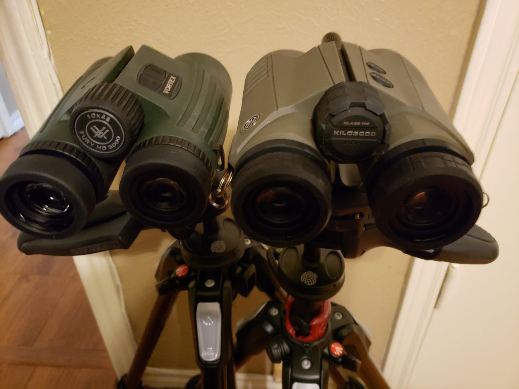

Thank you for the side by side view, I haven't seen one before.
The other pictures I saw were front angles and looked more similar although it's hard to tell what is under the plastic.
So you say it's not a private lable white box product?
Please tell us what you mean.
With similar specs, performance and price I was assuming they come from the same factory and that the actual binocular and LRF bones are identical.
I think it's safe to spill the beans since they are both out in the wild now.
Thats not for me to disclose, but the LRF tech is not Asian select your spec gear. It is licensed by Sig and Vortex. From right here at home.
