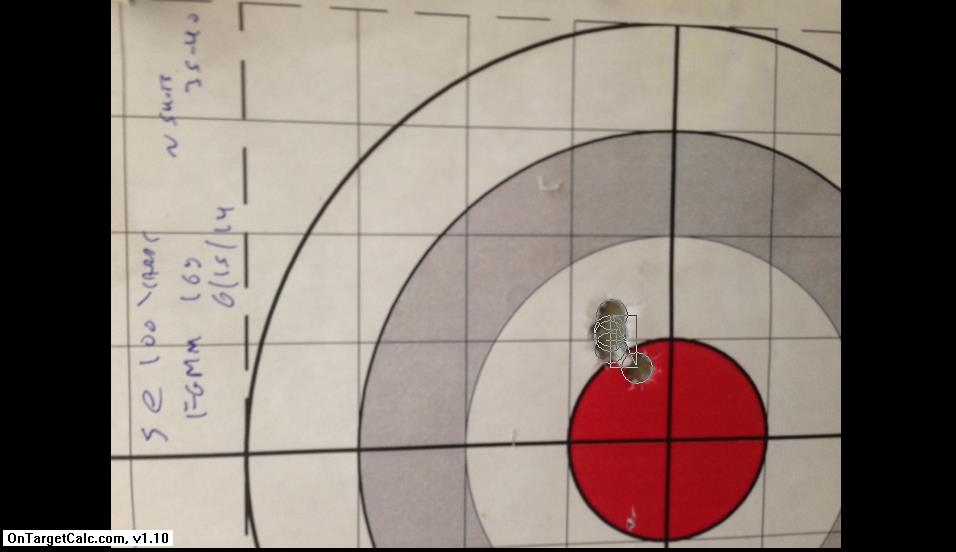

finally got mine out to the range - too bad all I have here in CT is 100 yards. put 30 privy partisan 'match' through it, cleaning after each 10, nothing special in groups, ~1.25". cleaned it again, and tried 5 FGMM 168 gr. of course, had to pull off one, or it would have been a single ~0.3 MOA hole... but, for the first day, I'll take just over 1/2 MOA, considering the total lack of rifle trigger time this year so far.
some more practice for me, and this will get really fun.
really happy with the SSG-3000...
