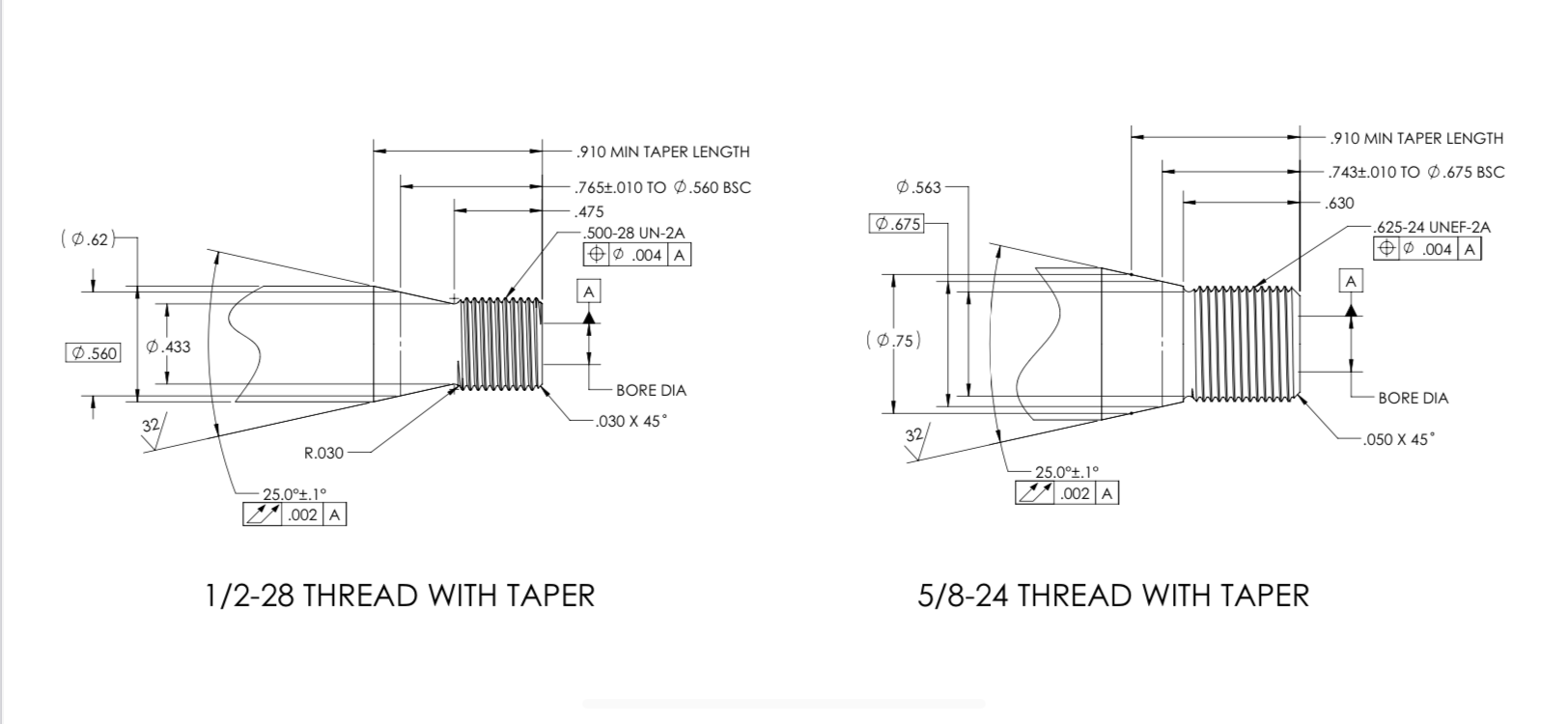

U Ubaderb Sergeant of the Hide Full Member Minuteman Oct 15, 2020 131 35 Nov 30, 2022 #1 Nov 30, 2022 #1 Has anyone had their gunsmith put a Sig 25* taper to their rifle? Surely if the gunsmith is competent it shouldn’t mess with my accuracy. I have a CGS Hyperion that has a taper built into the DT mount.

Supersubes Heathen Full Member Minuteman Supporter Sep 6, 2006 9,160 11,305 Eastern Sierra Nov 30, 2022 #2 Nov 30, 2022 #2 No reason why a competent gunsmith cant do it. Here’s the print to show them if they haven't done one. Reactions: Ubaderb

U Ubaderb Sergeant of the Hide Full Member Minuteman Oct 15, 2020 131 35 Nov 30, 2022 #3 Nov 30, 2022 #3 Supersubes said: No reason why a competent gunsmith cant do it. Here’s the print to show them if they haven't done one.View attachment 8010936 Click to expand... I appreciate that print. Only one I could find online was a blurry copy.
