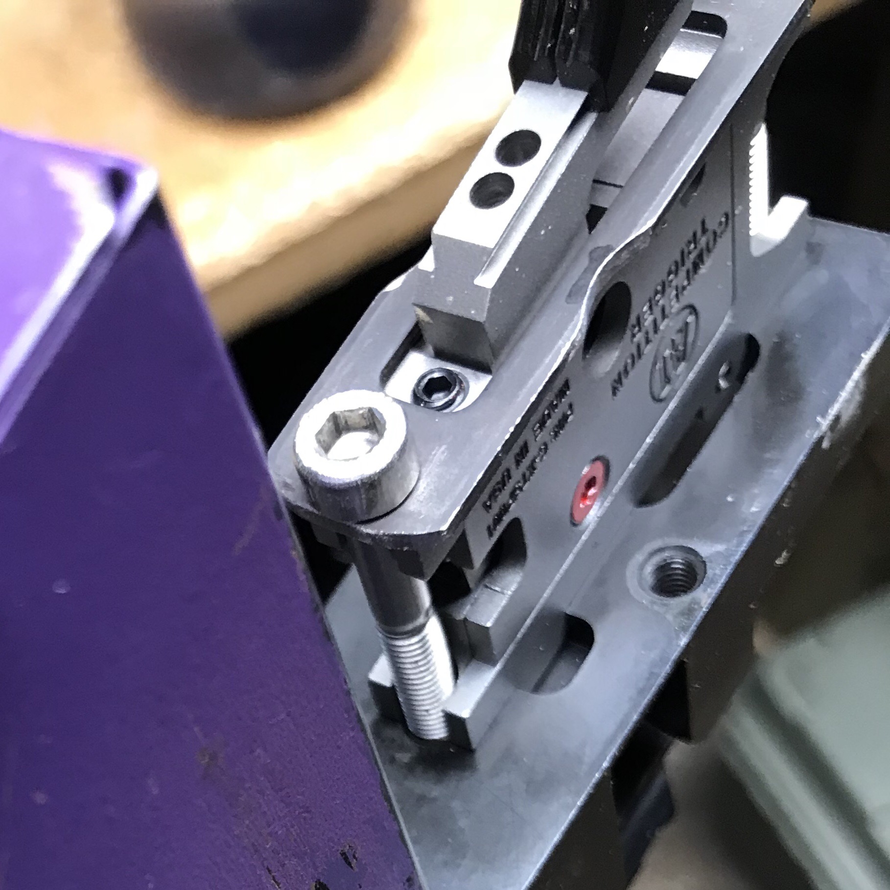

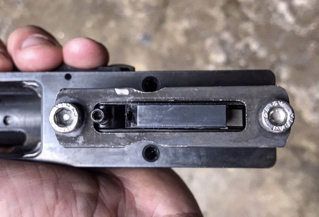

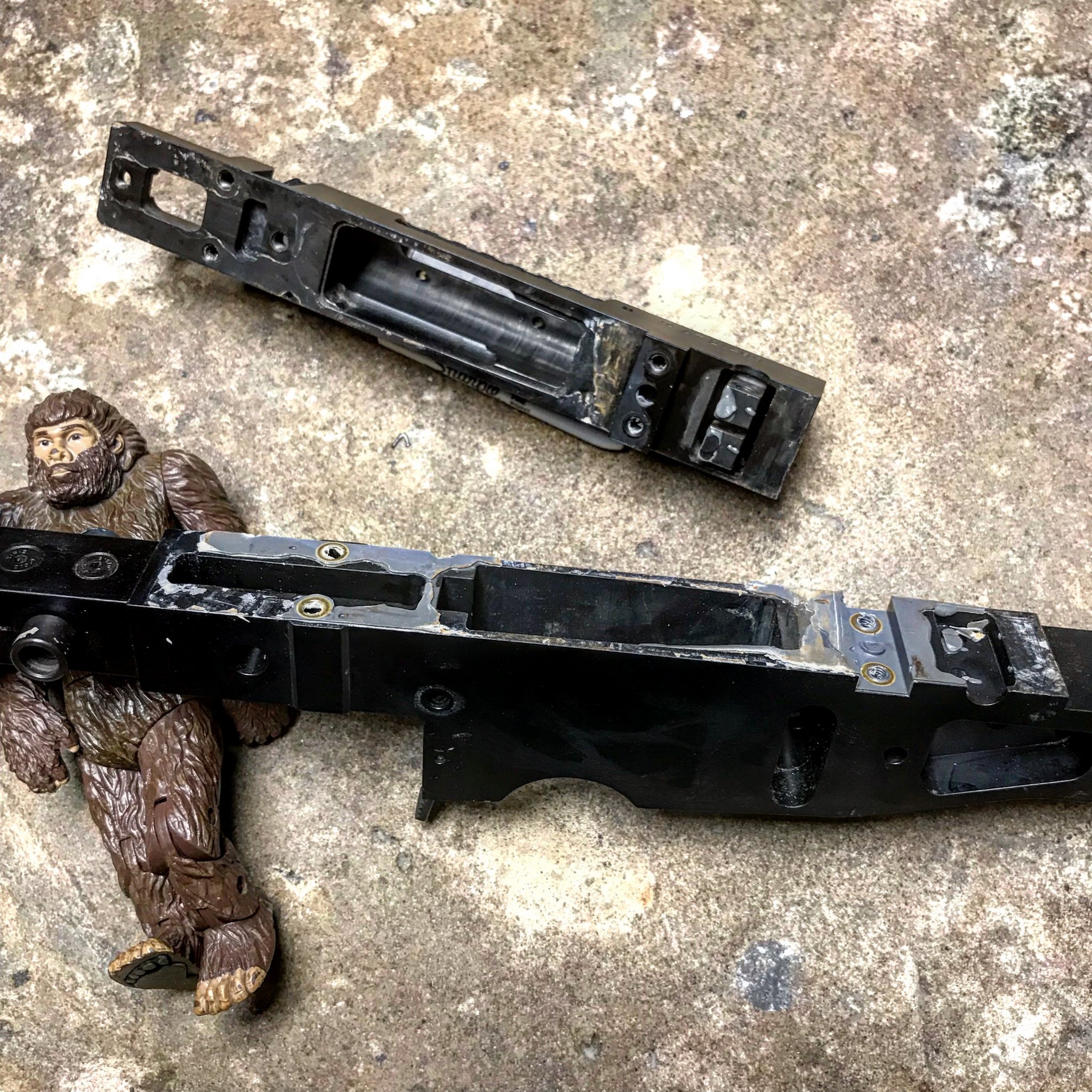

Extremely easy to do. I put the barrel in a vise, heated the epoxy with a paint remover heat gun and it popped right off.

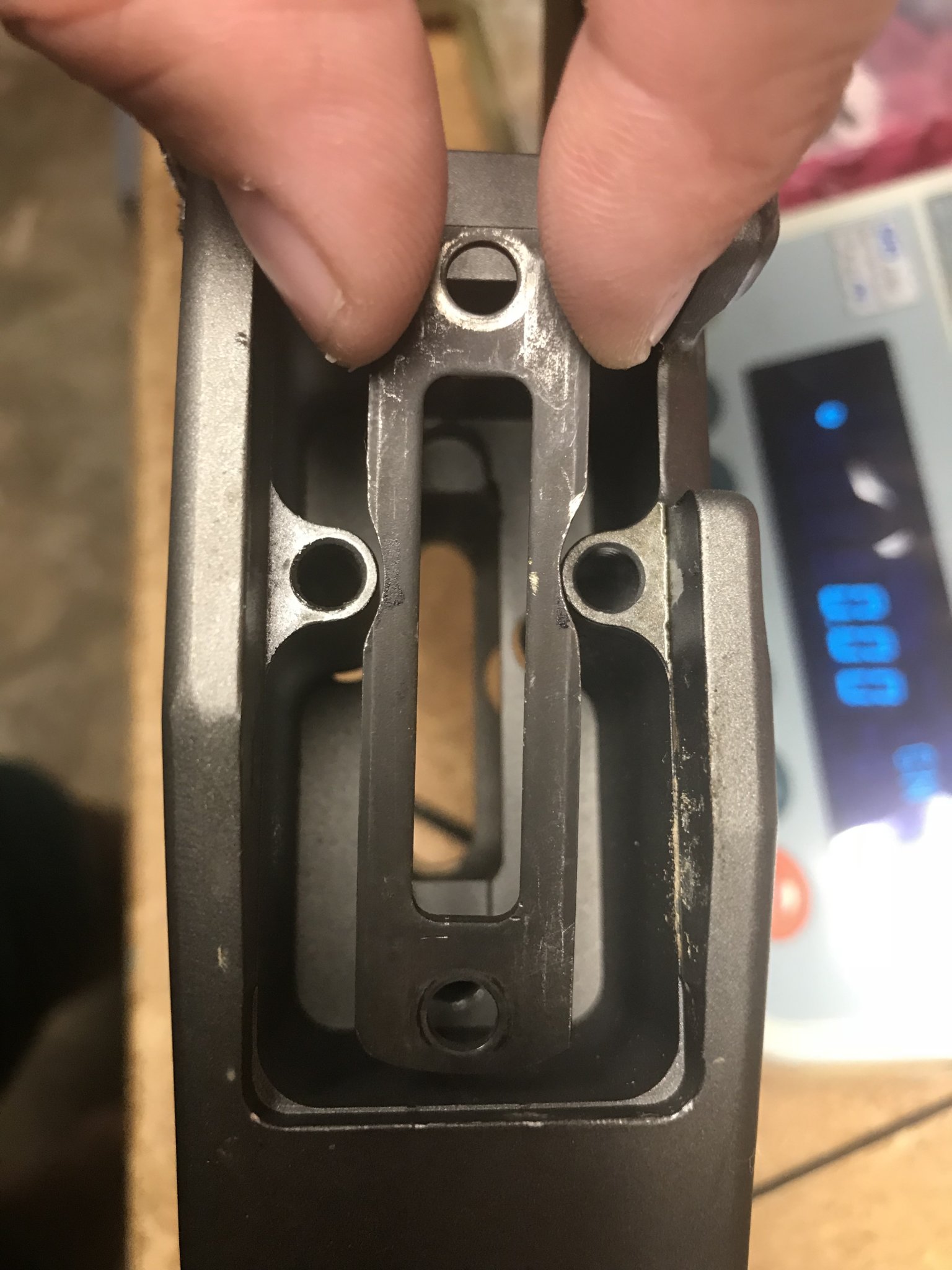

The ONLY modification that needs to be done is on the trigger capture plate thingy. You have to trim and radius both ends and then notch the side to fit inside the action screw pillars. I’ve ran this setup through 11 matches since April with zero complications.

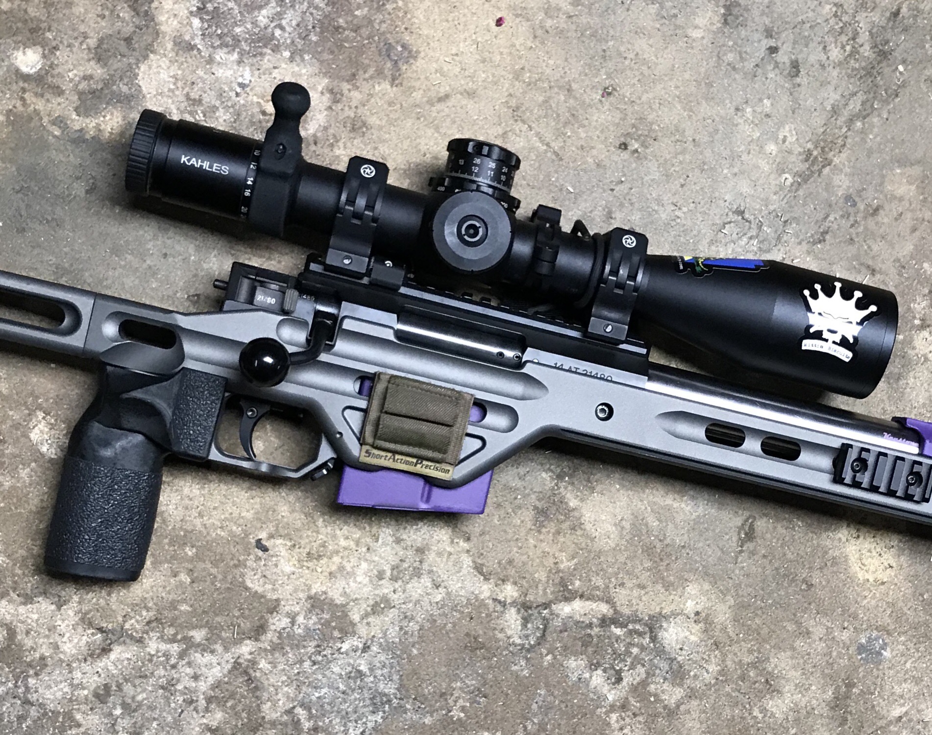

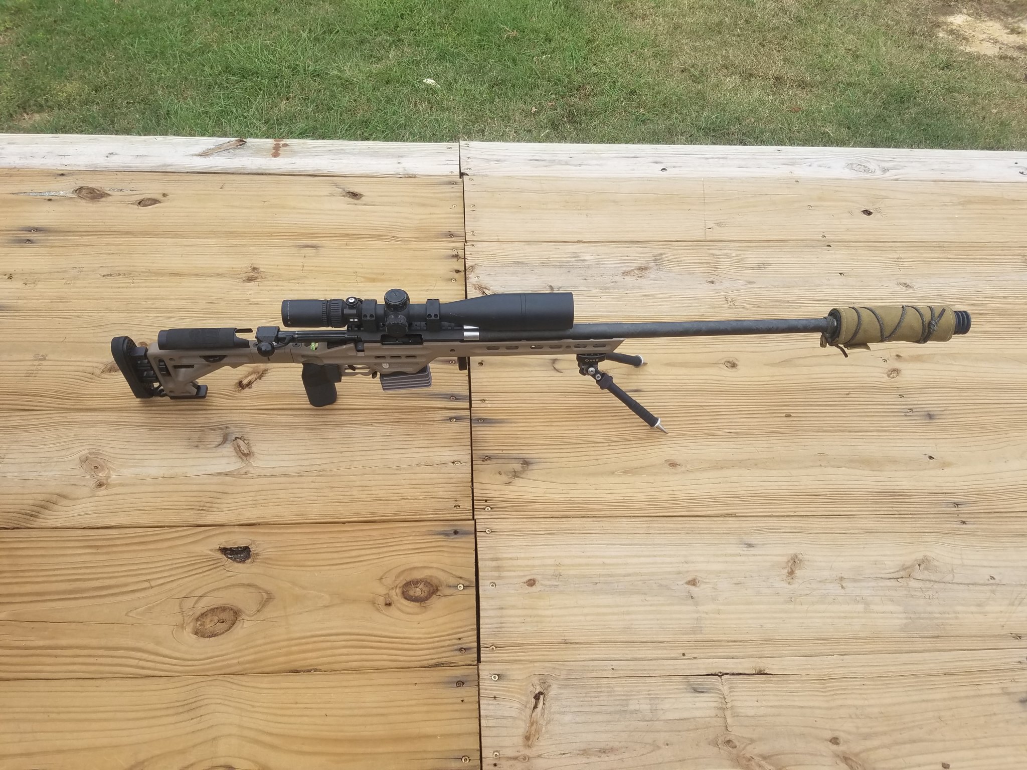

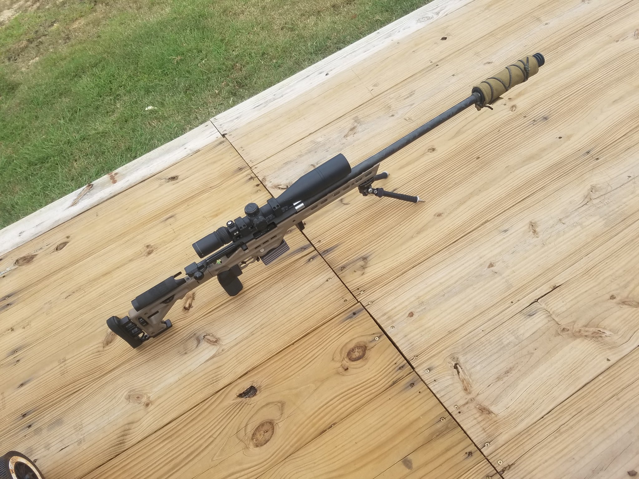

Why???? Because I love the features and stoutness of the AI actions, but the ergonomics of the AT chassis don’t really lend itself to a “great” match rifle. Now it’s a bombproof race rifle that has people scratching their head when they see it in person. I really do enjoy the shock value when I tell them that it’s an AI. The AW mags continue to run absolutely perfect, zero hiccups. In the video I’m pushing down on the rifle. The pic is with the MPA on top of the AT chassis. They’re lined up on the quick change barrel screw holes. The MPA is not adjusted higher for the photo. You can perfectly see the profile differences between the two. I really can’t explain how much better the MPA handles and balances on props.

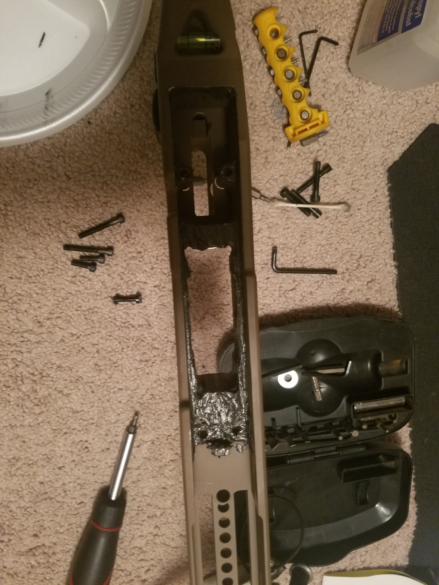

As of yesterday my AT is in an MPA chassis. Thanks for the chassis, Fred @ Bison Tactical!

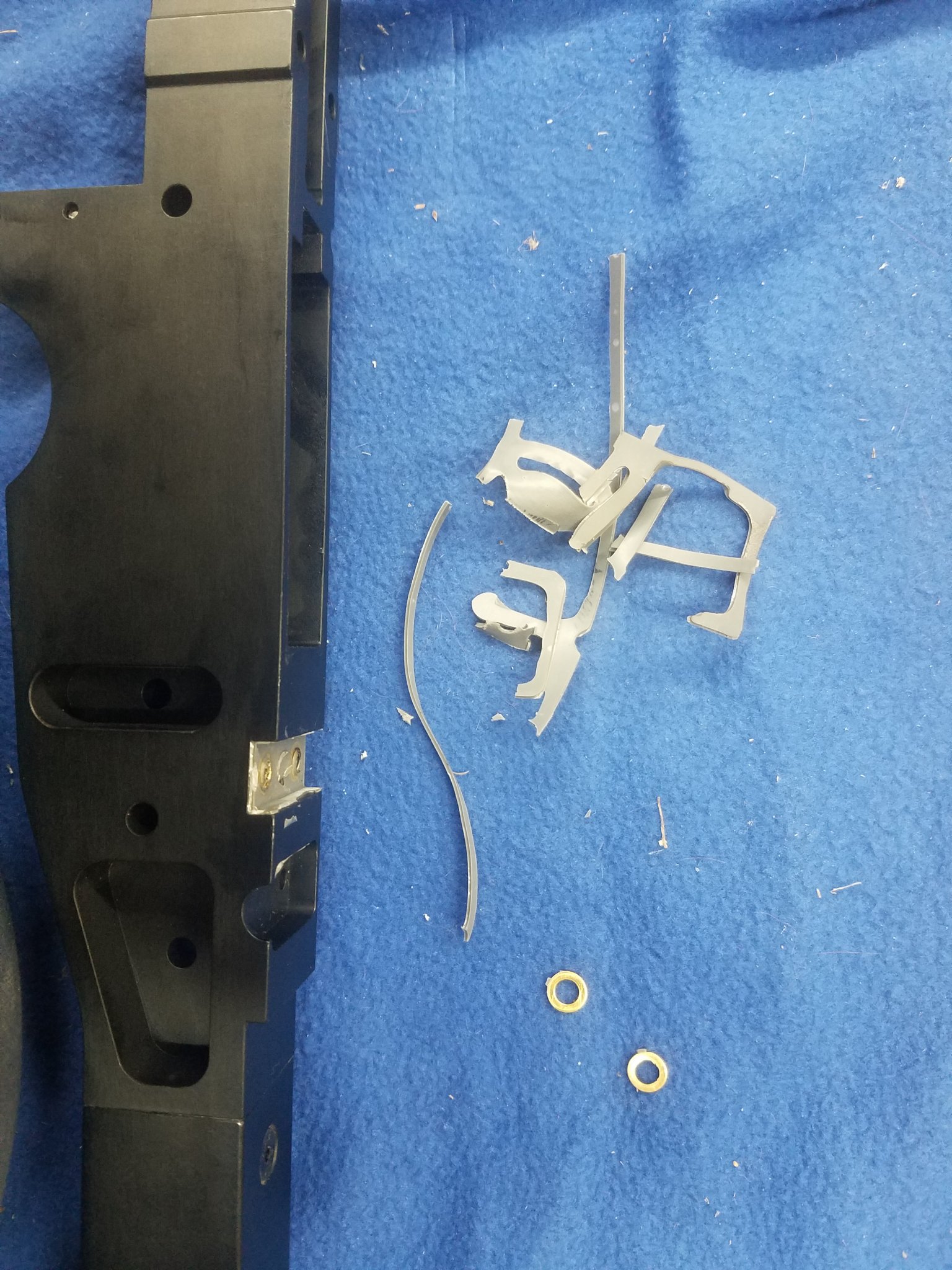

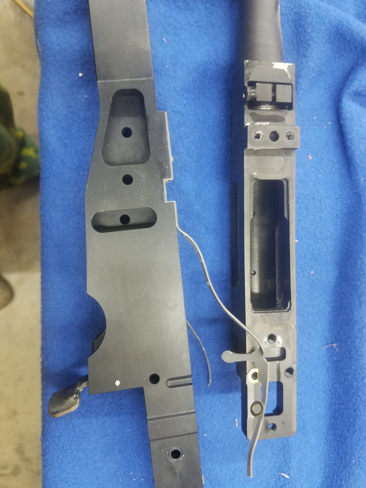

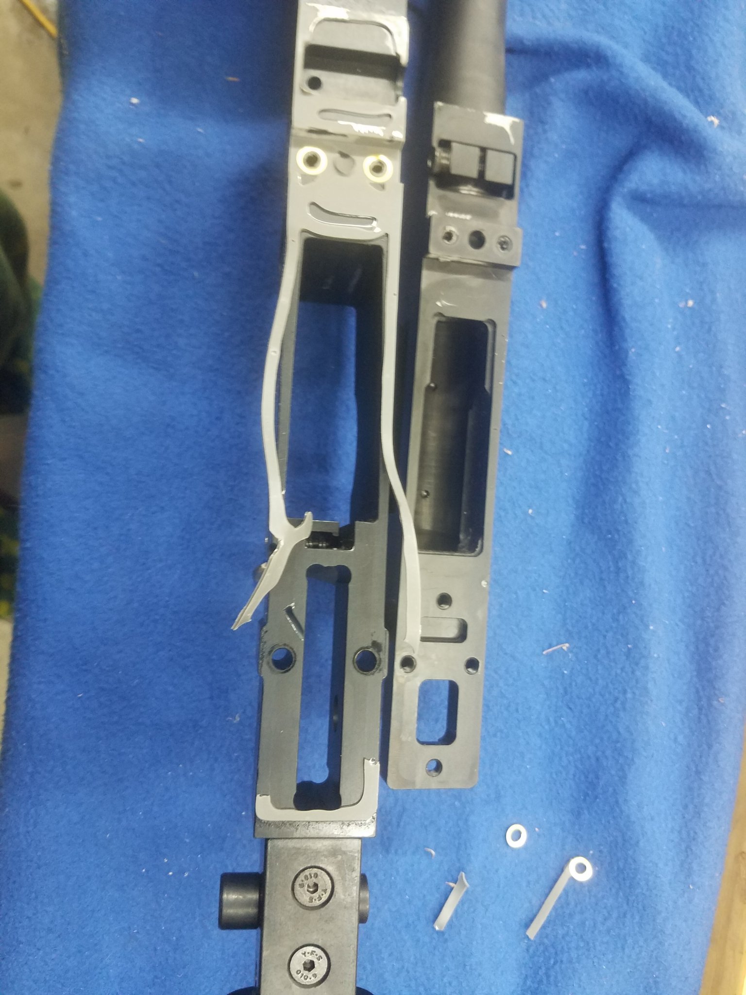

I removed the skins on my AT, applied heat to the action with a heat gun on high for 2 minutes, then popped the action off of the AI chassis by putting a soft wooden wedge between the barrel and chassis. By applying heat, the original bedding material softened and peeled off with a fingernail. The whole process was under 5 minutes.
The trigger retaining plate needed to be trimmed on the side, plus both ends to fit down into the trigger cavity of the MPA. The head of the trigger retaining bolts had to be reduced also. I bedded the action, just because.
Pics.
And yes, that's an AW magazine with a mag extension.
