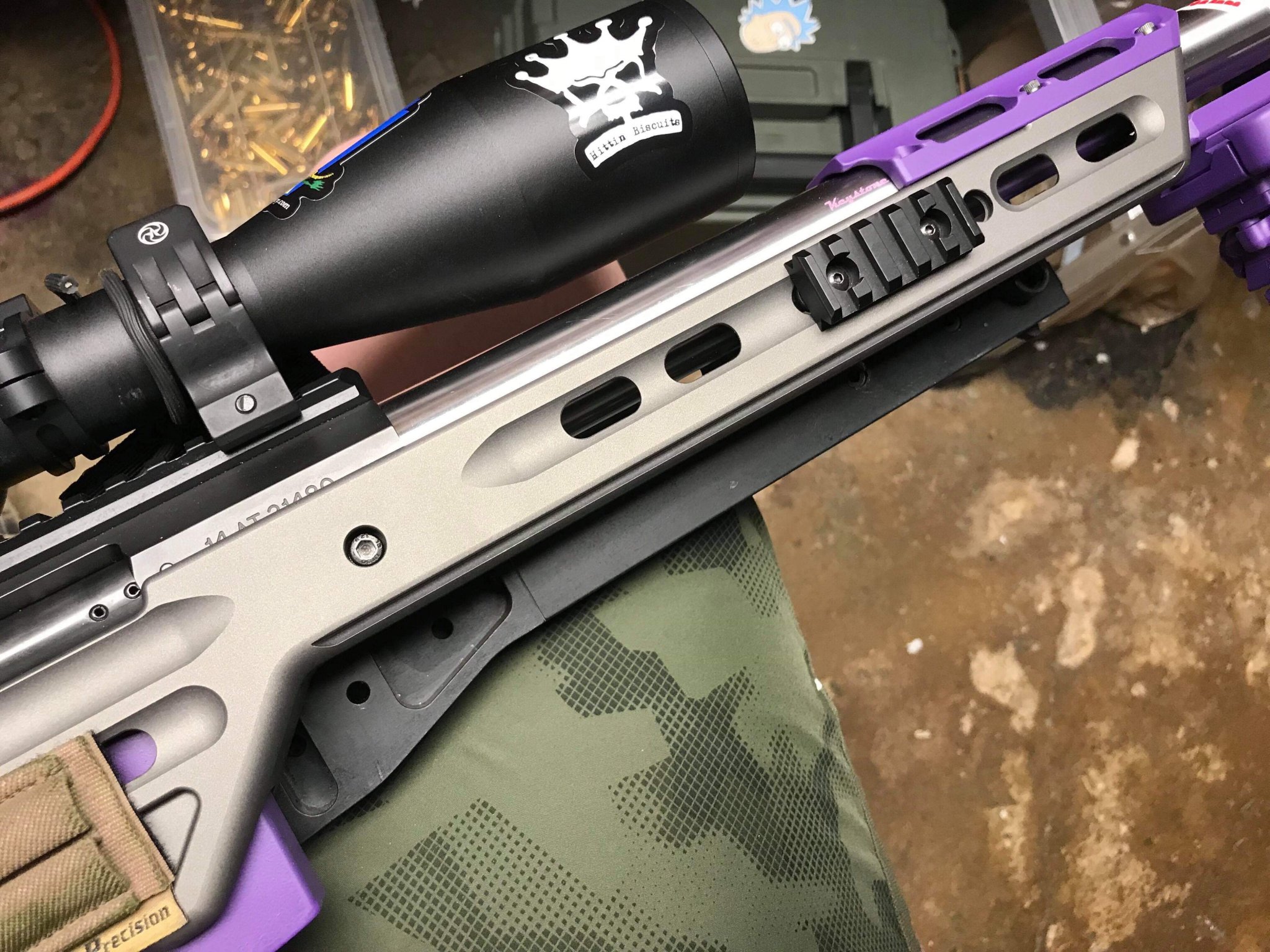

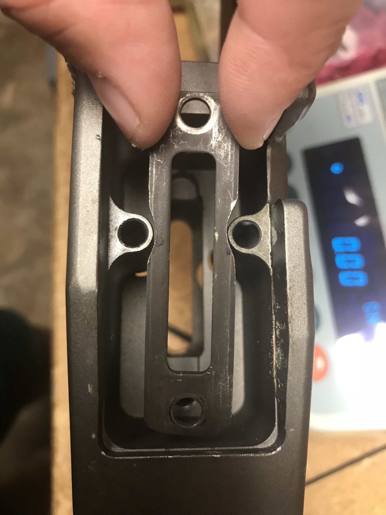

M5 DBMs are wide enough to accept AW mags but I would think a custom height mag latch and action screw spacing would need to be adjusted.
That's what I though at first but if you look at the pictures above, it looks like the AI has 4 action screws and the rear screws are on either side of the trigger. I could see that as a big challenge with a conventional stock as you might not have enough material on either side of the trigger to install a pillar without things getting too thin.
On second thought, with a manners mini chassis it could be done maybe??
Reactions: RyanM
It looks like that would have to be one wide bottom metal - things would have to be awfully thin on the side.

It's not a requirement.
I just do it to ensure there are no chance to have issues. Also, you may ask them to verify the clearance for the safety. I had to relieve a substantial amount of material and some people would be unhappy to ruin the ceracote.
Reactions: 96C
You may ask them to verify the clearance for the safety. I had to relieve a substantial amount of material.

Am aware of the trigger hanger modifications from @tennturk above.
For the first few weeks I didn't notice it, I doubt they're aware of it.

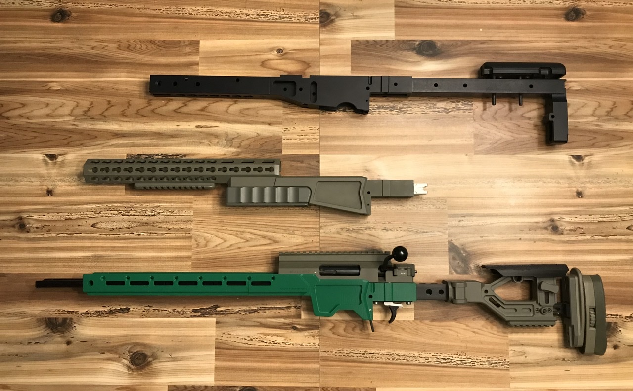

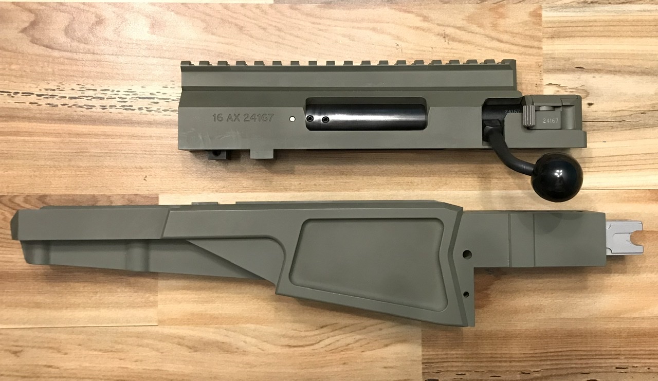

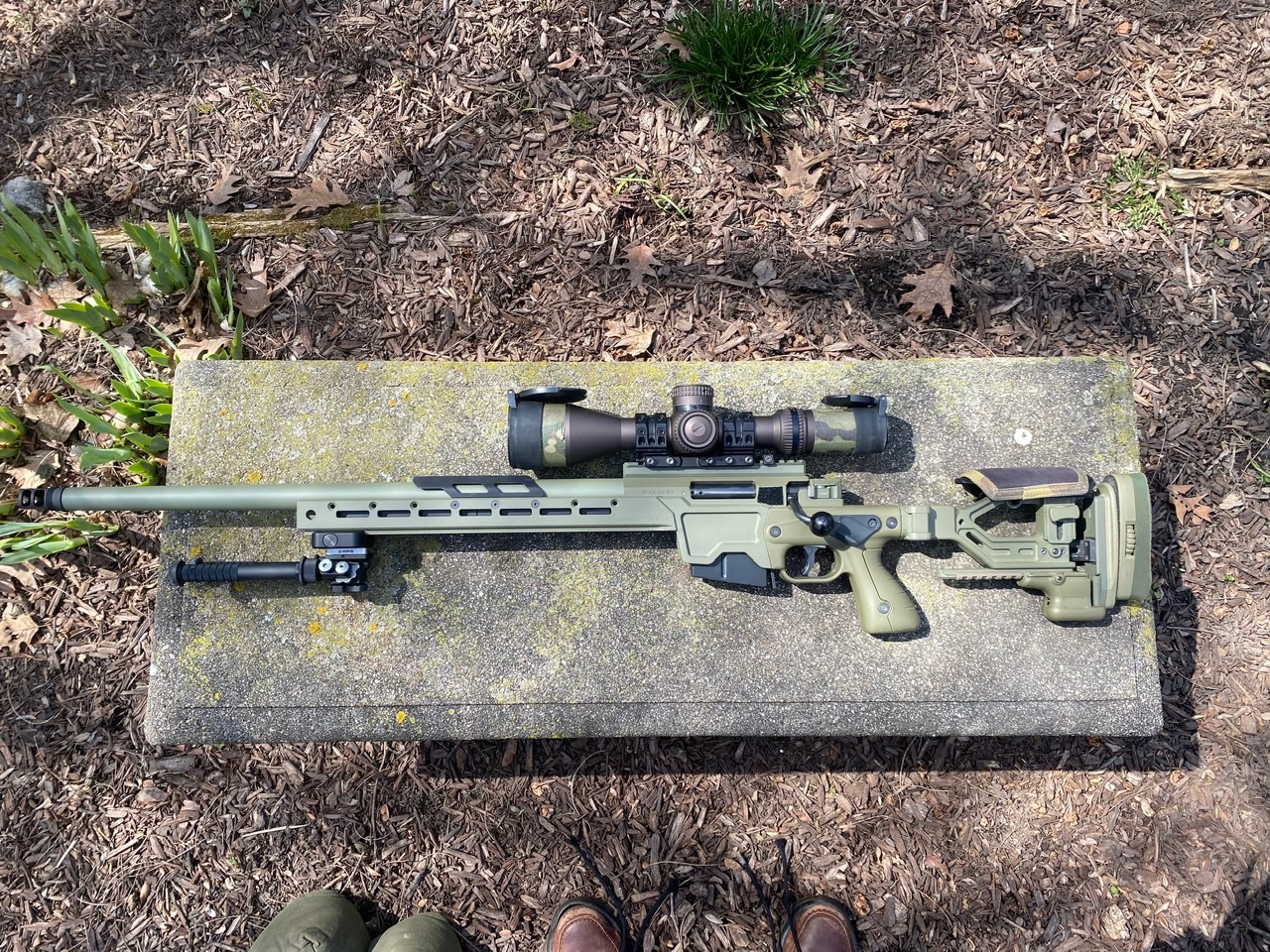

Why???? Because I love the features and stoutness of the AI actions, but the ergonomics of the AT chassis don’t really lend itself to a “great” match rifle. Now it’s a bombproof race rifle that has people scratching their head when they see it in person. I really do enjoy the shock value when I tell them that it’s an AI. The AW mags continue to run absolutely perfect, zero hiccups. In the video I’m pushing down on the rifle. The pic is with the MPA on top of the AT chassis. They’re lined up on the quick change barrel screw holes. The MPA is not adjusted higher for the photo. You can perfectly see the profile differences between the two. I really can’t explain how much better the MPA handles and balances on props.
Please can you post some more photos of the complete rifle. I’m on the fence to do this right now and more info would be appreciated
