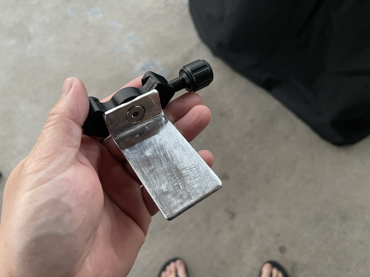

Essentially you can make this sans the arca clamp. Get a piece of aluminum bar at Home Depot and have at it. I used nothing but hand tools and bent it by clamping it in a vise.

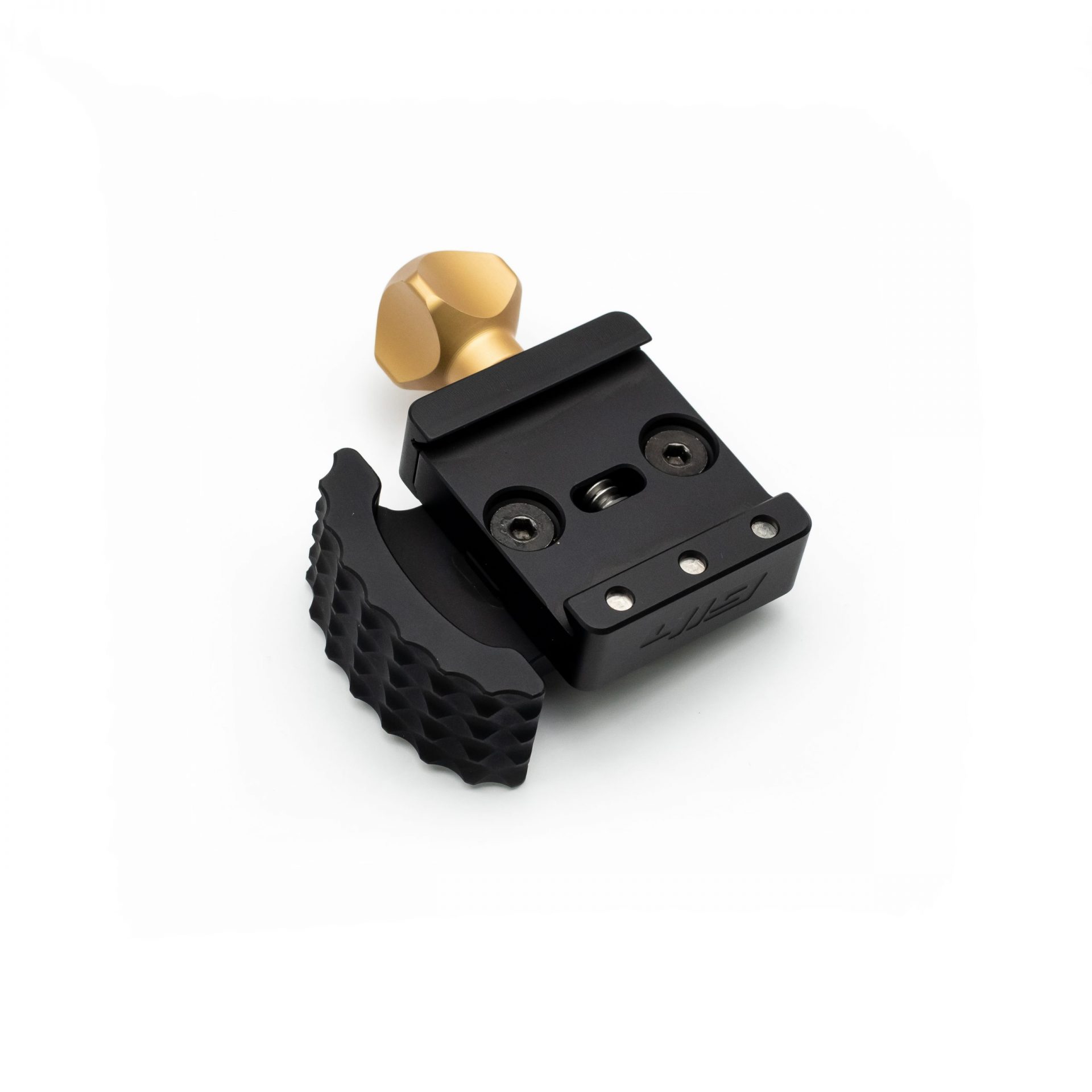

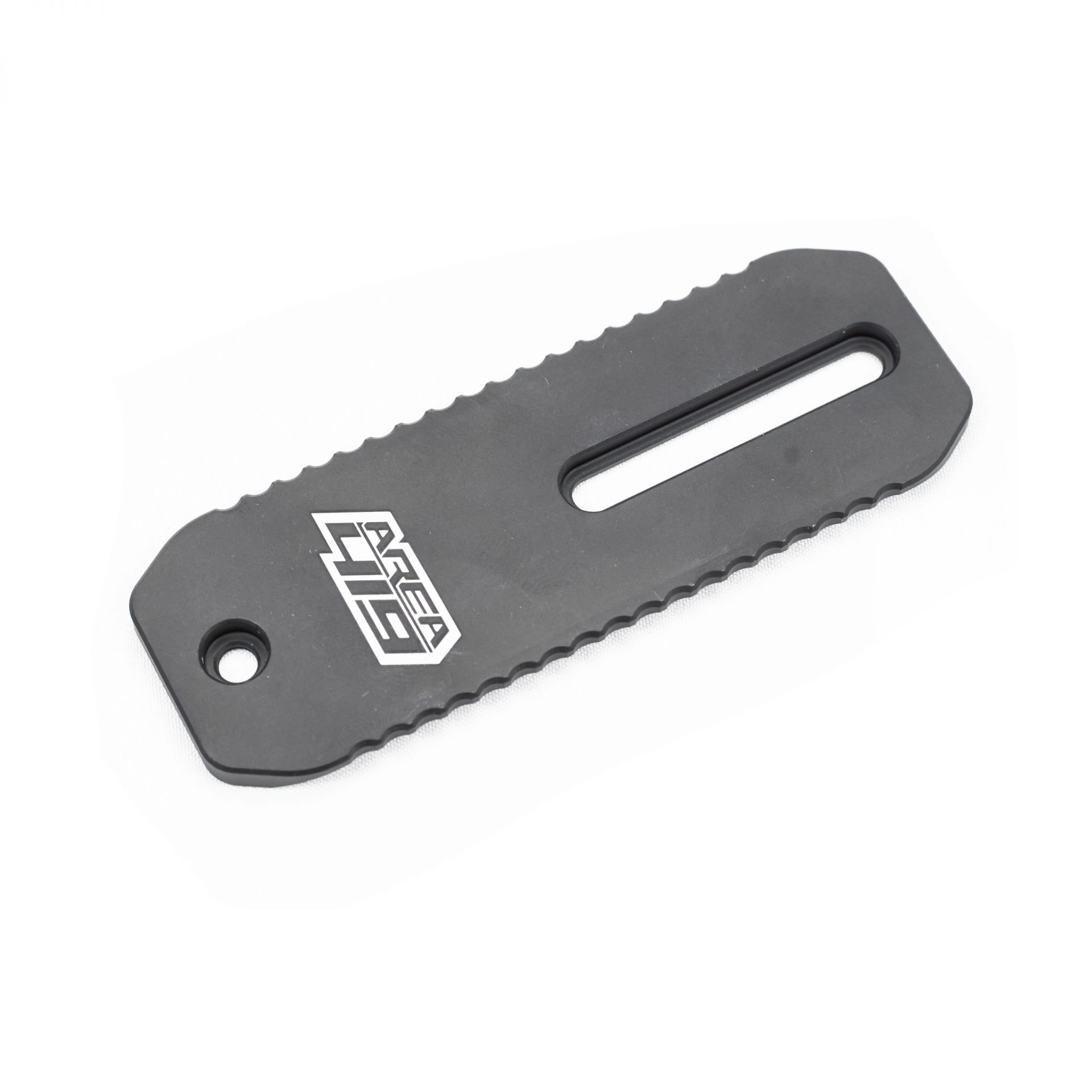

I would buy the 4.25" ARCA rail ( $45.00) and clamp and stop assembly (100.00) for a total of $145.00
That would require two holes.
You could save a chunk of money if you went with the fixed stop. Rail, 45.00 and fixed stop $40.00 ( $85.00 total )
By fixed, they mean you need tools to adjust it's location.
Both designs would put the face of the stop about 2.5" in front of the magazine.

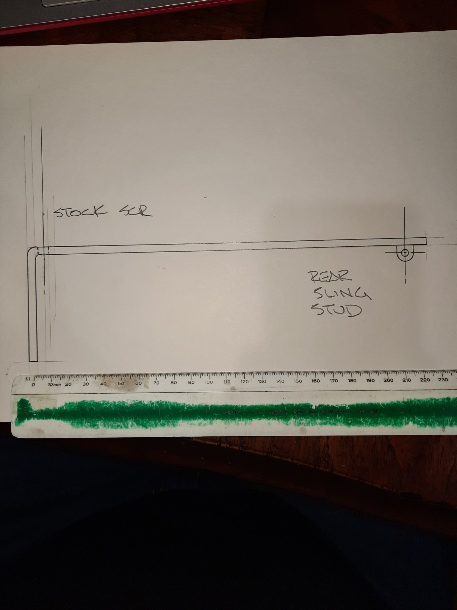

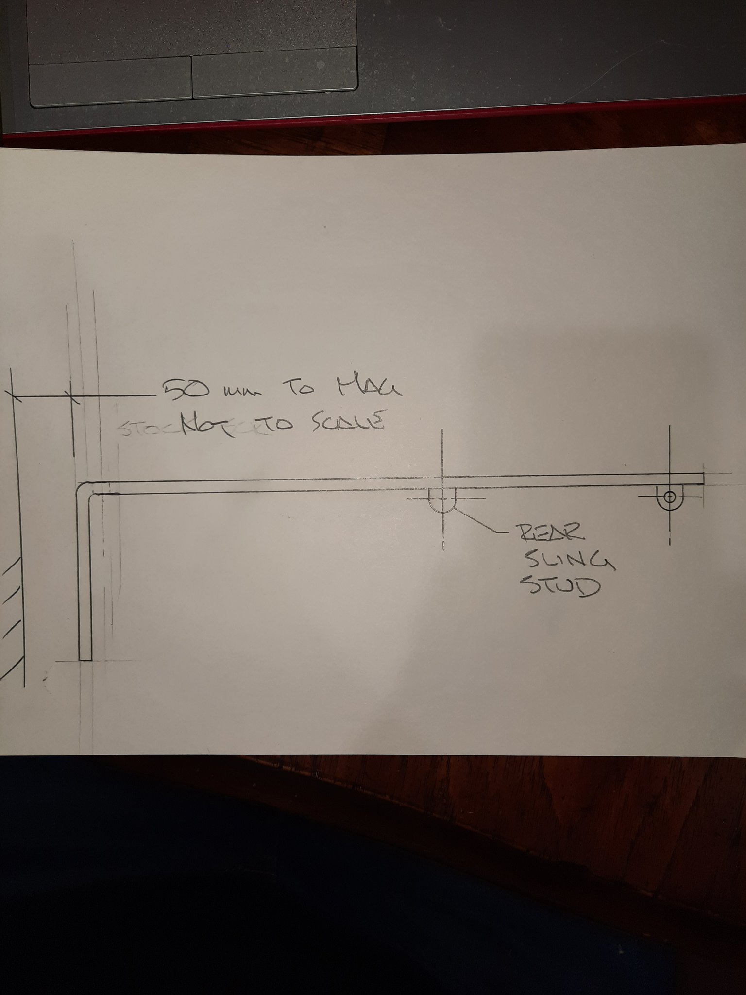

Ok... I just had an idea.
I understand your desire to not drill holes but I suspect that you may be open to repurposing a couple.
You could make a long stop that would use your front stock bolt and another about 200mm farther forward
that is currently used for the aft sling swivel.
That would also protect your stock from wear and tear of the barricades.
Taking that a step farther, you may consider using both swivel stud holes and leaving the stock attach screw alone.
That would leave you with about 50mm clearance to the front of the mag.... or what ever distance you like.
In either case, you could still use the sling studs... if you use them at all.
I have sketched both of them at about 200mm as a starting point.

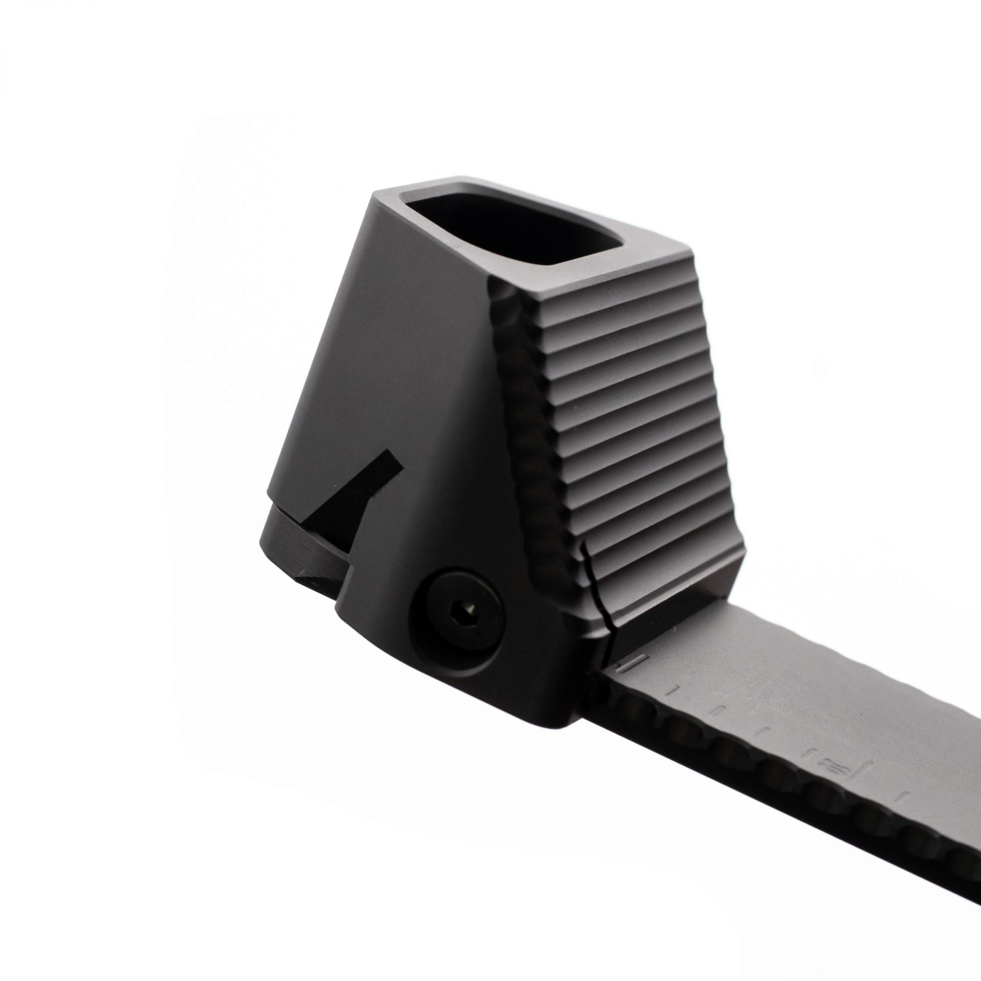

The only non-diy option I'm seeing is the grey ops one, and the seems purpose made for the MPA shaped chassis.
Had the Aera419 for a while then switched to the Grey Ops version. Best one so far to protect the magazine from issues pushing against mag on certain props.
The Grey Ops one seems to be the only thing that will actually stop a bag from interfering with the magazine, the rest of them are just normal barricade stops.
