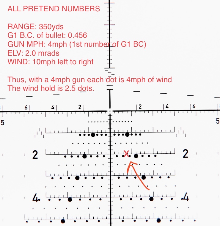

First off, I’d call myself a varmint shooter, not a big game hunter.
I didn’t catch your scope of choice but I think a FFP scope might suit you well unless you are often in dark forests. If you use SFP, train yourself to keep it at the proper mag that the reticle was designed around (or half that). Otherwise your holds will be off.
BEFORE THE HUNT
Weather:
As someone else said, not going to make much of a difference. I think. But do run the numbers.
Altitude:
More of a difference. Not sure it’ll matter that much out to only 500yds.
I don’t have experience hunting in the mountains. More of a pdog shooter. But getting your gun on target fast is paramount for both of us.
Prepare dope:
If I were you, I’d calculate my range cards for different weather/altitudes and buy this plus some spare cards they sell:
Learn the gun MPH/weaponized math (now called Gravity Ballistics).
Look into the difference in dope that shooting up/down makes. IIRC, it takes a fair bit of degrees to make a difference, especially only out to 500.
More dope subtlety: Elevation (aerodynamic jump):
Use a ballistic program to see the difference in elevation adjustments with a left—>right wind vs a left<—right. Make sure that aerodynamic jump is turned on in the app.
In my case, the .204 has quite a bit of change. Larger calibers and more aerodynamic bullets have less difference.
Wind estimating:
Use the wind meter you own or whatever and carry it around all of the time around town etc to test yourself on your wind calls.
Because, especially in the mountains, the wind where you are vs. the target might vary a lot. So whipping out a Kestrel while in sight of an elk seems sorta foolhardy if you’ve trained yourself to guesstimate wind at your position. You’re never going to know the wind at the target anyway until we get some fancy LiDAR wind-ranging RF.
Wind calls:
Study @Jack Master ’s wind rose to calculate a full-value wind call from, say, a 5 o’clock wind. Make a weather resistant version for the field.
Ranging:
I think either having a small monocular LRF or that plus a LRF bino would be nice. The little monocular LRF could be kept somewhere handy to whip out fast.
IN THE FIELD
Weather/Altitude:
You’re already going to know this info on the day of the hunt, right? Close enough at least. Bring along your pre-built dope cards and stick the most likely used scenario on your rifle using the Coletac-type dope holder.
You could bring a wind meter along to test yourself some more.
Shooting:
Range using monocular or bino, estimate wind, calc full-value in your head or glance at the wind rose, look at your dope card stuck on rifle, hold for elevation and wind, shoot.
Or dial for elevation. Whatever floats your boat.
Reactions: Gemsbok

The short version is you take your G1 BC number (pretend it’s 0.456), take the first number and that’s your Gun MPH number.
With this 4mph gun, look at the Tremor 3 wind dots. Each dot is 4mph of wind. The lines/hash marks in the T3 are 0.2 mrads each, and the dots are the wind holds.
In action:
Above the main horizontal there’s ranging stuff and numbers for helping you hit movers, so ignore that.

A chart I made to figure out how much the big dots in the T3 cover up:
Range0.2 mil T3 big dot coverage (more exact)T3 big dot coverage (rough)
1000.72”3/4”
2001.44”1.5”
3002.16”2”
4002.88”3”
5003.60”3.5”
6004.32”4.25”
7005.04”5”
8005.76”5.75”
9006.48”6.5”
10007.20”7.25”
11007.92”8”
(accuracy confirmed by @Jack Master)
Anyway, food for thought.
