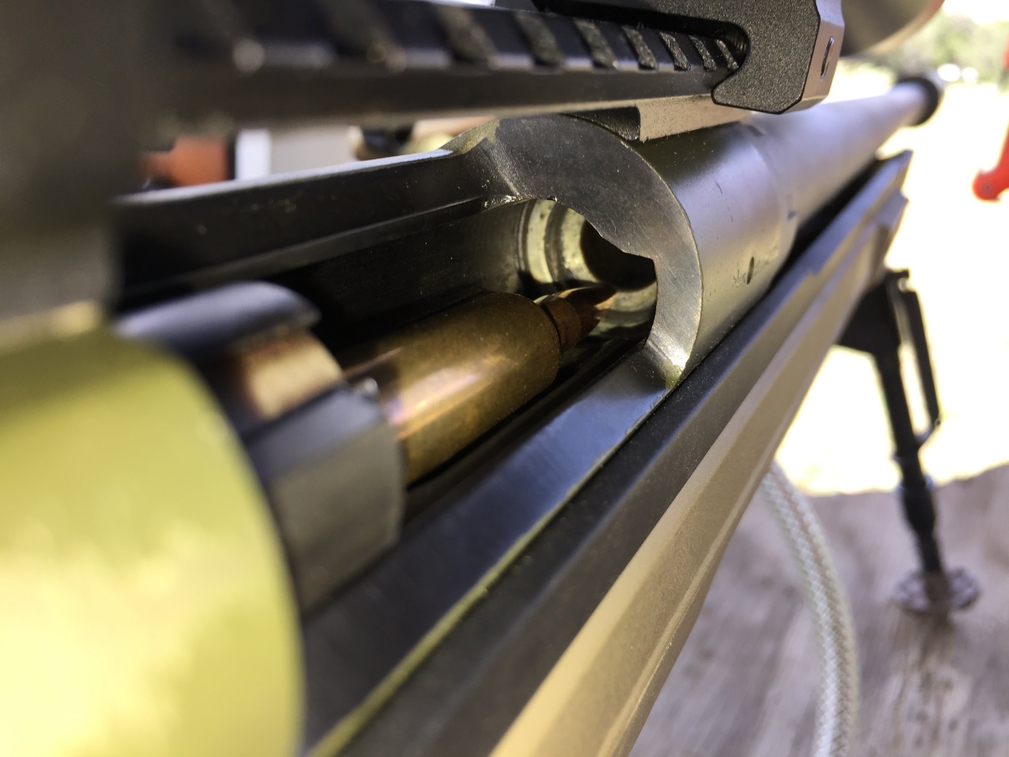

Do AICS mags in a Badger DBM normally need a Single-shot Sled? When shooting F-class my Rem 700 feeds fine with a single round laying on top of the AICS mag/ follower. I guess if I wasn't careful the round could go sideways or roll out.
Yeah, if just laying one top of the feed lips its pointed downwards with the cases body taper and crashes into the breech face. It’s not hard to start the tip into the chamber first though after a few tries, doesn’t take long to learn it.
On the mag
7115262
Fed forward
7115263
That’s a bravo pictured but my old krg, manners, mdt all feed the same way.
My Deviants and 700 feed very smooth single feed just by tossing them in... But try that with a Ruger and a few others and they can get hung up unless doing the above.
