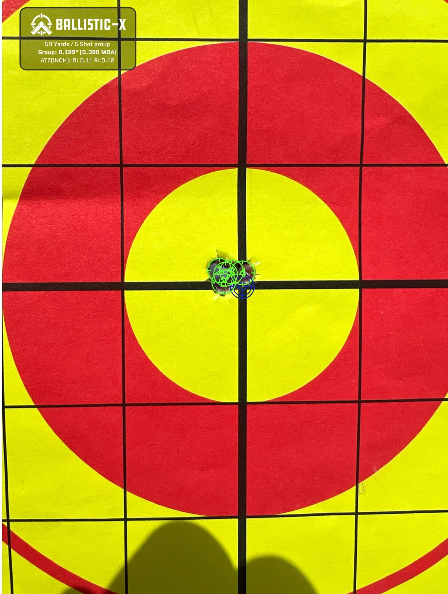

Long range match for me!

I am just telling you guys what I see..I have zero reason to get on here an exaggerate how that particular lot of SK Standard + shoots at 50 yards..
As far the sk standard + i mention not being as accurate as I "described" it actually won a benchrest local comp. The person who put on the match and scored the cards is on these forums. he can chime in if he wants..
I will say that you have it backwards though, ammo that shoots good at 100 will more than likely shoot great at 50..From my own experience, I would not say what shoots great at 50 is guaranteed to shoot great at 100..It can absolutely, but it's not a guarantee.
